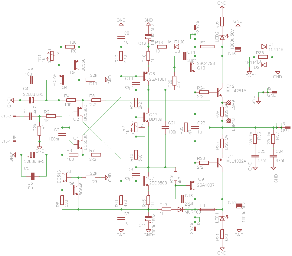

OK, the 2x1N4148/10R combo was the ground lifter I omitted the signal diodes and retain 10R to save space (also not so critical). The 2200uf 6.3v was Lazy Cats original, 1000uf or 2200uf are both valid. 10uf 63v MKP bypass caps is optional, install them if you want (expensive though) without them it's still OK. Small signal trannies BC546B are higher voltage type but they are the same family as BC560C (low voltage, high gain). The 4x220uf 50v filter caps in the pcb represents both C5 & C6 as well as C11,C12 etc...You can use 470uf as with the schematic as long as the board can accomodate it. Lastly, the output zobel network (another omission to save pcb space) can be attached to the speaker terminals. This is a personal preference (me of course ).

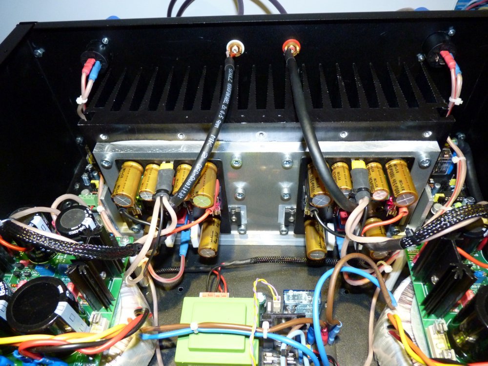

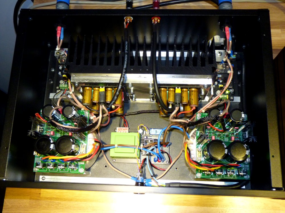

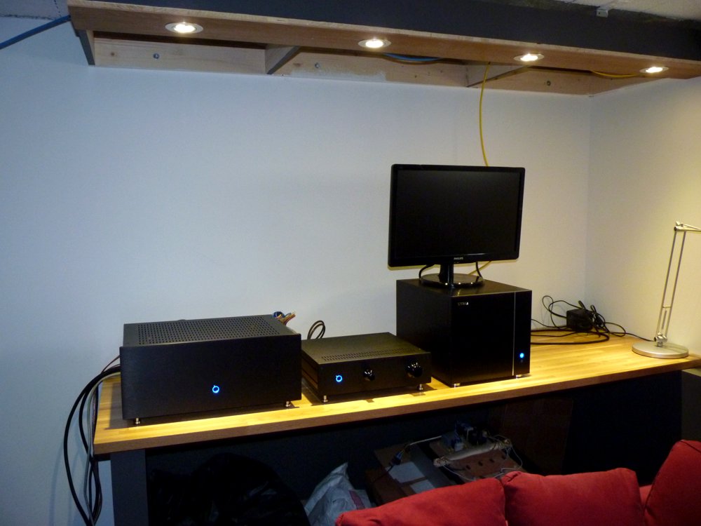

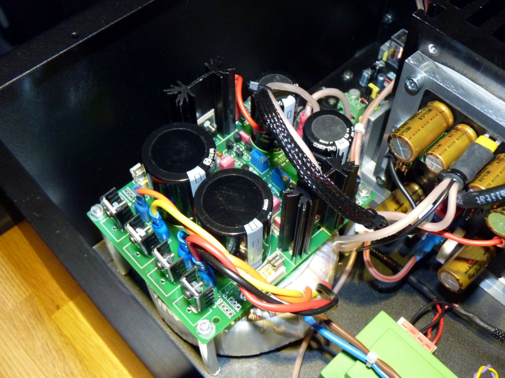

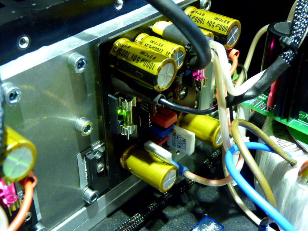

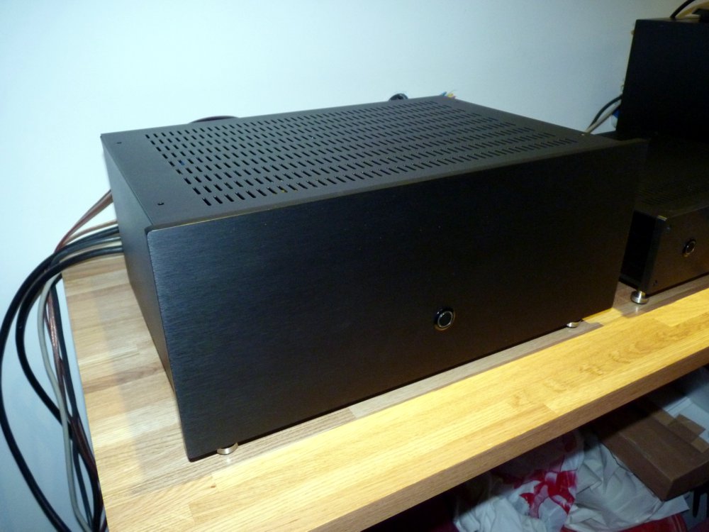

Hi, i just finished the versatil casing. Initialy i have bought to SMPS300RE but i have an issue with them as they induce the light bulb tester turn on. So i go for Capacitance multiplier as i had some board and trafo in stock. Versatil 50 is yet feeded in mono configuration : 1x 300Va 2x25Vac + Capmu per amp board. Varsatil is bias @ 55mA. All capacitor are new and need some time break in but the few listening session i made since yesterday evening let me think that versatil will take place in my listen room for a while...may be juste replaced by a 110W/8R 3 output pair version. I join you some pictures. Case is a commercial one since i have no time to begin from scratch. I have no soft start as Capmu as this proprity. I have just a 12V little power supply for DC protect and trafo relay on
^Very good looking build Idefixes!

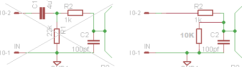

Idefixes a pleasure to see your top notch handwork, congratulation and thanks for posting. Because you posted over at LC's VSSA about the SMPS i think of some easy test setups to try for bettering your Versatil. Thinking of input filter and PSU voltage 45V which both i think may influence sound quite much. Modify input as in picture, it makes nearly a copy of LC's input, and try connect SMPS300 to Versatil to get it at 45V.
Thanks Brytt for advice i will try it on proto.

Having followed Idefixes great diy skills just makes me think that to compare they need same dymamic voltage elastic, and input filter may also make difference, earlier this thread Boris note it could be DC coupled by omitting C1. Think GB VSSA still win soundwise because of speed and clever CCS + layout by LC. But beauty of diy PCB's, zeal and handwork by Idefixes is hard to stand. Thank you both.
In fact, even if will swap versatil by vssa in actual case it never signify death of versatil, just the time to purchase a new case as i will keep vesatil together. So your suggested modifications have all my attention.
Differences between Versatil and Vssa are very subtiles so all this schematic familly are topnotch. Versatil has a another major feature over VSSA as for it can be easy upsacle in power and current capacity for diyboys...

So Brytt suggested mod is done....and he was rigth : input cap suppression is another premium mod to do. Versatil reach VSSA calrity and sound stage level, but at first i fouded he lost some weight in lower end so i remember me what i done on VSSA that had same lower end presentation : i bypass mur160/10R on both supply rail between before input CCS. This mod produce same effect as on VSSA : nice lower end were back. Yet i am unable to make difference between VSSA and Versatil. Conclusion next Versatil generation will have no input cap and no mr160/10R combo on Vrail.
