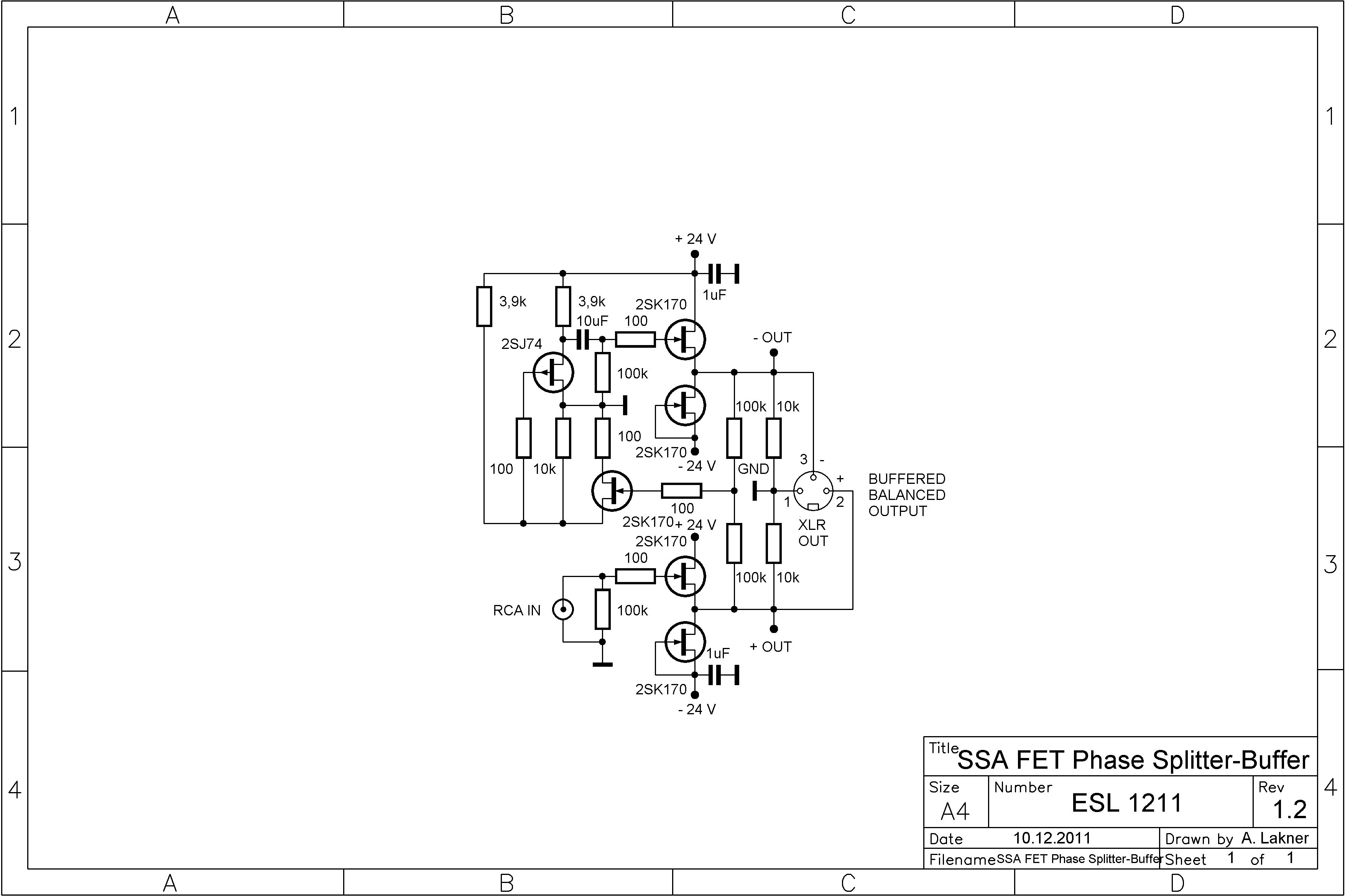

SSA FET Phase Splitter Buffer
Six fets form compact phase splitter plus impedance buffer for balanced XLR output. Can be sucessfully used as balanced line driver or as input phase splitter for bridged amplifier.
Regards Andrej 😉

Though it probably has enough open loop gain for decent gain balance.
What guarantees the midpoint of the 100K's is GND and doesn't drift?
I'm thinking this will have DC offsets that don't match.
Oh, nevermind.. That GND drift won't matter, I just spotted the 10uF in
the feedback loop. DC can match as well as the output JFET pairs match.
And drift with temperature in unison... Its OK. A lot of parts though...

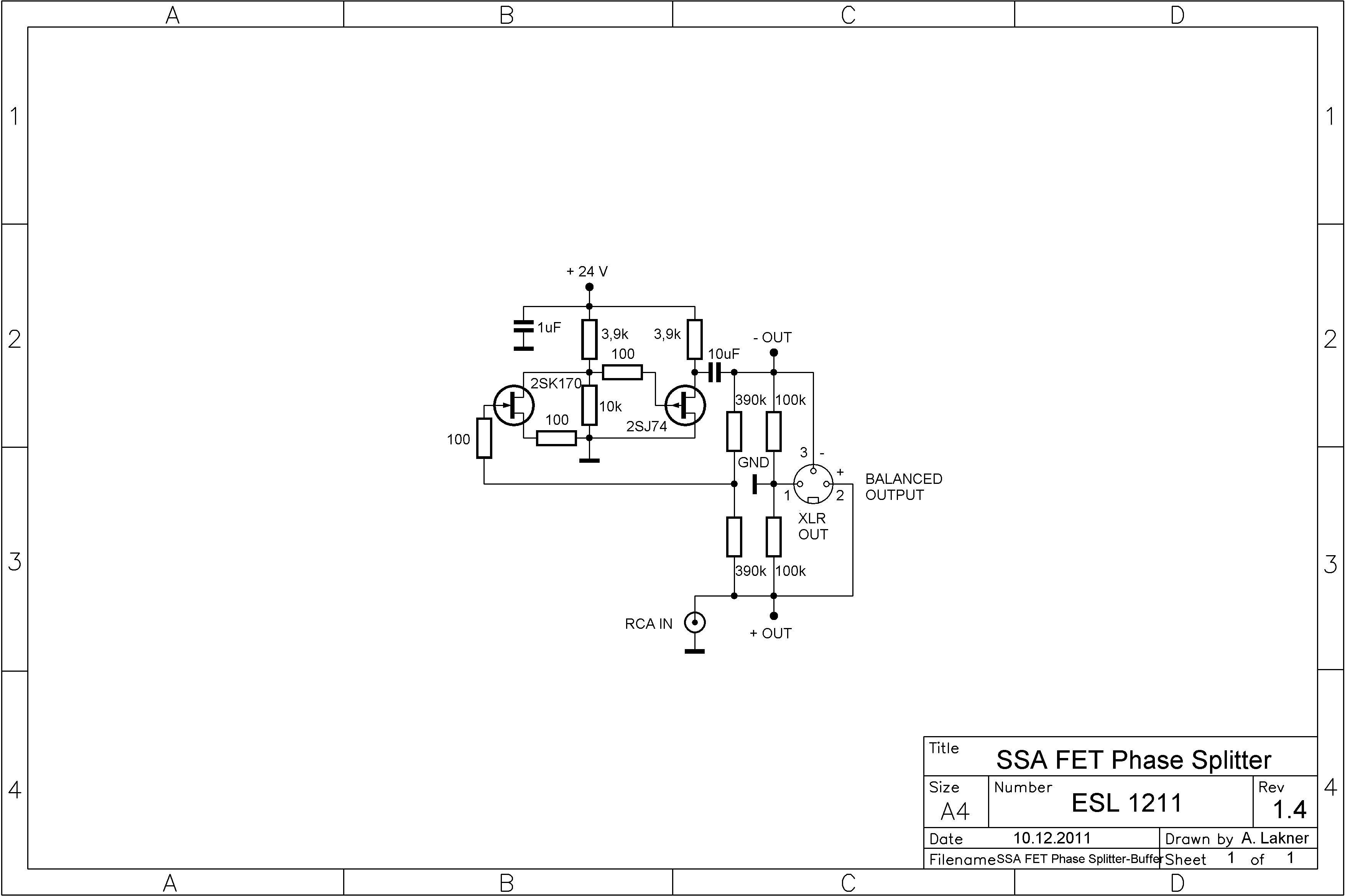

Here is simple but effective solution with all possible options at the input as well as on the output, buffers already included to drive power amp for each phase.
Regards, Andrej 🙂

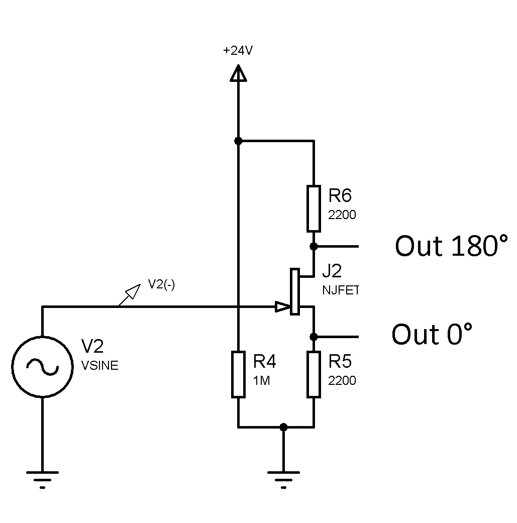

Hello, is there a way to use this circuit without a input transformer? I mean using it with a rca input . I will try to use this circuit with one mono signal input in order to have 0° and 180° output phase .
Thank you..
