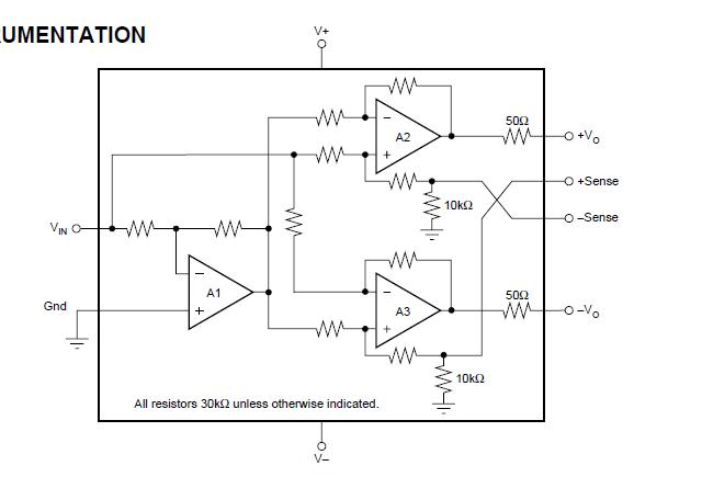

Just for fun and curiosity, is it possible to make something very much like the MooseFet IRF710, except with the major difference being phase splitter duties for bridging amplifiers?
What about a differential line driver opamp?
http://www.ti.com/lit/ds/symlink/drv134.pdf
17 volts into 600 ohms with a slew rate of 15V/us @ 0.00005% THD.... If that's not good enough...

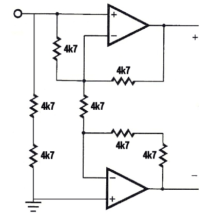

What do you think of this curious arrangement?
Is there something that needs fixed?
Surely there would also have to be 4.7 pF from each output to negative input, just to bolster the "4.7" theme. <grin>

Here's the DRV134 schematic. Show me where there is "compensation" in this circuit.
The rest of the stuff you wrote makes no sense to me. sorry.
Yes sir. A1, A2, A3 clearly show a grouping of internally compensated buffer chips. My application doesn't resemble an IN134 closely enough for DRV134 to produce the favorable figures that it did within optimized circuits located at the laboratories of Texas Instruments.Here's the DRV134 schematic. Show me where there is "compensation" in this circuit.
Unfortunately, there is nothing in common.
This was and remains, Application Mismatch.
If you can apply it successfully to drive a hi fi power amp, well Kudos. But the facts are that I cannot.

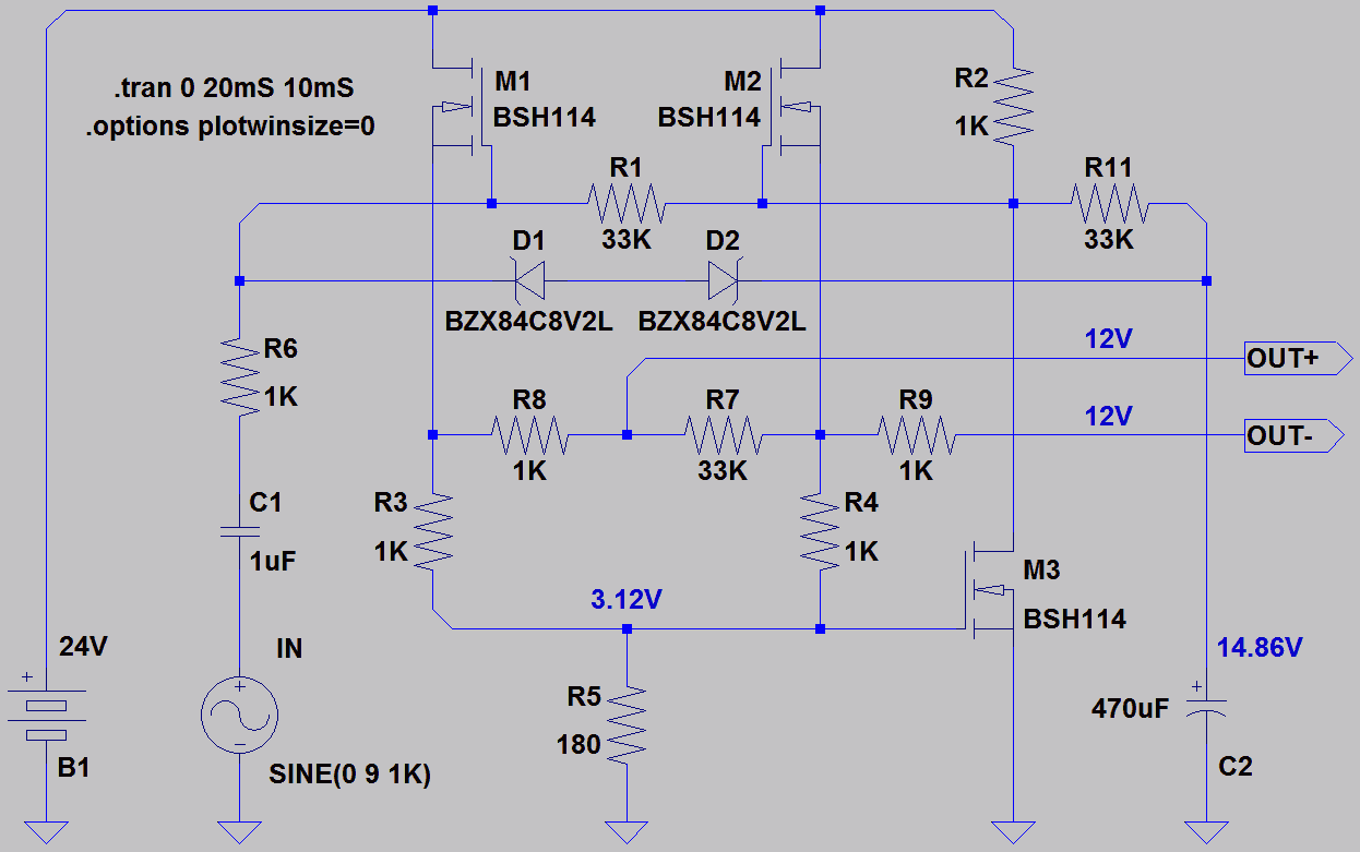

Biggest PITA was getting both clipping behaviors right.
If you are bridging an amp, I would assume that both
drives need to clip exactly the same??? And not pump
one side up while the other down, nor make weird dip
in one peak asymmetrical to the other...
Finally solved: let clamping find it's own damn center.
That worked! Nothing "normal" I tried before that did...
VGS threshold sets how close to our rails that a clamp
must restrict the input waveform. These zeners give us
about 3.1V exclusion, but I think it wants for around 4V.
Might also keep drains from going severely non-linear.
Some of the bigger MOSFETs like IRF510 simulate well
too, but the tail resistor at the bottom also has to be
scaled with VGS. Probably ought to be a potentiometer.
I could not find a lower VGS .model that performed well
enough to keep the gains balanced with reasonable low
output impedance. The one chosen for this sim isn't too
bad, but it is surface mount.
Sim here is just starting to clip. Back the input down a
little, if you prefer to examine the linear performance.

Ken, that looks great!
So, R5 is 270R (or 330R?) parallel to 1k variable resistor and turn the dial till 3.12v?
Surface mount fet is okay. They're easy to solder.
What other adjustments are done when "Fet Rolling"
For IRF510? (fast local availability for it too)
For IRF710?
I mean, do some of the other resistors need to be different value or variable to support that?
Which resistors need to be larger than 1/4w?
The Zener is 8.2v 1/4w. But I have 9v on hand. Okay to try it?

Ignore 3.12V. Tweak the pot till outputs are centered
exactly halfway between GND and power. Whatever
voltage VGS turns out to be, probably doesn't matter...
9V is too wide, it won't clip in time to keep the circuit
in the zone of good behavior. If 9V is the reverse volt,
you have to add another 0.7 for the opposing diode
that is biased in the forward direction, so total its 9.7.
Unless you speak of an SA9 transorb. Bidirectional, so
you would only be using one...
Don't go closer to the rails than VGS. And don't use
a MOSFET with low VGS. We lose open loop gain, and
closed loop gain balance if VGS and R5 are too small.
Pick a zener thats a little smaller than (B/2)-VGS, or
add a few volts to the rail to widen your margins.

I think that I understood the voltage. But, I don't understand which pot dial to turn to make the outputs have the same voltage (both at exactly 1/2 the rail). Earlier, there was also mention of pots and adjustments, but I became lost, since the schematic doesn't show it.
We have to multiply VGS to center the output between GND
and the power rail. But we won't know VGS in advance...
My voltage marked "3.12" is a manufacturing variance of the
MOSFET, and not something you can control. No matter how
far out of wack you might adjust this circuit, you will always
find VGS threshold for your M3 here, whatever number that
threshold happens to be. Probably not the same as mine...
Instead, adjust R5 until DC offset of your output is 1/2 of
full rail voltage. For 24V rail, use 12V. For 30V rail, use 15V.
Both outputs DC should be same, so doesn't matter which
output you choose to probe for the R5 adjustment.
After you get the center set, you can measure VGS at the
point marked "3.12" if you are curious to see what figure
your MOSFET threshold might actually be... It matters to
your selection of a proper zener threshold.
The thresholds of (one reverse biased zener + one forward
biased zener + M3) should not total up more than 1/2 rail.
If they do, pick a smaller zener.
Your 9V zener might be OK at 24V rail with some MOSFETs,
and not with others. Eliminate the worry by using 30V rail.
The above measurement was made with no input signal.
But now we need to apply a steady tone that does not clip.
Measure the AC voltage of both outputs, and tweak R7 to
make them exactly equal.
R7, a 68k resistor parallel to a 100k variable resistor?
R5, a 330 ohm resistor parallel to a 1k variable resistor?
*I was aiming for trimpot controls that aren't twitchy and don't wear out the trimpots. For less wear on the trimpots, perhaps the paralled fixed resistors could be a step smaller value. Am I on the right track?
If I heard you correctly, it seems like you want R5 to stay inside the range of 3.3v to 4v. Is that right?
At power up and power down condition, the rails will fall below the range of 24-30vdc. Is that a problem?
Apparently, I need to use an adjustable regulator, so I can dial the rail up or down to help the conditions all match up. Wouldn't that be good?
As for power, I wish that I could calculate the method for making an ordinary regulator chip work as a shunt regulator, like Jan posted in the last newsletter. But, I can't seem to get a grip on the calculations for it. Clean ground and clean voltage would be nice though, because it seems like there's no point in having one clean without the other just as nice. Help?
And I need to order some parts.
