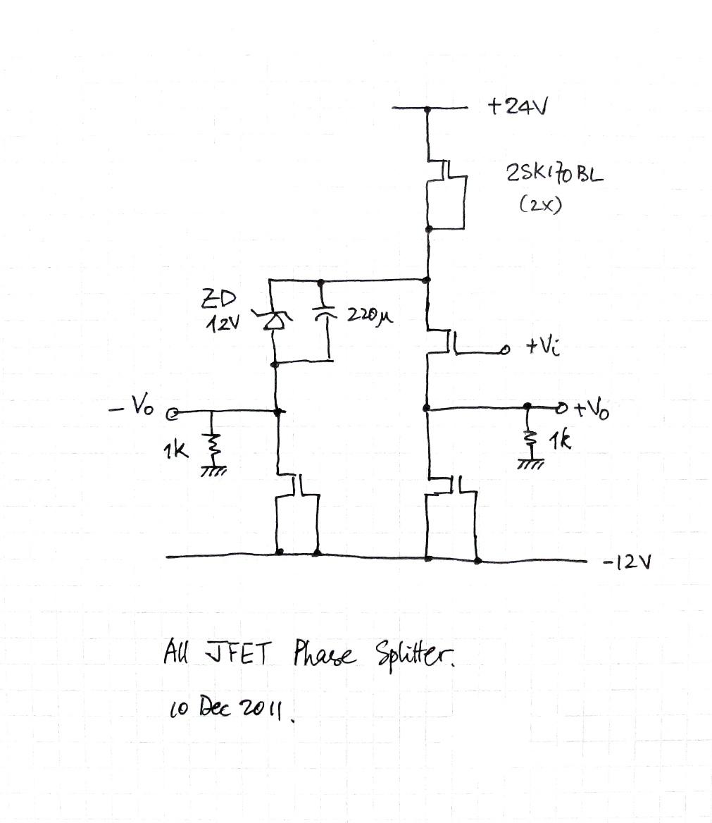

Fet based phase splitter?
After all of this, I still have to ask, why not just make one of the amps inverting and one non-inverting, so no phase splitter is needed? Too "asymmetric"?
Or, if you really want to use two identical power amps, then why not just use two simple unity-gain opamp input buffers, with one being inverting and one being non-inverting? Still too asymmetric?
Or is it really just too boring that way?

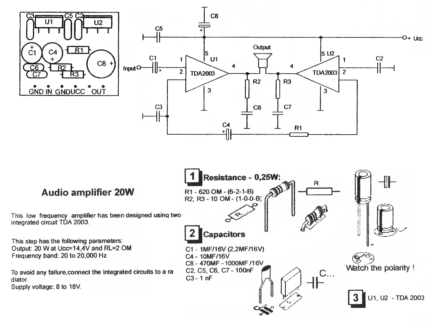

Table radio amp
Here's an inexpensive little amp suited for a table radio (with a surprise).
It needs a 10k pot and it needs regulated power.
The surprise: It will fill approximately 125 cubic foot of air with a large 3d sound field from a single speaker.
What causes the surprise Big Wide Tall Deep sound field size (from a single speaker) feature from this little thing?

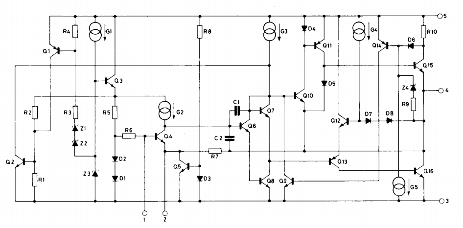

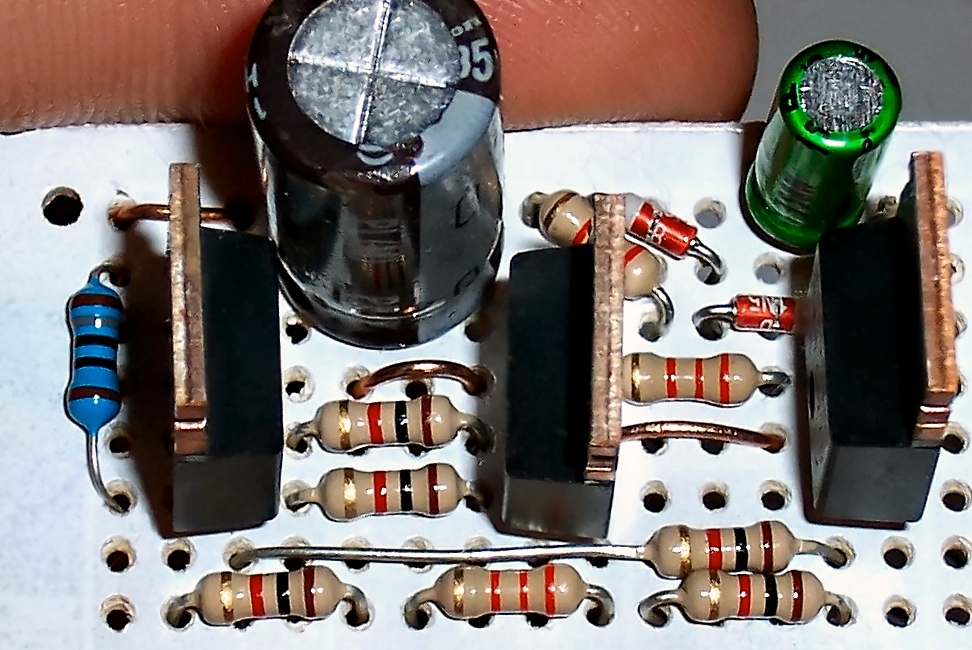

Been chasing down Fake Fets with the car! These IRF9610 Fets from Texas arrived at my mom's house in Kansas, so after a 4 hour drive, I caught them, but they weren't Texans. By looks, extremely shiny thin chrome with much exposed copper on the sides and a few mill marks showing, they are Chinese Fets.
Fortunately, these aren't the well decorated high priced counterfeits with fake brand names on the outside and nothing useful on the inside.
Instead. . .
These are the very inexpensive generic and the manufacturer actually does intend for them to work although it cannot match a simulator. It can be expected to sound more like a 6n11/6n3P than a 6922, will have different voltage tolerances, and won't quite match IRF9610. Fortunately Ken's circuit has some adjustable dials. Thanks man!
I'm sitting down with the schematic, a little board, a scrap of datasheet, some random resistors and 3 fets to discover how to fit this all together without long leads/traces. So far, its not boring. A tone like 6n11/6n3P except also with the clarity that a Fet could do, would be acceptable.
