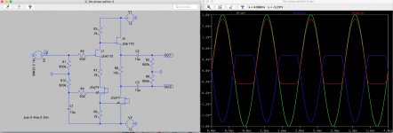

However, when I try simulate it on LTSpice using the beloved jfet 2sk170/2js74, the output look wired. May be I doing something wrong. Please help see if there is issue on the schematic or I did somehting wrong by replacing all 4 with jfet. I changed some register value from 10k to 2k to keep the Idss in-check with the BL grade jfet.

Think I figured out the issue on above schematic. While the writer mention the above circuit for two fet and two transistor (BJT?). The first stage of fet is not bias correctly for 2sk170/2sj74.
I modify the circuit and changed it to use voltage-divider bias at first stage jfet and it work on simulator correctly the first try. Then I find out the new circuit is almost similar to the writer second circuit which using 4 transistor. Anyway. it been good for me and able to learn more on jfet bias as part of discovery and trial and error.

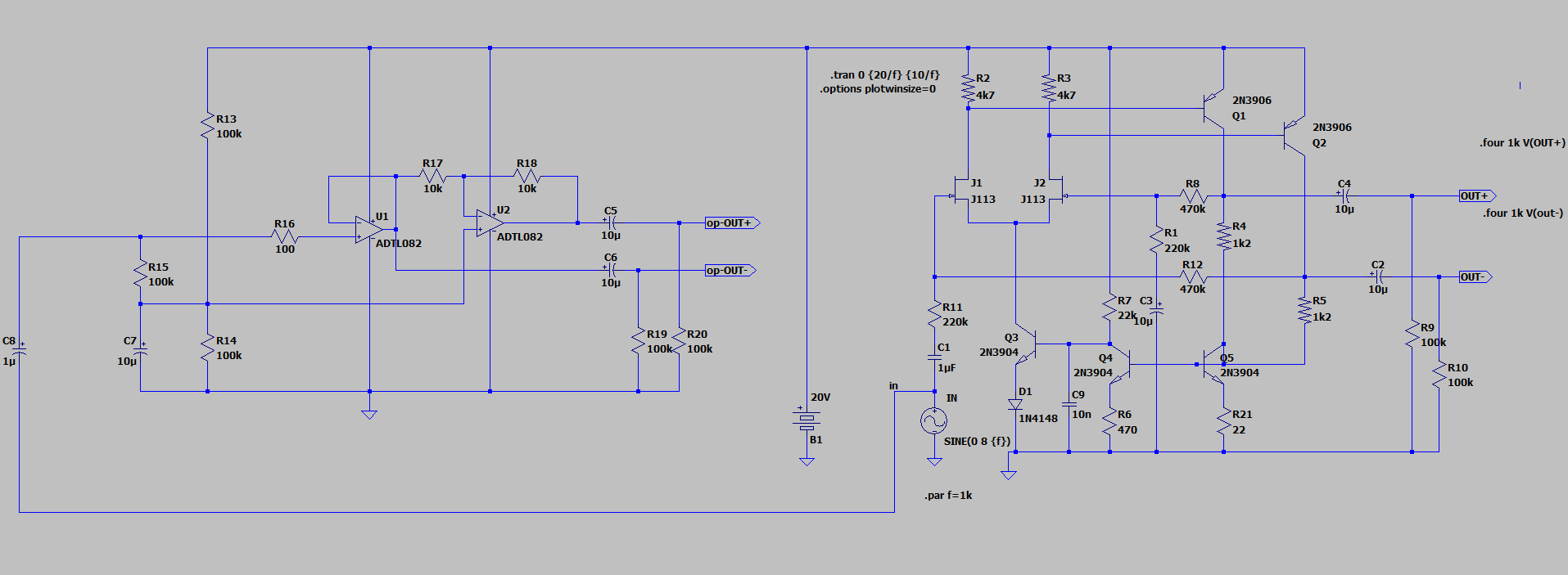

I played with this a bit. Interesting that circuits that use no feedback suffer from wasted output capability, < half the supply voltage. So I turned to a circuit similar to the "Educational PA amplifier" example that comes with LTC Spice. It has similar startup problems but using JFETs that conduct with zero (startup) bias solves that problem. So here it is along with a standard op-amp solution, which could be just one dual part such as TL084.
