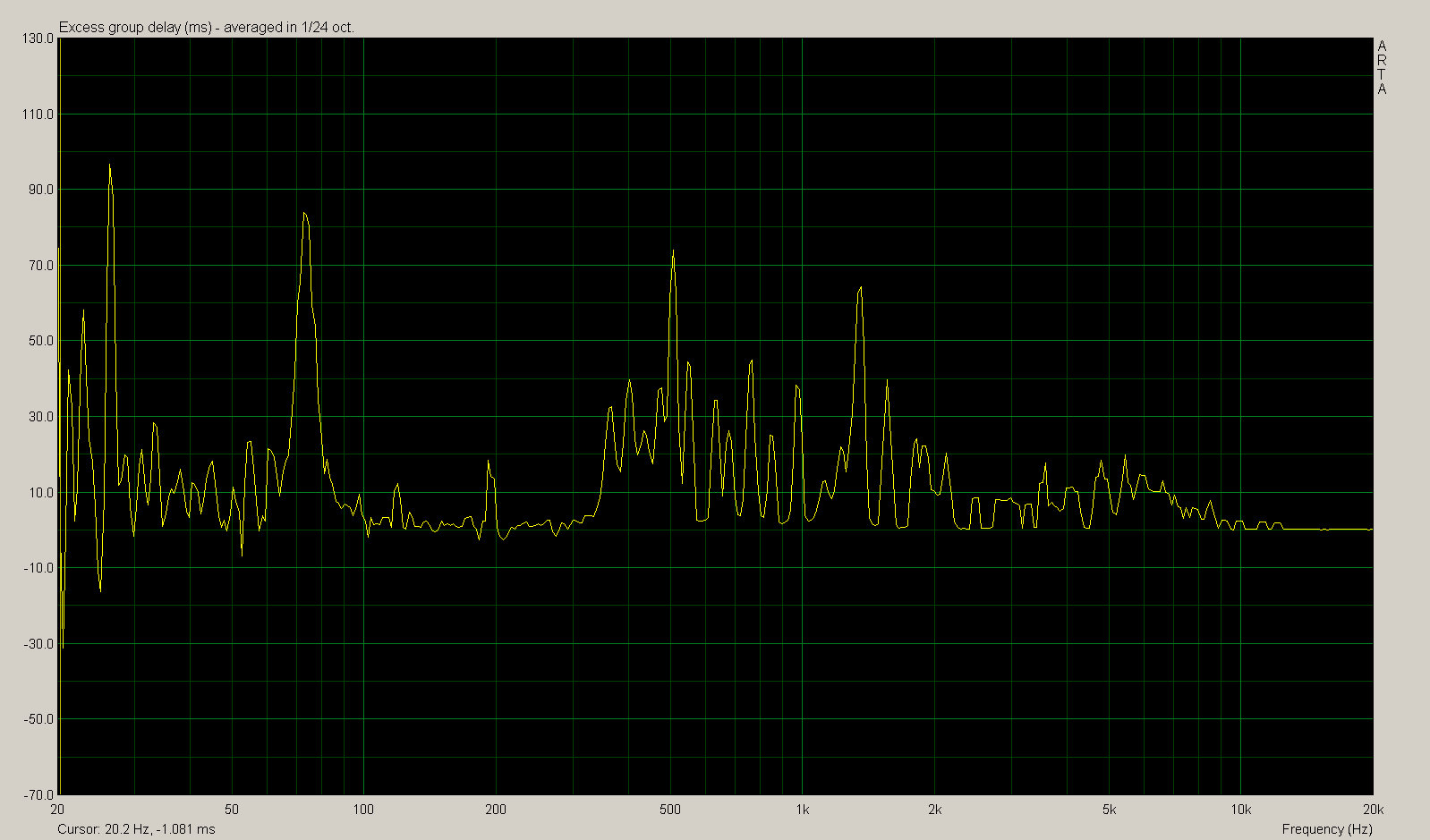

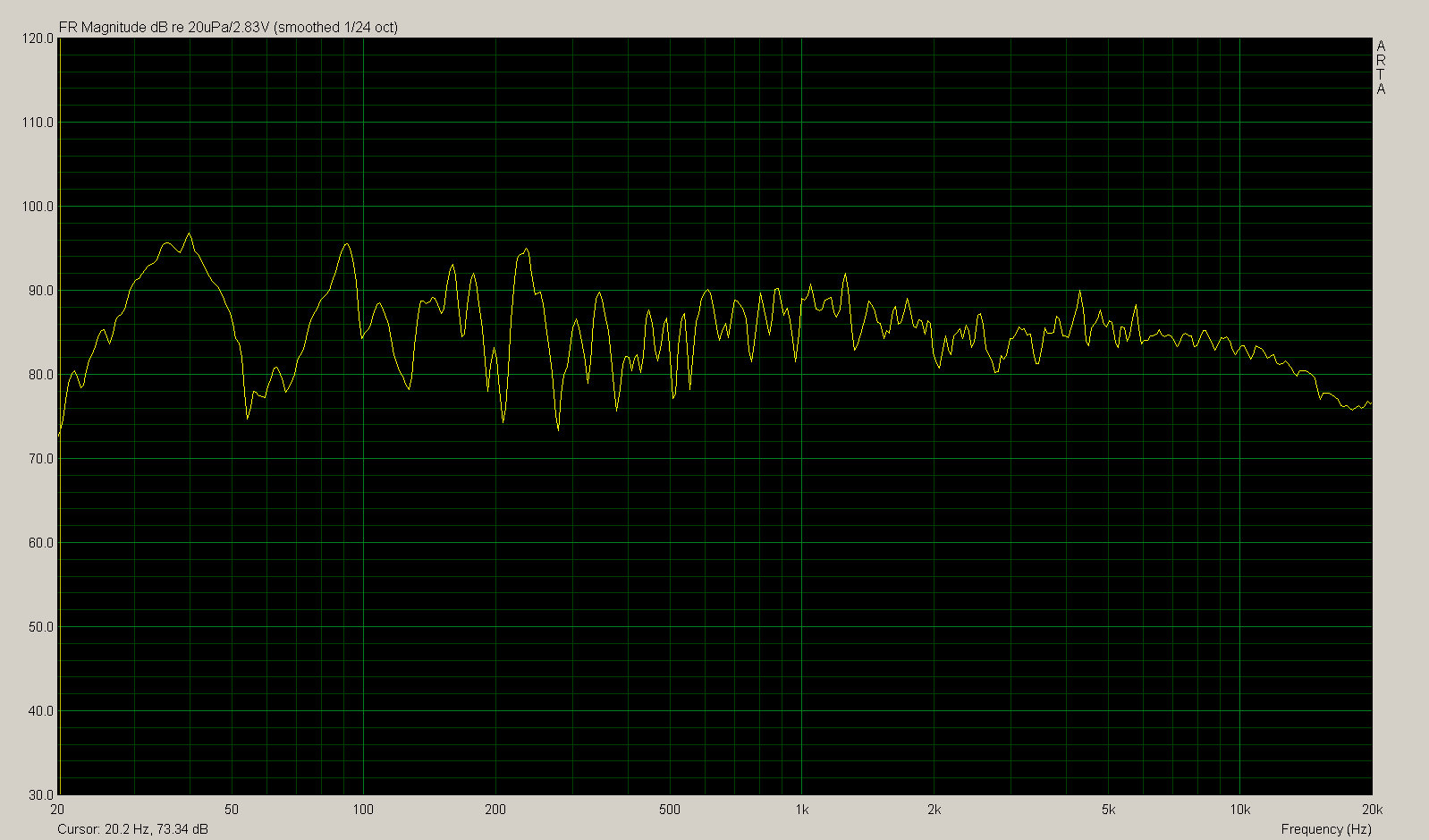

If it'll put your mind at ease, I'll attach an actual measured excess group delay taken in my roomI also worry that calculatons with deep nulls and phase reversals don't put error into the group delay. Since group delay is a differentiation it is prone to exageration of any errors in the associated phase curves.

If you remember the reverse phase L-R noise measurements we made a while back in another thread, here is the frequency response and excess group delay of the left speaker as measured at the listening position at the opposite end of the room. Both measurements are from the same impulse, and both use the full available window period of about 2 seconds - essentially steady state measurements capturing all significant reflections.
If you remember the listening position is also fairly close to the "critical" distance, and I think this is where excess group delay really starts to show up, since the direct to reflected ratio is low and there is more chance for summed reflections to exceed the amplitude of the direct path, especially where the direct path is experiencing cancellation from for example a front wall reflection. (I know for example that if I move the microphone position half way up the room most of the excess group delay spikes in the midrange disappear due to a much greater direct to reflected ratio)
