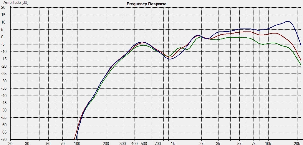

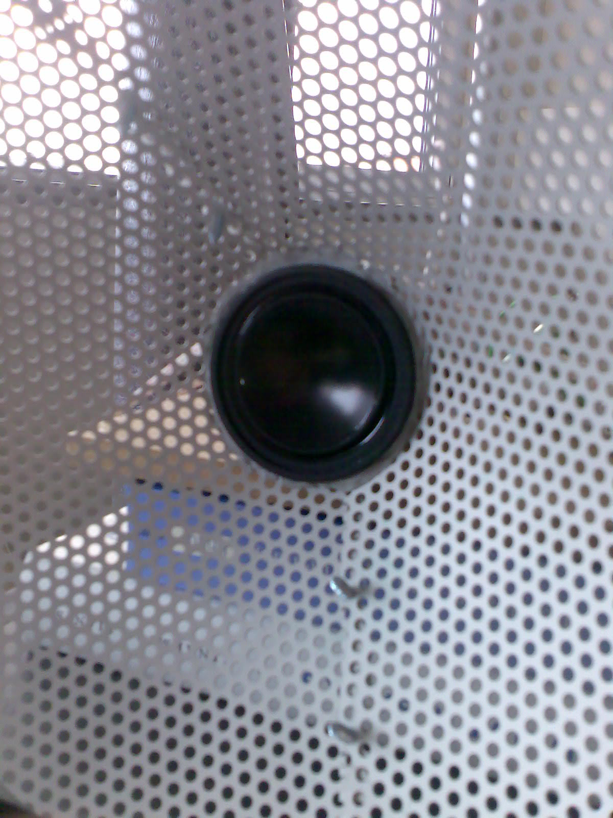

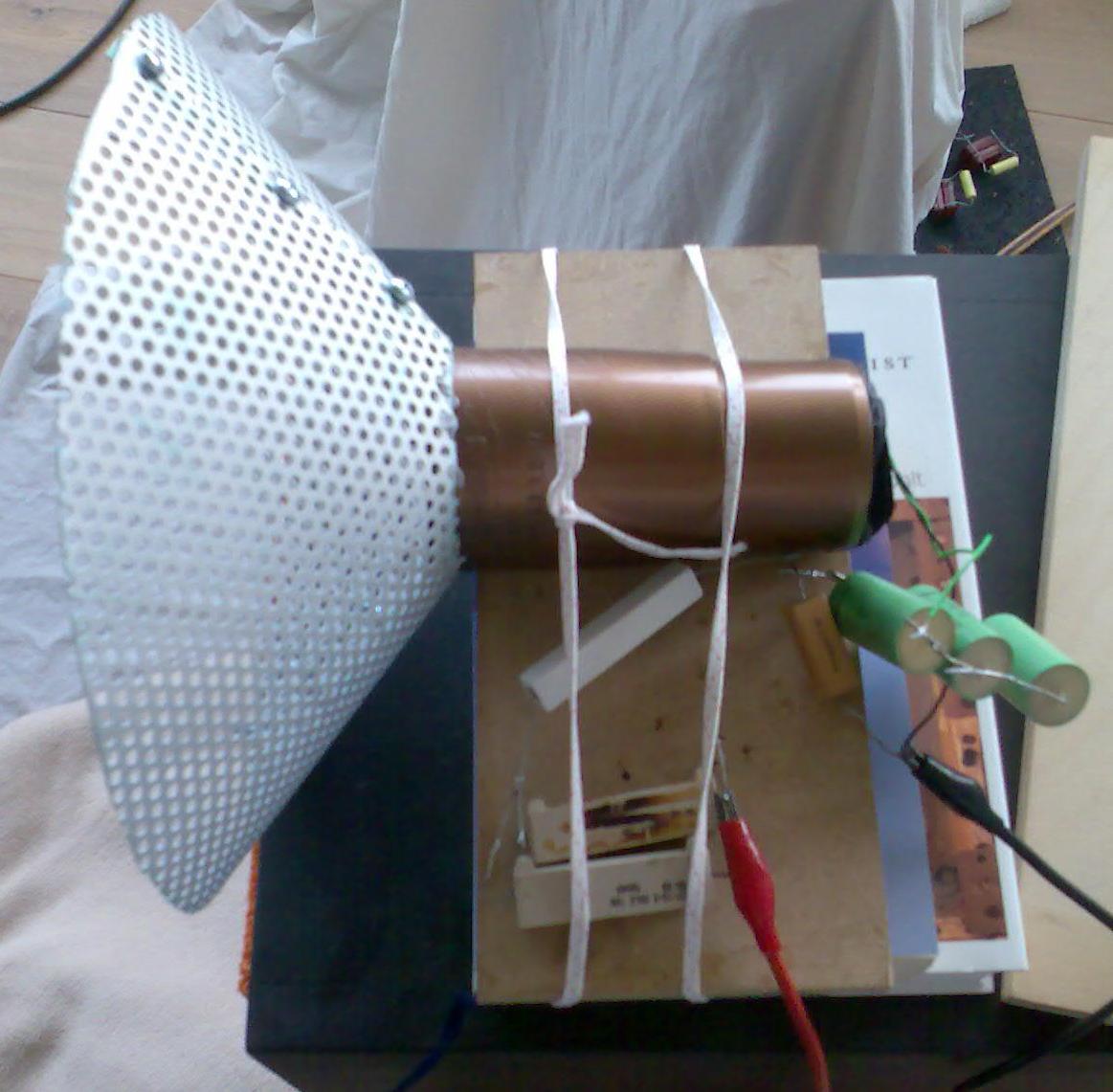

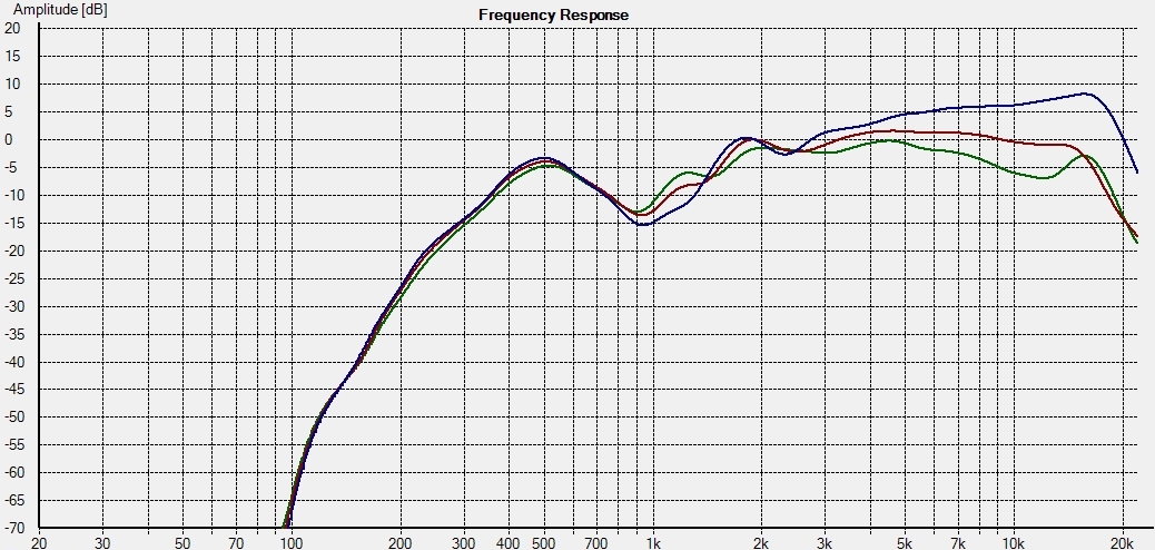

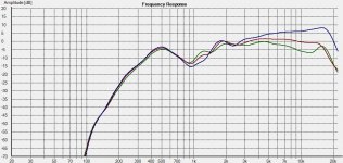

some kind of "lossy" or "defracting" WG i made two
years ago as an explorative prototype, which may
read more polite than "quick and dirty" ...
"A" is the driver in the stuffed tube without WG
"B" is with WG attached
As far as i remember angles were
blue: on Axis
red : 20 degrees
green: 45 degrees (quite in line with the WG's "walls")
distance about 0.7m
A very different approach from felt of course ...
but absorption could also be added in several ways
outside the WG's walls.
Kind Regards

It looks like your waveguide was essentially tranparent over most ot the frequency range. I'm not seeing much difference between with and without.
I suspect the same would happen with the foam walled waveguide. If the walls absorb or pass the sound it isn't a waveguide.
David S.
Hi David,
of course there is little effect below 3Khz, above there is a noticeable
modification of the directivity pattern.
The being effective is not just due to transparency, but also due to
length of the device compared to wavelength, like it is in a "true"
waveguide.
... it isn't a waveguide.
David S.
I am not sticking to terminology that much. Devices that modify
radiation patterns by diffraction or delay paths are also often
called "lens" or "diffusors" depending on what the functionality
seems to be mainly.
In ultrasonic devices e.g. arrangements of rods in the soundfield
are used to achieve focussing e.g. . Of course such arrangements
are usually optimized due to a specific frequency.
In this case especially the near off axis angles show less divergence
and i think if someone achieved a comparable effect using a different
approach, it would be regarded as kind of "noteworthy".
My internal name for that would have been "PerfGuide", not derived
from being "perfect" but from having perforated walls.
The arrangement can be modified in several ways, absorption of the
diffused radiation from the walls outer side is one of them.
But also "nested" spheres having variing transparency are possible,
to have a diffuse portion of radiation,which is angle dependent.
However i posted this as a present or inspiration to the community,
and whoever likes trying it as a base approach in modifying certain
driver's dispersion may do so ...
Btw. in that test speaker the tweeter was crossed in at about
2.3 Khz.
Kind Regards
