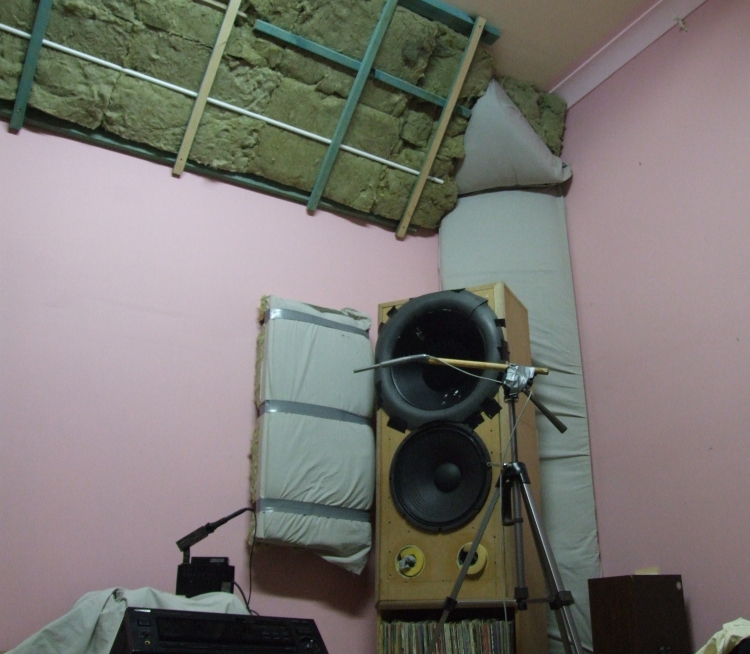

This is an old photo, but the front wall is on the left. This now has heavy curtains covering the entire wall, and light ones in front of the speakers. I have mats on the floor, absorbers similar to the front wall ones strung up to the ceiling points on temporary mounts, and I am trapping the contralateral points because they are just too similar in distance as the ceiling.
Which clutters the readings, as does the first horizontal which sometimes seems to boost the low end up over what I'm trying to see.
What I'd like next, before I set up with a ceiling diffractor is to damp heavily beside and behind the speakers. The way I see it is that too many reflections are too similar. The floor, side, rear and combination pairs of these three messing up the lower midrange.

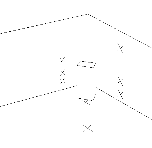

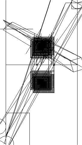

I traced a good ceiling treatment location and density. I've changed speaker locations a few times so I decided to start from scratch and add some synergy into the absorption scheme this time. I traced out woofer reflection points for primary and secondary reflections and compiled the data based on delay time, the angle the speaker produced it, the order of the mode, and which ear it arrives at.
There was no need for a single absorber solely for the tweeter. Only the floor and ceiling actually needed one but I already had absorbers there. These are mostly for 200-1kHz. What surprises me most is just how compact and ordered they are compared to when I apply treatments as a 'reaction' to observations.

Allen, did you also look at contralateral reflections? I found 2nd order and even 3rd order contralateral reflections to be pretty high in level, especially when using toe-in.
The first contralateral points are met by close to the zero degree speaker axis. These were some of the longest reflections though and although I'm not confident of this, I decided not to fuss over anything longer than 15ms. I figured by that time it may be more diffuse, and probably doesn't matter as much anyway. Besides, anything that is in its third cancellation by around 150Hz is probably best dealt with by bass treatments instead.
I was luckywith most of the earlier contralaterals. The direct one is diffused by furniture. The near then opposite wall reflection almost coincides with the first near wall absorber which I just have to make a little larger. The opposite wall/floor bounce coincides with the opposite side floor absorber, and the opposite side ceiling reflection absorber might be unsightly so I'm going to ignore it for now

I would also do some ETCs and verify the reflection direction by putting a absorptive panel at the reflection point on the wall. Sometimes one finds reflections from surprising directions.
This also helps evaluating the strength of single reflections. The more one reduces energy of first reflections, the more perceptually effective single reflections become.

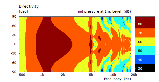

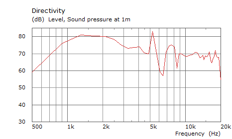

What happen if you build a Lipinsky like cavity with wood instead of foam, that is with a fully reflective material instead of an absorbing one. You get an absolute insane waveguide. Yes, but how bad is it really?
That's what i have tried to simulate with Axidriver, and this is what i get.
The response is clean enough till aprox 5khz and behaves roughly as a conical WG. Above reflections destroy everything.

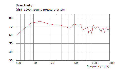

My guess is that if we use foam instead of wood, absortion will clean the response in the last octaves, while the waveguide behaviour will remain under 5khz because absortion will be less effective at lower freqs...🙄
