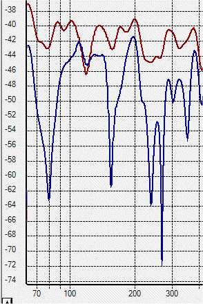

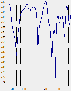

I need something a little more substantial in my case. That's the ceiling at 80 and 240. It is somewhat omnipresent though and partial absorption is liable to increase the depth of some of the nulls.
I doubt that a ceiling reflector will make that dip go away. It's probably modal and the common small and shallow absorbers will only help with reflection effects on localization and spaciousness.
In addition, nobody stops you from using a much bigger absorber hat. I think absorption is more effective at the source. It's hard to tame sound waves once they escaped into the wild, i.e. the room.
The hat would also be difficult because the woofer is 70cm below the top panel. I also need to keep absorbers free of the room lighting and casting shadows, or move the lights.
These nulls change frequency in proportion with the measuring distance.It's probably modal
With several inches of absorber and some sub into the mix, it is doable. (Better than shown, I've overwritten the more recent shots in Holm)I doubt that a ceiling reflector will make that dip go away. It's probably modal and the common small and shallow absorbers will only help with reflection effects on localization and spaciousness.
