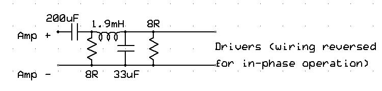

If anyone cares, this is the network giving me a nice flat bandpass response, 2nd order, from about 300-1k.
That looks like a very lossy bandpass filter to me, et. al.
Sims say I can pick up a bit of sensitivity by omitting the second resistor, but yes, it's a very lossy filter. That's the nature of the minimalist dipole beast, you have a slope built-in that starts with the cancellation, about 800hz in this case. The big coil knocks it back to flat within the passband which is primarily within the cancellation region, and introduces the lowpass where the cancellation ceases.
You could, of course, use a bigger baffle, but smaller baffle=more cancellation=more consistent directivity within the cancellation range.
My guess is it might be better to omit the second resistor and recalculate the filter for the resulting higher impedance.
the sims say (and pcd is accurate thus far in my use) that the shaping is barely affected by the second resistor, it's pure loss. Hence, gonna pull it out in the next round of testing.
