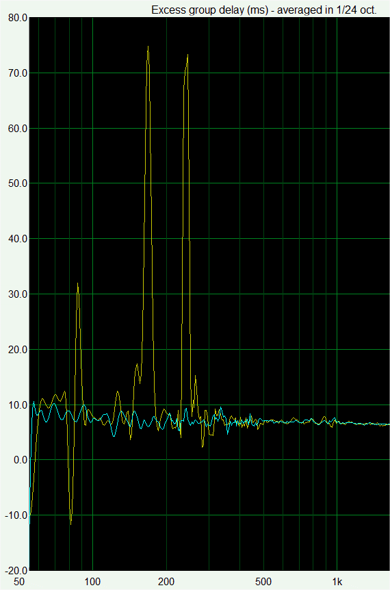

This time I watched each sub for how it affected excess GD. The process was very interesting particularly in disseminating the various first lower midrange reflections. Each making their own contribution at some frequency, adding subs can have the effect of improving the response whilst blowing out the GD. Cancelling out reflections can deepen a null and yet still improve the group delay.
I have a screenshot of excess GD below showing where I was when I tried another sub setup routine a few weeks ago (which I didn't like the result of), and what I came up with today. I avoided any sub making the GD worse on its own. Whether this is necessary, I could only guess.
The response wasn't to good but I felt I had reached a point with the GD considered. So I cursorily EQed (shown in Holm), and listened.
So how did it sound? (Well, I think you should find out for yourself.) I thought I could produce a kick drum well. Hmmm, kick drum stood in the way of nothing and nothing stood in the way of a kick drum. Even when outside of the listening triangle. But this was more, and this lower midrange work even affected sibilants, cymbals etc.
Not sure what you mean by cancelling out reflections, in this context. The nulls are generally caused by boundary reflections, so removing the reflections (not sure how you would do that physically) would reduce the null.Each making their own contribution at some frequency, adding subs can have the effect of improving the response whilst blowing out the GD. Cancelling out reflections can deepen a null and yet still improve the group delay.
Ok so I'm assuming that in the first image the setup that you previously didn't like the sound of is the overlay in yellow with the large spikes in excess group delay, and the cyan response with quite a flat excess group delay is what you've achieved with your most recent reconfiguration ?I have a screenshot of excess GD below showing where I was when I tried another sub setup routine a few weeks ago (which I didn't like the result of), and what I came up with today. I avoided any sub making the GD worse on its own. Whether this is necessary, I could only guess.
By the way I'm not sure what the significance of the negative going spike in your excess group delay is, in theory (?) excess group delay should always be positive relative to the overall baseline, since its a delay, so there could be a measurement error involved there, perhaps related to windowing of the impulse. All my excess group delay measurements have positive going spikes with a flat baseline except below about 30Hz which is probably due to insufficient FFT sample length to obtain high resolution at very low frequencies. Selecting a longer FFT length might help you there.

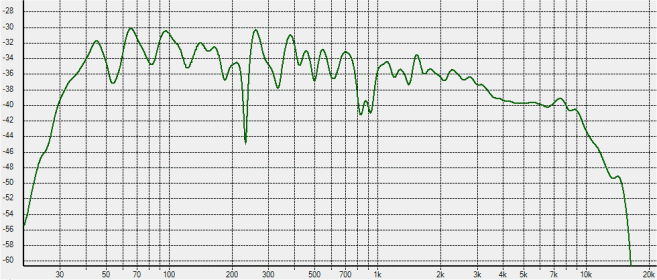

The new sub arrangement did help with the 240Hz reflection. The subs are crossed lower than that but still having an effect. you can see in the Holm plot that I didn't force the issue.
It seems that there are so many sources for these reflections (if you count each nearby wall, etc. etc), and modes, that if you try to target one particular frequency (for example) the end result can be a little hard to predict without trial and error. Not that it's an issue, just interesting.
I'm not certain about the negative going spike. I did truncate at 50Hz because I have mains issues with this sound card. Most of the excess GD seems to be at 7ms. I thought this odd so I plotted the woofer and tweeter individually and found the result to be different for the woofer than the woofer showed when plotting the whole system. From this I made some assumptions and stopped worrying about it.
I wasn't using windowing. My direct sound is somewhat dominant. The plot is low on resolution so as to show the GD spikes from my previous arrangement.
As far as preferring no GD spikes over a flat response, this is somewhat true. I've obsessed over a flat response in the past, and maybe it's essential at the other end of the spectrum. I could hear the unevenness of the response but it didn't seem to matter much. OK, it wasn't a good thing but it was educational to see how much it actually mattered today. I've produced bad sounding flat responses where the flat response itself was a good thing, but it wasn't enough to save the sound.

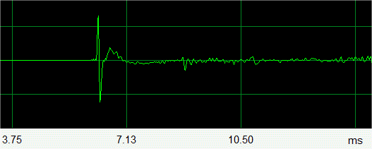

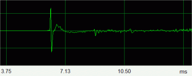

That's only frequency response data, so we have no idea whats happening to the phase / excess group delay and whether the multi-sub result is closer to minimum phase or not.
Do you still have the original impulses that you could generate excess group delay responses from ?
You can have the IRs as WAV or FRD if you like. Just let me know.
