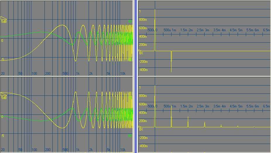

I was able to find some old picture left over in my photobucket.com account:
Shows the reverse function's FR and impulse, as I tried to describe above. Sorry, my quick writing was not very good, this picture should be better explaining. The correction filter's impulse keeps decreasing and decreasing but it won't end, but there is always noise floor after that it can be considered to have ended. But in theory, you don't have noise.

In terms of the math side of it, for the simple case of circular baffle, the diffraction transfer function becomes
1 - A e ^ (-d s)
where 1 is the amplitude of the original impulse, A is the amplitude of the echo, d is the time delay of the echo, and s is the s variable of the transfer function, ^ is power symbol and e is the natural logarithm's e number
The above has zeros at (just did quickly on paper now, so could have mistake but it is something like this):
s = ln (A) /d + j k pi/d, where k is an integer, pi is the pi number
So if A is greater than 1, the real part ln(A)/d becomes positive making it non-minimum phase, and vice versa.

Beating the dead horse probably, but wanted to point out something important in the above equation. The minimum phaseness of echo system (or diffraction which is echo with negative amplitude) has NOTHING to do with how much delay is involved.
The amplitude of the echo determines it.
I think there may be some conception that short delay would be minimum phase, long won't be, that is just not that way.
