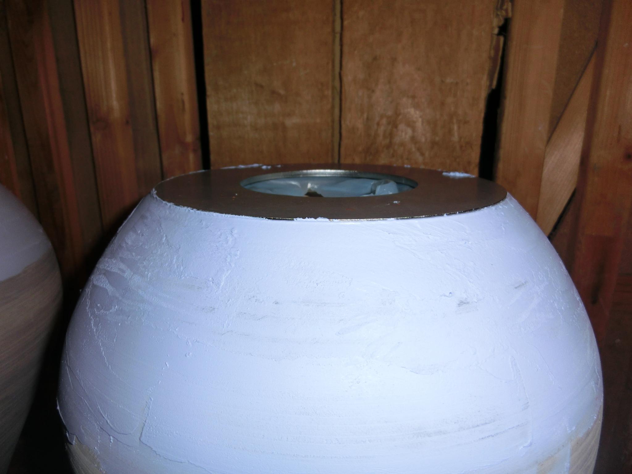

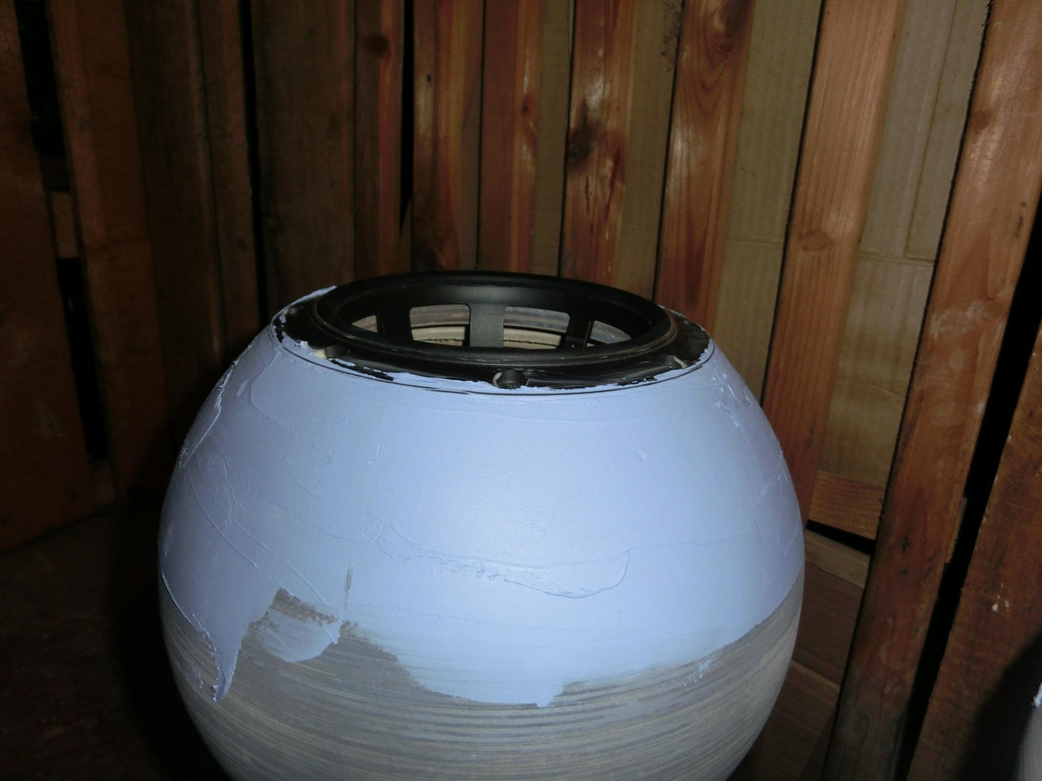

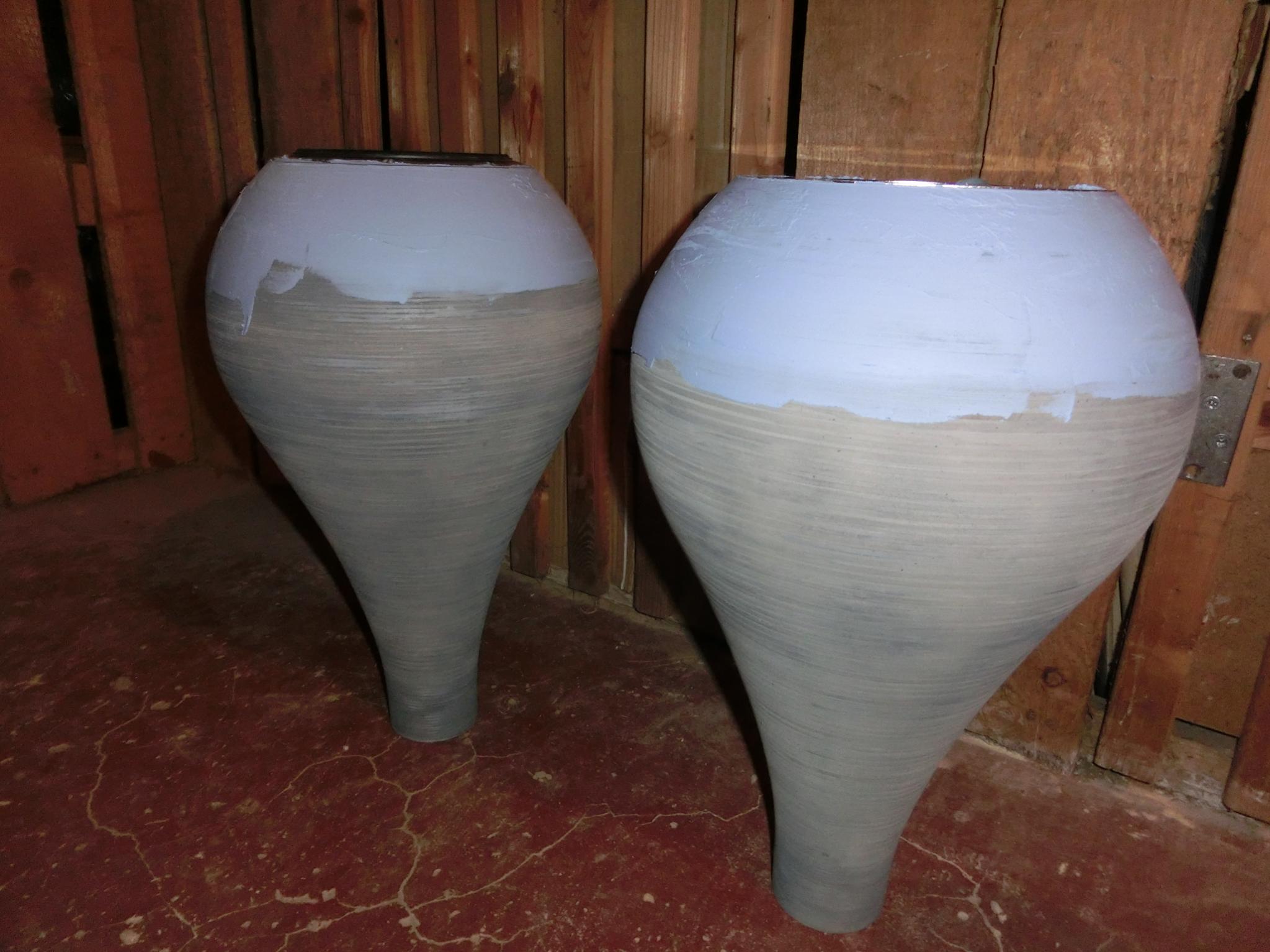

Right, applied first coat of body filler, two different approaches.
the one with the stainless steel ring has a thin plastic around it to prevent the filler to stick to it.
the one with the driver basket has a coat of cream (for better lack of words - hand cream type thing) applied to prevent sticking...
let's see which one works better 🙂
Danny

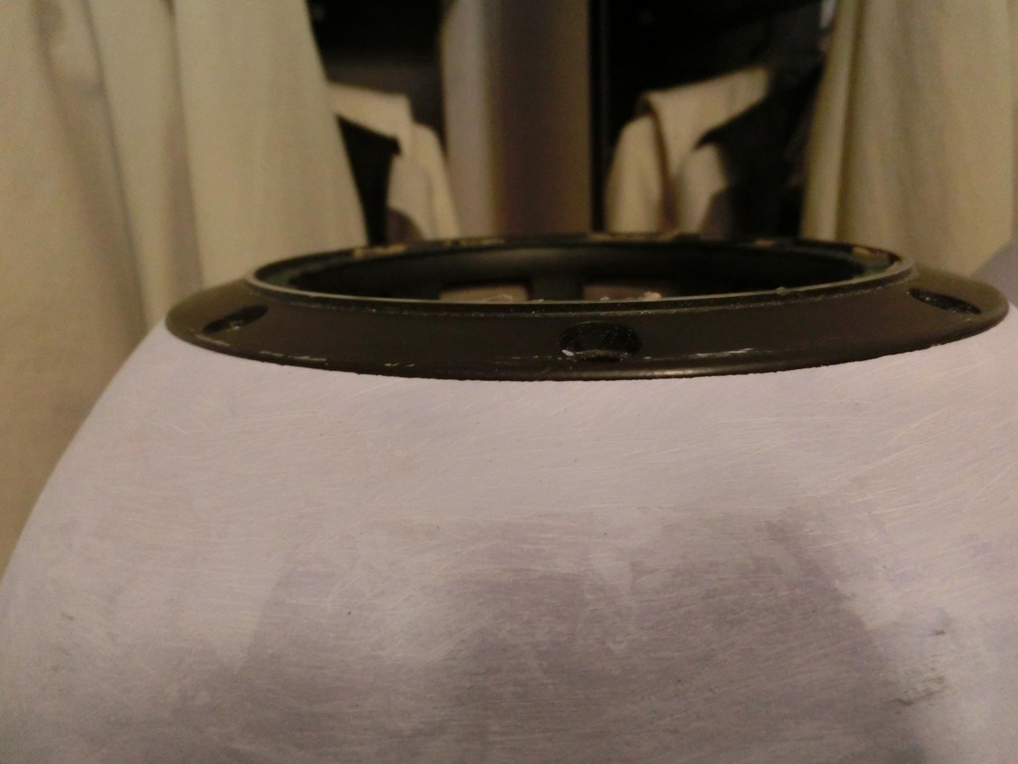

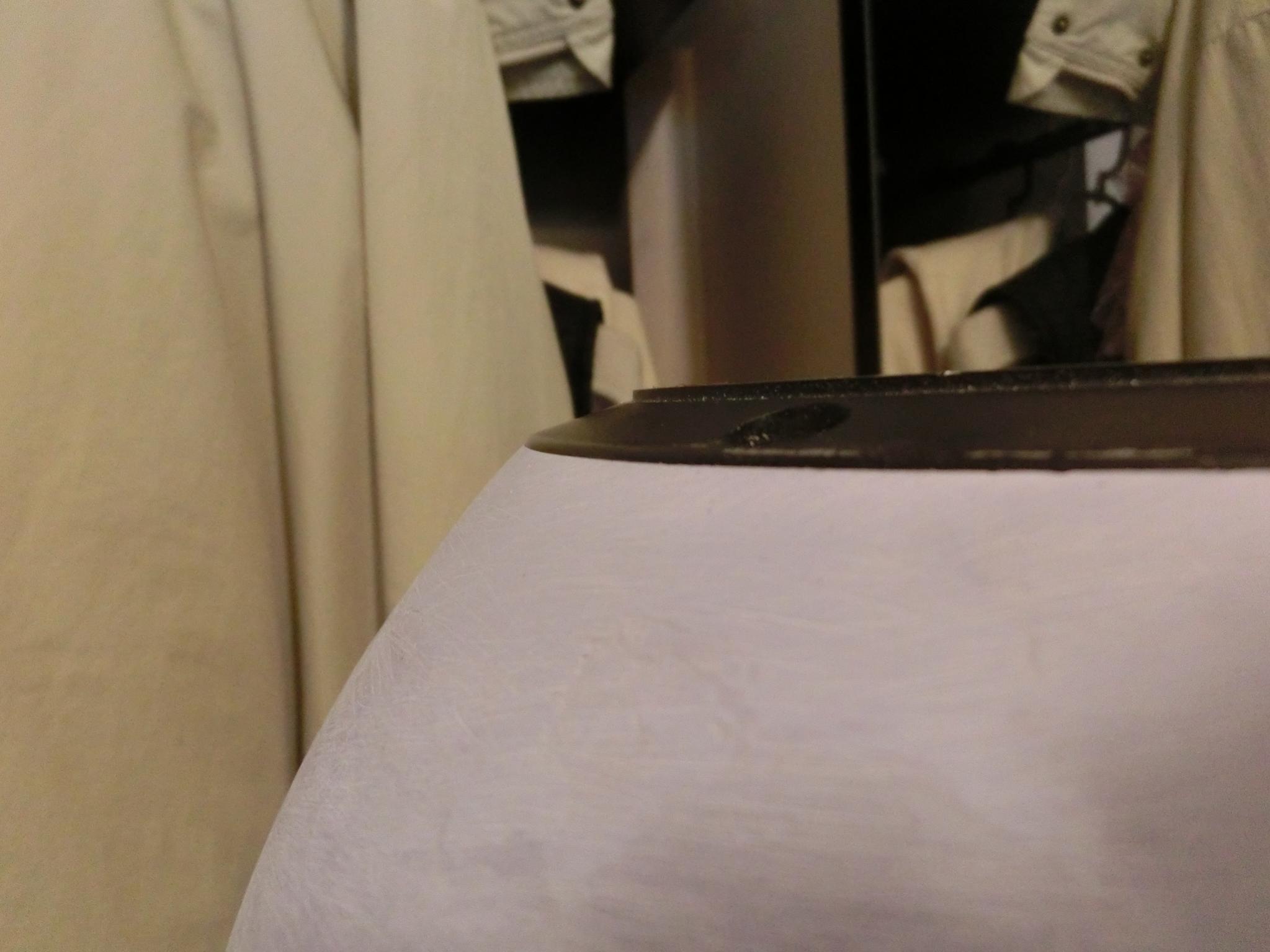

Small update before yet another business trip (oh god why do we have to work 🙂 )
After a lot of filling and sanding I am pretty happy with the transition from the driver to the enclosure...still needs some touch up here and there, but nothing serious. The other enclosure is completely covered in body filler and ready to be sanded. Unfortunately, after the job.
Hope to have them sanded in time of X-mas (the time when my monoblock EL34 amps should be ready 🙂 )
Danny

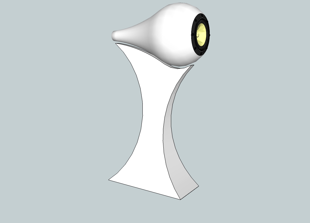

P.S.: Included is the pic of my wifes STAND design 🙂 comment is appreciated

I was a bit busy this afternoon with the troubles that happened with my own enclosure but I wanted to comment so here I am: Love the results on this enclosure. Looking very good or better yet: smooth at the transition.
As for the stand: It looks good, I like it. Be sure to have a wide enough stand, your speaker will be top heavy! How do you like the proposed stand yourself? I like this one better than the arc. (no offence ment to Derek 😉).
I did notice I was still gleaming at a way to use the space occupied for a helper woofer (lol). That won't work with this one but I am kind of curious about a measurement from the sphere. How low does it really go? What could you be missing frequency wise....
Maybe, just maybe it plays low enough to bring in a sub and not miss too much.
Hi Wes...are you in netherland? I travel there regularly to Boxmeer and sometimes Amsterdam 🙂 we could perhaps meet for a beer...
Well, I plan to use a woofer in the stand at the bottom, projected volume should be about 30L, bottom dimensions around 340mm wide and 550mm deep. There is a plinth and the bottom missing, about 75mm high 🙂
I like the stand a lot, the one my wife designed, she has an eye for aesthetic....

Good to hear you're planning a helper woofer. that should help out/relieve the Fostex somewhat. Is it meant to be a passive wired helper woofer or do you plan on giving that woofer a little more power than the 4W monoblocks?
I agree with you on the stand, good eye that wife of yours, hang on to her! 😉.
