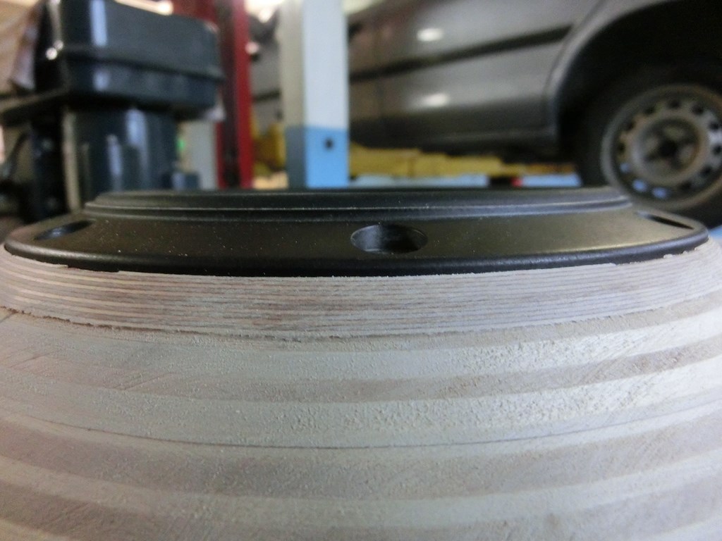

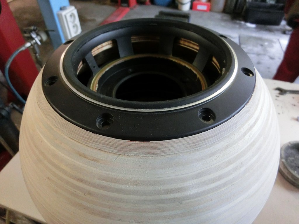

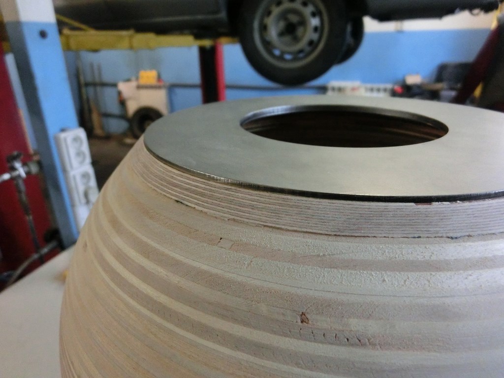

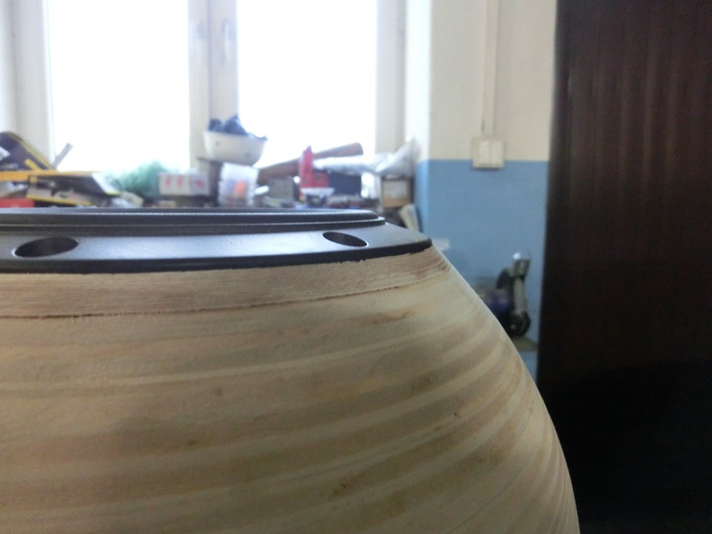

I would suggest that the front edge is 'just right' for the driver/chamber mounting and just rebate the front edge of your 'teardrop' around the mounting flange to form a 'seamless' line - sometimes when adding dress rings, protection grills, etc, the effect is a creation of unwanted peaks/interference leading to a deterioration that is a most unpleasant surprise.
It looks like the manufacturer already has this in mind when they formed the front edge profile - perhaps you can just carefully 'BMW it' if you want it to be white.
Hello Hesener
hope to get some work done after this business trip. Work life is killing all my hobbies. I made up my mind on the transit from driver to the enclosure. I made up 6mm high ring, and will make a 45 degree chamfer on it. And if I am not happy, I can always put the Alu ring on it, as it will be a chamfer.
hehe BMW paint...sharp and fast...I like that.

that is what I am about to do. With the 6mm chamfer, I will create seamless transition from driver to the box. The chamfer will be 45gedree, 6mm wide and 6mm tall. I think its not that bad
Hesener:
The form would matter to me, it would look unfinished, if you know what I mean. It would bug me every time I look at it.I want it to look as professional as possible.

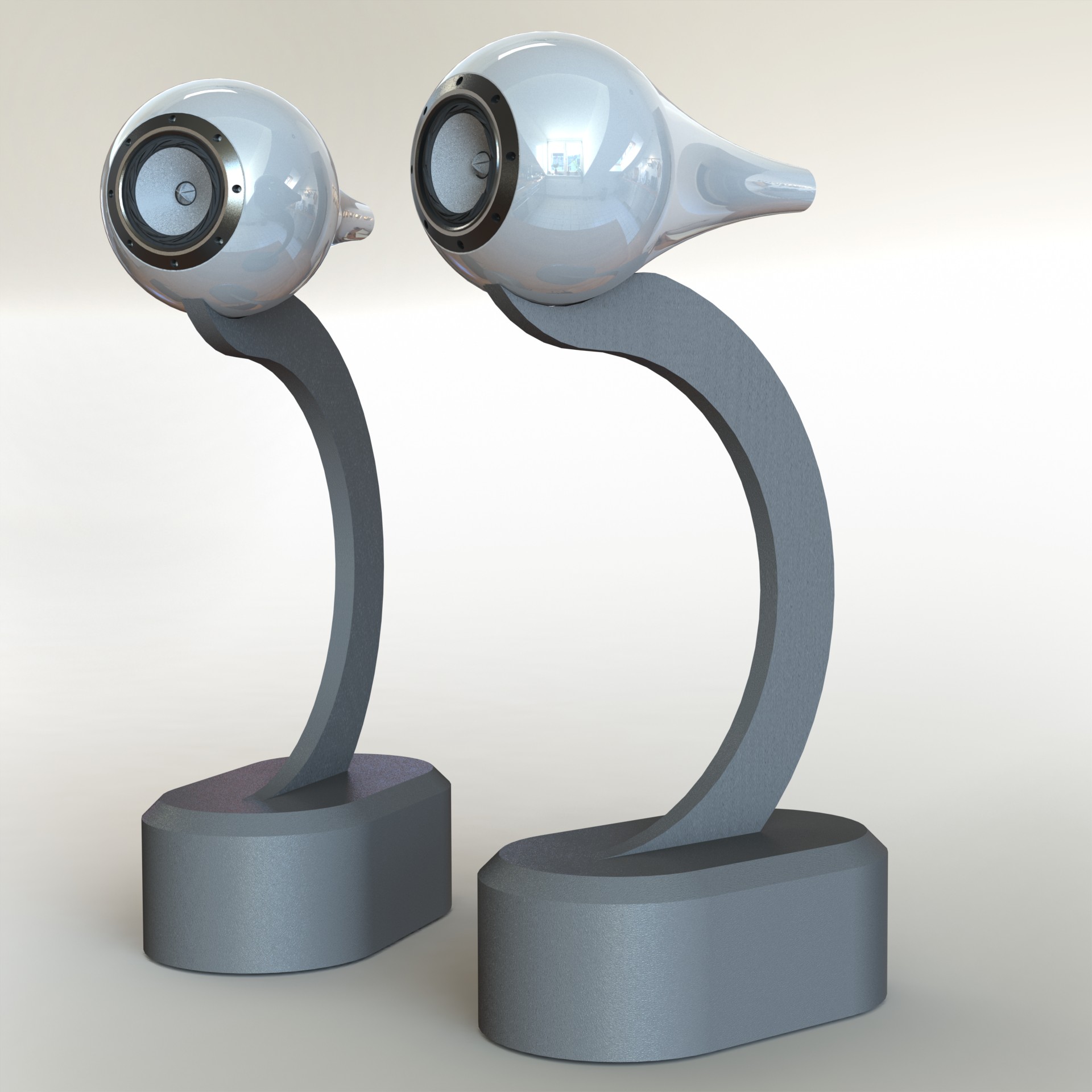

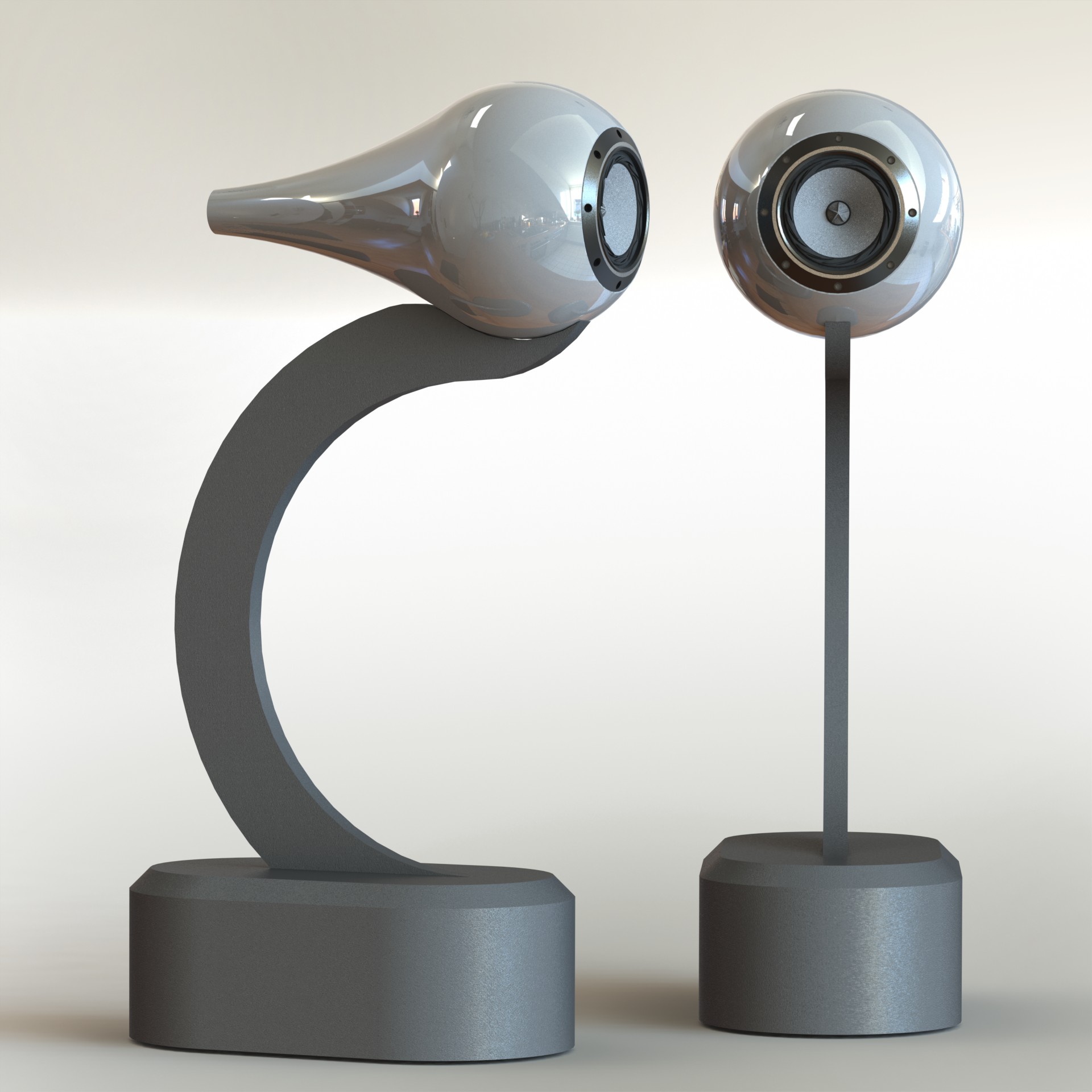

One of the forum guys (I will not mention his name just to prevent overflow of requests in his PM box) did a CAD rendering for me.
I cannot say how much I appreciate this gesture. It must have been a lot of work.
Thank you R.S. for your help. Gave me a great idea about the speakers, they looks, and also bumped the WAF considerably 🙂
Danny

That is really really beautiful work... I admire it. The significant better half tells me now that she has seen it she will permit me to put them in the living room 🙂
Every time she had a look at the raw enclosures, she said they are either a vase or Bee hives :S imagine that....

yes separate. you have any thoughts on that? I came up with some curved stand with good inside volume (has to be calculated when finished i.e. fill with water to see how much). i know this is not the proper way to design, but I think any volume above 12L will provide enough bass for the small apartment room, and in that case any woofer able to play in that volume down to let's say 40-50Hz. All I really need is a little help at the bottom, nothing more.
Also the leg/stand/woofer section was my wifes idea, I let her have a part in this. She made compromises when it came to furnishing the living room, in exchange I let her design the aesthetic side a little bit 🙂

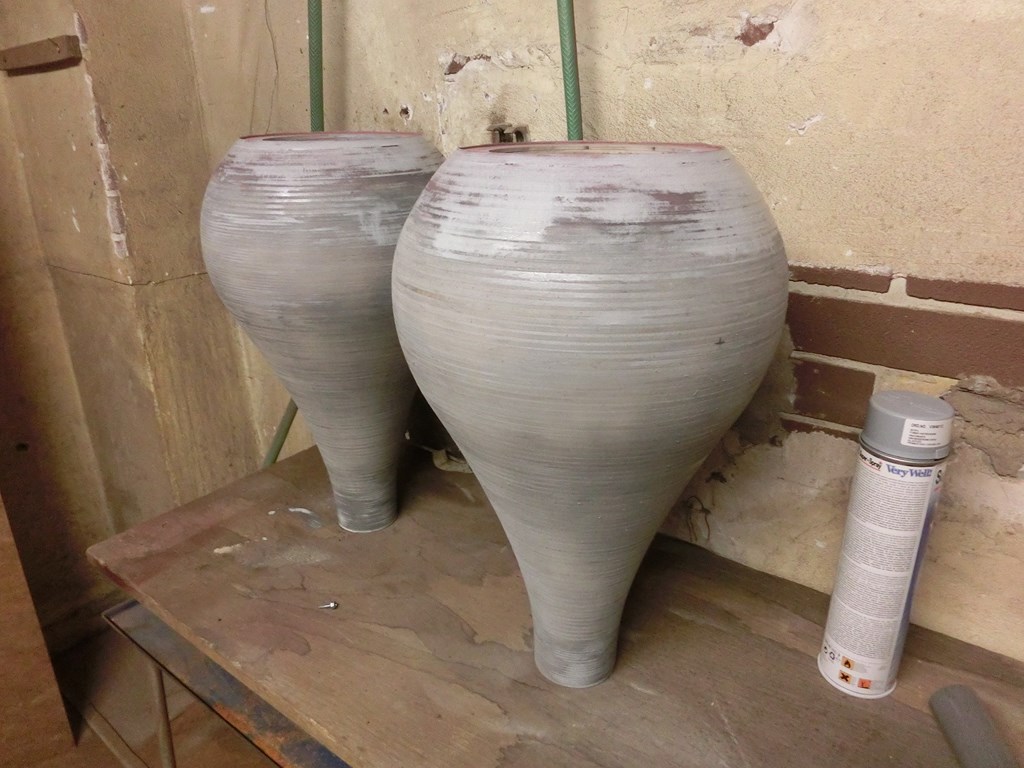

Yes just driver and enclosure, no damping or anything. Just took them out today for basic primer, then comes the fun part - filler and a lot of sanding 🙁
Will post some pics if people want to see them
I had it running through Onkyo receiver. I was surprised how loud they get and how little excursion is involved. I am playing with the idea of closed box, and then the helper woofer at the bottom..... will do some more testing when sanded down.

Hi Wes, yes that was also my previous drawing, an idea about the stand. However, after some tests with 12" drivers I concluded that anything above 8" is too much for this apartment house. It multiplies the bass in other rooms to great extent...
So in the end I will be using a stand that me and my wife came up with, esthetically and functionally pleasing 🙂 for both...
