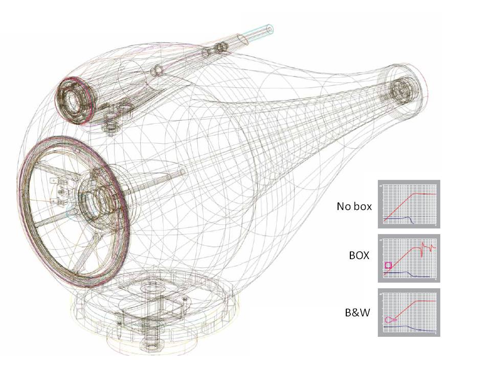

Have you found any math to calculate the optimum volume and shape of the sphere and tapered tube? The B&W white paper describes work on math and experiments to find an optimal internal diameter for their midrange sphere, and the optimal shape of the rear taper to an open rear tube. B&W's open rear tube appears to provide a type of aperodic termination loading. I do not know if B&W uses any stuffing. I always thought that speaker transmission line theory could be used for this design. I would probably add stuffing only in the tapered tube with the goal of keeping driver dynamics with minimal rear wave reflections getting to the rear cone.
I think every midrange speaker has a different optimal size and shape sphere based upon the T/S parameters. I suspect most 1" dome tweeters could be installed in a common sphere+tube, and I have seen pictures a few tweeters in teardrop shaped rear chambers.
