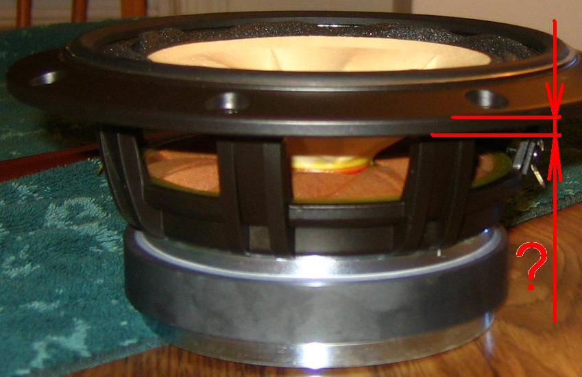

Guys I WANT TO ASK FOR ONE FAVOR FROM SOMEONE WHO HAS 168E Sigmas
I need to measure the thickness of the lip on the speaker front, marked on the picture...
O dont have the drivers here with me...

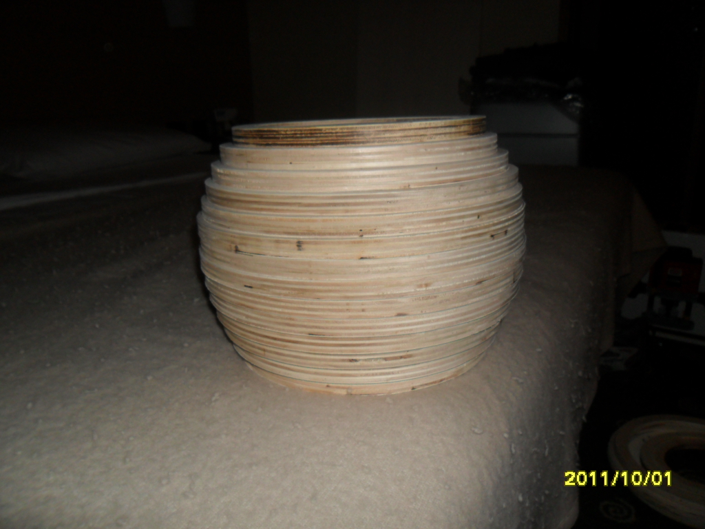

OK the wood is bought
Nice 3m2 of Russian (i hope) plywood 16mm thick, cut to 5 boards of 1.2x0.6m for transportation purposes. On some weekend will be the cutting done to many many rings....actually 72 of them
Can somebody help with the flush mount depth? I can remember it is something about 4mm but not 100% sure....

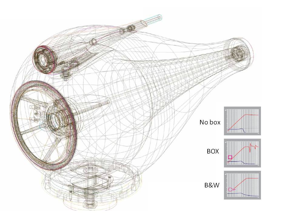

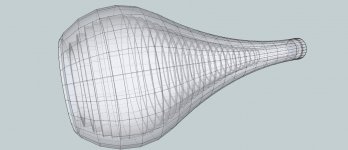

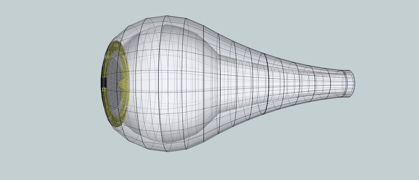

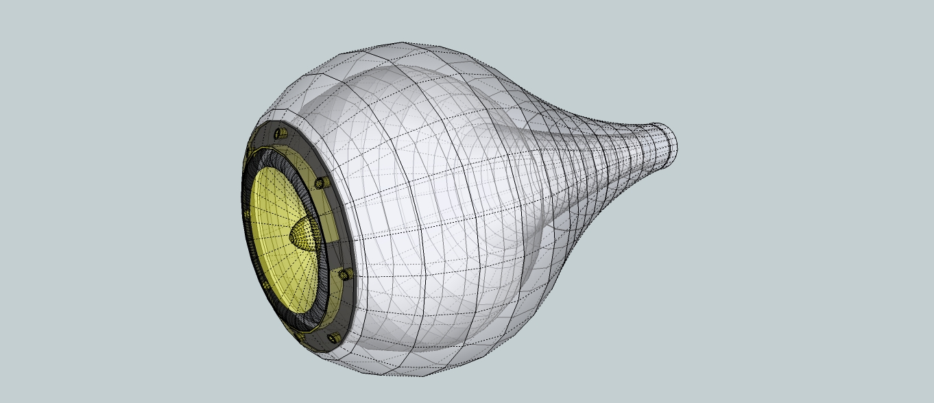

OK some updates:
- as per Planet10 (Dave) and his replies in other threads, I decided that the inside shape should be different than just scaled down version of the outside shape.
He suggested that it has as close as possible shape to B&W
- speaker cutout = inside sphere joining point to the tapered tube
- front half of inside sphere = back half of the same inside sphere
- closed enclosure, back part stuffed with some wool (tests must be done)
- the inside will be zigzag shape (?) because of the square nature of the cuts, but the space between the two cuts will be filled with filler. I am not sure if everybody gets it.
IF ANYBODY IS INTERESTED, I CAN SEND THEM THE CUTTING PLAN AND THE SKETCHUP DRAWINGS WHEN IT IS FINISHED. That means the sketchup contains all the measurements, so just take the sizes and off you go
I done a lot of reading on the B&W site, inspected the pictures, made measurements according to their drawings.... I hope it works
1pic=1000words:
1pic=1000words:

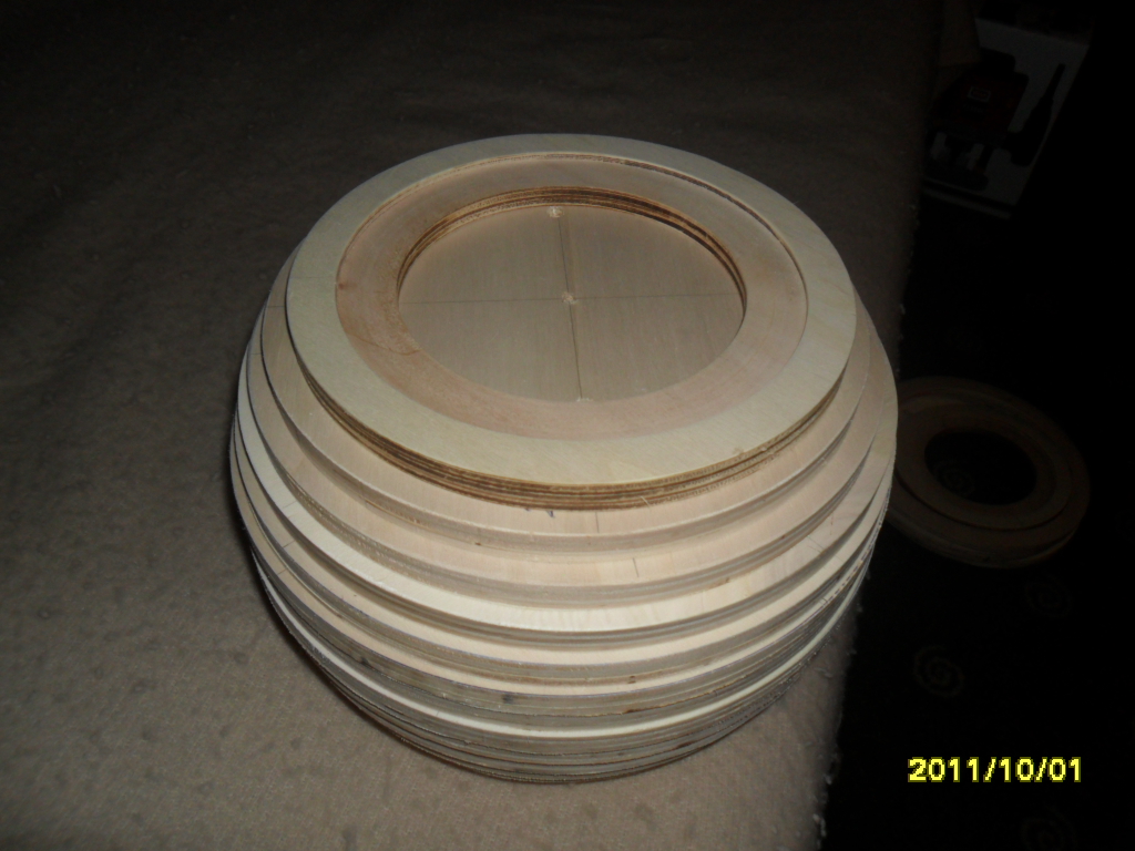

joe58:
the filler will be applied on each part as I go, so i glue and clamp first and second ring together, apply filler, leave it dry, then sand it. Then another ring, apply filler ....etc
Boris:
yes, its called wood lathe (although its made of metal ), simply rotates the piece very fast and you can use hand tool for hand carving. My friend has just a lathe like this.
During the work i will take many pictures, so you will se the procedure up close.
Danny
Boris:
Danny

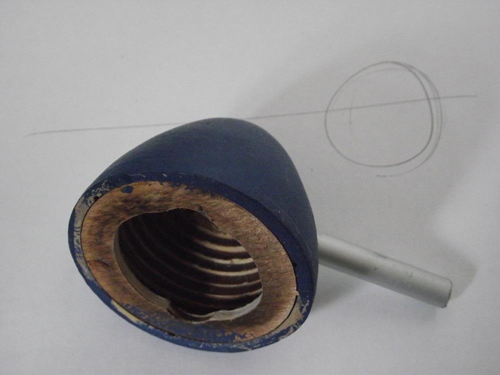

Yep I've done something similar for a year 12(17 years old for non uk peeps) project and I made these tiny(I had no idea of speaker building) curved enclosures. Lots of rings of ply laser cut and then wack it on the lathe. First time I had never used a lathe and found it very simple and therapeutic...
Edit: The image is part way through to being modified for something else, hence the new bit in the front and not finished.

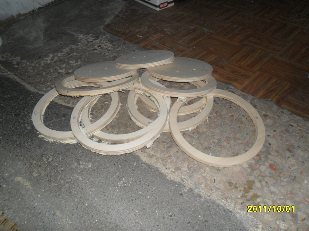

started cutting some wood
well, some wood has been cut. Although only 6pcs as the rain started and I managed to break the router bit (c**p quality, will have to buy good one).
cutting is actually very fast, the setup takes longer time then cutting.
Some pics:
https://picasaweb.google.com/101292885356793975790/BWStyleFREnclosure?authuser=0&feat=directlink
Some pics:
Well, still waiting for good weather and weekend so I can cut the rest of the big circles for the teardrops. As of now, I only have 8 rings from 68

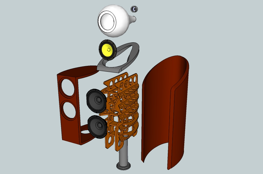

Getting back to basic design...802D clone that is.
The open baffles or ripoles would be nice and something unusual, but WAF kicked in, no space for them in my small apartment living room.
Some exploded view:
Some exploded view:
- Full Range
- FE168E Sigma teardrop enclosure
