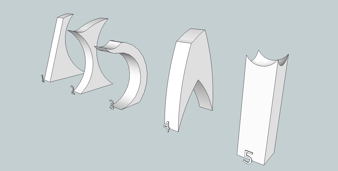

Hello guys.... I am really struggling with the aesthetics of the stand....
I will appreciate any suggestions you might have.... sketches, hand drawn or links to pics...
I am at the end with this, have tried many variants.... and I am not satisfied....
Anybody?

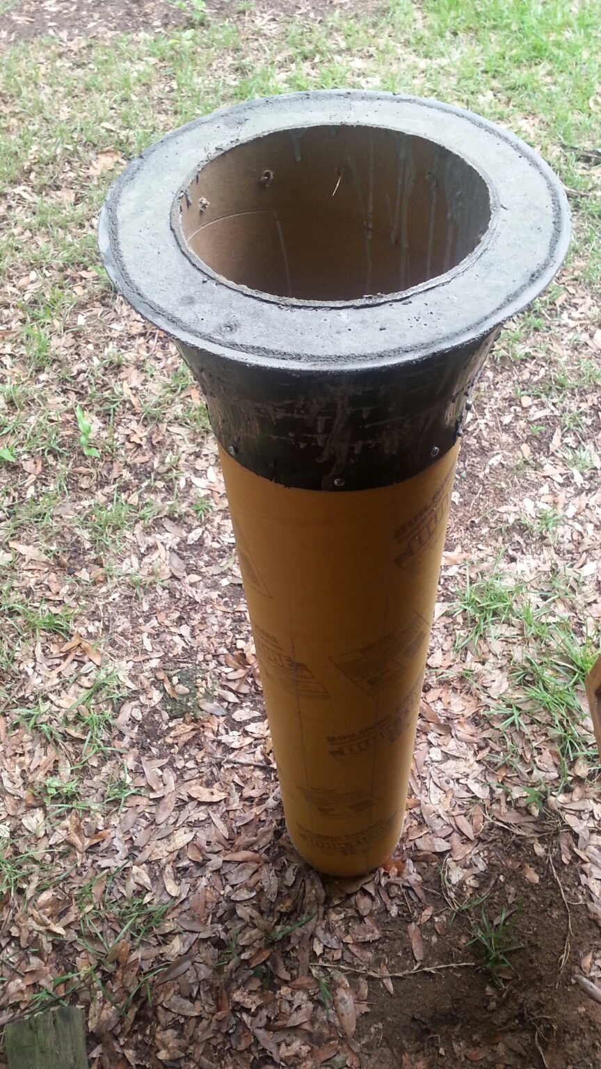

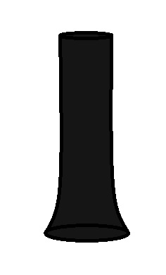

Im working on a small mtm on sub/stand. Im using 8 inch sonotube with a concrete flare to add weight to the base. I used a planter the flares to 12 inches from the 8 inch tube. I will be installed a down firing 8 inch sub in each for stereo sub sound. I will be wrapping the whole column in black grill fabric
Im still really like my oak railway sleeper and brass spike combination, gives an airy ness and lightens the mass of each object.
I toyed with the idea of using ikea parts like this to make it look a little Sputnik'y. But the cost seemed a litte high having to buy x6 of those legs
...but flipped around with a big base tapering to the thin point.

Hi, thanks for the suggestions.
Well I would like to incorporate one or two 6,5" or one 8" woofer in each stand, just to take away some bass duty from the full-range driver.
I had a look at some Scan Speak and Peerless drivers. I would like to avoid big speakers (apartment house).
Later I post some sketches, what you people think. There is one stand which would be about 14 liters, and also looks good, construction might be a trick 🙂
Danny
edit: stand shapes suggestions....
Danny
Number 4 looks familiar...
hahah right, that was actually an attempt to merge enclosures with Star trek commbadge shape (big fan) 🙂)))

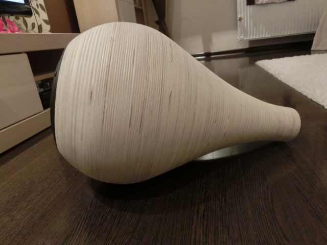

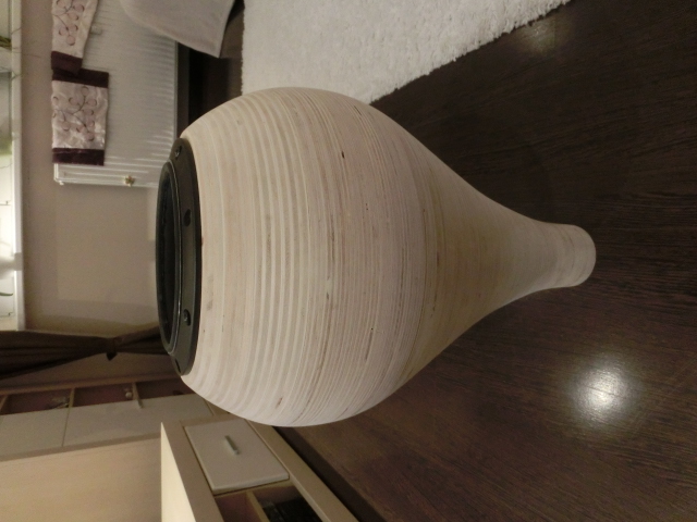

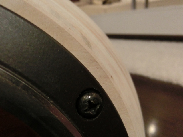

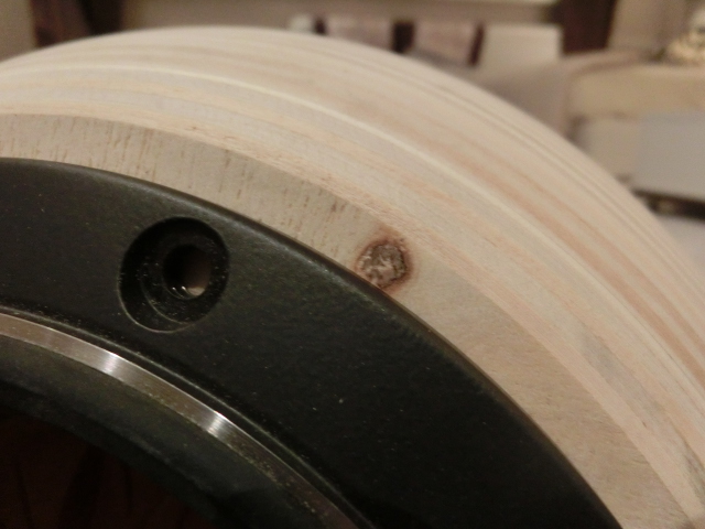

OK small update. Progress is slow, work permitting. Been to holiday and still have 10 days left at home, so I hope to make some progress. Enclosures sanded and smooth. But I have one big problem, aesthetic problem that is, well I hope its only aesthetic.
The mounting of the driver it self. There is a (how to call this) a bezel?
The area for mounting is bigger by 14 mm on diameter then the driver. I had an idea of letting it covered by some nice aluminium ring or finish it off to merge with the driver by using two part putty (body filler for cars).
Any ideas?
Danny

I'd opt for the aluminium ring covering it up. Anodise it clear or black, depending if you cover the entire mounting area of the speaker or a trim ring around it. Have you thought about a finish yet? If you go the putty way you'd have to paint the enclosure. And the wood is too lovely to cover 😀.

Yes I am leaning towards the alu ring, but have problem to find somebody who can make it for me. So I welcome any suggestions for a shop or private person who can make it. I travel a lot to Netherlands, but any country will do 🙂
The finish will be high gloss white...to match furniture

Sadly I can't help you with that, I don't have access to a lathe. I'm already glad I can outsource my aluminium baffles to a friend. Another option would be 3D printing? Not cheap though, but almost unlimited possibilities and a variety of materials available.
You could also have it turned in wood, have a small streak of walnut or something, but if its gloss white you want maybe an aluminium ring is the way to go.
Shapeways to 3D printing based on volume. It would cost the earth to have it printed in stainless steel, can use sketchup and it tell you how much the model costs almost instantly.
How about Home- Schaeffer AG - Frontplatten, Front Panels, Faces Avant , I worked with them a lot and (outside of what their software tells you) they can do all kinds of shapes...

hope to get some work done after this business trip. Work life is killing all my hobbies. I made up my mind on the transit from driver to the enclosure. I made up 6mm high ring, and will make a 45 degree chamfer on it. And if I am not happy, I can always put the Alu ring on it, as it will be a chamfer.
