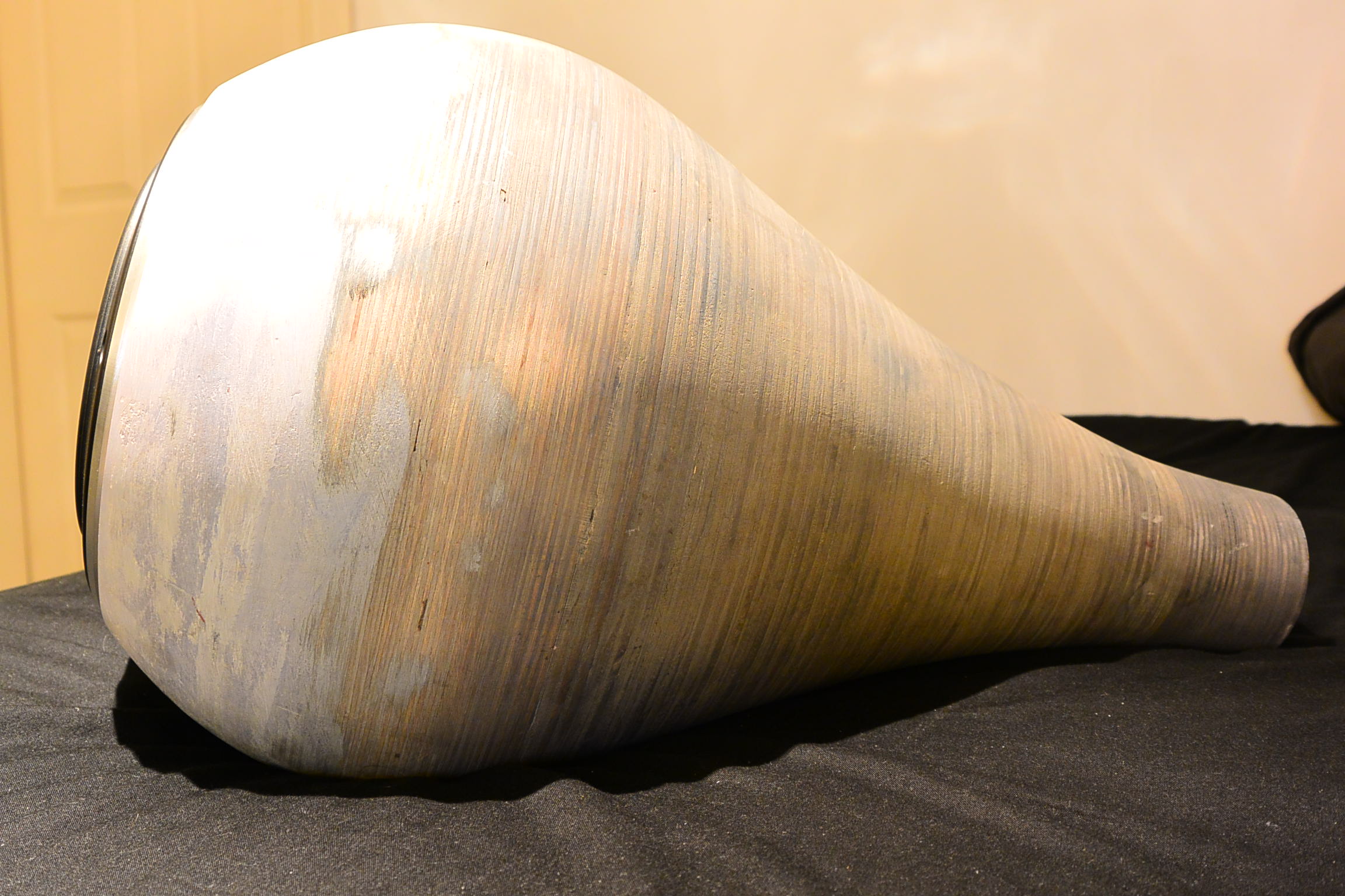

FE168E Sigma teardrop enclosure

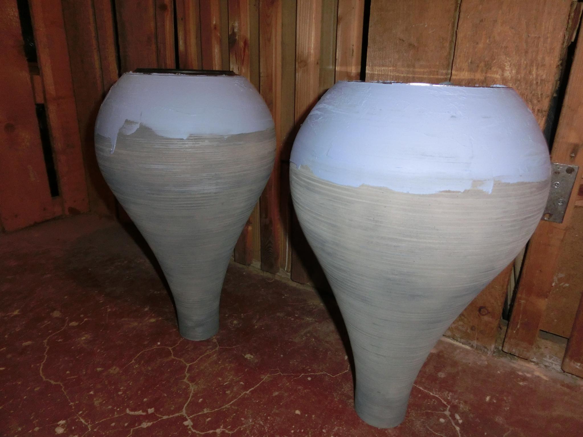

Hi Sippy, I coated the enclosures with epoxy first, second coat wet in wet was with the matt. The areas that were previously covered in PU foam sucked up much less epoxy from that first coat (although the PU was sanded down), that much was visible. While doing the weave coat I was too busy pressing out the excess epoxy with a bondo spreader to notice anything. It was my first time working with this stuff 🙂. After about an hour or so after that coat I packed the entire enclosure in household plastic foil.
Don't ask me too much, lol, I'm no expert on this subject.
Edit: This is the matt I used: http://www.mrboat.nl/glasweefsels/glasweefsel-300-gr-5-m2/
My information comes from that site:
Harsverbruik: 250 gr./m2
Laminaatdikte: 0,31 mm
Laminaatgewicht: 550 gr./m2
Im more inclined to use the lightest cloth available.and just one layer.Used to do this on sheeted wings for rc planes.Adds little thickness and strenghtens a lot.
Danny
Been there with OGY (Open Goodyear) c/l racers....
I'd go the same route as wesayso - 300g/sq m rather than 25 / 50g cloth as speakers don't have to fly.

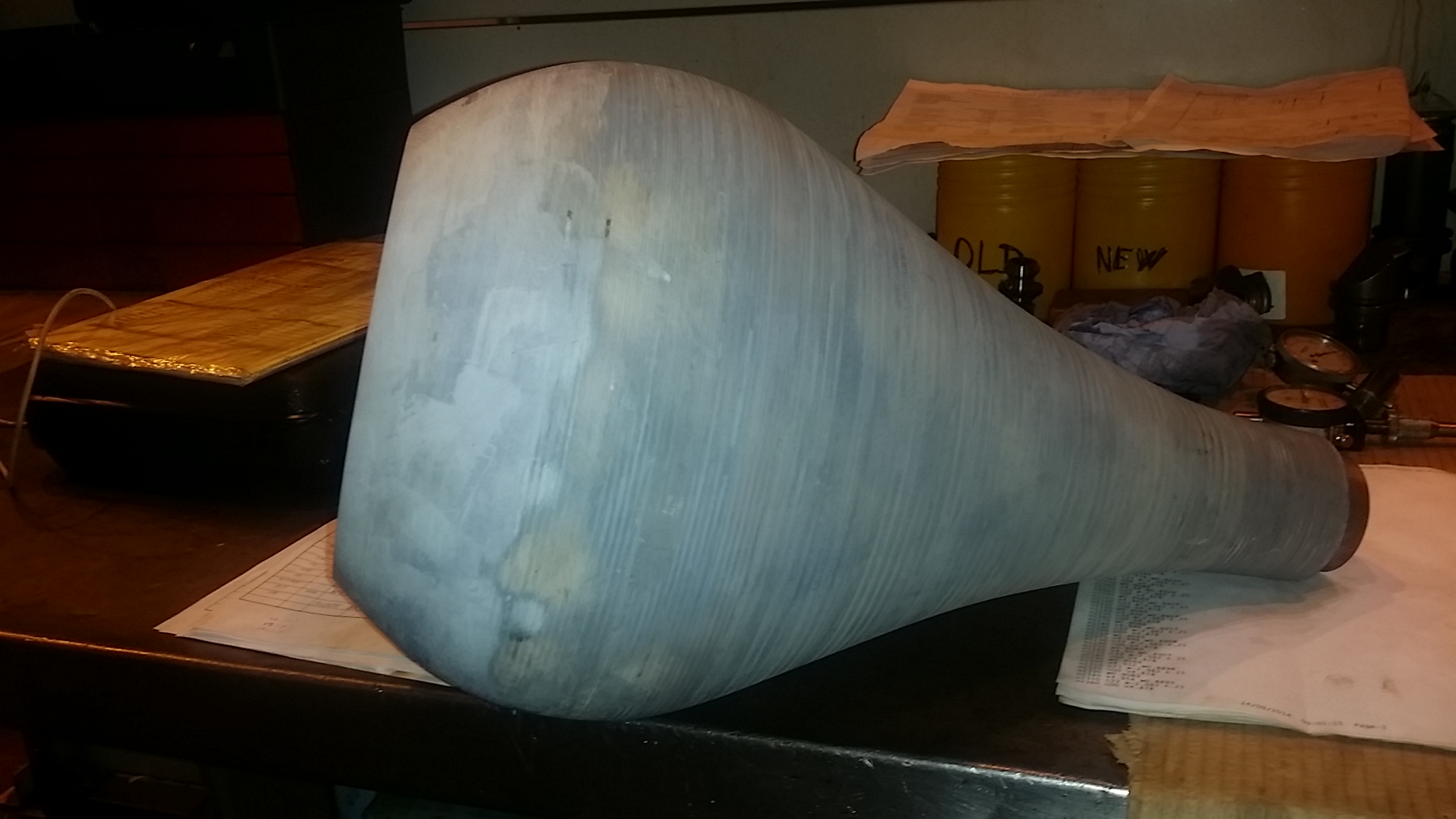

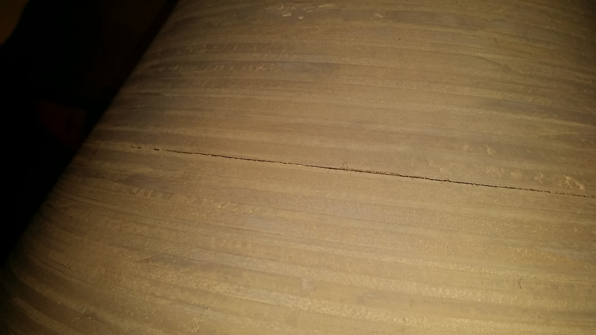

If you are going to glass these anyway, the easiest fix for the crack would be to wick in some thin superglue (cyanoacrylate) and clamp it tight for 24 hrs or so.
You might be able to force some diluted epoxy into there with a pallet knife, but it wouldn't wick in to fully stop the crack.
Humidity change is the cause.

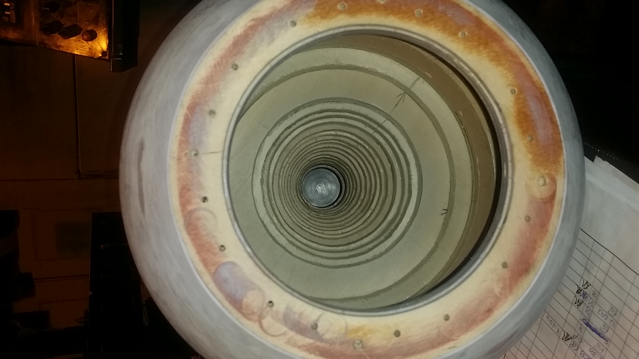

OK so going to fix the crack and then fiberglass.Then I will have to fabricate new mounting ring (previous one made by ShinObivan from DIY forum). They are good, but now too small.
I have to make them taller, the bottom diameter will be 210mm the top 190 to give some material thickness to work with. Here you can see the original ring and cut down length of enclosure again.
P.S.: I'll probably use Dynamat for the internal smoothing of the steps.

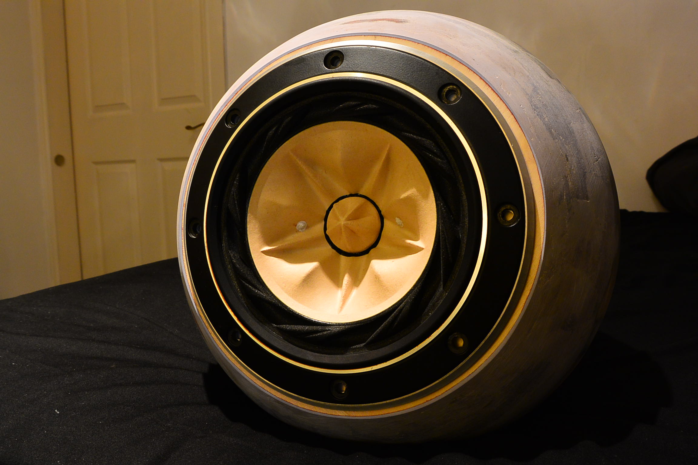

On the mounting ring business... how do you plan to attach, what do the mounting surfaces look like? Is it like in the picture? The ring mounted around the speaker and flat face to face on the enclosure? I'd be inclined to make it one part with the speaker (small lip under the mounting ring of the speaker) and use an o-ring on the outside and a neoprene seal where the bolts are.
Another way would be to create a ring that goes over the face of the speaker and curves back to the enclosure. Neoprene between speaker and ring and speaker and enclosure.
More difficult (but not impossible) to make though.
If I were in your shoes I'd use 3D printing to create the rings. First a couple of plastic ones and maybe if everything fits right make some RVS ones. RVS printing is expensive though. But for a plastic one you can use an online printing service.

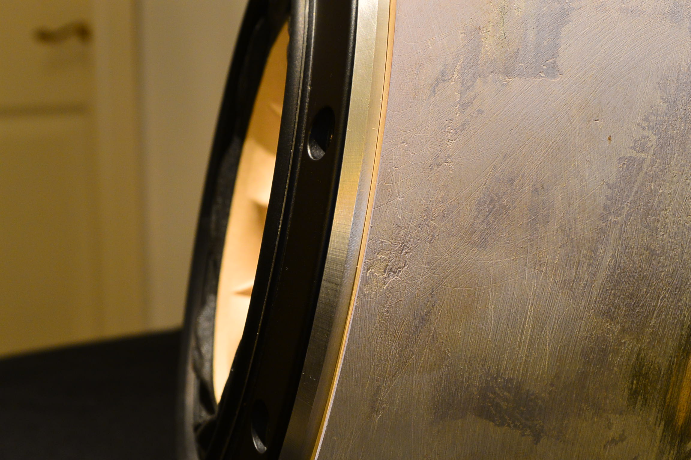

the wood surface is plane flat plywood.the OD is 206mm ID is 144mm.
The mounting ring is also simple.Bottom is flat.top has a reces for driver and chamfer on outside.
I will use a gasket between the two surfaces.

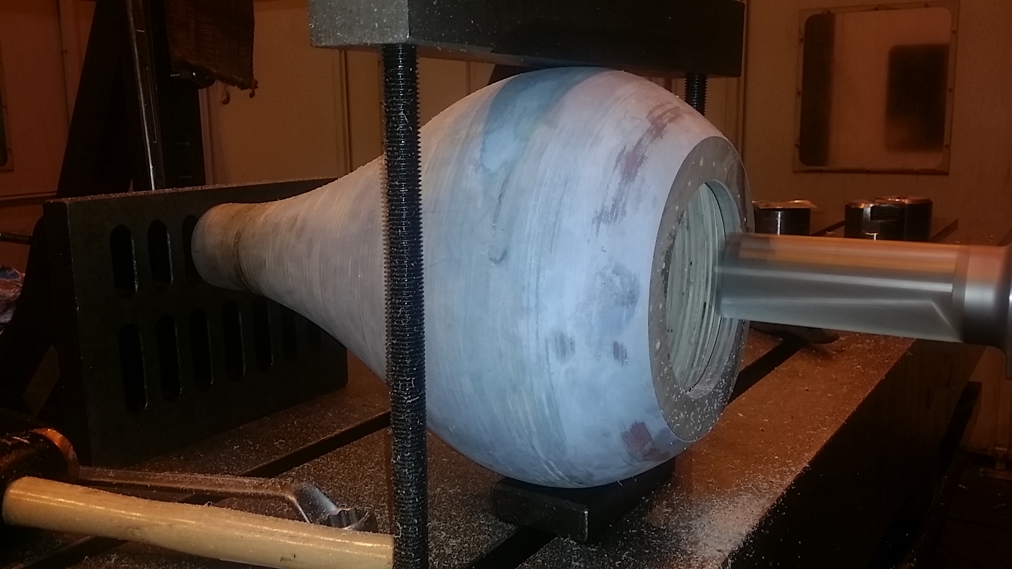

Tonight at work i will mill them to same length and diameter on top.Just general clean up of surfaces.Im working on sunday too so might be later when i do the laminating.Working 12h a day has its drawbacks.....
Danny
Will make a pics of boxes getting machined
