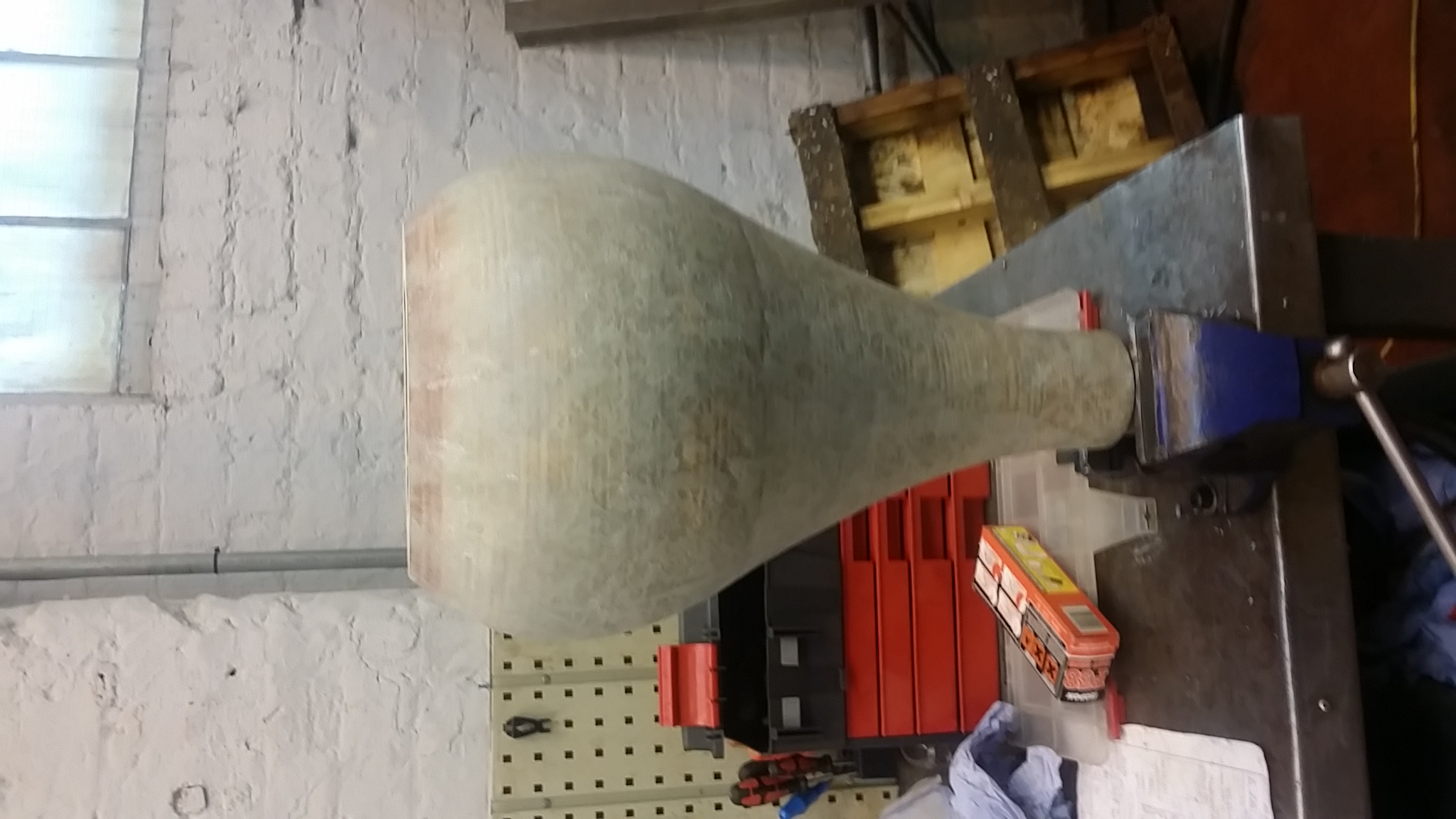

First one fiberglass sanded and did a small test with P38 body filler.This one is really easy to sand. and leaves very smooth finish even after 120 grit sand paper.Works best at 150rpm on a lathe.Not much heat,dust keeps going down.GREAT!
Next second enclosure to fiberglass.

I'd hit it again as theres still some resin 'high spots' - will help keep the bondo layer thin as you have to put enough on to have some remaining over the 'peaks' when you sand / have sanded.
Also helps keep the diameter of the 'finished' piece closer to spec.
I was thinking about it to put another layer of FG over it.The finishing one. Not sure on that though. If not I will sand it some more.The high spots are actually not that high, you can feel it with a finger, but its really shallow.
What is the usual thickness of bondo you use? Or what is max that I should avoid?
Danny
Personally.... I would not put finishing tissue over the top as:
1) It might make it no better than it is now and just add another step.
2) It might make the finish worse (higher highs and lower lows)..... more pain in correcting.
Hmmm, it's really hard to say as I cant lay my hands on it to feel how irregular it is........ if the hollows are no more than say 0.3mm - 0.4mm you'll be fine.

When a metal panels been beaten to shape, it's full of dimples n ripples - only very slight but they are there.
How the body shop guys deal with this is simple - they 'skim' on a layer of bondo, let it cure out then sand the c**p out of it.
The high spots are raw metal, the lows are the colour of the bondo - the bondo 'lows' are 'flat spots', this stage it all looks a bit 'mottled'...
So they do a second skim and sand again, rinse repeat till the panel is correct in its contours and a single even colour.
It's hard to say how thick this layer should be, my best guess would be 1.5mm - given that panels flex a fair bit even on 'Big ol' Yank Tanks' with their thick metal hides and driven in a 'Florida Granny' manner.... or trailered to the point of destination 😀😀
I'd follow the same scheme for your teardrops - skim on bondo with a 'stiffish' applicator (wifes credit card 😉 ), mount it your lathe and sand till the highs show.
Apply a second thicker layer and sand till its smooth, no highs or lows showing.
DONT PANIC if you sand through this layer - say in a band - keep the workpiece in the lathe, mix some more bondo and apply while rotating slowly.... leave to harden, sand again 🙂
Now, only You can be the judge as to the required thickness, it will take a bit of 'getting the feel' and trust in your abilities / senses as you work through the 'grits' towards priming.

Do not underestimate the power of the ply layers coming trough... You have experienced the powers that the ply forces on itself leaving you with a cracked enclosure. Even after covering the enclosure with cloth and whatever resin you choose.... the ply won't stop entirely from moving about with changes in humidity. A thicker layer of bondo won't let that ply movement shine trough. You want a gloss finish, if you create that with the glass layer you have on there now, look at it 2 months from this point on and it will change on you. You can slow down the process of the change in the birch ply with humidity, but I'm pretty sure you won't ever stop it. Best you can do is hide it, that takes a coat that can handle that. Hope this makes sense....
I'll add this to your train of thought...
True.
1mm or 100mm - if the base structure shifts to 'that' degree, the bondo will crack no matter what...... 1 month or 1 year down the line.
Bondo takes longer to cure out the thicker it is.
Bondo SHRINKS no matter the thickness, in fact, the thicker it is, the more it shrinks...... this is 'no $h1T', it's why body shop guys use as Little bondo as possible.
Its even possible for thick bondo to 'shrink off' what it's attached to.....
Dont believe me - go ask a bodyshop 😉
I think (with my near 21 years of experience of putting composit on substrates that Have to move / flex (or not in the case of racing propellers bolted to 4.5bhp 10cc race engines)) that barackuda will be just fiiiine with the steps I have written.
