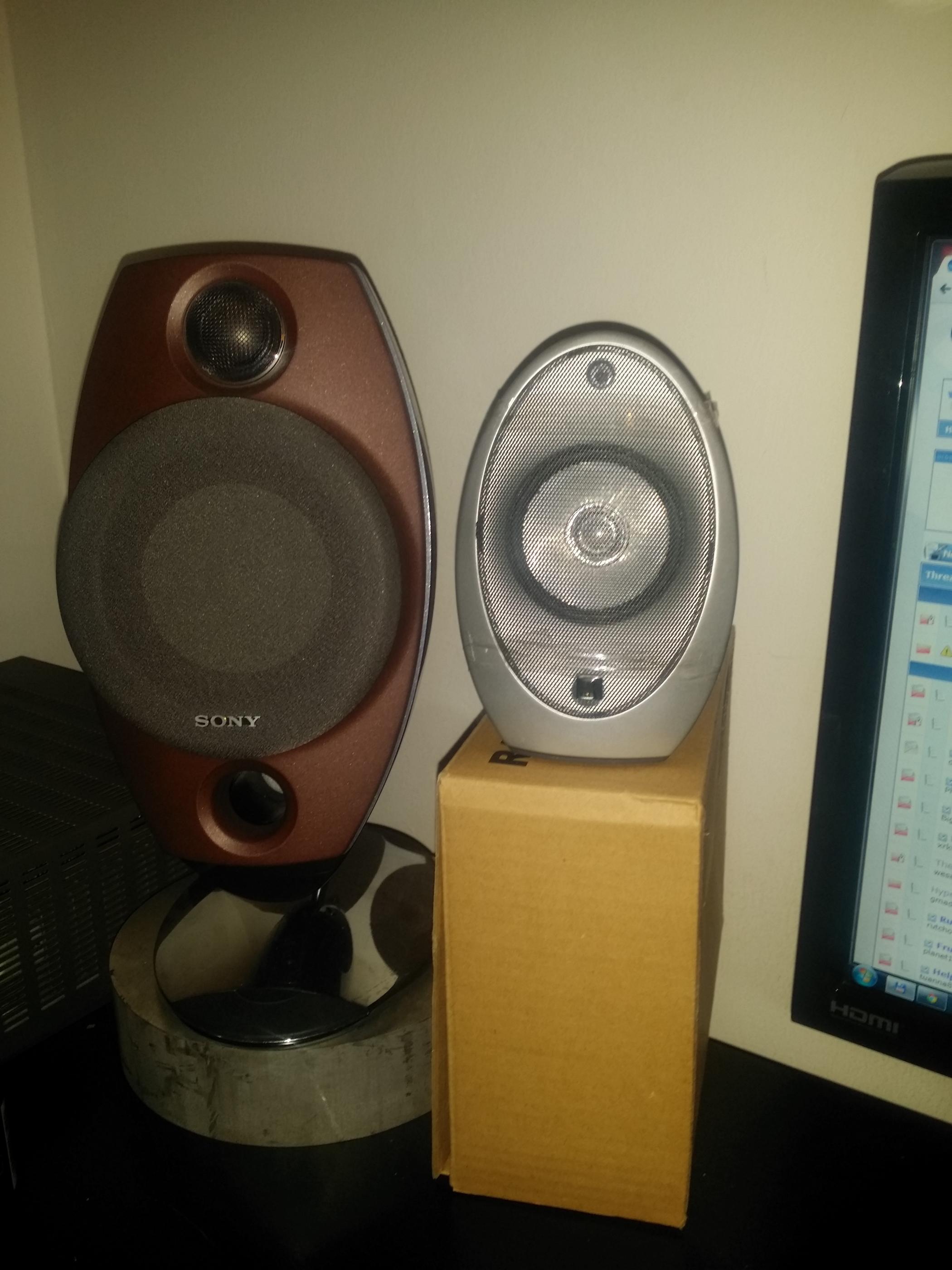

Above mentioned KEF uni-Q drivers...75mm LF, 15mm HF...
Actually very crisp and clean. No lows at all, but that is to be expected.
Danny

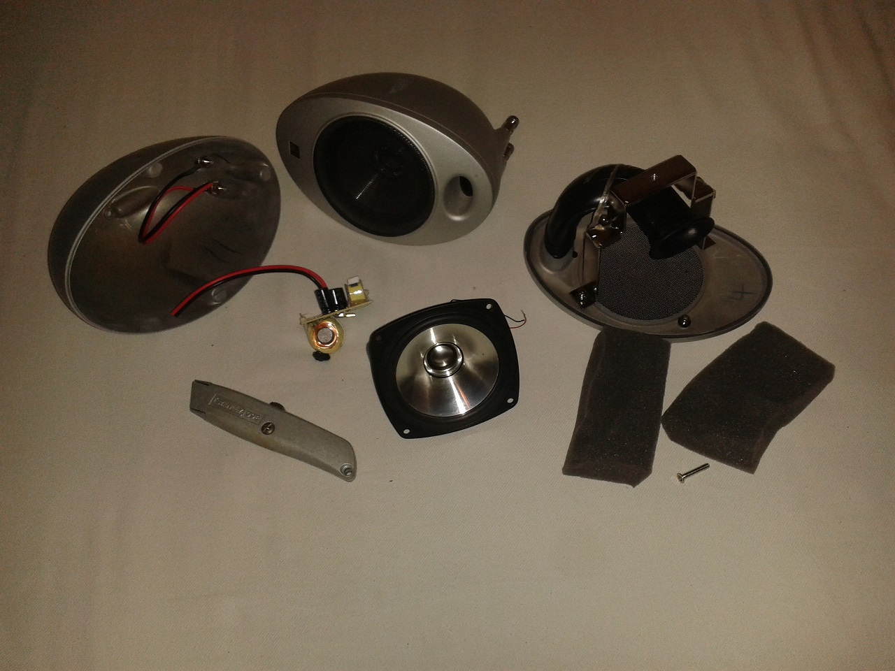

Ahh-ha.
I've not seen that type yet.
This is what mine look Like:
Note the 'Bass Port' - which sounds like a 'chuffing pipe'.
ie: if you nearly run me down in your car, I would call you a 'chuffing idiot'.
The Stanley knife is there for scale btw

Sippy thats the HTS2001 with a 100mm Uni-Q, 100mm LF and 19mm HF, both ALU. 80Hz-25kHz, 1.5L internal volume
I wanted something small, with a 5" woofer will be perhaps too much for near field.
