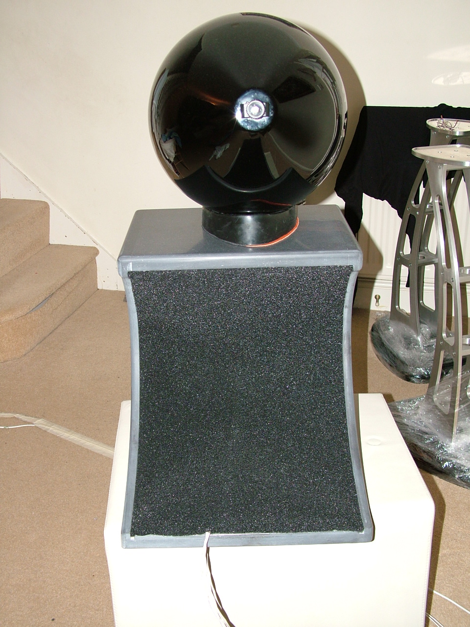

the 'tapered tube' was done in fibreglass initially but attempting a thick wall (15mm) paper mache if I can figure a way to mount it!

The 'open pipe' (a la 2 stroke motor bike exhaust idea) is quite reasonable and like these things, there's enough flexibility to adjust them a lot - if you see it as a closed pipe resonant pipe (like a 'pan pipe' for example) the standing waves length reduces to 1/4 the lowest frequency you're to reproduce, or at designed Crossover freq anyway)
So, for my 125 Hz this is about 24" long and if the density of the damping increases in a non-linear way, this can be reduced even further but runs into the problem of limiting the peak peak transients and you get that dynamic compression result that you're trying to get rid of (or I am anyway!) and this is where that low mid frequency has added to the difficulty a lot, as you can imagine.
So, the idea was to add some flexibility to the rear part of the chamber and I found at that 10mm thick paper-mache was really ridged/stiff (used the PVA glue) like fibre glass, but harder, and rang like a bell not like a softer damping material at all!
So, the next one contained damping fibre, lead shot, all sorts of 'junk' stuff but didn't change much even when I just taped this rear shape to the front half sphere with musician's 'gaffa tape' (that black fabric super stick 2" wide tape)
