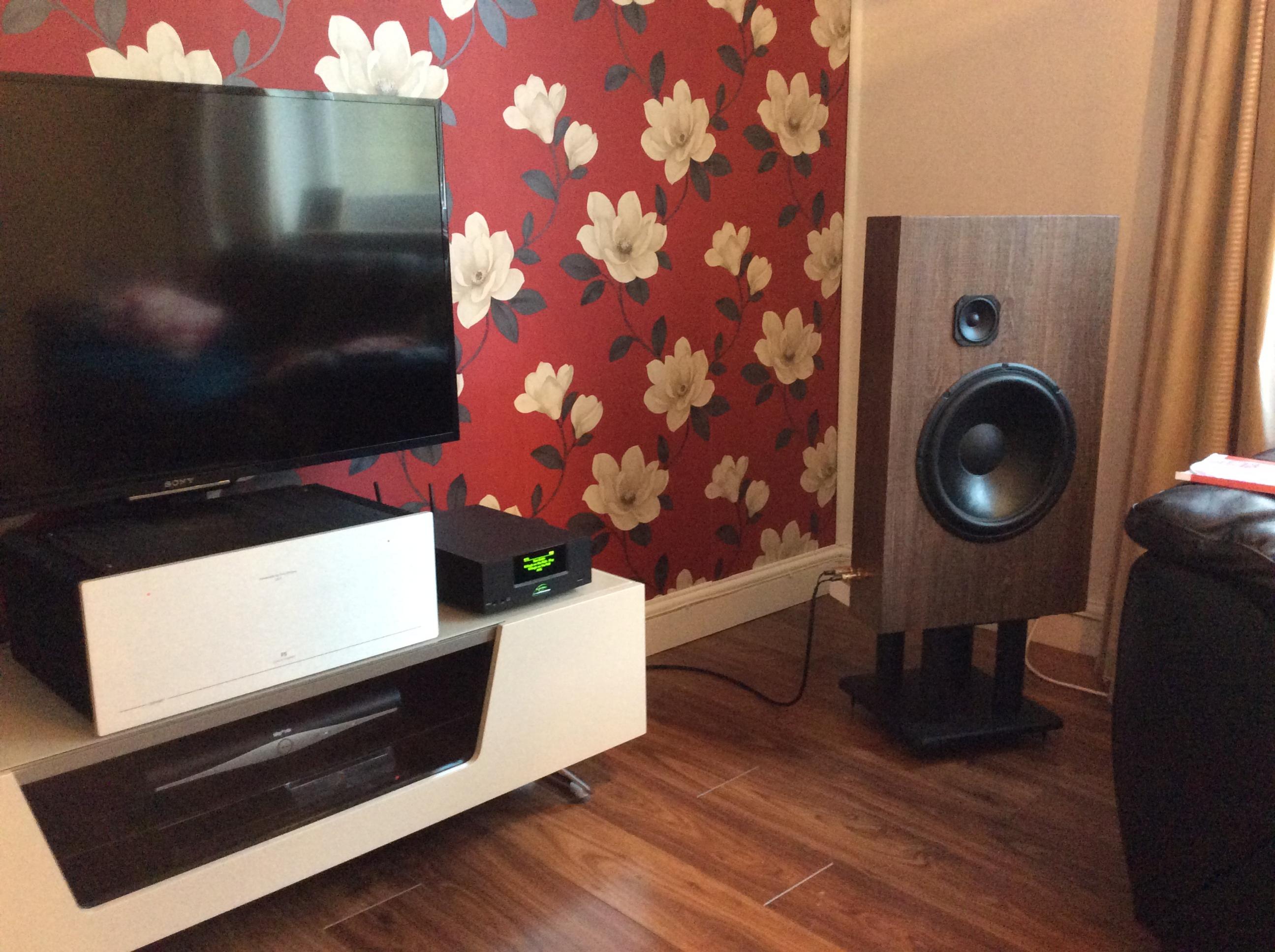

That looks great.... nice job!
This one is on my list as well.
What is that monstrous amp under the TV?
Do u plan to move that couch away soon? 🙂

Nocrapman - sofa going tomorrow🙂 the amp is my first amp build... F5 class A amp, curtesy of the forum also.... Just building some chip amp mono blocks for these speakers, as the F5 does ok.... But... Well.. Just want to build something else🙂
Try also BA-3 with 32 volt rails...(24 + 24) considerably more gain than F-5....now I am doing F-6, as soon as DIYstore gets more chassis. Is that the 12" Peerless woofer? Nice build!
When using my F-5 with mid 80" efficiency speakers, I find I want extra gain. The BA-3 FE as pre amp solves this problem nicely. Gobs of gain, it will drive your F-5
like crazy!
