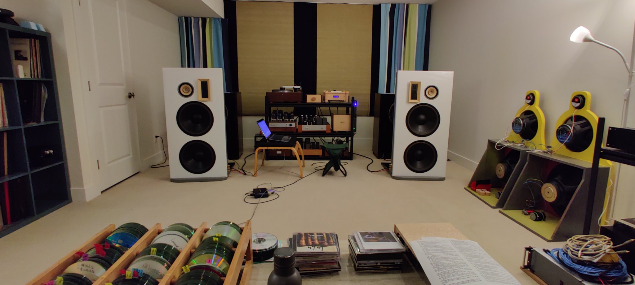

I brought 4 GRS 15 when started. My first pair ultra finished over ten years ago and enjoy listening to them every minute. lately I make up my mind and think I should put my hands on the ultra plus of which supposed to be the project right after I finished the ultra.
Don't know much about crossover design and the first order is my pick with the help of minor EQ.

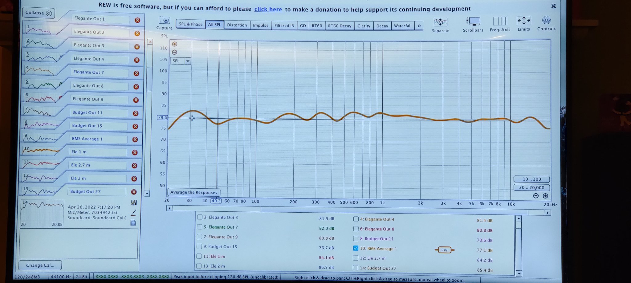

Pano, thanks for your advice. You can find the pictures above showed there are two full range one is Lii audio F6 n the other is GRS 8" planner. I did merge them together in different working frequencies and the end result is acceptable of which you can find on the graph showed above. I'd try the crossover point you recommended n will feedback with my findings.
