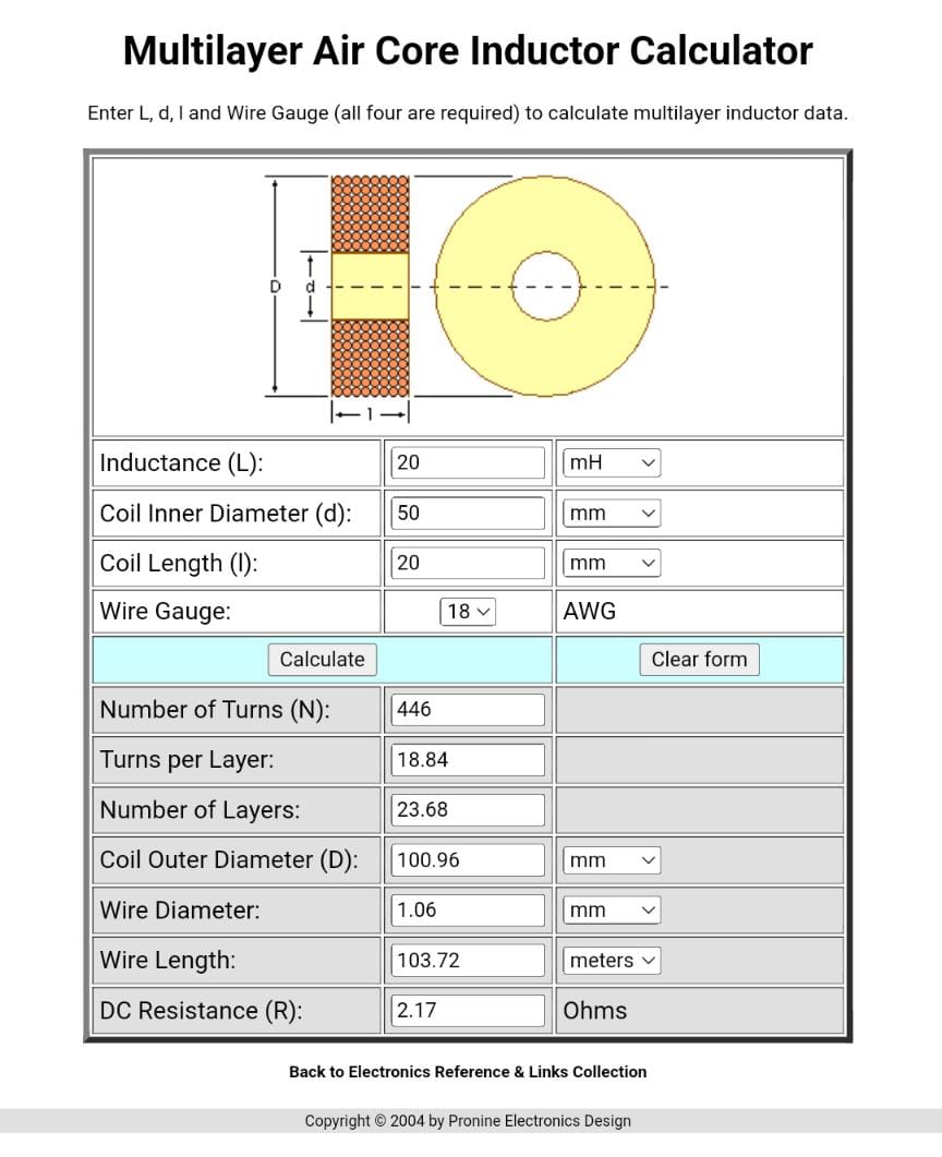

Is it possible to replace the 20mh iron core inductor with an air core?
For me, it's easy to wind this inductor, it would cost me something around 20 dollars.
Getting this recommended inductor is much more difficult and much more expensive, for me.
tks
tks
