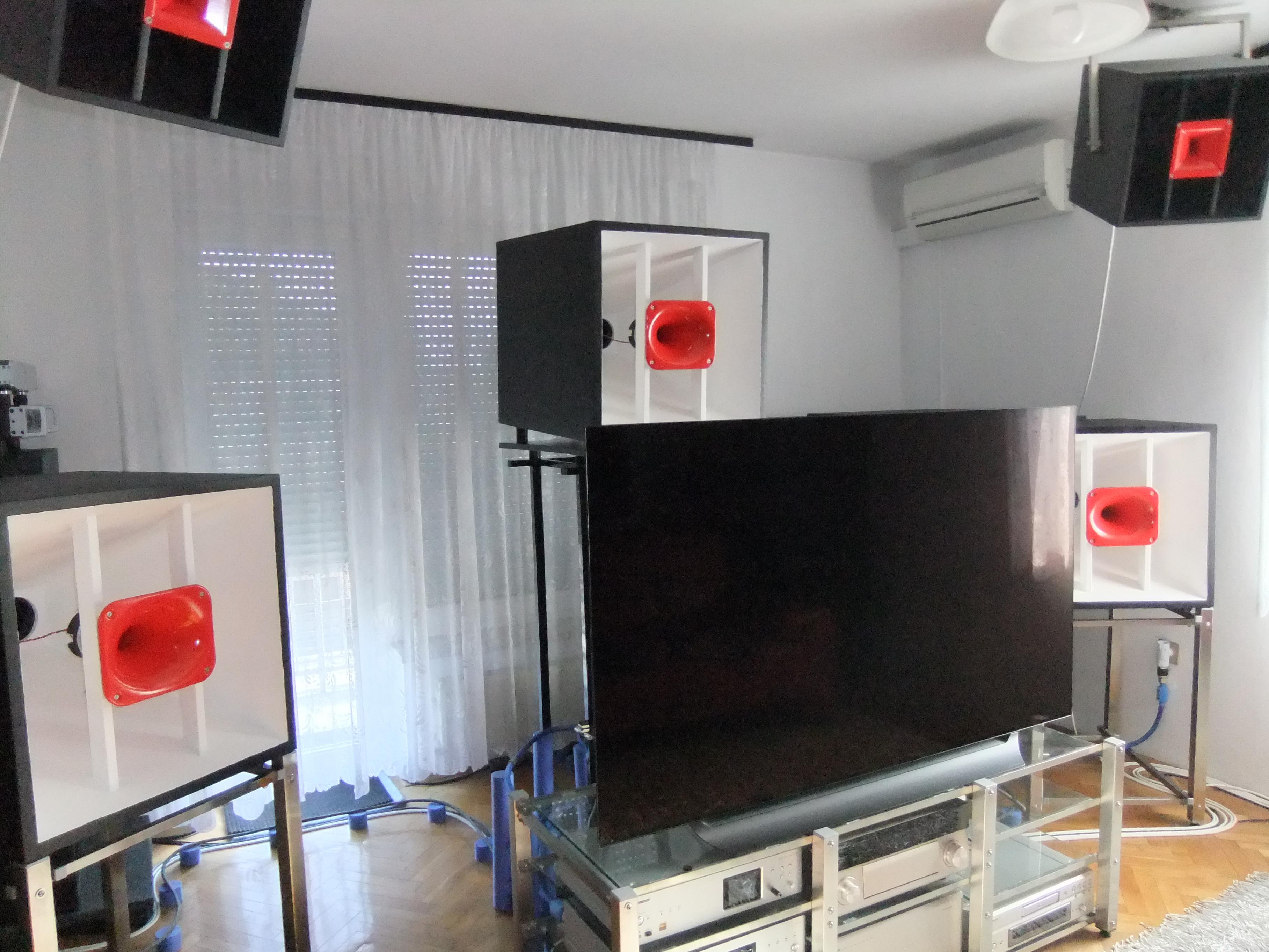

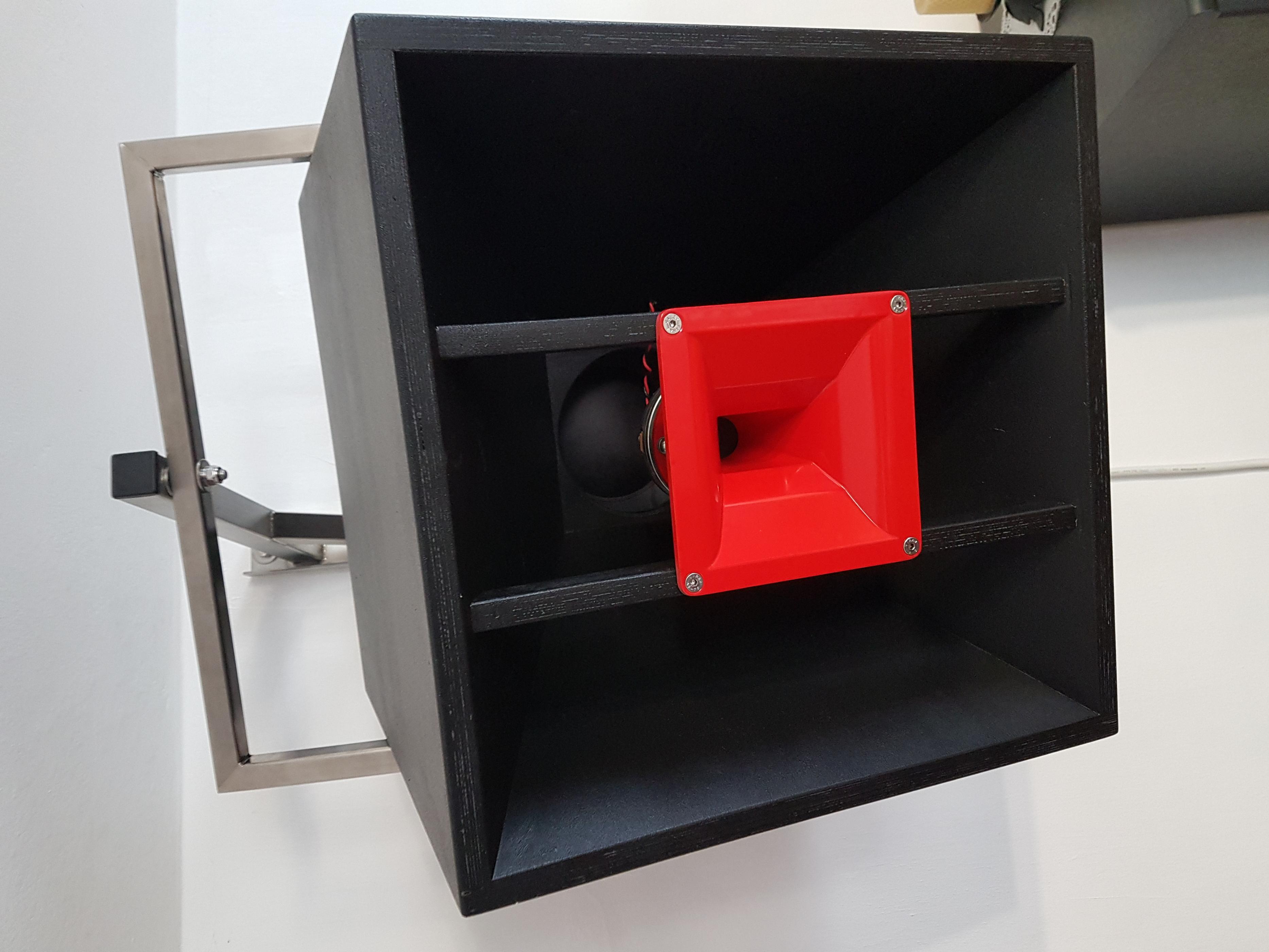

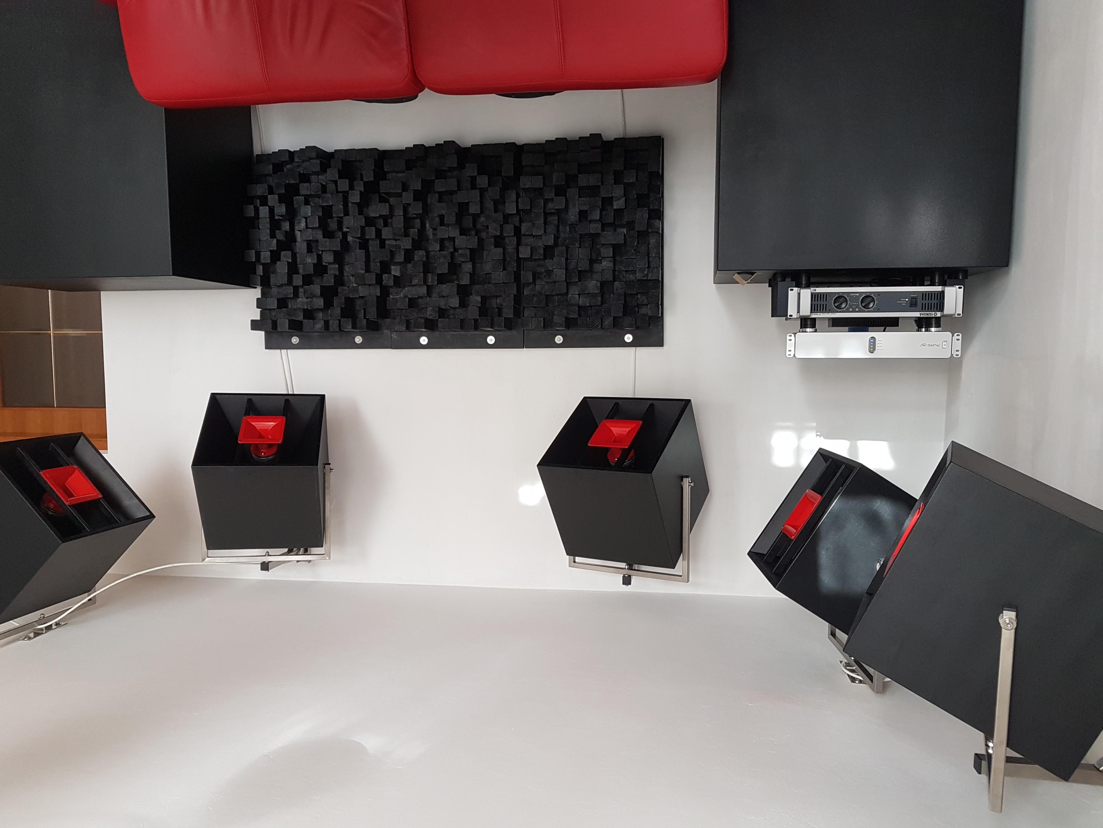

Sorry 8 x Dolby Atmos horn speakers MID freq is from 120 Hz to 1.600 Hz and left, center and right horn speakers MID freq is from 120 Hz to 1.350 Hz with Faital HF10AK + LTH102 for HF for MID is Faital 10PR300.
Yes, 4 x TH1819, front left and right corner and back left and right corner. Each is some 110 kg and WxHxD (58cm x 125cm x 80cm) with 450 liters netto and 4.50m horn path!

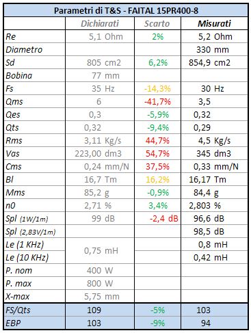

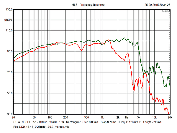

The 15PR400 is undoubtedly one of the best midwoofers around, which is acknowledged by people like Tony Gee and Troels Gravesen.

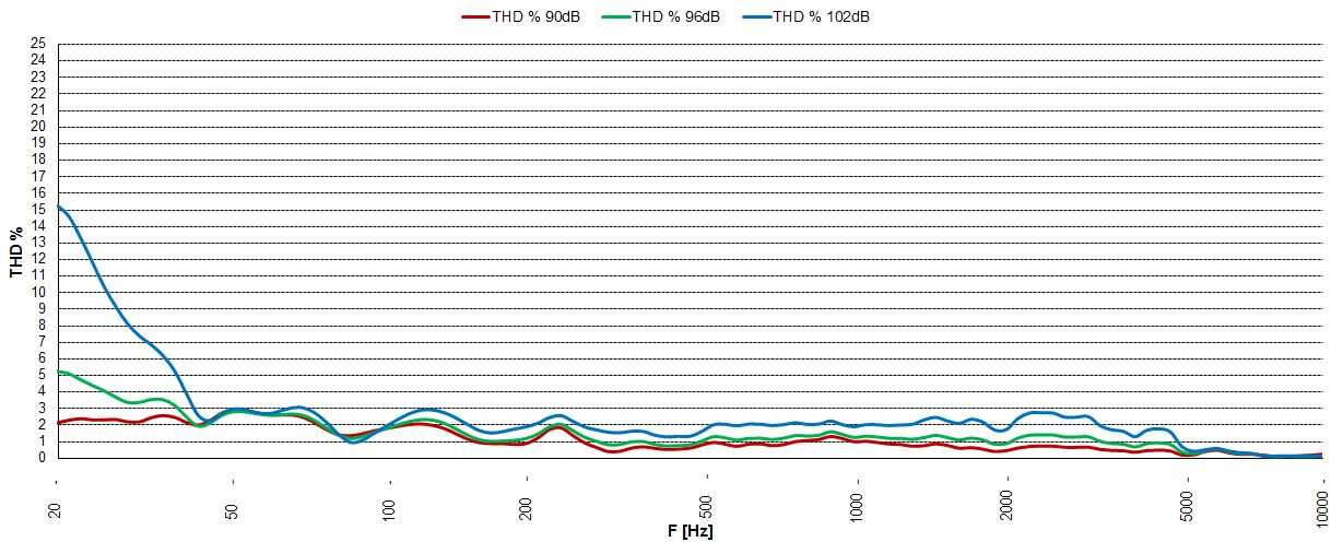

Not only Le is very low, but the measured Fs lies between 32 and 30Hz. There's a small dip centered around 1000Hz - which makes 800-1000Hz a logical XO point, but apart from that, its response is fairly clean up to about 2kHz.
No wonder this 15" is an ideal partner of either the HF108(R) or HF10AK for a (nearly) full range 2 way.

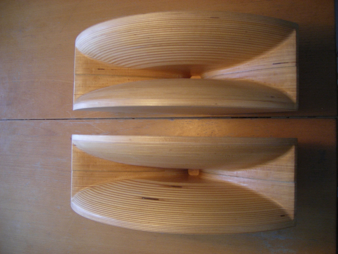

With tractrix 80x70° horn the walls, ceilling and floor reflexions are outside a sweet spot ? Saying a 2.7 meter floor to ceilling and horn at 1 m f the rear and side walls, sweet spot at 3 m ? We often hear 90x40° is an appreciated horn pattern -outside more mdern designs I mean- ?
vertical 80° at 6k hz then gently beams 40° 20 khz
horizontal 80° since 2.5 k hz to 7° 20k hz
