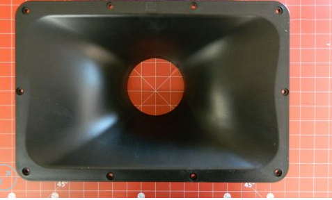

Which horn you would recommend for HF10AK from 1300-1500Hz and up? 18Sound 1086?
I want to match it with 90°x50° mid WG.
Haven't done any measurements on mine yet but those HF10AK measurements look really good.
Which horn you would recommended for HF10AK from 1300-1500Hz and up? 18Sound 1086?
maybe LTH102 horn:
https://faitalpro.com/en/products/HF_Horns/product_details/datasheet.php?id=903010110
I have the HF10AK on the Parts Express B-52 buyout horn. 60x90 constant directivity.

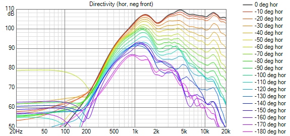

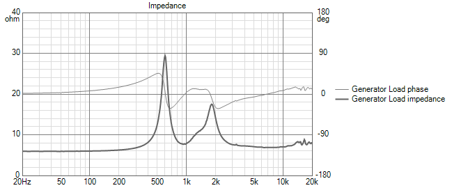

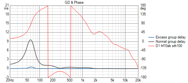

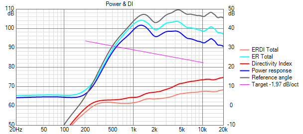

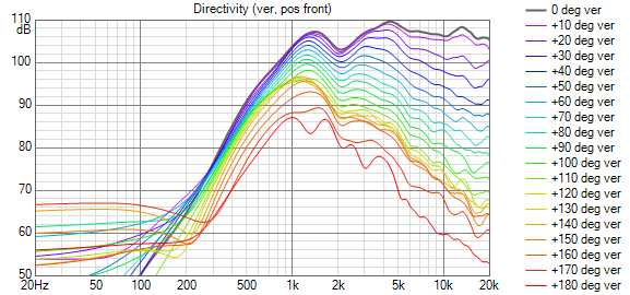

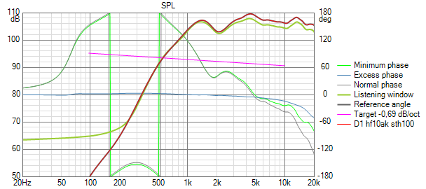

HF10AK in STH100 horn

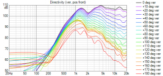

Hi, attached images from VituixCAD. These are full "spinorama" measurements of hf10ak and sth100 horn on some of my prototype speaker. If I remember correctly it was pretty small enclosure housing sth100 and 8" + inch or two extra panel. Note, there is some DC error on the measurements since I didn't have my soundcard on proper setting when measuring these. This was one of my first measurement sets with ARTA 🙂 Anyway, have fun!
maybe LTH102 horn:
Thank you for advice.
HF10AK in LTH102 looks prefect, I'm just not sure if it's a good match with 15" by 10" WG with the coverage angles 50°x90°.
Isn't that huge JBL PT waveguide for a cone driver ? It does certainly not look usable for a 1" compression driver.
