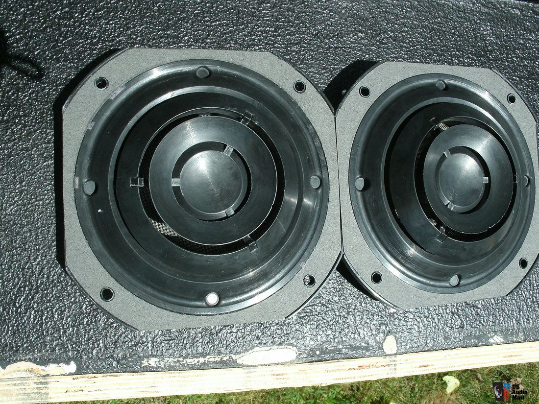

Have you considered using the BMS 4555 with the 2384?
It would bolt right on and it's a much better driver than JBL's own 2418H, that comes with the 1" version of the 2384.
I own the 4554 and while Faitals play better down low (towards 1000Hz), the BMS sounds wonderful from about 1500Hz and upwards.
The 1.8k crossover seems ideal for this driver-horn combination.

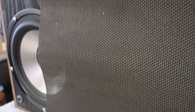

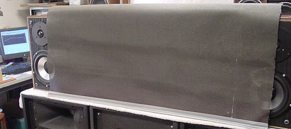

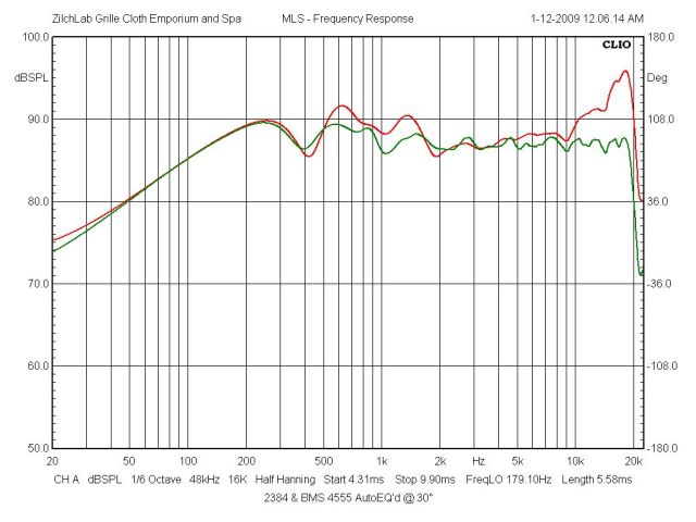

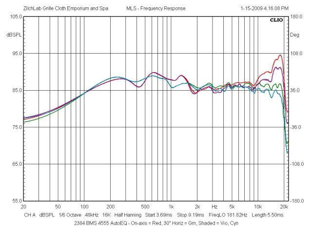

Zilch experimented with the 4555 + transparent cloth shading to selectively attenuate the 2384 VHF on-axis.
His comment:
"What I am hearing presently from a single (2384) on the test stand is clean and clear with "big horn" transparency, even though I am only crossing at 1.2 kHz. Listening for it, I do hear the SSC™ compensation as a slight change in timbre moving on-axis, but it may be more prominent to others who hear VHF better; I know it's there.
Needless to say, the imaginary gonadotrophic effect is huge -- these babies BEG to be cranked...."

The BMS 4555 seems to be the best option, because it resembles the JBL annular drivers.

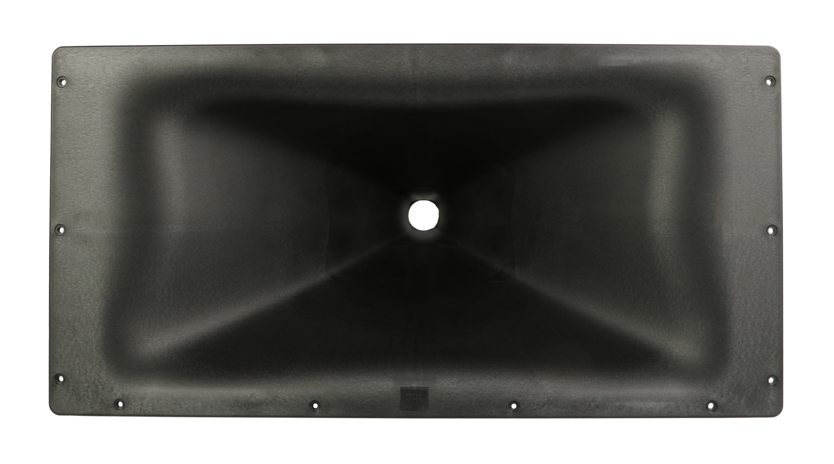

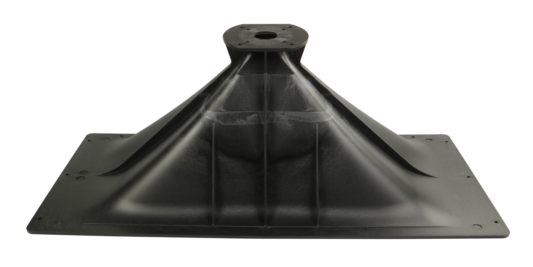

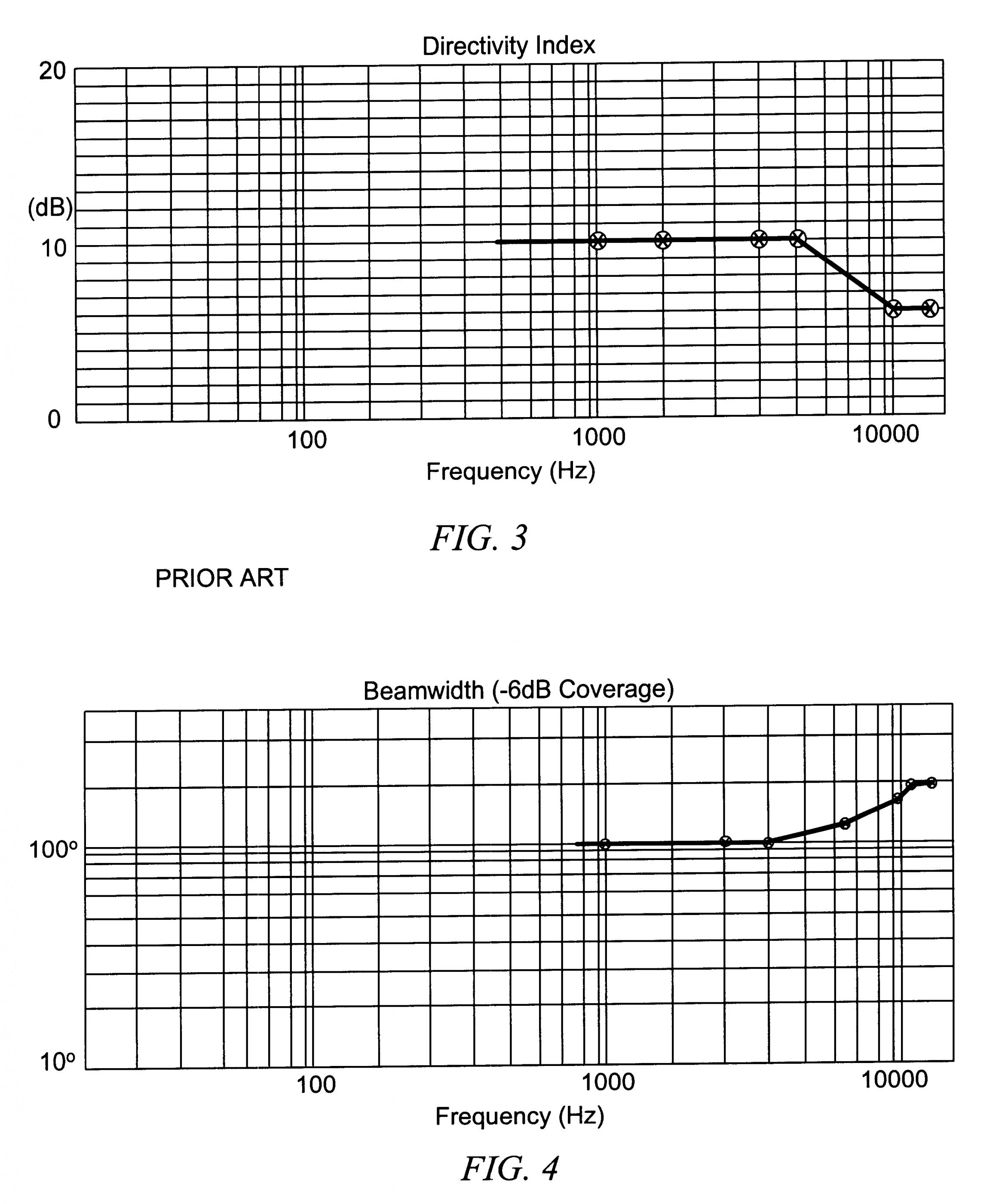

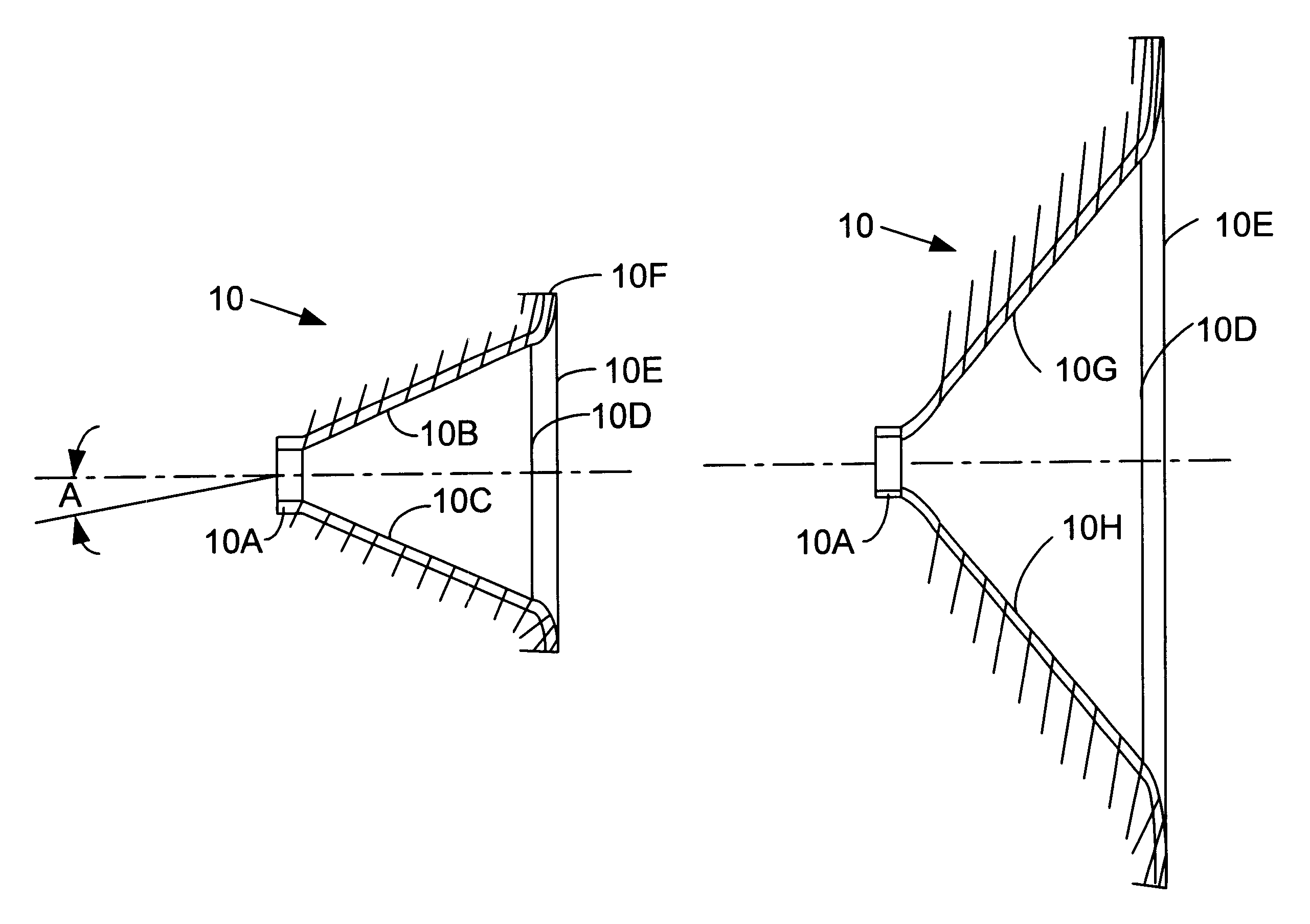

It is indeed a big horn and well designed, based on JBL PT principles.
If you look at the drawings - yes, the 2384 has its own patent - it's clear the throat resembles that of Geddes' OS waveguides.
The 2384 has a slightly increasing directivity to maintain output in the upper octave over longer distances (placed behind screens) in cinemas.
Therefore, you may want to attenuate the 4555's top end a bit. At least there's no shortage of output and extension.

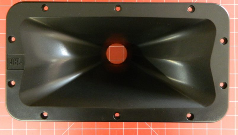

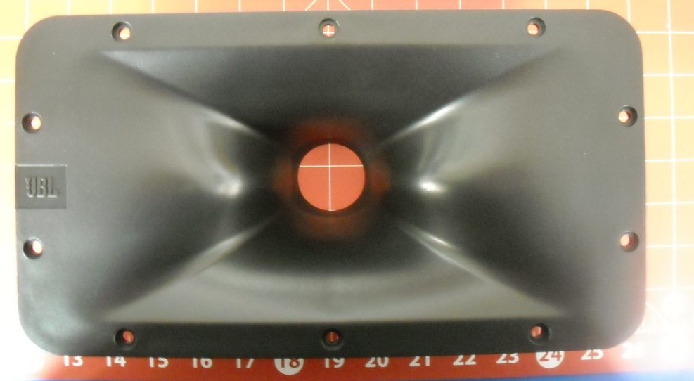

Left is JBL #5006815 for STX825 (90° × 50° nominal) and the other is JBL #5006219 for STX815 (70° × 70° nominal).
The smaller PT horns are basically similar to the 2384 and should work, but you have to add some delay to time-align both horns.
I would pick the first horn, because its coverage angles (90° × 50°) resemble those of the 2384.

The smaller one has a smoother mouth area, which may reduce diffraction / reflection.
Each of these two waveguides incorporates the latest refinements and can be considered state-of-the-art.
On second thought, the 70° × 70° dispersion might be a better match, as the midwoofer is probably beaming at 1.8 kHz.

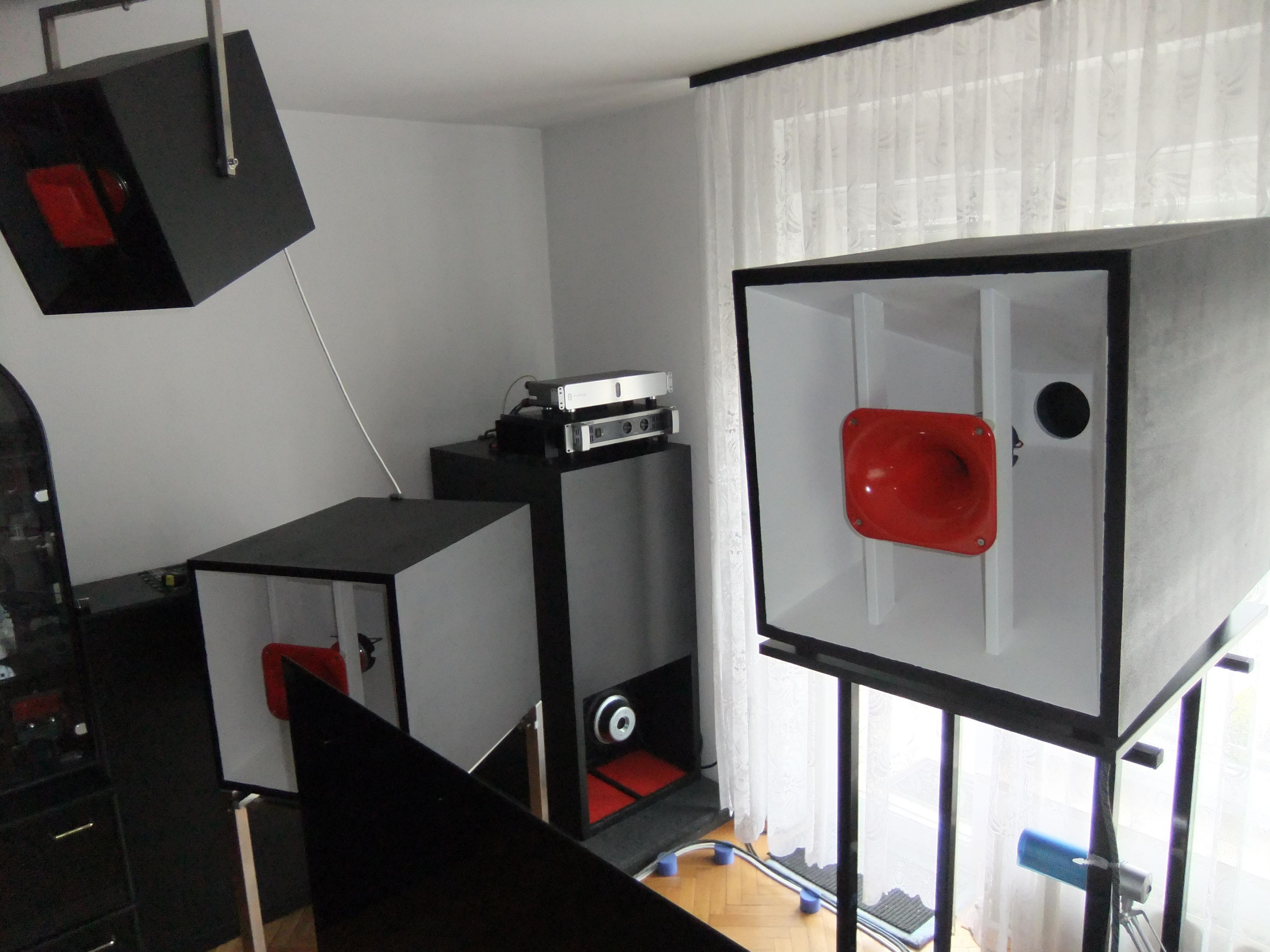

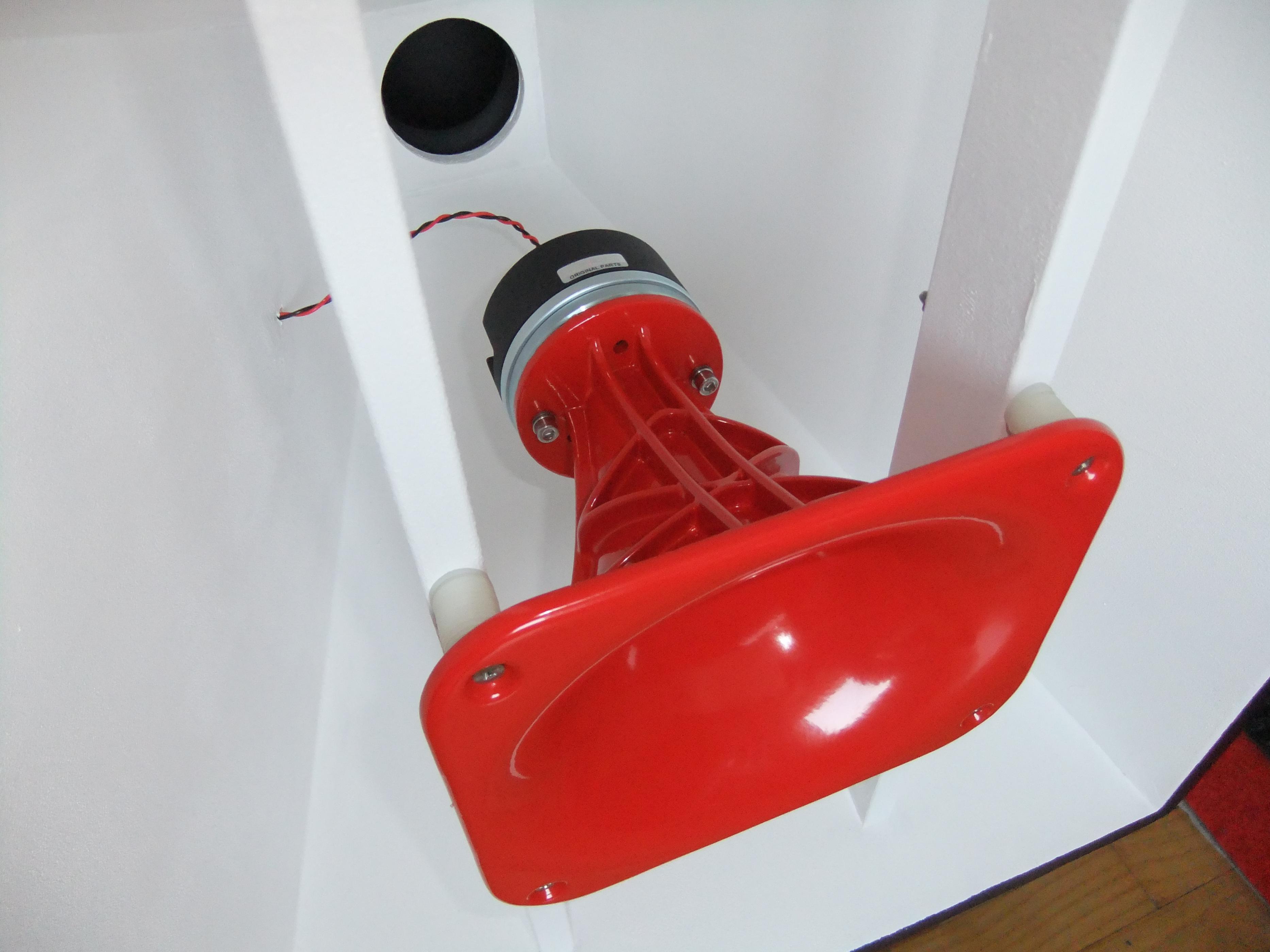

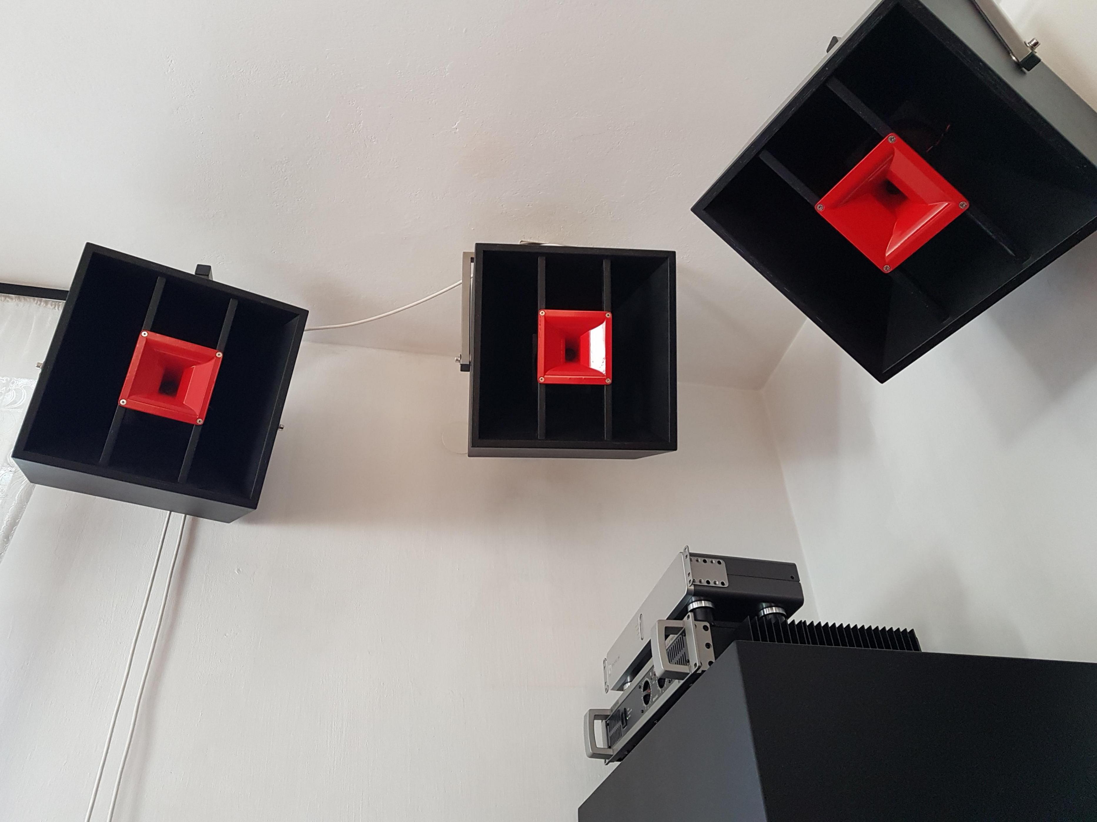

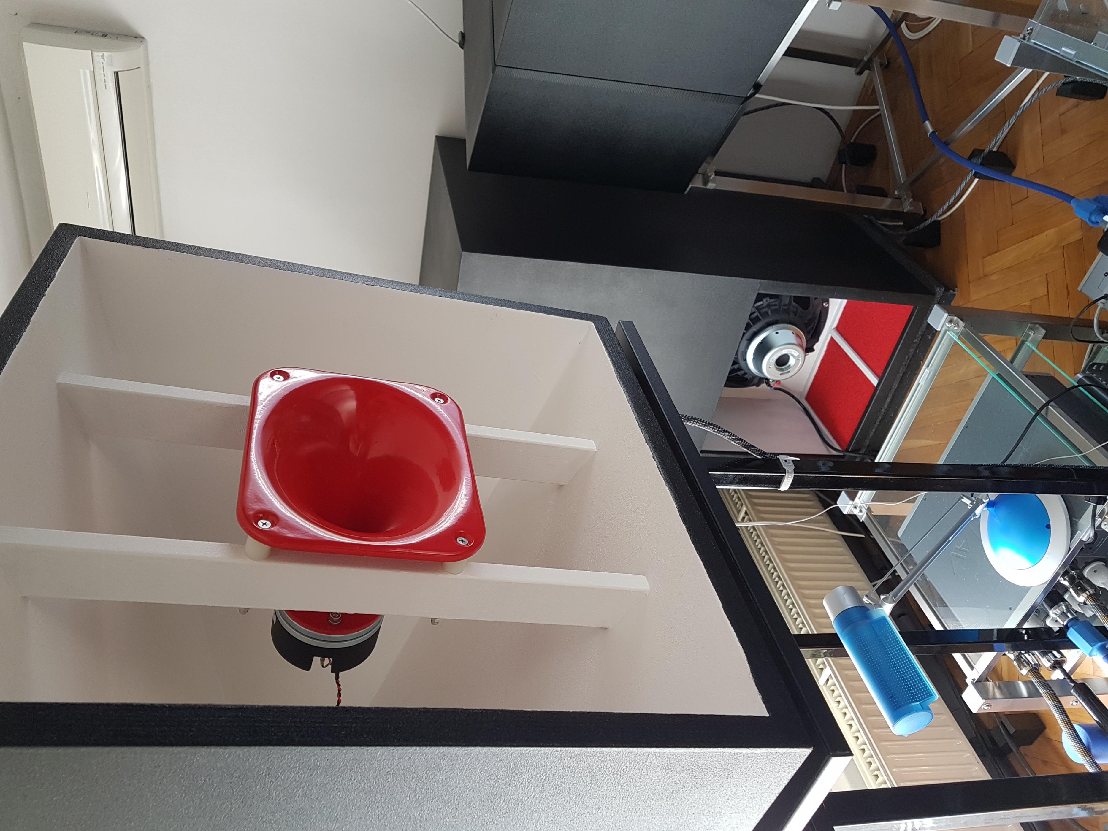

Yes you are right, I have HF10AK in left, center and right horn speakers, for Dolby Atmos 8 horn speakers using HF108.
