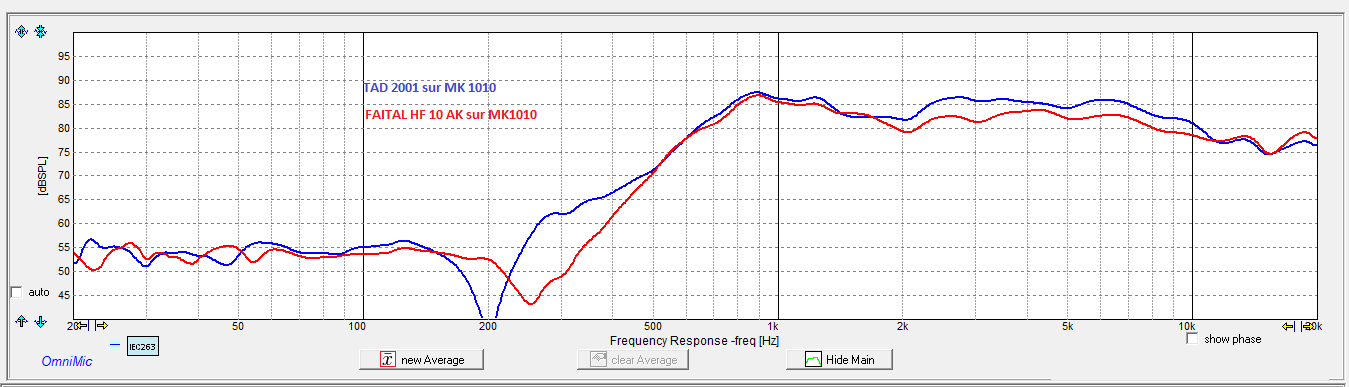

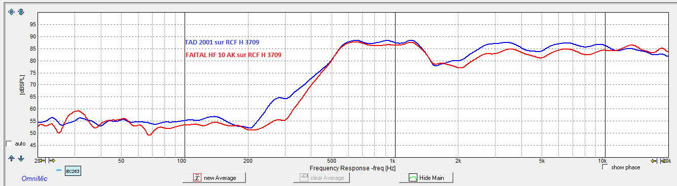

Comparison between HF10AK and TAD TD-2001 on a Markus Klug MK1010 (small multicellular horn) and RCF H3709 (semi Altec/WE 32 clone):
774796d1565700859-cover-spectrum-spl-low-distortion-2-a-tad-et-faital-sur-mk1010-png
774797d1565700859-cover-spectrum-spl-low-distortion-2-a-tad-et-faital-sur-rcf-h3709-png

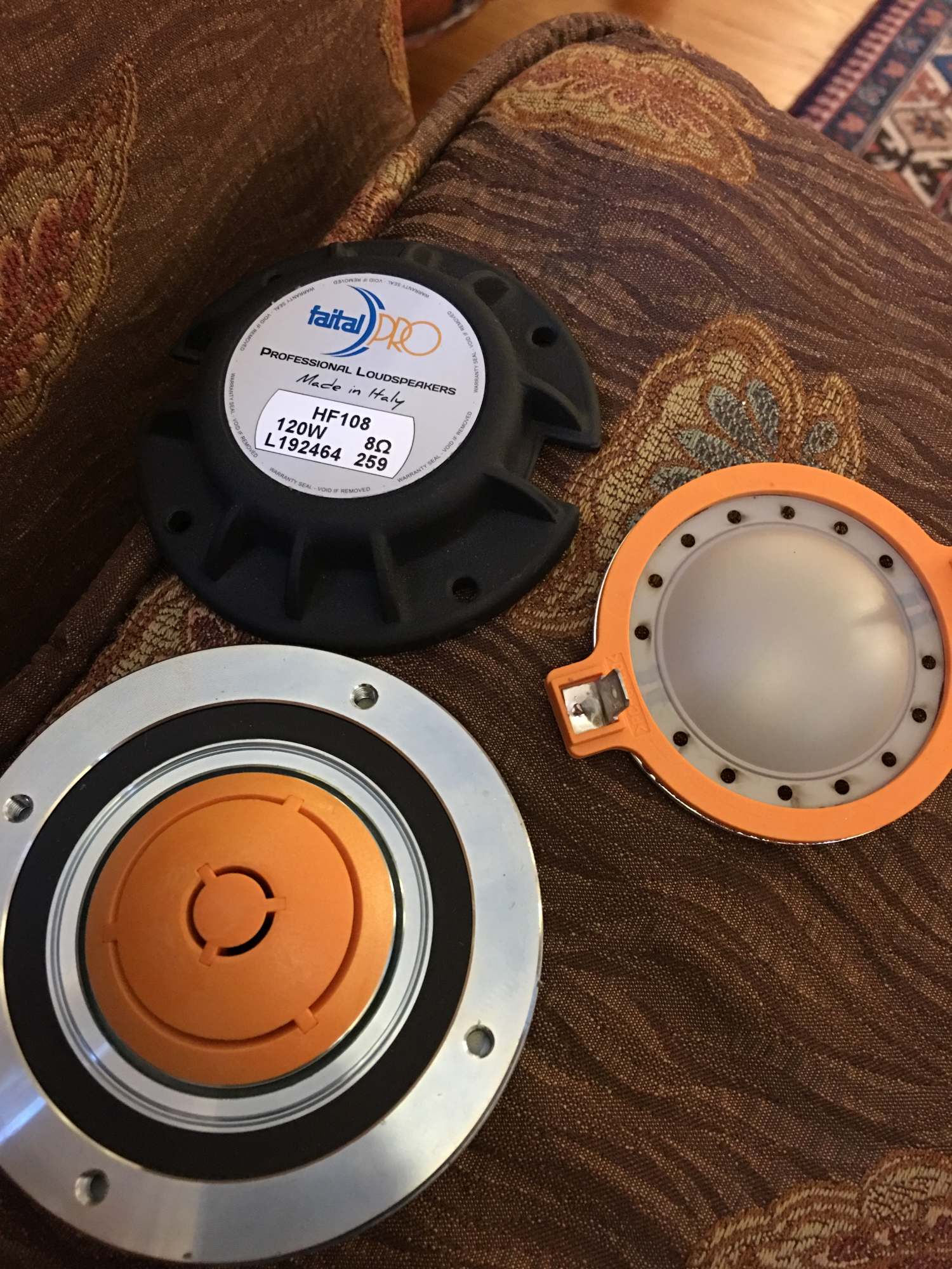

I can confirm the HF108R paired with the XT1086 horn is a good sounding combo. Nice 'softer' and refined sound. Good for home speaker application. The HF107 which I also have is slightly bit harder sounding. But still easier on the ears over some of the metal diaphragm drivers I've tried. I did recently pick up a pair of Dukane 5a540 16ohm 1" drivers which are apparently similar to Coral M100 which I read has a very natural sound. Have not compared yet to the Faitals though.

@tuyen: what's your XO freq. of the HF108R + XT1086 combo?
Considering its low resonance freq. the driver should take 800-900Hz, crossed steeply and behind a horn that's big enough.

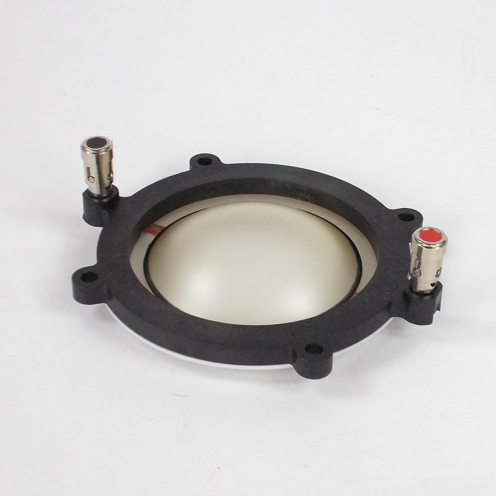

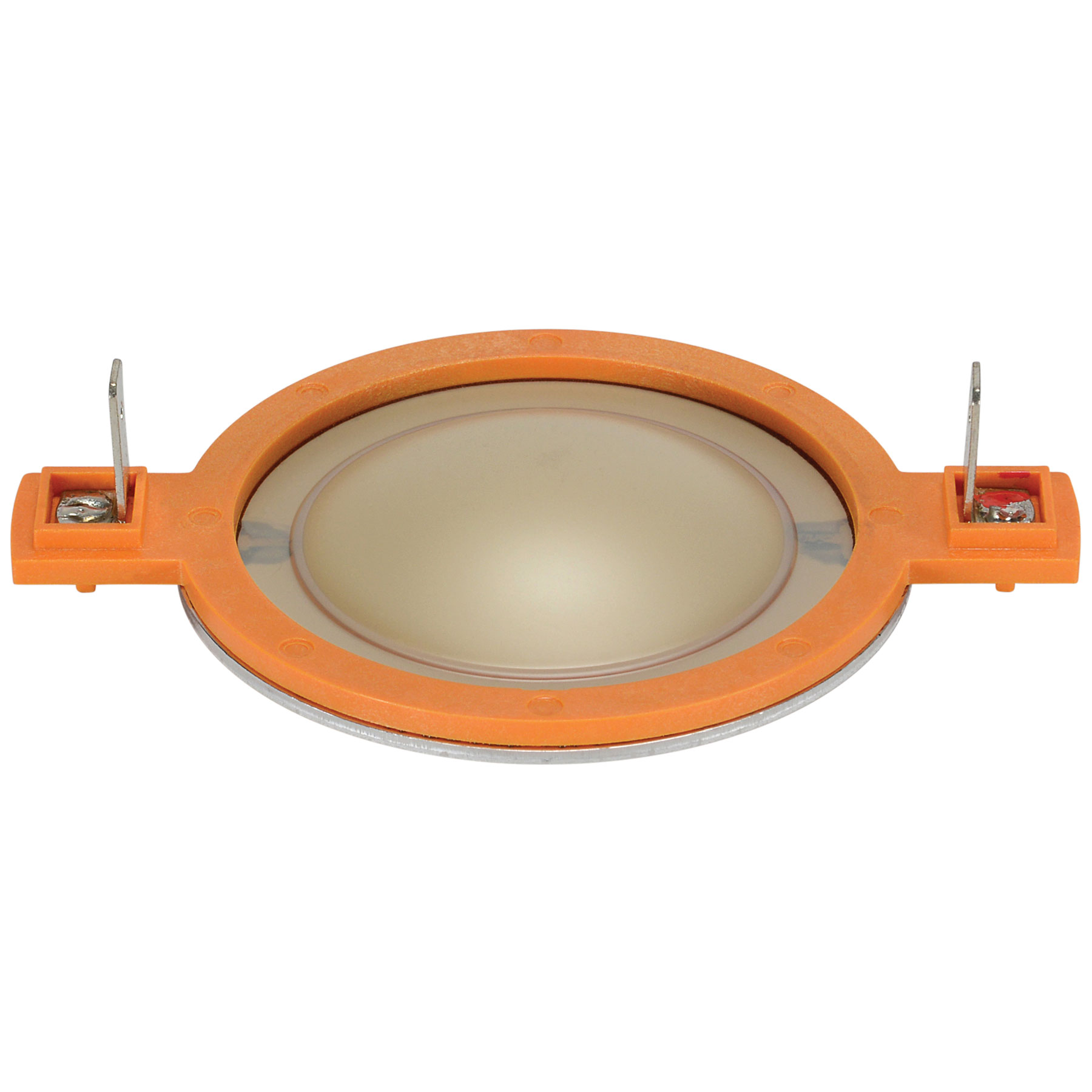

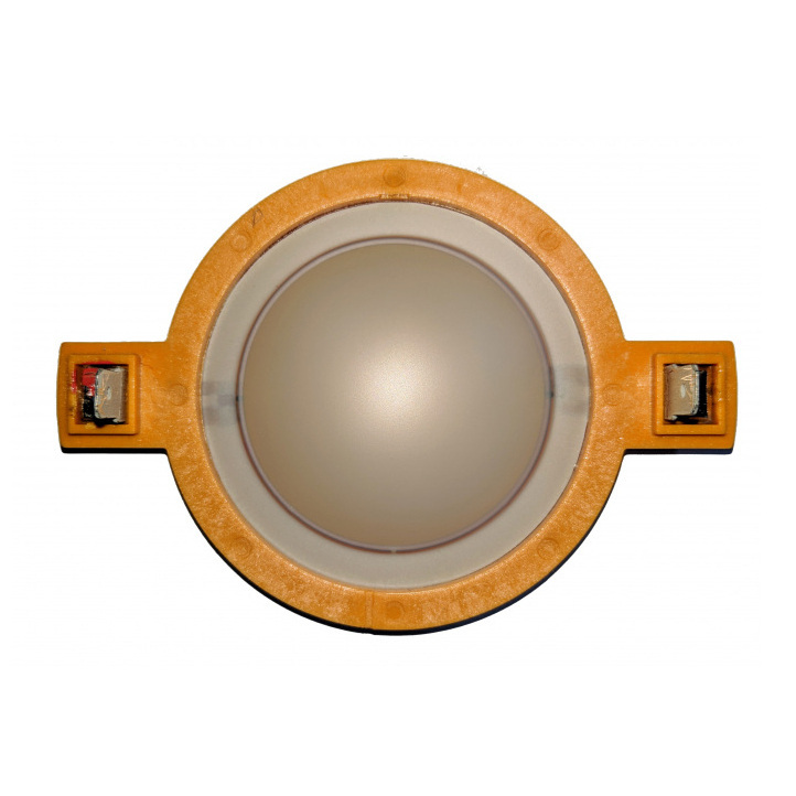

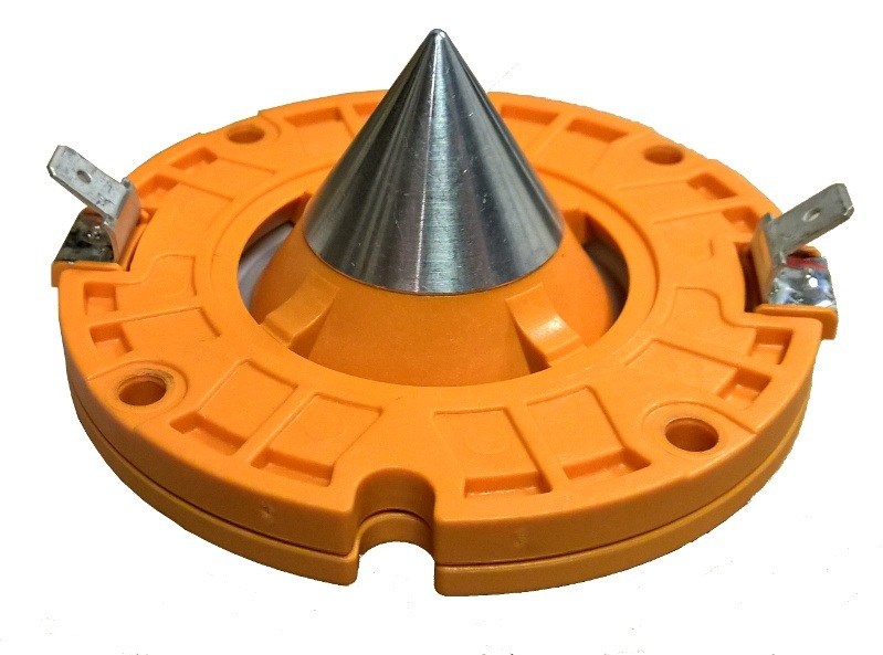

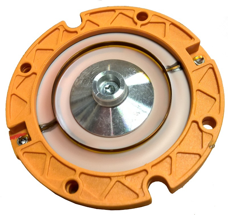

It's what's inside that counts, or better: contributes to the perceived sound quality.
Measurements are important, but often don't provide enough clues to make a judgement of what I'd like to refer to as 'sound signature'.
As far as compression drivers are concerned, diaphragm materials, including the suspension, are the main contributors to the perceived 'signature'.
2 comparable, but structurally distinctive drivers may show similar frequency responses and distortion characteristics, though may not sound quite the same.
Diaphragms of the HF10AK and H107:

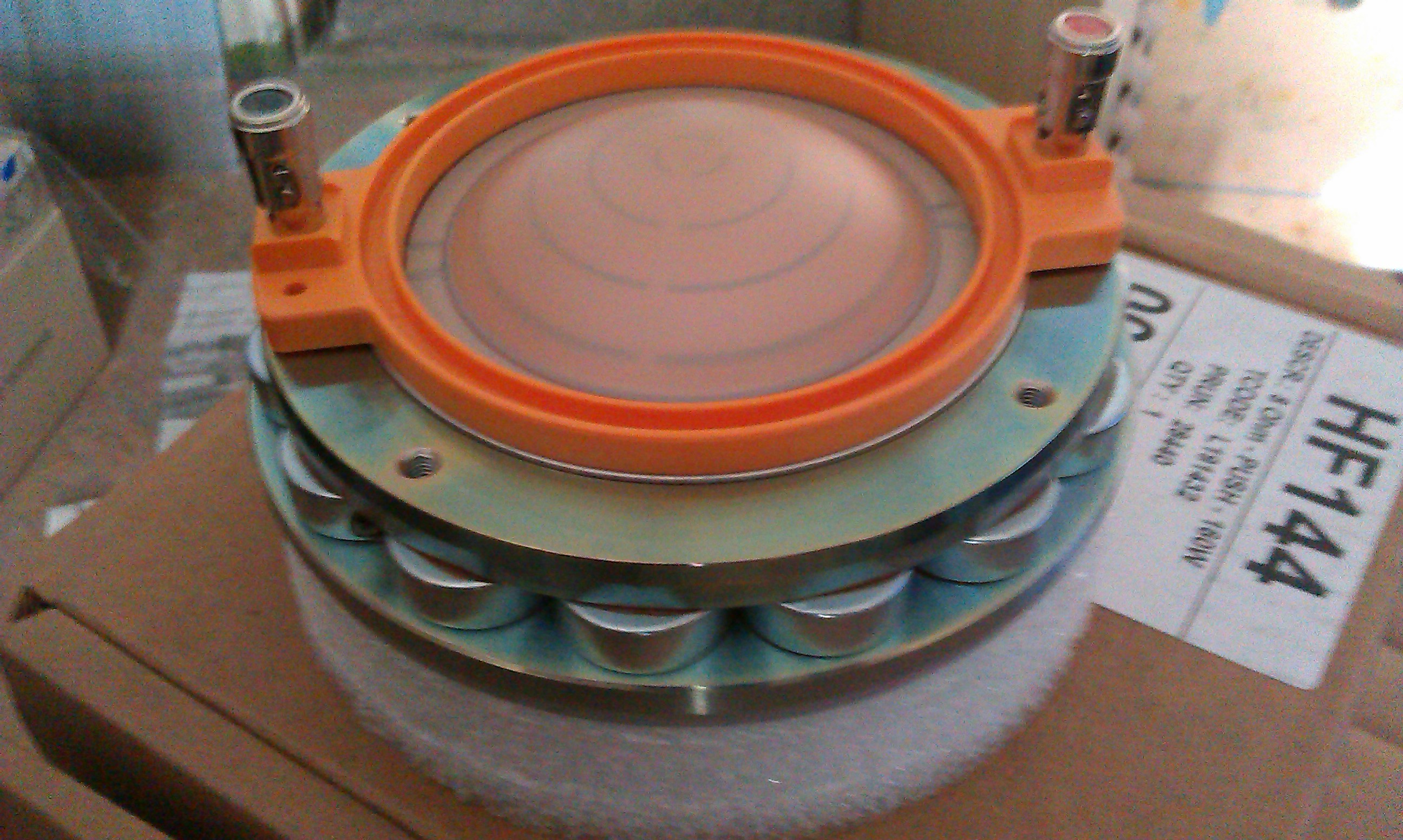

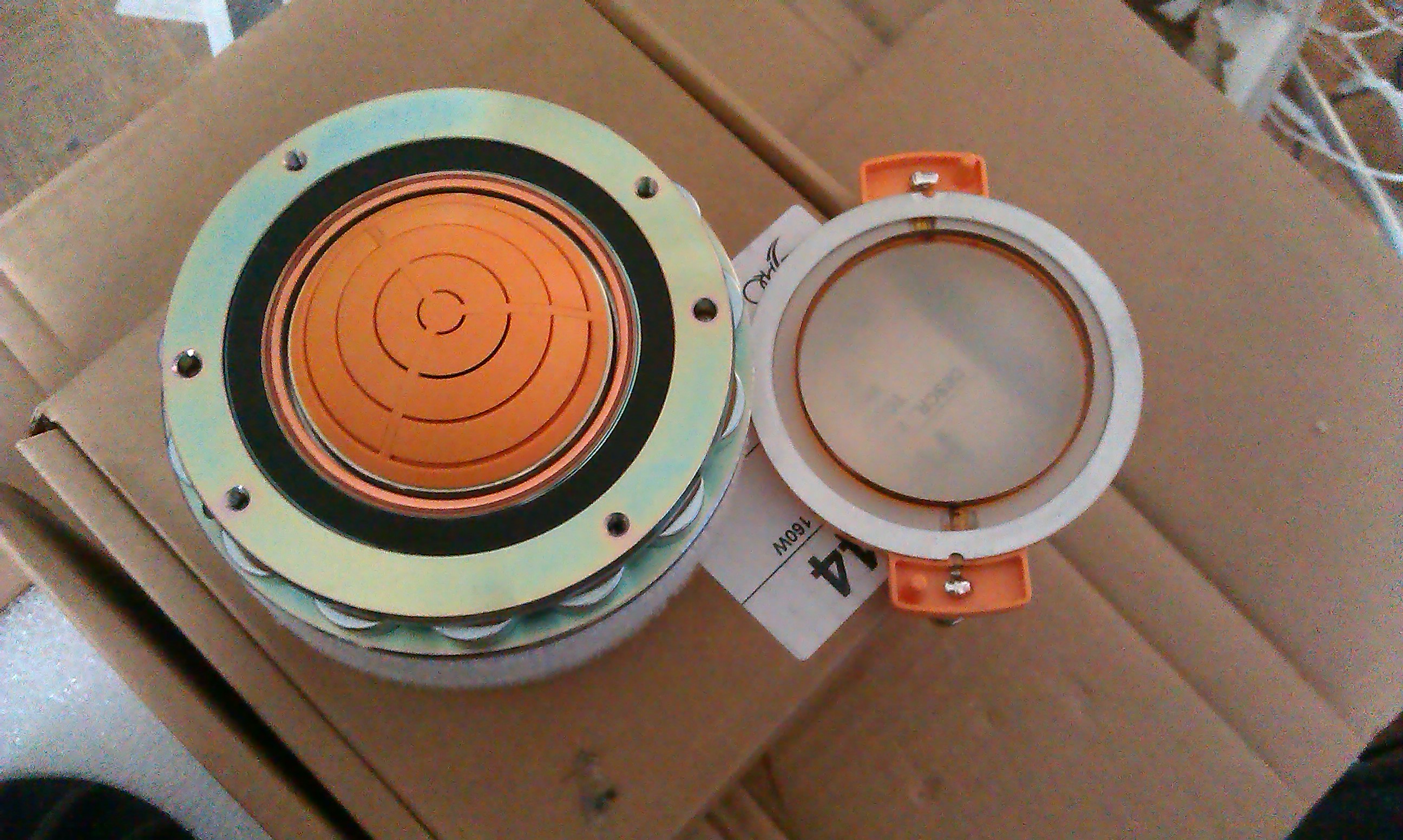

Personally, I'm also interested in this (slightly different kind of) Polymer diaphragm, especially since the driver that hides it includes a copper shorting cap.
It's quite interesting that the HF144 has a shorting ring. The data-sheet doesn't mention one !
The four-slot phase-plug is definitley not a bad thing when it comes to HF extension. I don't know how many 1.4" drivers in this price range have one.
