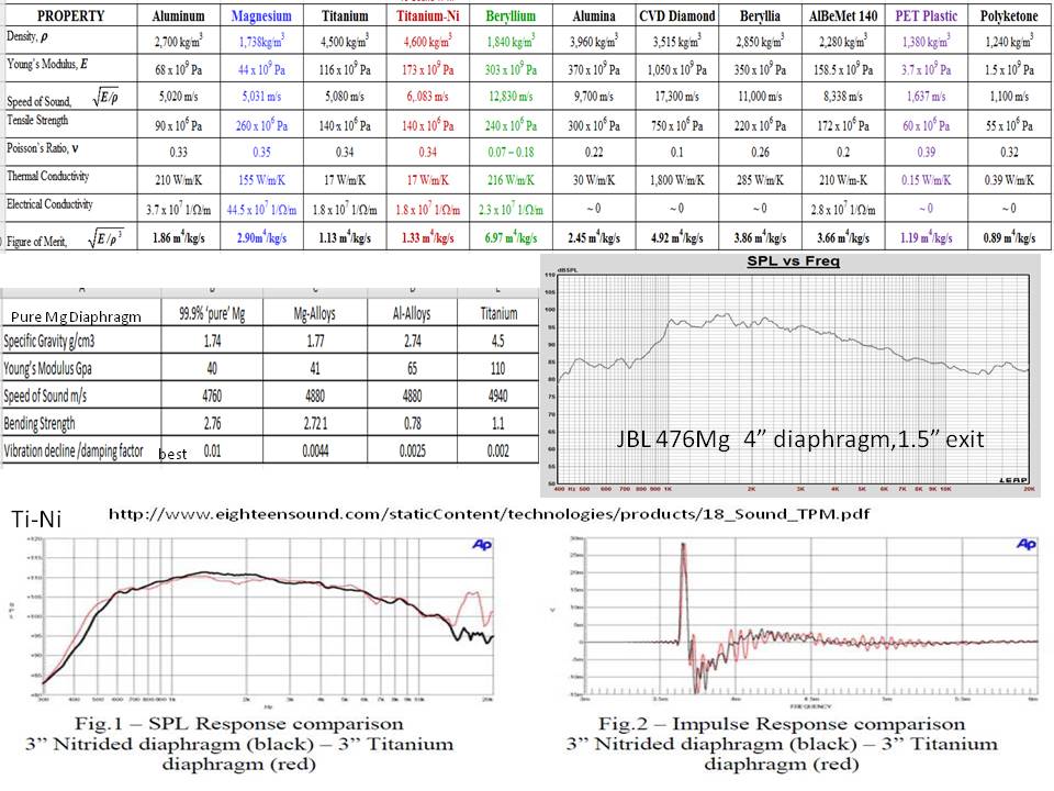

You can find measurements of the 18Sound NSD1095N on the XT1086 horn to help your decision.
ATTACHED: a table of physical properties for most diaphragms. includes NSD1095 vs, NSD1095N
(makes you wonder why magnesium does not get more love)
To reduce breakup, several newer Titanium diaphragms use
1) stamped-in ribs Peerless DFM 254400-8
2) plastic coating Peerless DFM 254400-8
3) Nitride coating ( NSD1095N) -- see table of materials
AND.... now that the patent has expired... plastic annular rings like the BMS 4552nd are everywhere.
All I want for Christmas is the new coaxial annular rings B&C DCX464 compression driver!
Dear Santa at Parts-Express....

LineSource very great schematic over the many different types of membrane materiel,,i can see you know a lot about cd driver and horn,,,respect

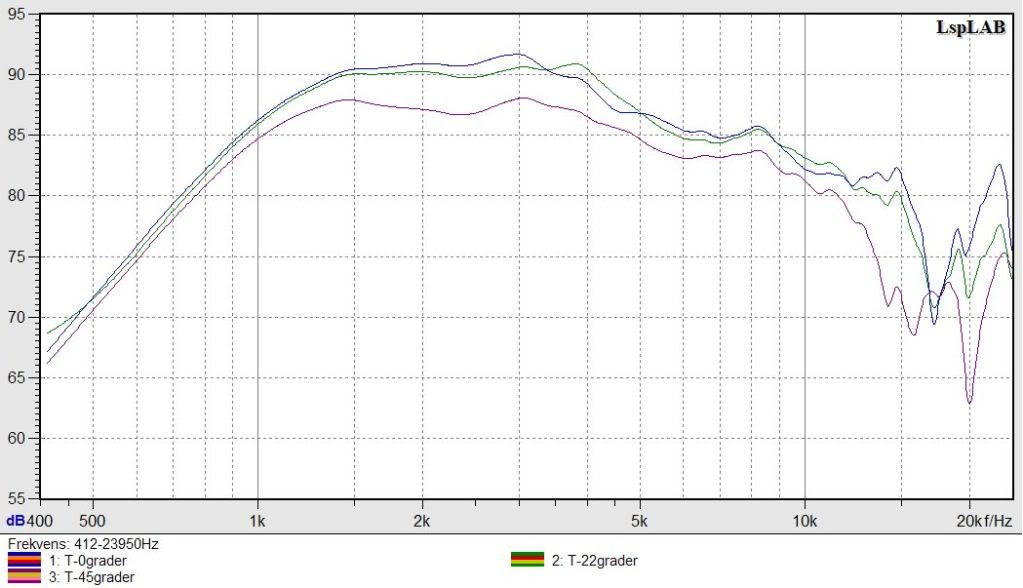

time to tell a little about the Faital HF108
i use it now instead of the NSD 1095 driver
The Faital give med just what i was hope for,,,a more civilized sound than the nsd1095
the Faital sound really nice ,,very fine dynamic silky sound,,,,no metallic sound like the
nsd1095
i use the Faital all way up without coil in filter,,,,i will say that the faital give a little more top end than the nsd1095 (maybe about 2db more )
i have change the filter to be used with Faital,,,(cap and notch filter are change a little)
i use now my Beyma tpl200 from 8 to 20khz (totally overkill,,but measure fine ,lift the top just what i make it to )
Best Bjarne
