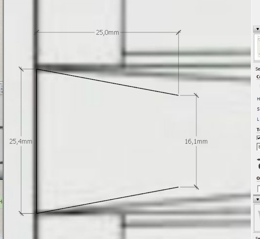

Will the HF10AK fit in to the JBL WG #5006815?
Yes, I did cancel the order.
I want to keep the JBL 2169H as mid and no matter which driver I tried (dozen of 1" PRV, Celestion, Peerless, DE250 etc) none of them have the synergy with it as 2435HPL.
I order a new smaller WG for it but unfortunately it's gonna be complicated cose I have to add a super tweeter. Tried couple and got myself a Fane 5022.
I can confirm the HF108 is more suited for a shallow WG based on eye balling the exit angle.

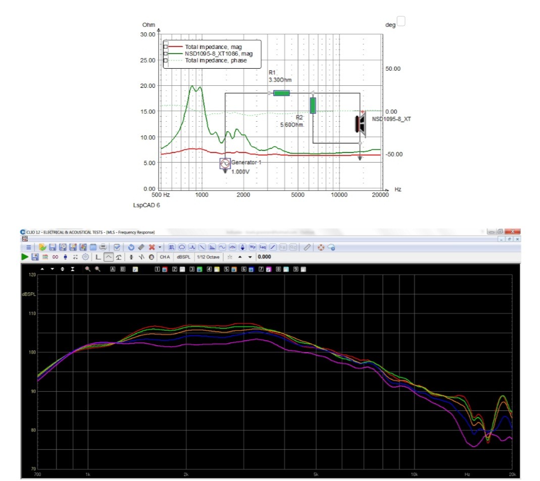

Here's something on the 18Sound NSD1095N / XT1086 combo I found from Troels G, confirming some of my findings. The impedance measured together mounted on the WG shows a very clean trace. Troels uses the driver down to 1.3 - 1.4k with a passive network. My findings with resonances between 1 - 2k are likely baffle step related running the WG on a small baffle compared to the large one used in his tests. This driver needs arallel resistance dampening down low to get the best from it based on Troels application of his attenuation network. It does drive me crazy he doesn't show any component values - I don't see much danger of posting just the HP section using the NSD1095N /XT1086, but it does at least show the WG is more sensitive than usual to various baffle configurations compared to other deeper WGs I've used.

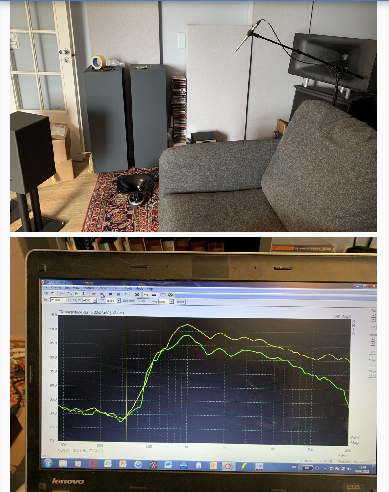

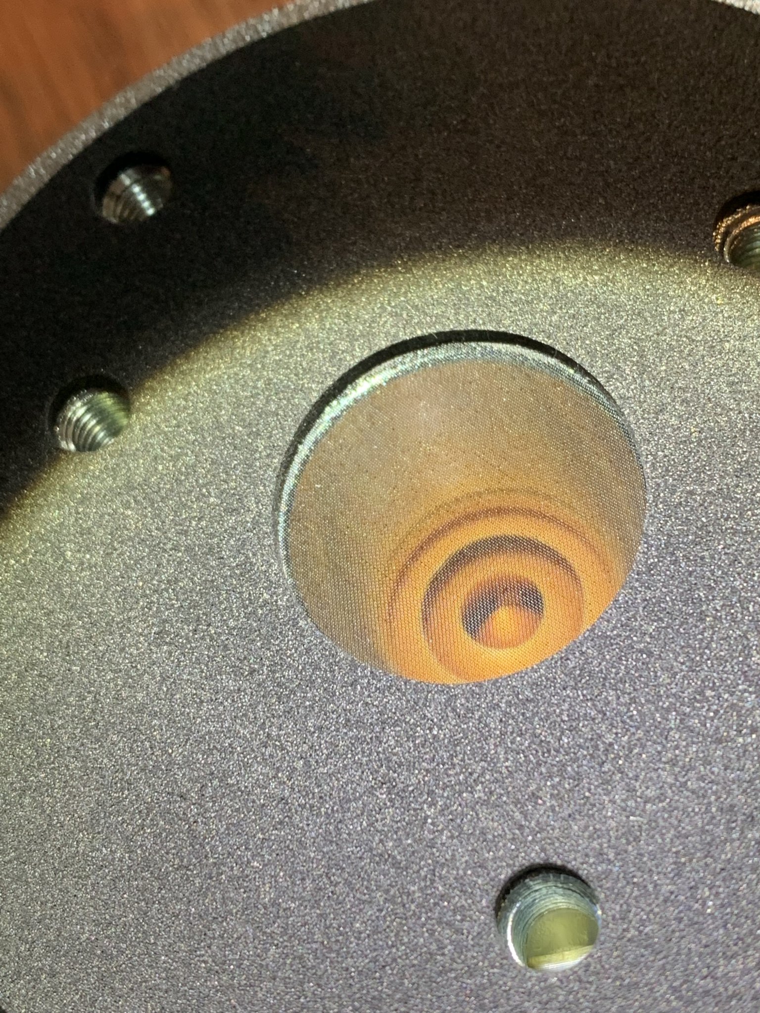

Anyone have an impulse response measurement on the HF10AK on an STH100 or indeed any generally similar horn that they could share here? (or privately by PM) I need a sanity check. I have an apparent ringing problem that might have everything or nothing at all to do with the driver/horn combo. I run them as tweeters from 8kHz up.
Strange - mine measured flatter. But I measured at a shorter distance to be honest.
Regards
Charles
The ripple pictured in the measurments of lower mids will be very audible, but a larger baffle would fix that, so it would be flatter. The XT1086 is sensitive to baffle dimensions based on all these observations. I had to pull out 6 dB @ 1.3k to fix my NSD1095N on the XT1086. You could see the problem in the impedance plot. There is also a throat cavity resonance @ 8k that gets worse using drivers with deeper throat openings.
