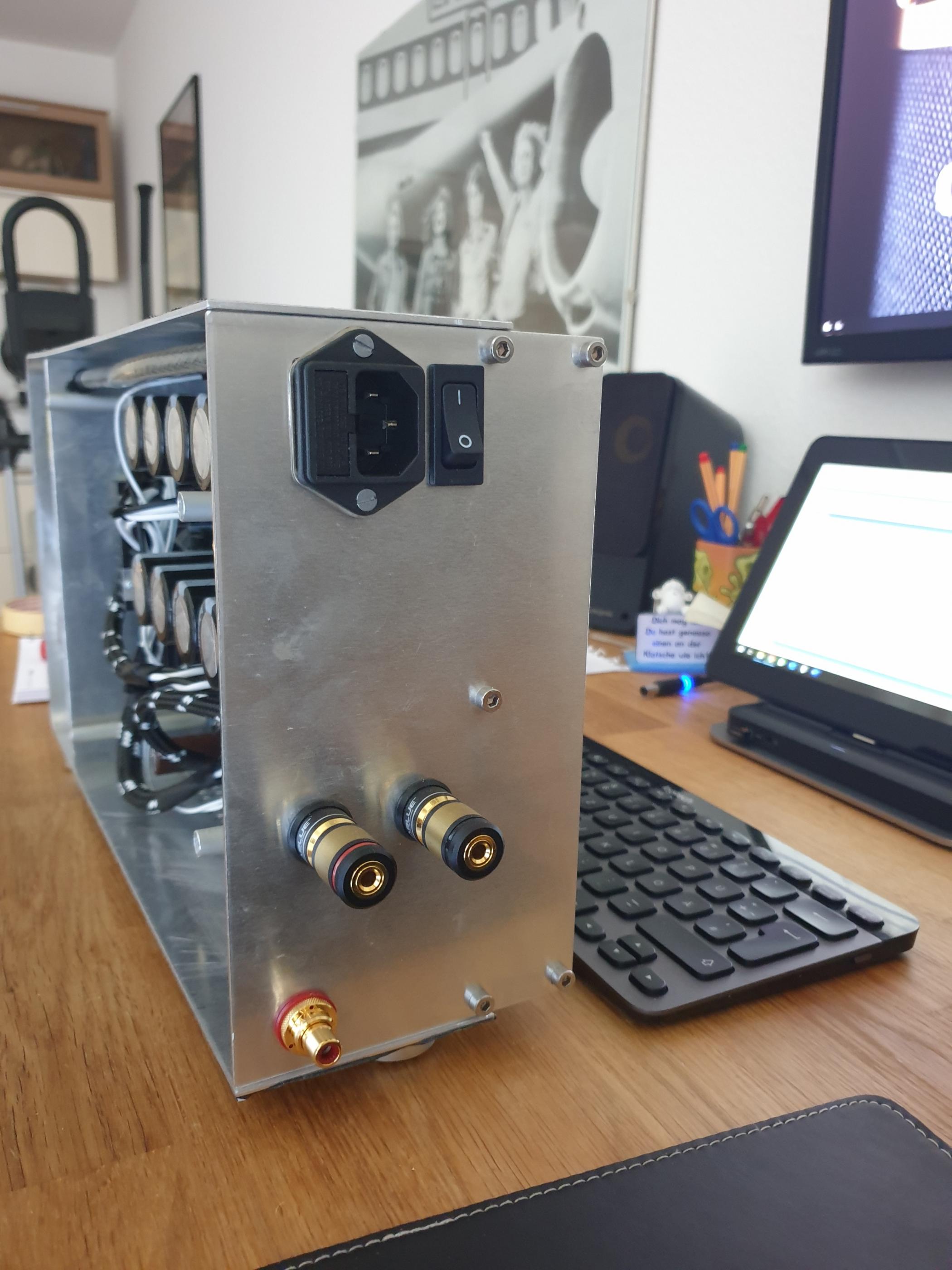

Hello KampfKeks3000,
Love those chassis!
It is your design and did you build them yourself?
Hello @ mqb1965,
@ quafro

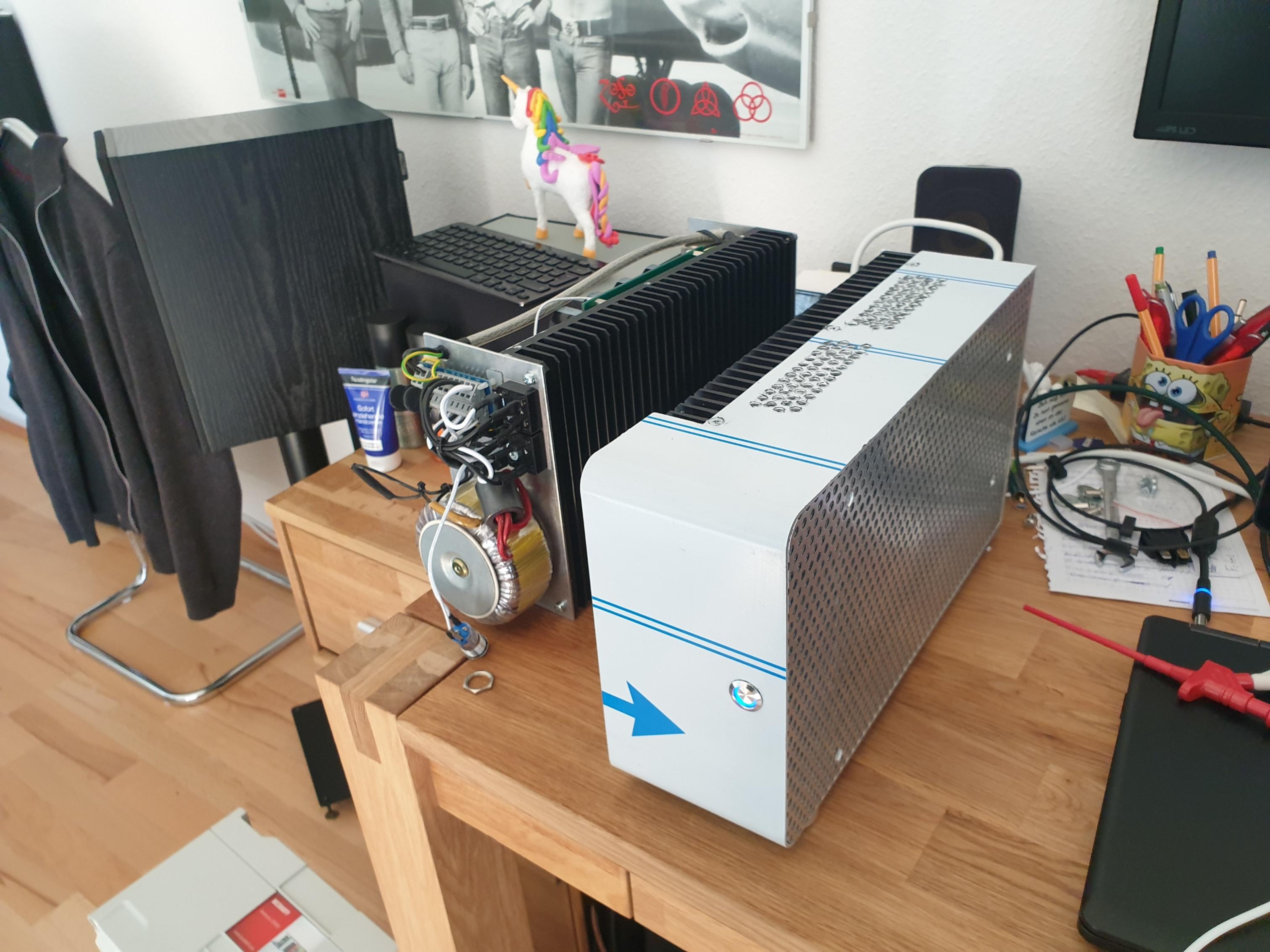

yes it's my design 🙂
I made them by my self in my tiny basement. (With a hand saw and hand drill)
Bending the aluminium sheets was pretty tricky... I had a few tries.
First I wanted to lay them flat on the table, but the produced heat was more than expected so I had to put them vertically.
@ sov
Thank you very much 🙂
When I'm finished with the chassis, I will anodize some of the parts in silver.

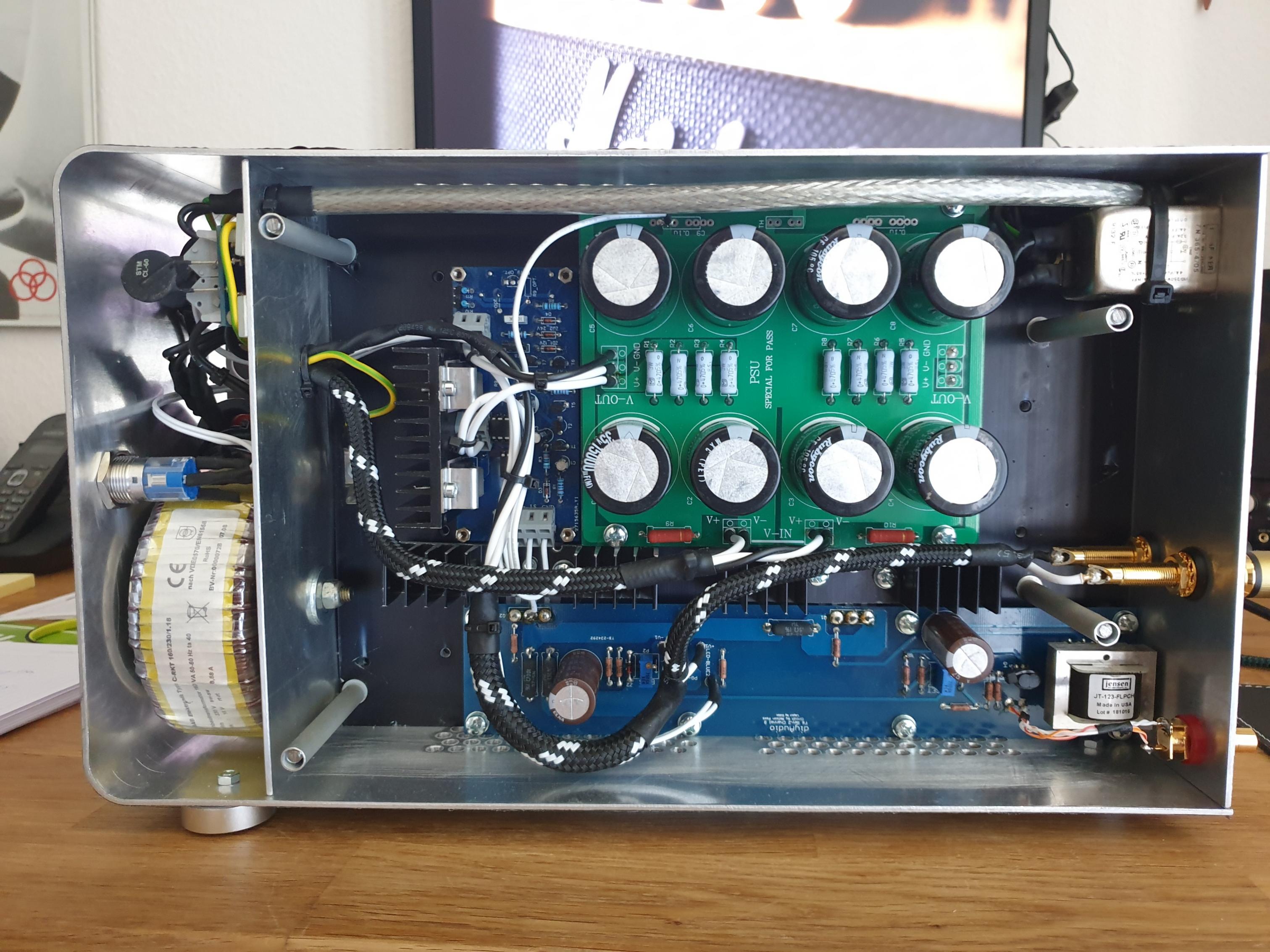

Hey guys,
I finally finished my F6 mono amps.
Unfortunately I had a bit of an accident while switching from my first chassis version to the second one....
I mixed up + and - going to the board...
That cooked one of the 1000uF capacitors.
I replaced both capacitors to be safe, but now I have a harsh sound when turning the amp off and a silent hum when turned on.
Could someone help me sorting out, which part could be damaged, too.... apart from the capacitors? 🙁🙁🙁

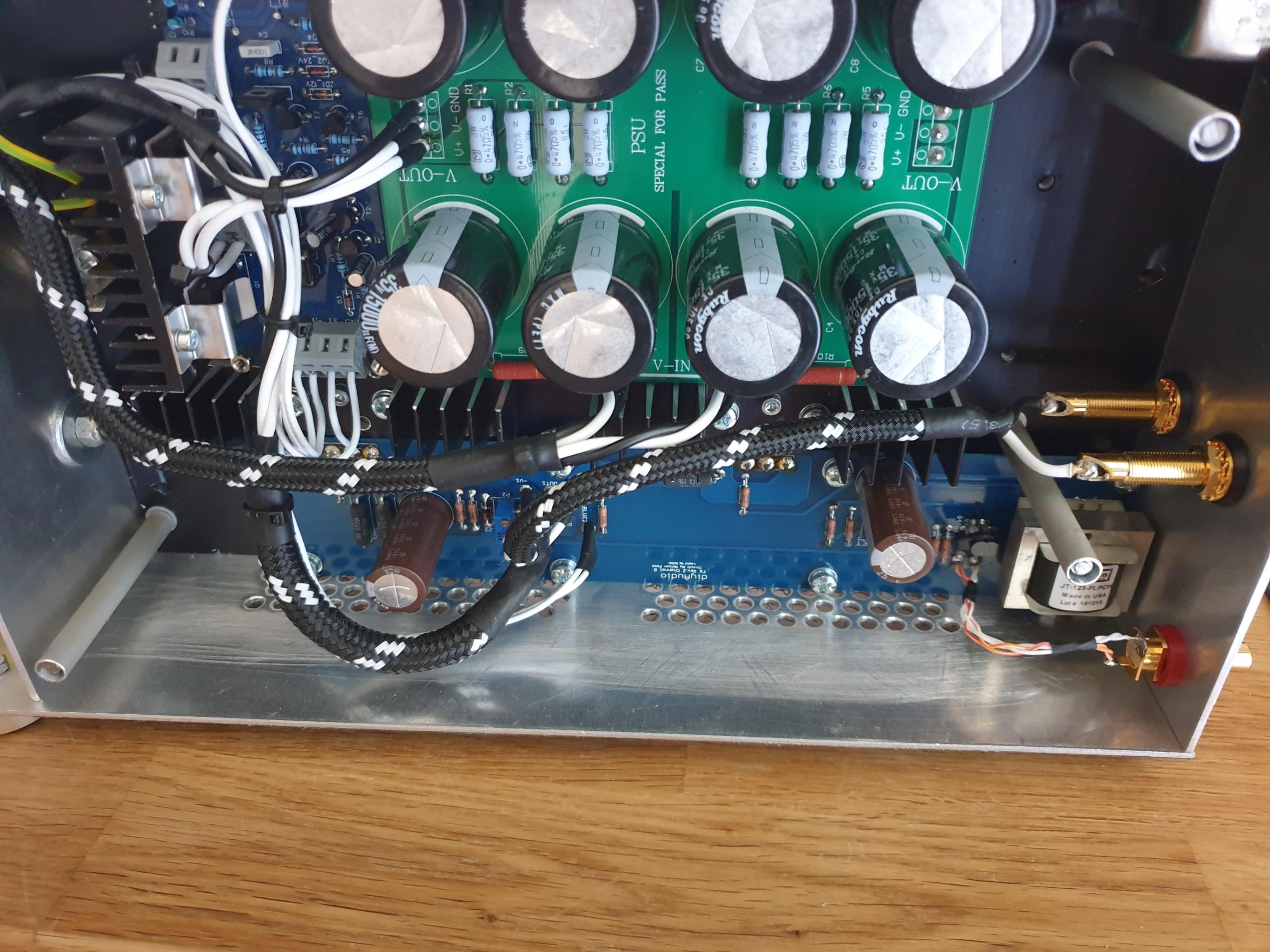

Have you checked the DC conditions, that is the first starting point? If the DC offset and bias set correctly then the input FET's are likely damaged.
If the offset/bias is incorrect then the output stage has suffered. Check that R1 and R2, R3 and R4 are intact.

I think you have to try. All the other component values are to high to pass significant current under reverse polarity conditions.

Well , i did the same stupid mistake time ago , the 0.47 and 0.56 ohm resistors got cooked , all the other components were ok , including jfets
even if the resistors measure ok , you should better change them 😉

One thing that might be worth mentioning is that the two output FET's (IRF240's?) have parasitic diodes across drain and source and that means they should have conducted heavily effectively shorting out the power supply if the polarity was incorrect.
It might be worth you making sure the power supply is still all good and that the rails are clean.

As Mooly said , when we invert the polarity , both the + and - goes to the 0 through the Mosfet diode , the current is 20 Amps or so , if the inverting process is short ( less than 10 sec ) , the output resistors burn quickly , if it last longer , you could have more issues in the PSU
