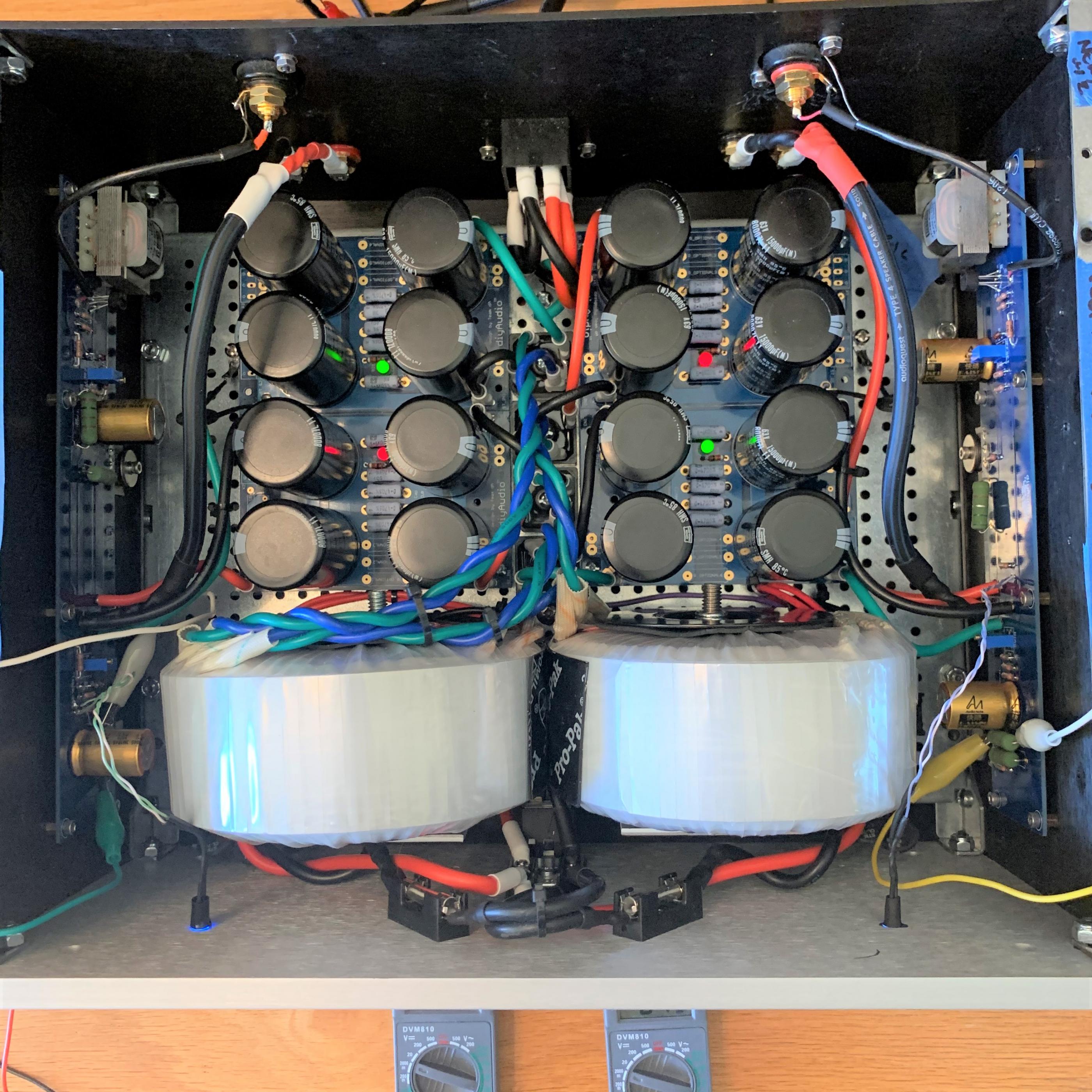

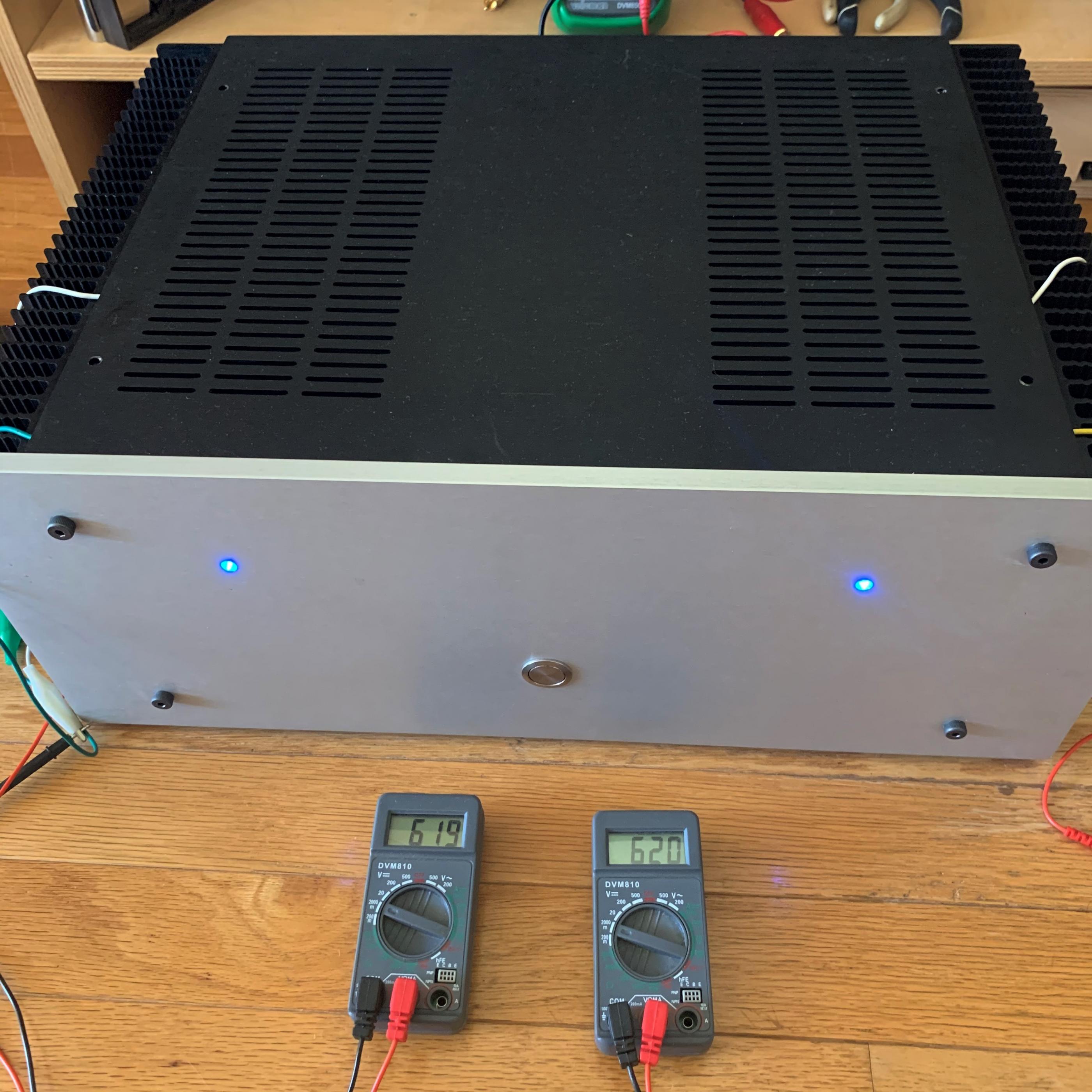

Kind of a slow day here on the quarantine scene, so thought I would post a picture and thank everyone for the help and inspiration that this site and thread gave me. Especially Nelson for the design and support.
I needed to do a rebuild due to outside issues and thought I might as well try to squeeze more parts into this box, inspired by other's posts here. It's tight, but is working well and is quiet.
Thanks again everyone
