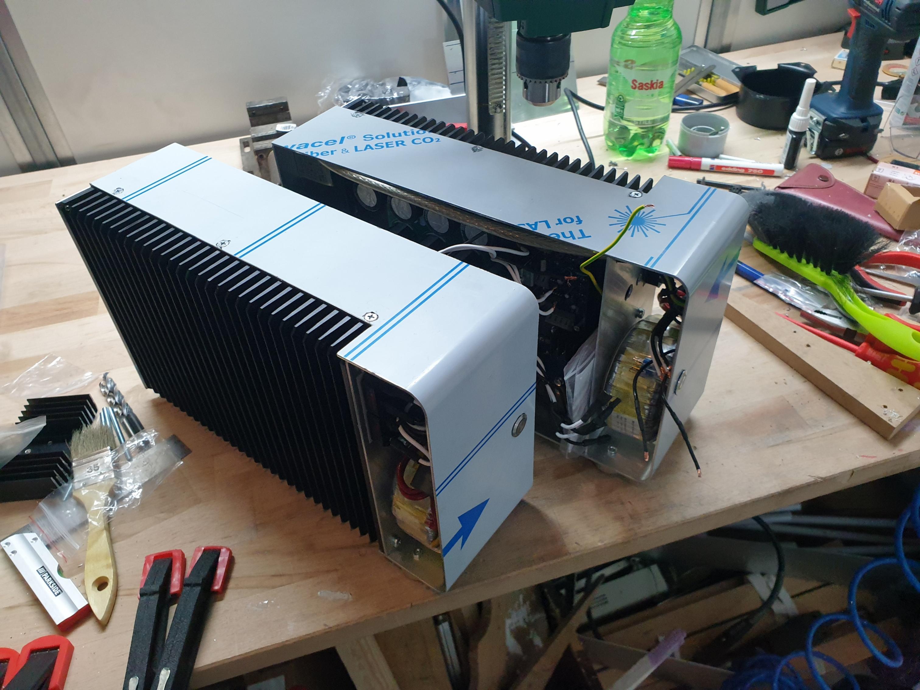

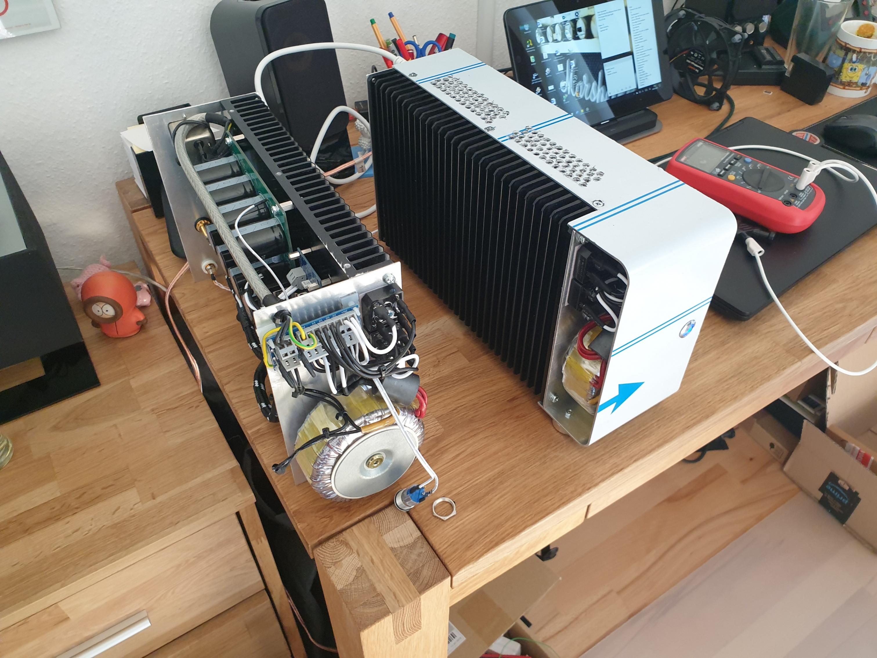

Hey guys,
I finally finished my F6 mono amps.
Unfortunately I had a bit of an accident while switching from my first chassis version to the second one....
I mixed up + and - going to the board...
That cooked one of the 1000uF capacitors.
I replaced both capacitors to be safe, but now I have a harsh sound when turning the amp off and a silent hum when turned on.
Could someone help me sorting out, which part could be damaged, too.... apart from the capacitors? 🙁🙁🙁
Thank you very much.

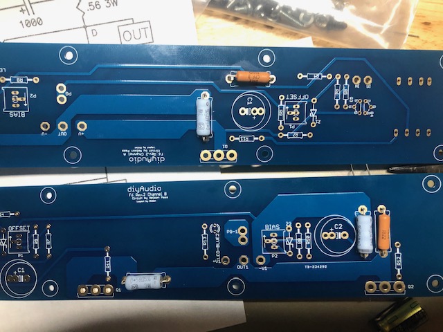

I'm a newby just starting on my F6 - I comparing my layout with the phtos in the build guide it looks like I have R1 and R3 reversed - The Board is missing some labels but I think I am right based on the Schematic (But I'm no expert) -
I am thinking it is just his resistors look different - R1 = .56 3W R3 = 100 3W I have attached pictures of my boards
