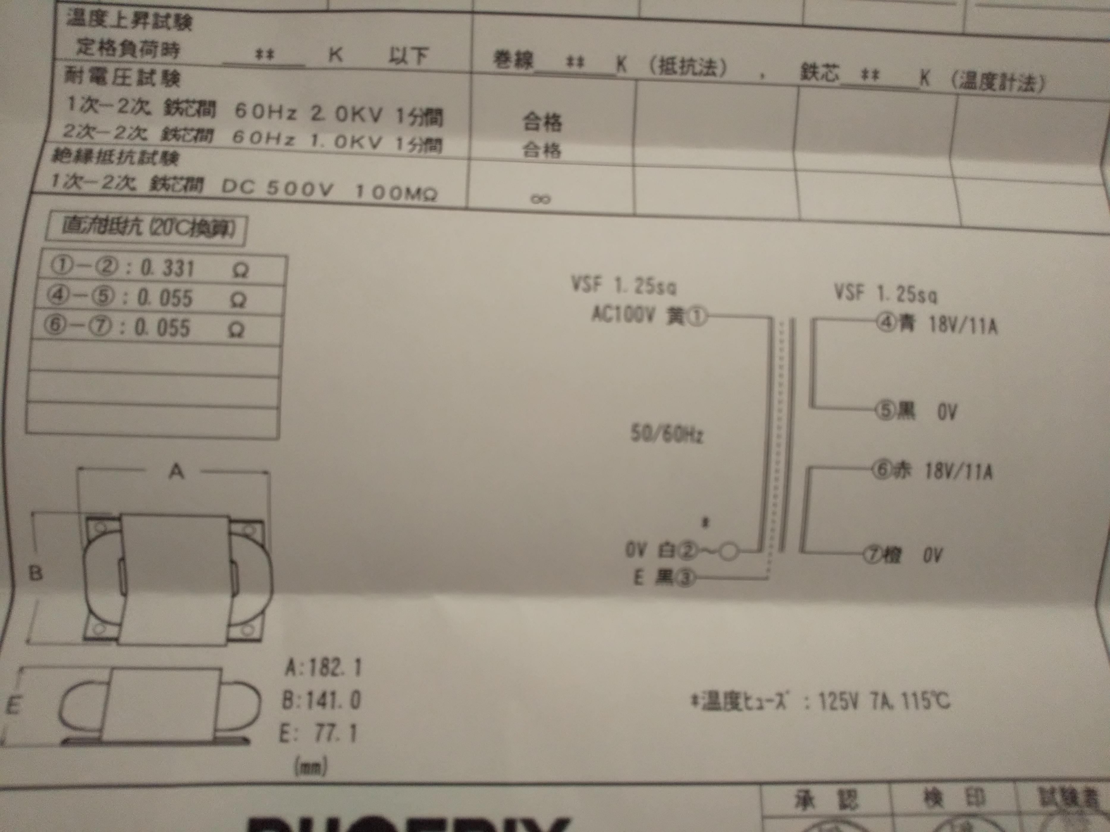

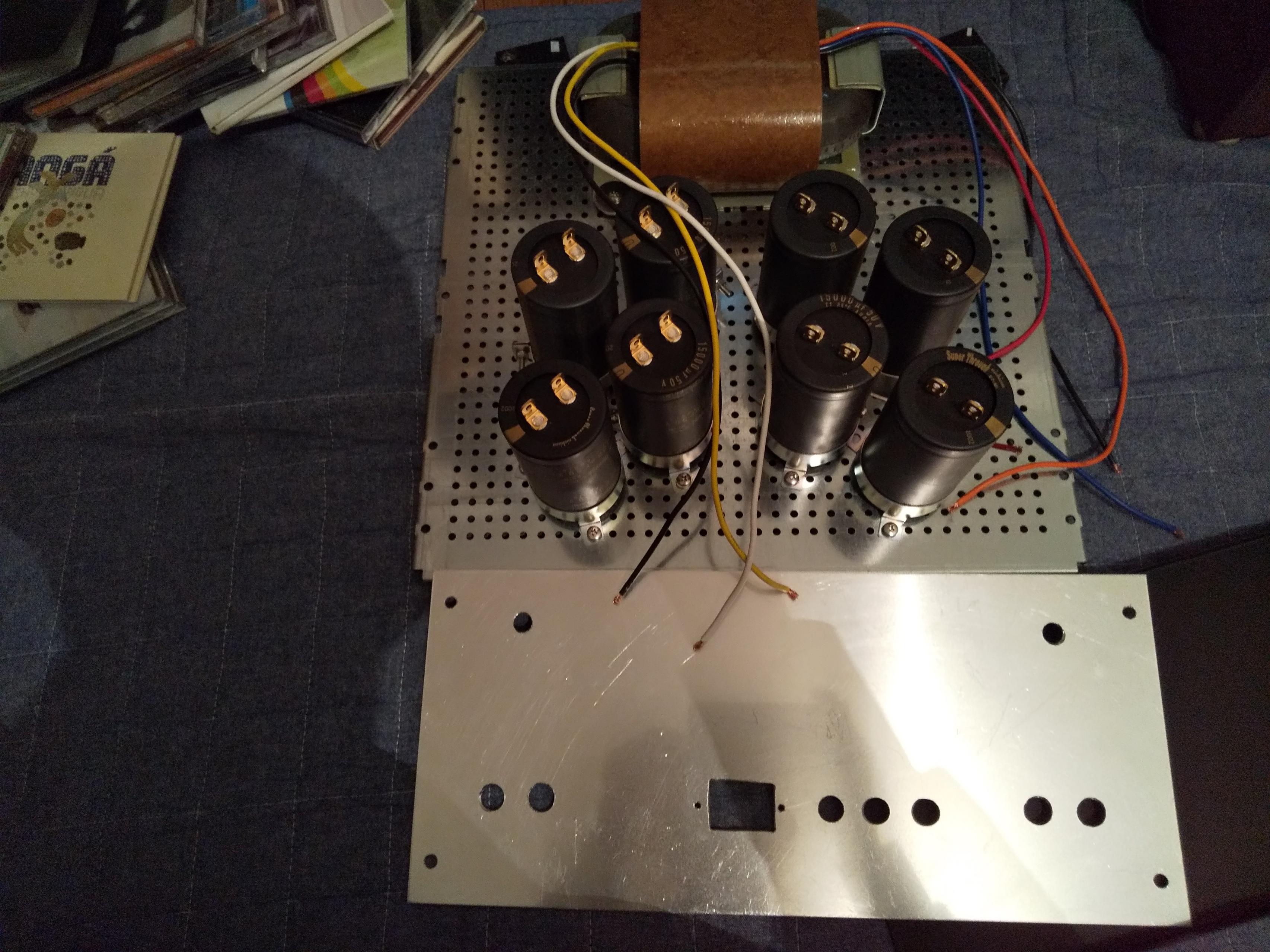

I am happy and appreciated that I could start to build F6 even don't really understanding electronics and audio.
I have 2 questions.
1) My transformer have ground line.
Should I need to connect transformer ground to chaiss or AC in my house?
Here in Japan don't have earth ground on house so may be no connect anywhere?
2) I have sic-sbd 650v 10A. Can I use them?
