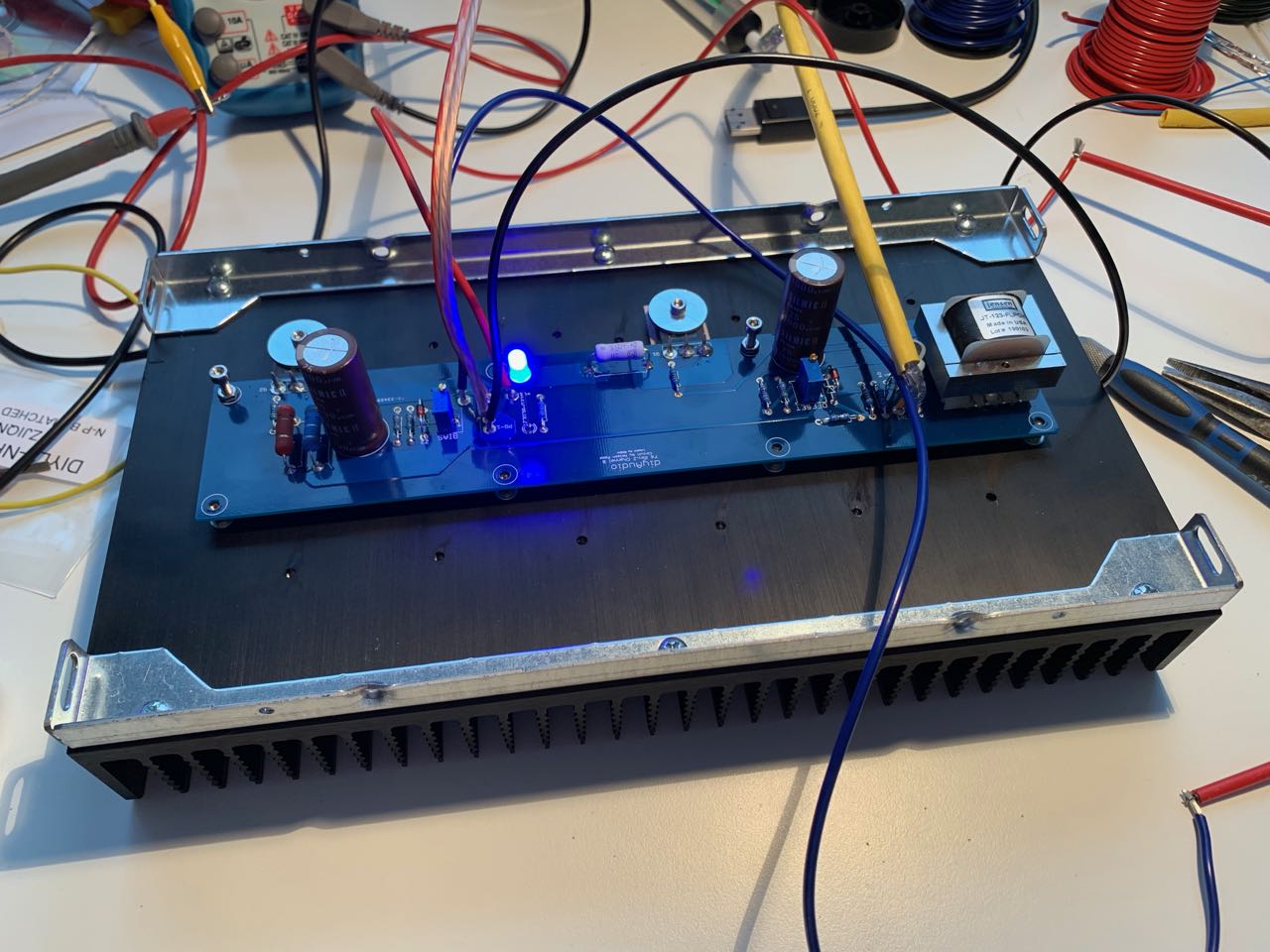

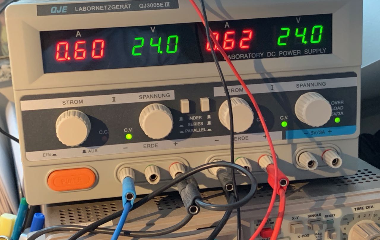

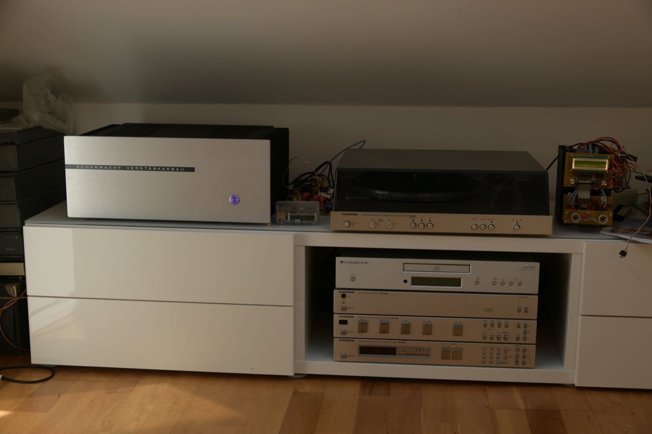

Just another F6 that came to life a month ago...biasing worked like charm - using a 6.1V zener and, can't stress this more, the support of a 2-channel lab power supply. Biasing with a current limiter is really a nice helpful thing 😀
Above being at 0.6 A of bias on one of the channels - I got both up to 0.95A and left it there - after a few hours of idling with the cover plate on I ended at 50 degrees heat sink temp behind the output mosfets, while the drain pins were around 70 degrees - I guess that's good enough...

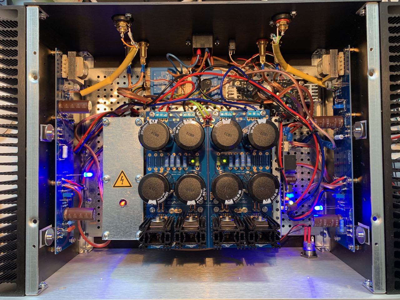

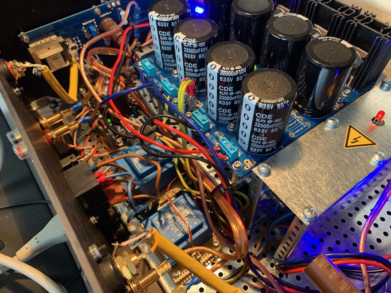

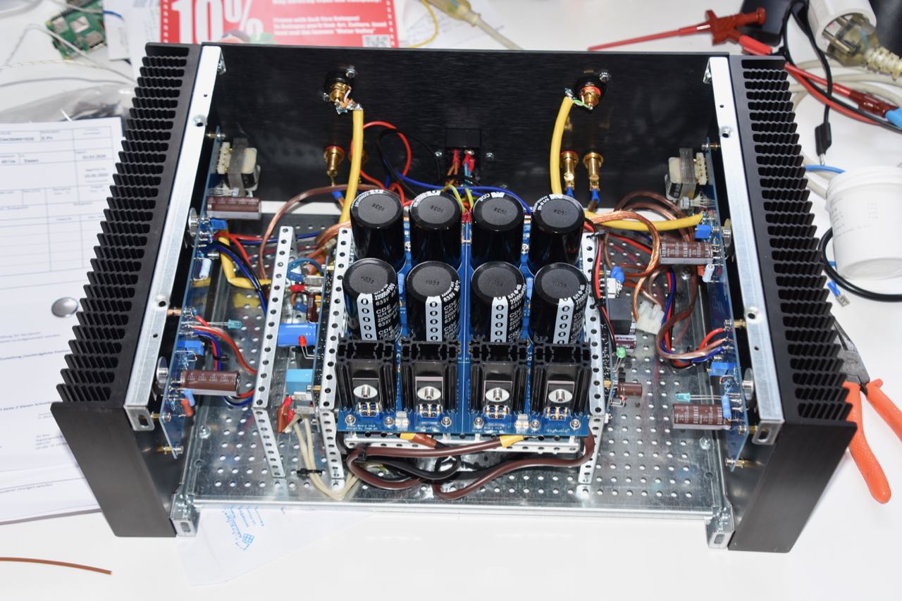

A little bit cramped interior, with the speaker protection board on the right hand side of the PSU, and the soft start on the left hand side - put a divider and later on a cover around the soft start in order to avoid accidental touching of high voltage parts.

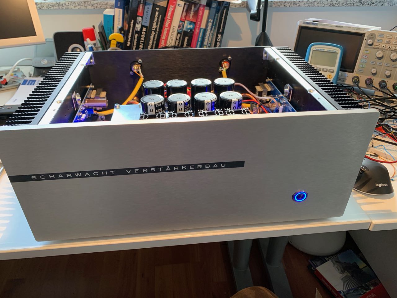

Finally, the face plate and the standby circuitry between PSU and back plate - needs some tidy up, later 😉 The standby circuit ensures that the whole story, including a remote driver for external speaker relais (to switch between amps) is ramped up in phases for around 30 secs, during which the blue on/off switch pulses nicely before going full on when ready to play - toys need to have some blue blinkin' light, don't they? 😀
In the end, this box is set up to be modular, to exchange amp boards later (F5 and Aleph-J planned), so there are quite some non-solder connections for ease of amp board replacement...only the inputs are solders as of now.
Finally, the new amp in its working "position" - in case someone wonders, that ugly thing on the right is an ACA, I maybe show a bit of that later 😎
