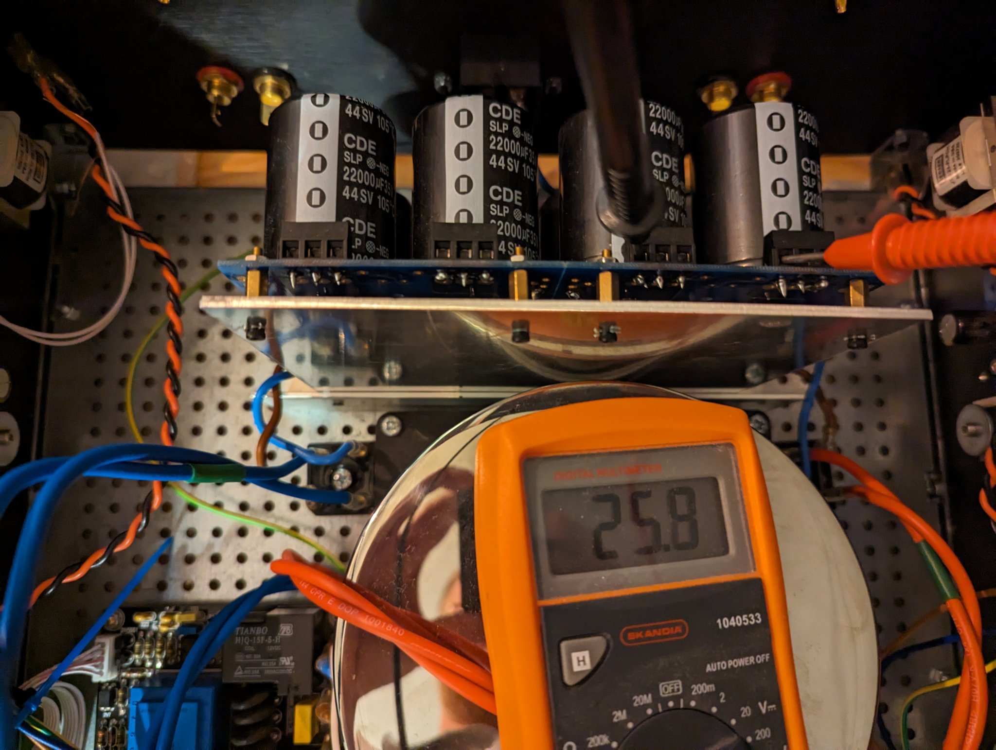

Building a F6 for the first time, maybe someone can help me troubleshoot. The bias at one board cannot be increased higher the then 0.180 v and the otherone stays on zero. What is the best way to check what component is giving the troubles?
Done so far:
Needs to trim of the power cables.
Done so far:
- PSU is giving 26 volts
- Tried to increase or decrease the offset
- The temp of the heatsinks are increasing till from 19 to 21 degrees.

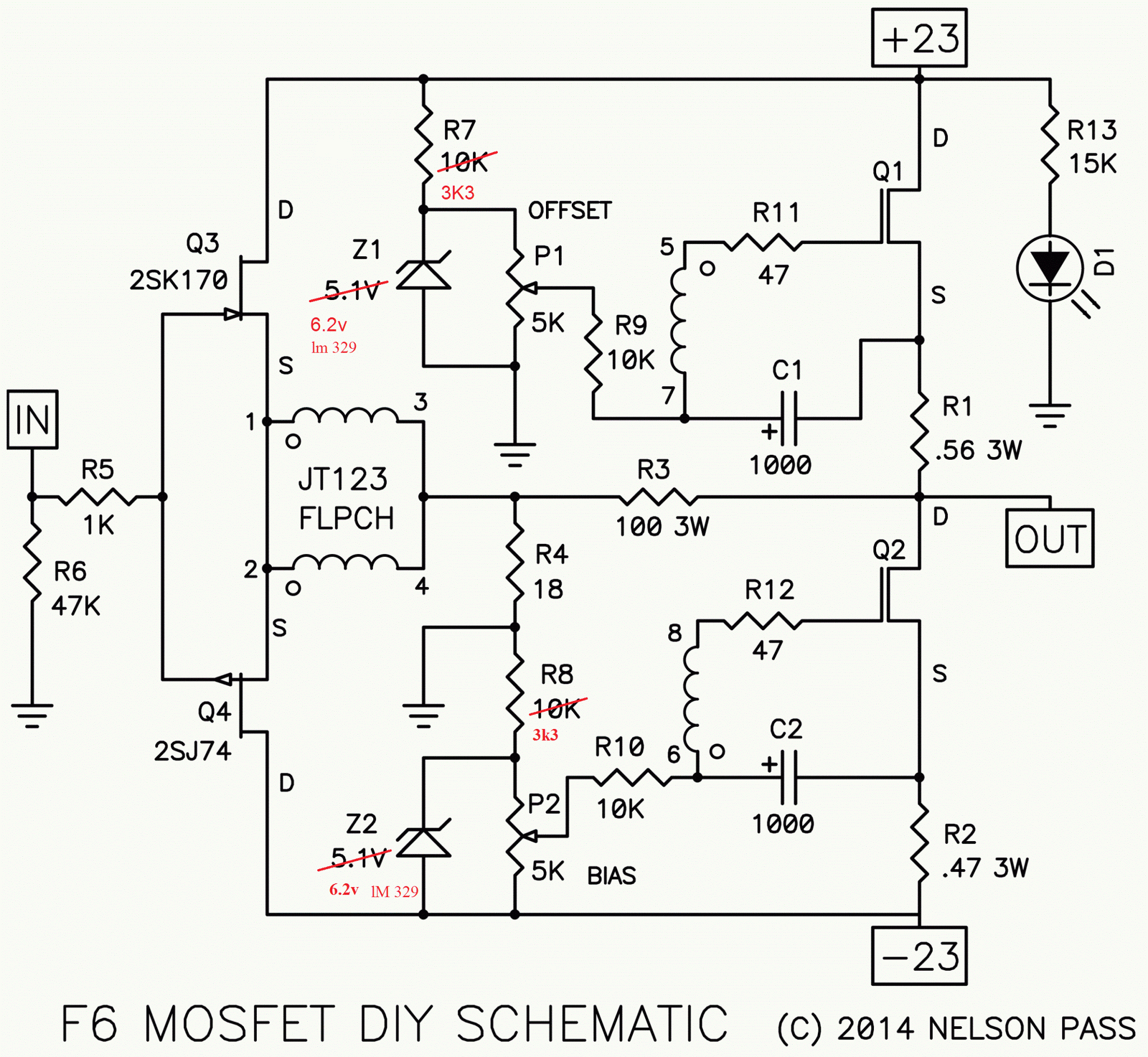

Assuming you are using this schematics from page 1: https://www.diyaudio.com/forums/gallery/data/500/F6_DIY_SCH.gif
1) Please specify R7, R8 resistor and Z1, Z2 zener values you used.
2) Please measure the voltage drops across Z1 and Z2.
3) Please measure voltage drops across R1 and R2 and the DC offset

Both good points.
I would second Ben's suggestion to measure the Vgs voltages of the IRFP240. (Be careful with the probes / clips though!)
The mosfets don't really turn on until you see 3-ish volts between the two outer pins. And these voltages are
controlled by turning P1 for Q1 and P2 for Q2.

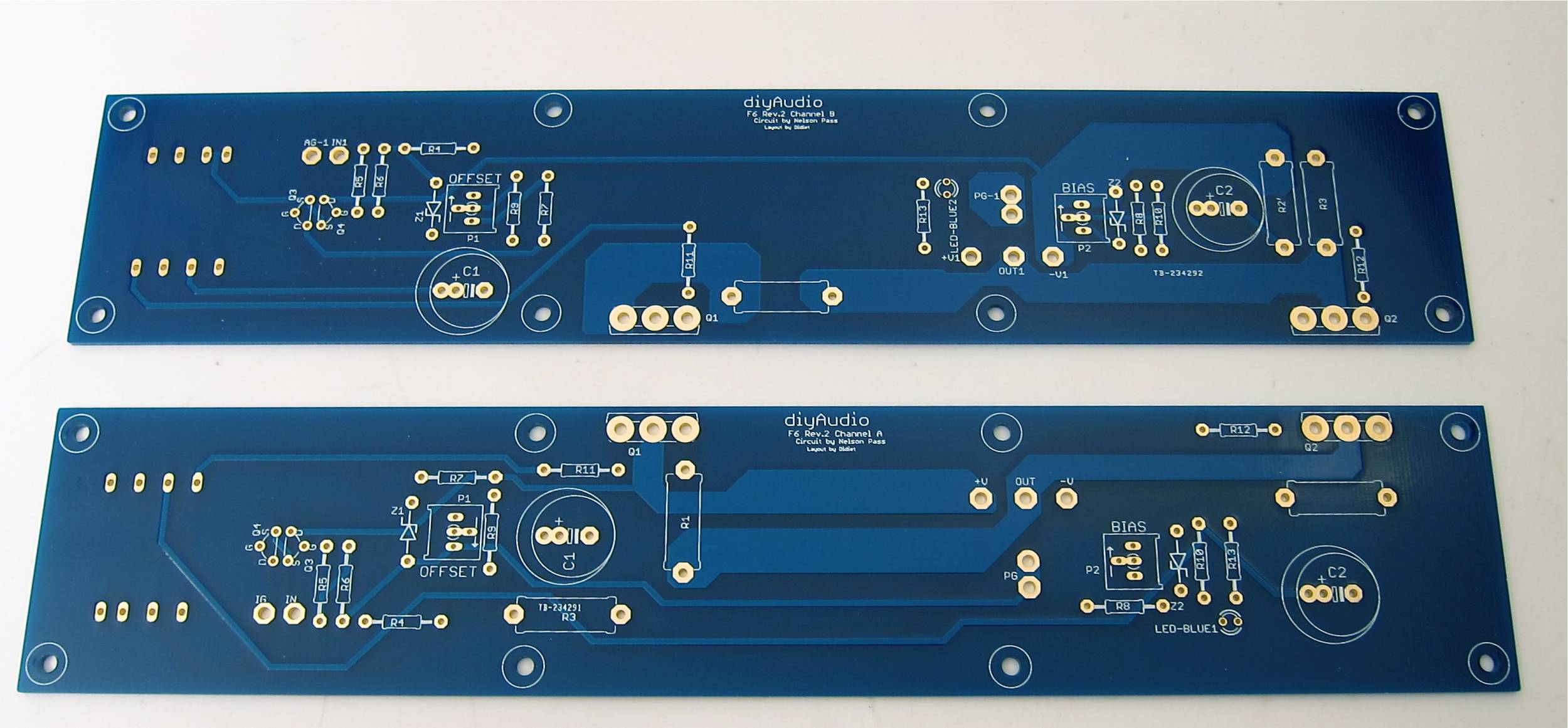

For the power supply voltage on the PCB, please refer to this photo: https://www.diyaudio.com/archive/gallery/data/500/F6PCB.jpg
Have you ground (black) meter probe on PG (resp. PG-1) and measure with your positive (red) probe at +V (resp +V1) and -V (resp -V1)
You should see, say +24 for +V and -24 for -V.
On board #2, does the Q2 Vgs voltage change when you adjust P2? Turn it in both directions at least a few turns to see. If you can get this to change then you might have just turned the pot in one particular direction which turned the bias down. (You can't always count on direction). If you can't get that voltage to change with P2 adjustment then soldering or a bad P2 might be in play.
On board #1, can you adjust P1 to get the DC offset close to zero?
I think your Z1 and Z2 voltages are kind of low. You may need to increase them and decrease R7 and R8.

Board 1: As Dennis said, the zeners may need to be increased in voltage. If 33b zeners are 33V, that is too high. Look for zeners in the neighbourhood of 6V or so. You may be able to get by without reducing R7 and R8 if the zeners are around 6V.
Board 2: The voltage at the zeners is not getting to the mosfet gates. Check the soldering of the pots, R9, R10, R11, R12, mosfets and transformer.
One thing that I neglected to mention is that the Vgs voltage you measure will respond slowly to adjustments of the pots.
It's good that you are seeing some voltage (1.93V) for Q2. Try turning P2 a few times and wait a bit and see if the measured voltage changes.
Did you get the f6 kit from the store? https://diyaudiostore.com/collections/kits/products/f6-board-transformer-kit
If so, the 33B zeners are apparently 6.0V ones which should do the trick.
