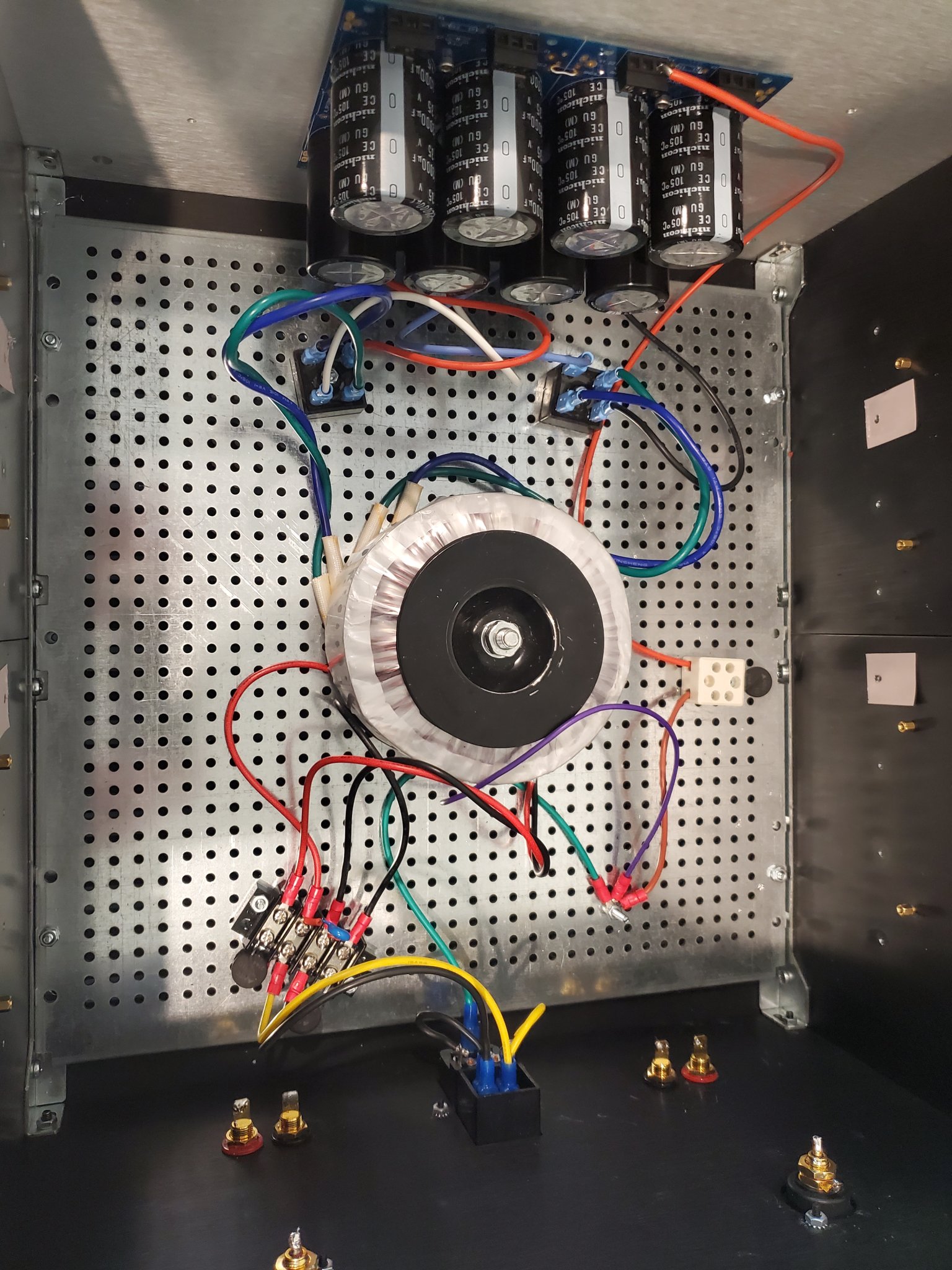

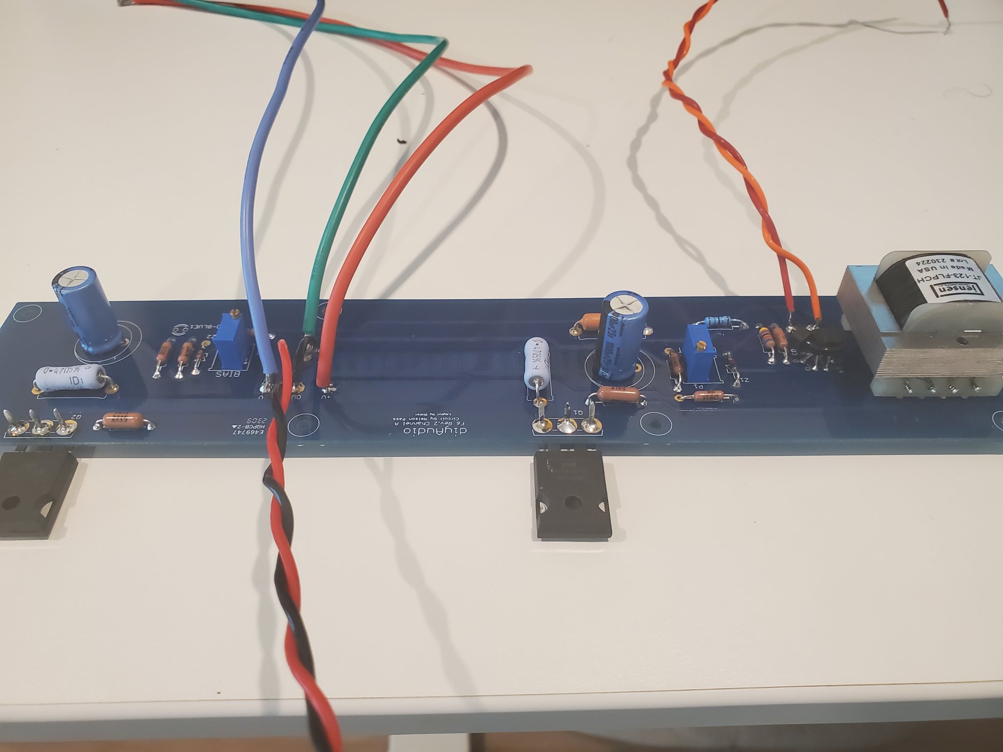

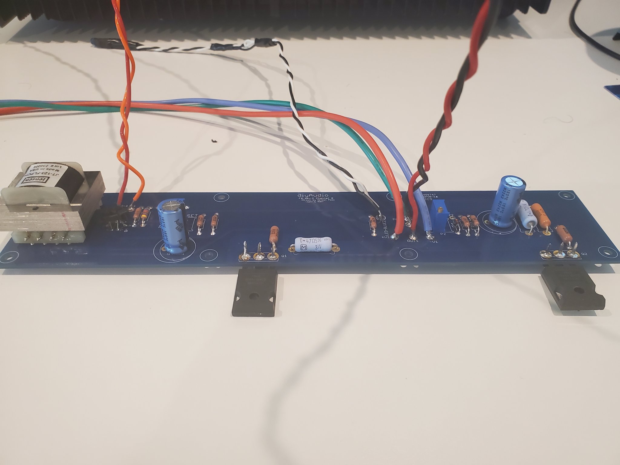

Man, I am bummed. This is my 2nd from the ground-up attempt at an F6 Build (at least the boards), and for the life of me I cannot figure out what is going wrong. For the power supply, it's the same one I've been using for months. With nothing hooked up to it, I'm getting 25V plus and minus, no issues at all. I quadruple (literally 4 times) tested and checked every single component on the F6 boards, was scrupulous on the soldering, and hooking everything up. When I hook up one channel to power, I get nothing, no light no signal, when I tested the other channel, I got the led to light up (after switching it around), then as I was figuring out which resistor to start measuring bias, I got smoke from that board, and immediately blew a fuse. I built an Aleph J, 2 ACA's, and a B1 Nutube preamp, all with really no issues, something about this board is messing with me. The only thing I can possibly think is that even though I shut off the mains power, while I was switching the LED around, the board was still attached to the PSU, so there may have been some very quick connections and shorts to the circuit. When I realized this, I immediately disconnected the 3 wires to the PSU, but maybe I damaged something in the process? I'd appreciate any help here, I am so beyond frustrated with this amp, maybe I just need an early beer. I can send pics. Thank you in advance.

No it's a legit question for me in this state, for sure. Thanks everyone. But yeah, it's plugged in. One question. (When it's not plugged in) should I have connectivity between the IEC mains input, like the 3 prong AC inputs and the Euroblock connectors at the top of the power supply board, after the transformer, rectification and capacitors? I don't, but checking. I am seeing connectivity between my +, -, and ground AC mains in through to the terminal block, and on the ground to the thermistor when the power switch is on (trying to see if something is funky with my fuses). Don't know if I'm supposed to see connectivity beyond that. When I plug in and turn on, I get nothing.
Joined 2012
No direct connection between PS board and IEC because of the power transformer. You should get direct connection from power cord connected to IEC and the terminal block in the chassis that is connected to the IEC. So check that both prongs of the power cord has direct connection to the terminal block. That will let you know that the fuse is installed correctly and is not blown.
You can also check for AC voltage at the AC side of the rectifier blocks and check for DC voltage on the DC side of the rectifier blocks.

Zeners were straight from the diyaudio store 9.1V, along with the mosfets from them as well. I had not touched P1 and P2 prior to power up.

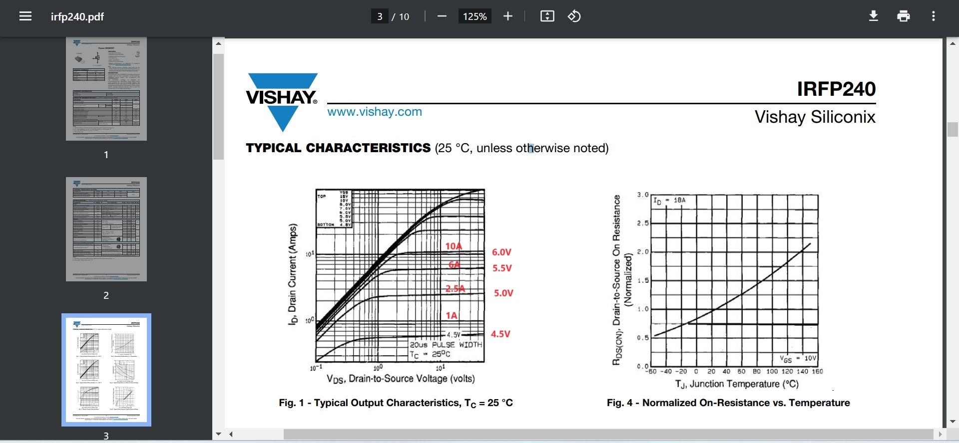

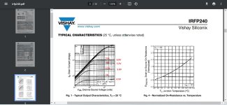

9.1V zeners can be bad news if the trimmers were set for maximum gate voltage. 9.1V at the mosfet gate is essentially a short from drain to source. If the trimmers were left in the midway position from the factory, then probably no issues. But this is diy and trimmers may be set haphazardly, and when combined with other possible issues, it can cause a lot of grief.
If more gate voltage is desired, I would think a small boost in the zener voltage is safer. Looking at the IRFP240 specification sheet, even 6V at the gate of a cold IRFP240 will get 10A of current.
