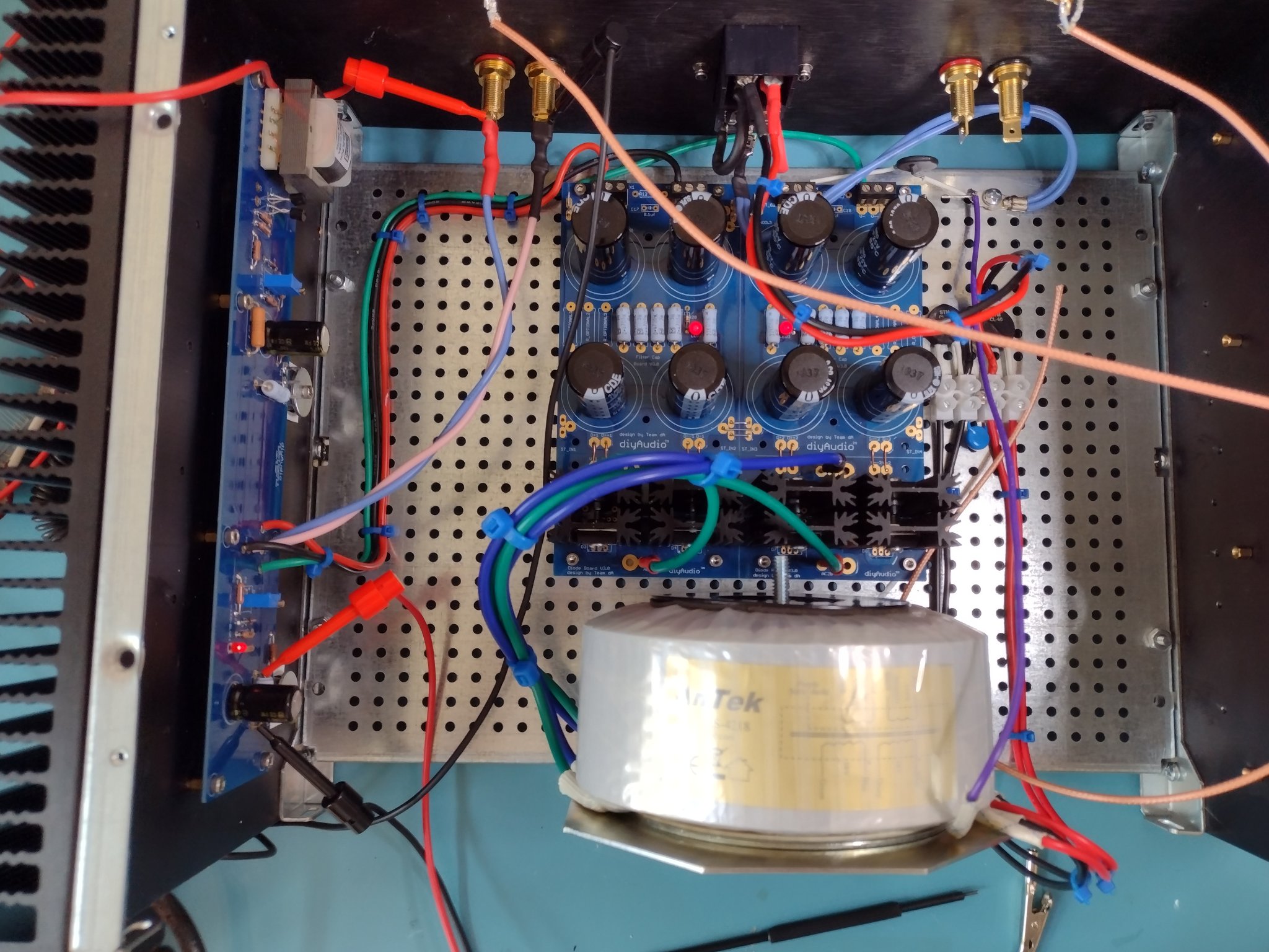

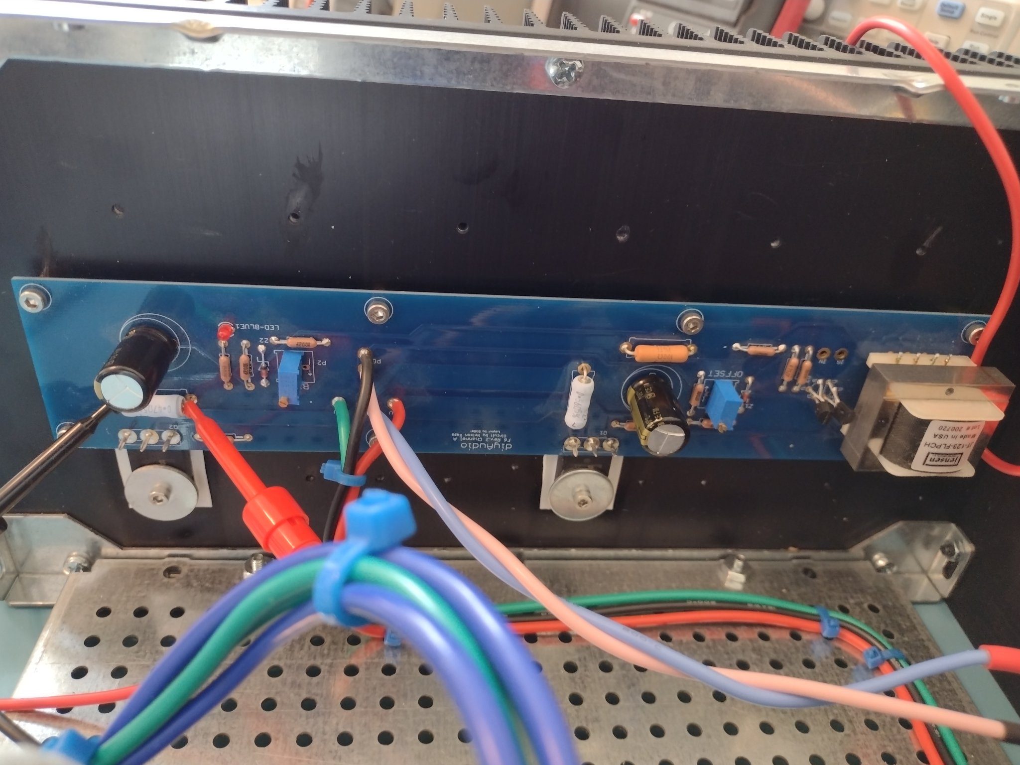

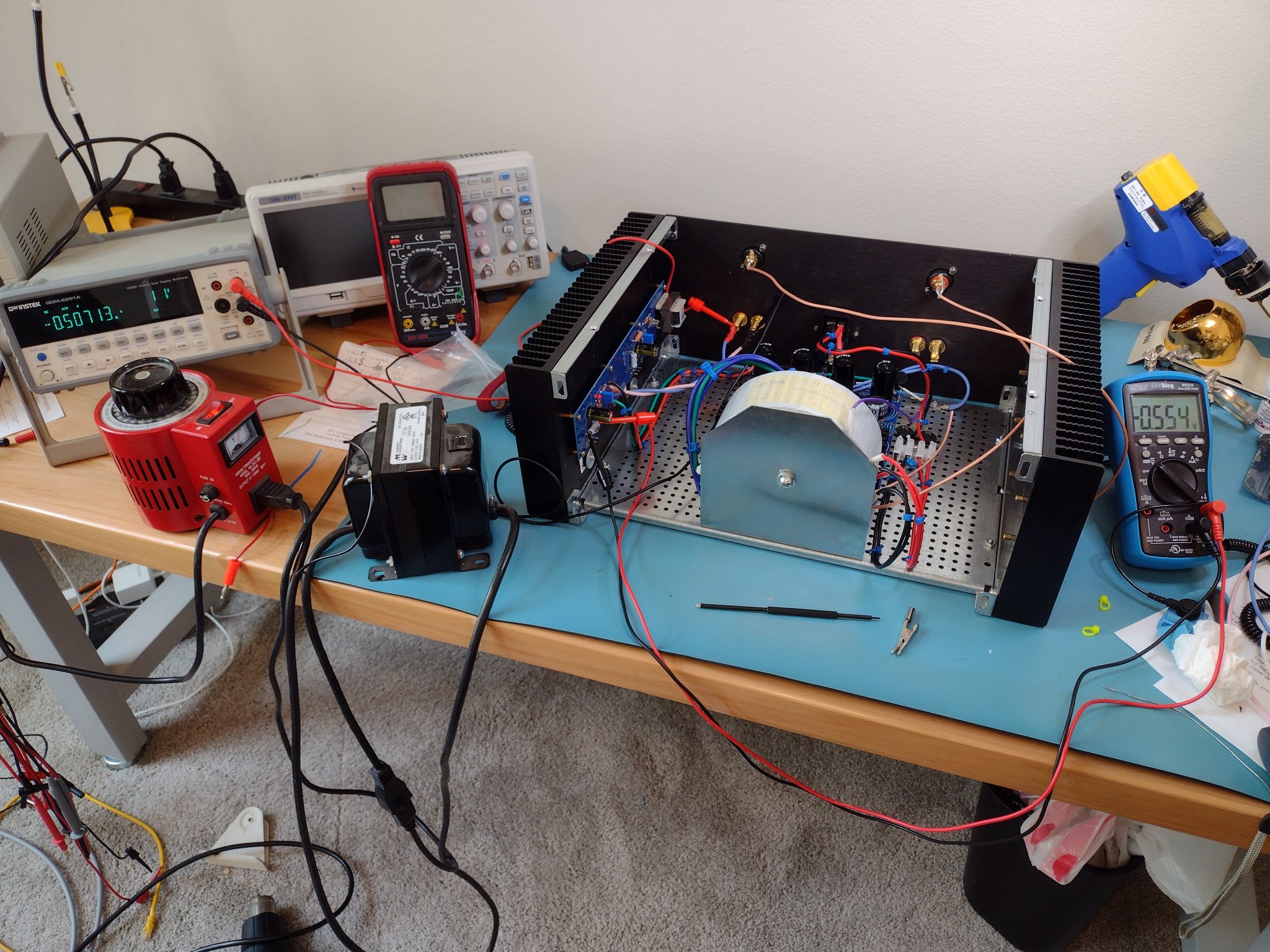

I've been banging my head against this problem, hope someone can point me in the right direction...

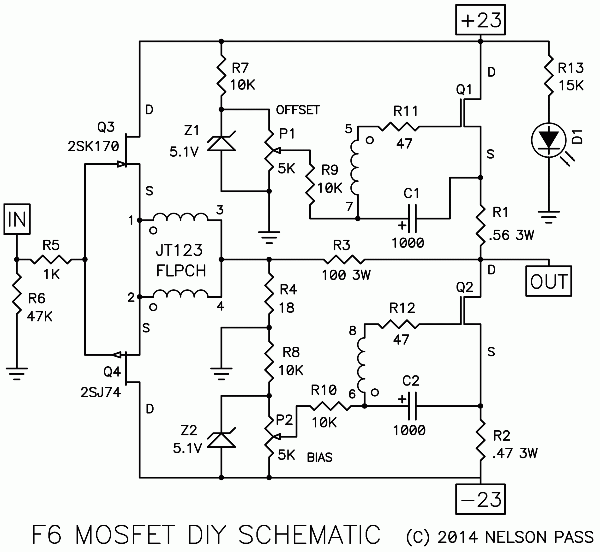

I've got one channel installed and am trying to set bias and offset. with bias set to 0 volts, I can get offset to zero no problems. However, once I set bias past around .28v, I can no longer decrease offset to zero. As I increase bias, the offset seems to hit a floor and will no longer decrease. There are plenty of counterclockwise turns available on P1, but turning has no affect on the Offset. This effect increases in severity as I increase bias. Once I set bias to around .5v, the offset is also around .5v and will not go down even as I make several turns counterclockwise with P1.
Can someone point me in the right direction on how to troubleshoot this? I was very careful to check all resistors when I ordered the parts, and I double checked each part as I installed everything. I am planning on installing the other channel circuit board this afternoon, just to see if it exhibits the same behavior.
Voltage across Z1 is 4.5v, Z2 is 5.9v. Q1 and Q2 read 4.5v. Temp on the MOSFETS is around 39c
Thanks in advance for any tips!

I’m assuming you’re giving plenty of time between adjusting pot labled bias and then adjusting the pot labled offset?

The 5.1V zener diodes, Z1 and Z2, set the maximum bias voltage to the mosfets. 4.5V across Z1 is too low, so it's best to replace it.
Just to be clear since it seems the term "bias voltage" is used on the forum to describe all sorts of things, I am referring the the voltage at the mosfet gate.

value of resistors in series with zeners?
if in doubt, post your ref. schm
It does look backwards.it may be the direction of p2
@jbholman56 : 4.5V for Z1 is kind of low even if it's a 5.1V zener. One possibility is that's it's current starved. Can you please answer ZM's earlier question about the resistor values you used for R7 and R8? (I'm referencing the schematics from page 1: https://www.diyaudio.com/archive/gallery/data/500/F6_DIY_SCH.gif ) Also, can you confirm the Z1 and Z2 values you used? (You mentioned a 5.9V measurement for Z2)
For an explanation for what Dennis is looking at, read post #27 by ZenMod few years back. The general recommendation has been to use a smaller value resistor for R7, R8; for example 3.3K ohms. If they are 10K ohms, then the zeners are current starved.

I will replace the zener with a known good 5.1v, as well as reverse the direction of P2. if that does not fix the issue, i will research the zenmod link provided and revisit those resistor values (I am using what was in the BOM). Thanks for all your suggestions, i will try this tomorrow morning and let you know the results...

Physically reversing the whole trimmer pot won't make a difference. Check the resistance across R7 and R8 as suggested.
You can use this calculator to see what resistors you can parallel with your 10k's to get the current that you need. For instance, a 10k and a 5k give you 3.33k. It doesn't have to be 3.3k on the dot. Just a good amount lower than 10k.
Reducing the value of R7 is a good idea to increase the current, but I do not believe the zener is current starved if R7 is 10k. If the PS voltage is 23V and the zener is current starved (not conducting), the voltage across the 5k trimmer would be closer to (5k/15k)x23V=7.7V, not the measured 4.5V.
I think it is most likely the zener has a voltage tolerance of of 10% and the zener installed is at the lower end of the allowed tolerance. So replacing the zener is likely still required.

I replaced the zener, and am now good to go! I measured the replacement zener before installing, and meant to post measurements on both the old and new, but I cannot find the old one. If I can find the old one I will measure it and post what I find out.
I will read up on the R7 issues you mentioned before proceeding with installing the second channel, in case I want to try those suggestions.
Many thanks to everyone! Brad
