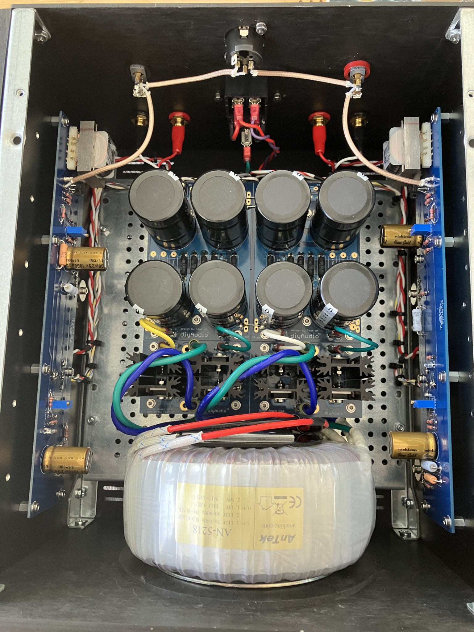

Picking the balanced output from one channel from the preamp:
XLR Pin 1 goes to signal ground on one board.
XLR Pin 2 goes to + input on the Right board
XLR Pin 3 goes to + input on the Left board
(I accomplished this by wiring the XLR to the RCAs, minding the need for only one ground connection to either RCA)
The speaker outputs will stay wired the same as a single stereo amp:
"+" output on R board goes to right + speaker post
"g" output on R board goes to right - speaker post
"+" output on L board goes to left + speaker post.
"g" output on L board goes to left - speaker post
Then hook up the speaker to the two + speaker posts.
I know someone has a schematic around here. Best I can do is a picture.
Requires two stereo F6s. @6L6 heard these and was amazed. Lots of oomph.

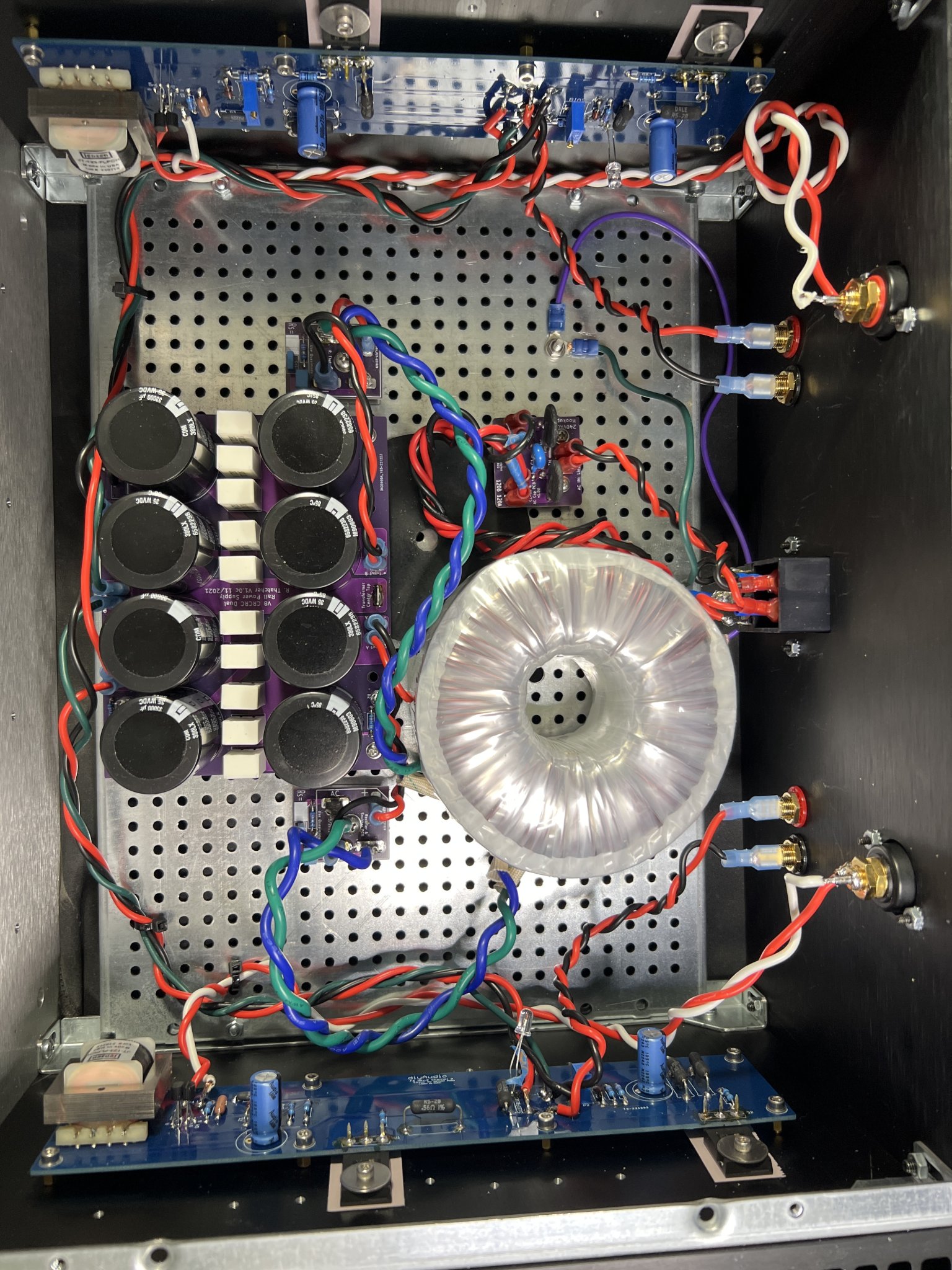

@6sX7 So I actually just figured out the hum. I first loosened the donut and tried rotating it to no avail so I detached it and tried it in vertical but no better. I noticed hum dropped to almost nothing with the donut at 45 degrees. I also found that just moving it away from the AC IEC inlet solved the hum.
Moving the donut close to one or other transformer did not change the hum, so I’ve concluded it’s the donut picking up ac line noise.
In my Alephs I had the CRC and donut side by side and have zero hum, but in the build guide the power was all central from back to front and I tried to replicate. I did buy the mountings to get the donut vertical rather than flat so I’ll use that now (hum dependent) it will give me more room for a back to front PSU.
It means I have to do a bit of a rebuild and I’ll get the donut as far from the IEC as possible and may flip the boards 180 to get the transformers away from the antek.
But I’ll play around with the arrangement and find the best one, and I’ll let you know what the final result is.
Thanks for the help!
suggestions:
1. flip donut to front as you mention.
2. keep AC leads from IEC to donut short as possible, down the middle.
3. same for leads from donut to rectifiers. (don't have to shorten them, just ziptie so they pull towards the middle.
4. flip boards so MOSFETs are on lower half of sinks (better heat management) Either front to back or left to right, pick one. Front to back would keep the transformers as far apart as possible.
5. run input signal wires along board edge closest to the chassis top, farthest away from any AC lines. Front to back board swap would keep MOSFETs away from them.
