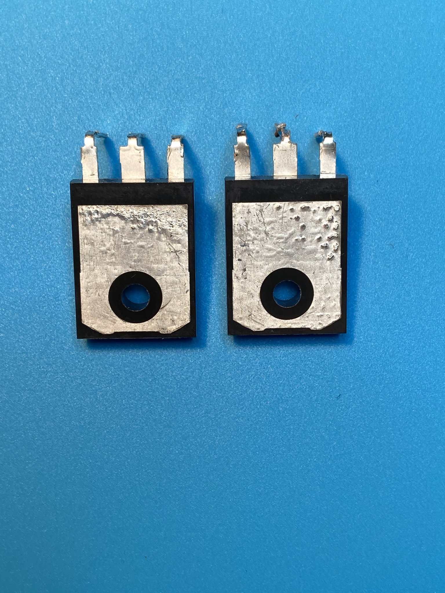

Zen Mod, I pulled the MOSFETs, which seem to test as OK. No continuity between D and S. On an inexpensive transistor tester from Amazon, which identifies them as "N-E-MOS", and applies 4.17V, all the tested values are similar to a new MOSFET, though I don't truly understand whether they're meaningful since the symbols used don't match those in the IRFP240 spec: Vt=3.6V, Cg=2.49nF, Rds=0.4 ohms, and there's 579mV showing next to the diode symbol that connects S to D.

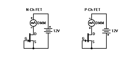

50mA is way too high for JFets
pull them out and check with simple JFet matching jig
9V will do as PSU

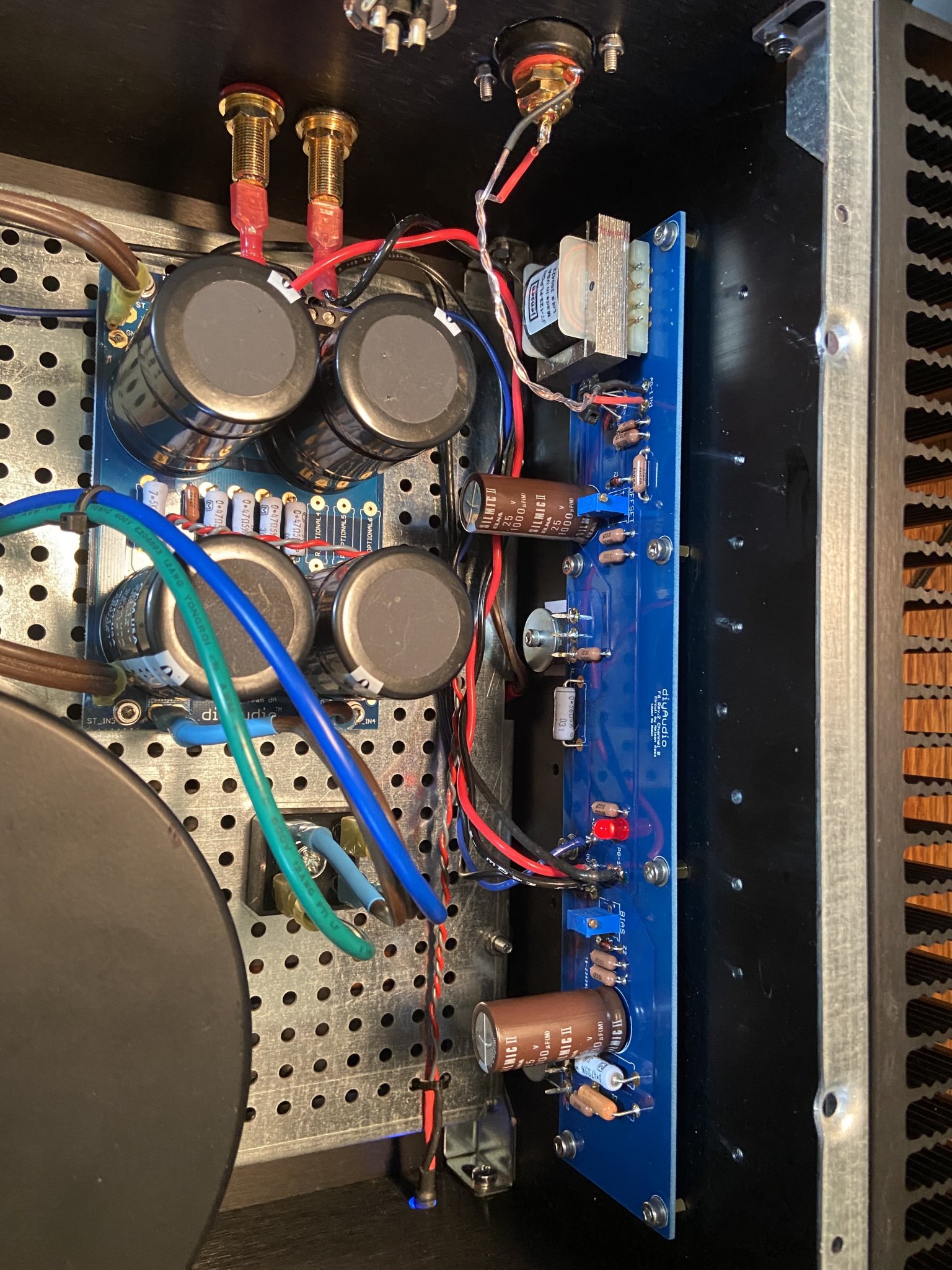

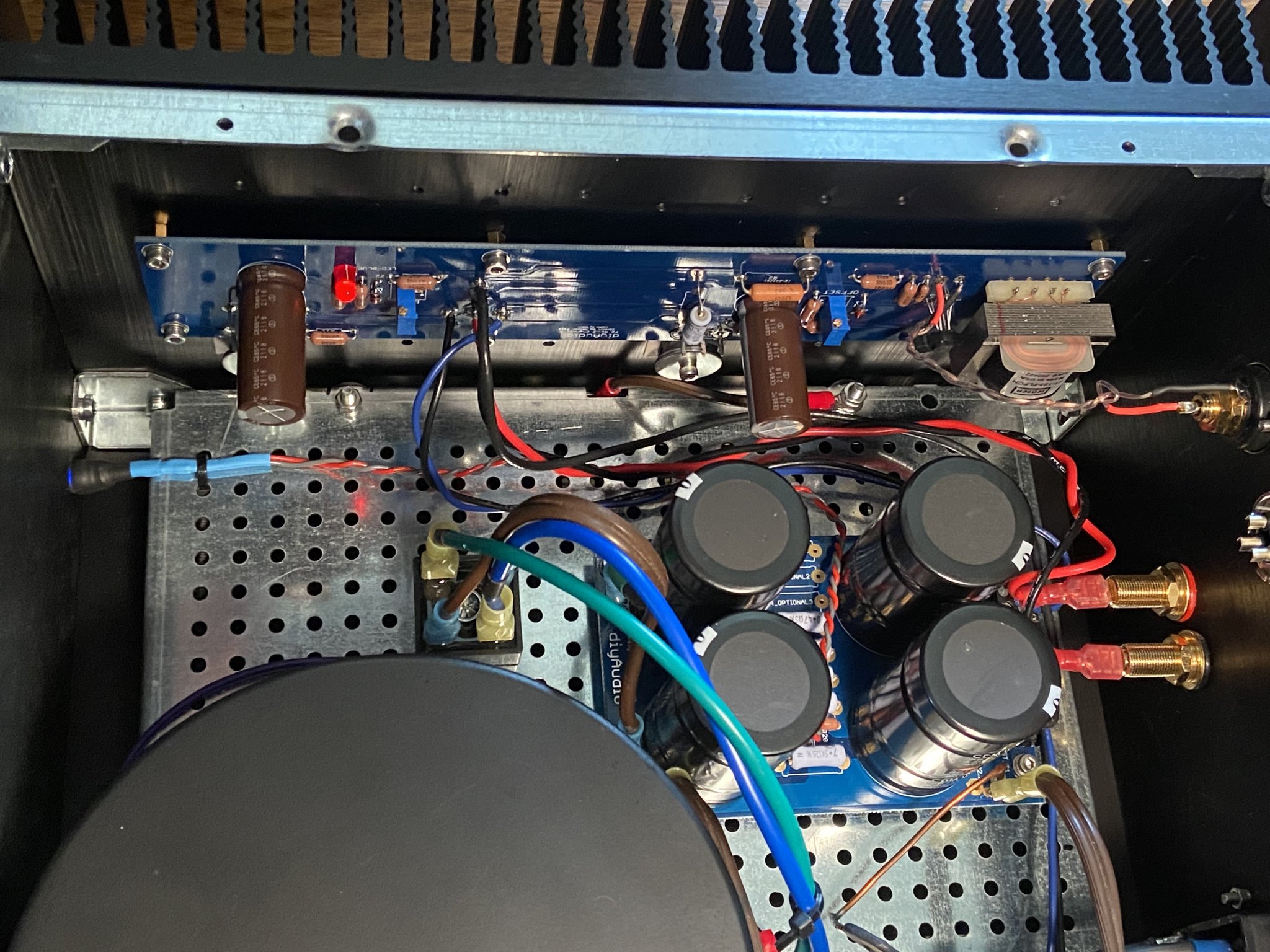

I came across the suggestion to replace the zener with LEDs a couple of times - after I had already placed the zeners, of course. Is the idea to replace both zeners with LEDs or only the bias zener, Z2? Getting some low-level hum on the left channel now (channel A board, same one I allegedly fixed). Right channel remains quiet, so likely not a PSU issue, I'm thinking.
Yes sir. Channel A is the hummer. Spectrum app has it between 99-125 Hz, so I'm guessing it's 120Hz. Both channels have it, but can only hear it on the right channel (B) when my ear is right up against the woofer, which is acceptable. I can hear the channel A hum from my listening seat, barely, when no music is playing.
When I look at the two amp boards, the only noticeable difference in assembly is the height of the JFETs. When I replaced the JFETs in channel A, I left the leads at full length, so the JFETs sit up higher, which puts their tops roughly level with the midpoint of the Jensen signal transformer. What's the chance that tranny is introducing hum through those JFETs? Worth the effort to lower them? Is there a best practice height that should be considered with those types of transistors?

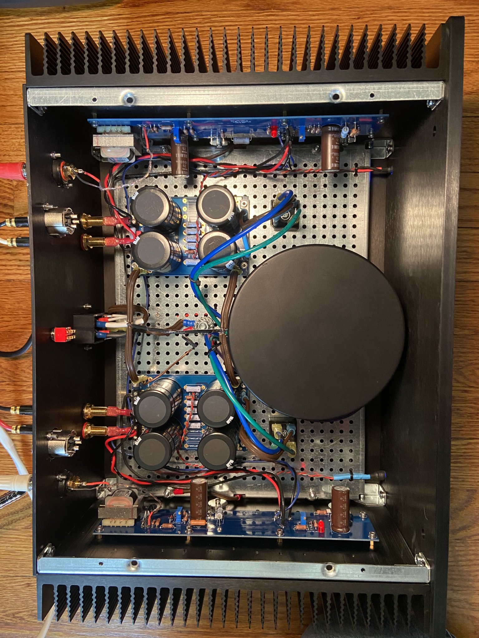

I used rubber spacers to raise the perforated base plate that the PSU is mounted to about 3/4" above the bottom cover. AC wiring runs under the base plate. That tip came from an early post by Zen Mod, though I believe he used rigid plastic spacers. Because the rubber spacers electrically isolate the heatsink sinks from the star-grounded base plate, I used grounding straps to tie the sinks to the base plate.
