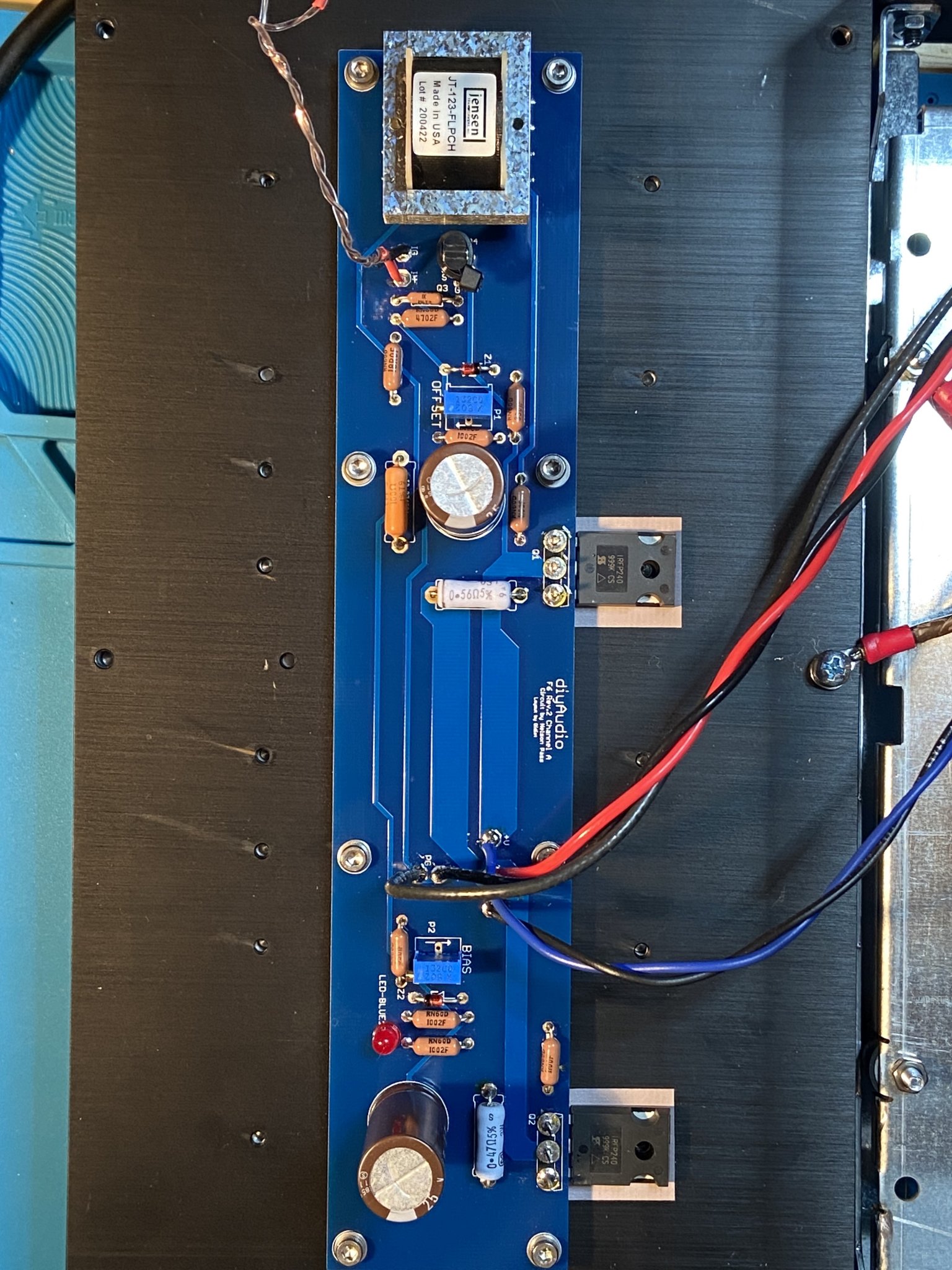

Hi all. Hoping someone can help me troubleshoot my F6 build. Completed the build in the Deluxe 4U chassis. Everything tested well, biased both boards to a stable 0.50V across R2 and DC offset was likewise stable at less than 5mV. Connected inexpensive speakers to check audio, and it sounded good. No hum in either channel, dead silent. Checked bias and offset one last time before installing chassis cover. As I removed my Fluke DMM retractable hook test probes from R2, I heard a pop from the speakers, and then hum started to slowly build in volume in the left speaker, which is Channel A. Situation is very similar to what HeyBill described in post #3458.
I read all responses to HeyBill's troubleshooting and tried what was suggested. All component values are correct. Boards have 6V8 at Z1 & Z2; 3.3K R7 & R8; 110R R11 & R12. Components test good in circuit as referenced to functional Channel B. PSU V+ & V- stable at 23.5V (and no issues with Channel B). I don't have an oscilloscope.
LED lights on Channel A. Diodes, MOSFETs and JFETs pass diode test (I think) in circuit. Signal transformer (Jensen) tests proper for continuity and resistance. Big clue that I can't decipher is that I'm getting runaway bias voltage across both R1 and R2, and Q1 and Q2 likewise go into thermal runaway. I haven't left the amp on for more than a few moments since this happened, but was able to measure voltage across Q1 source and drain, which seems to top out around 4.25V, but as mentioned, the bias voltage across R1 and R2 keeps rising rapidly, so I don't leave the amp on for more than a minute or so - shutting it off before it bias gets to 1V. Measured the temp at pin 2 on Q1 as 75C the last time I had the amp on. I have not changed settings on P1 and P2 since this happened. I suppose I could dial P2 all the way to 0R to see if bias still runs rampant.
I plan to replace Q1 & Q2 (if for no other reason than one of them, Q2, got hot enough to produce a thin curl of smoke at pin 2). Before I energize Channel A again, is there anything else I should consider replacing so I don't potentially damage the new MOSFETs? What could be the cause of the loss of bias control? Could the JFETs have been damaged and is there a way to test them for damage in circuit?
Should add that this hum is not the typical, low level ground loop hum. It's loud, like something is broken in the circuit, and it starts (softly) when the bias gets to about 0.3V across R2 and build to loud quickly as the bias climbs. Photo attached (note, removed screws and washers from Q1 & Q2 just before taking photo).

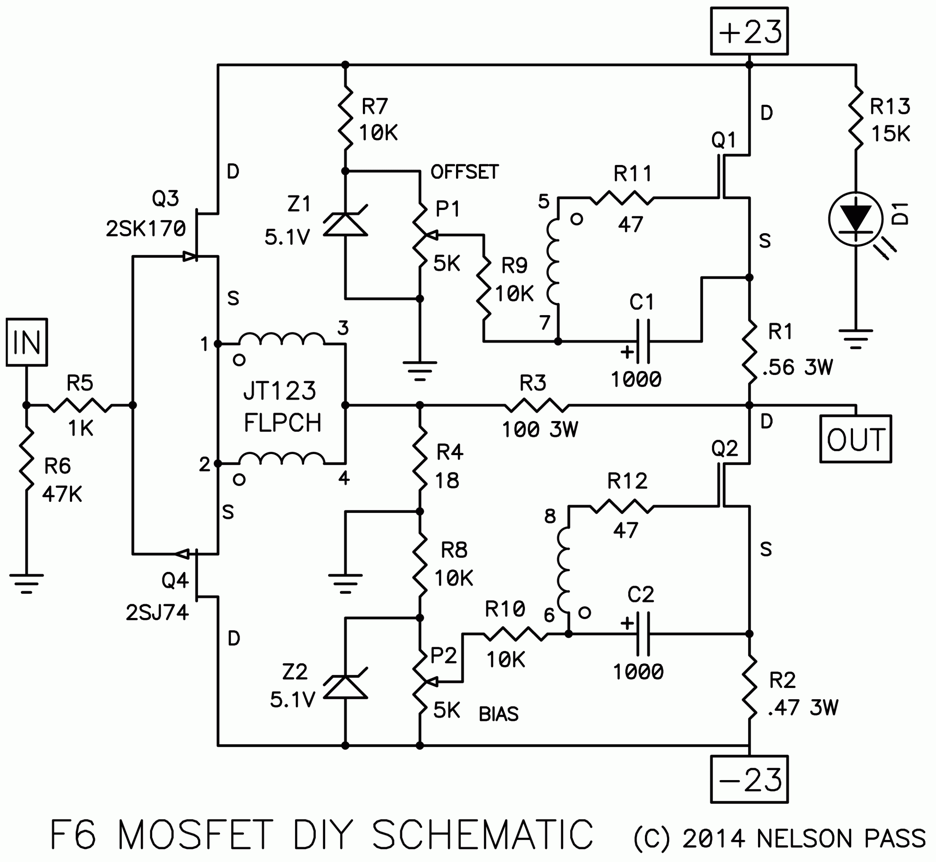

now - because origin schematic is missing from post #1, it would be nice that you post your reference schematic, so we know that we are on same page, regarding parts nomenclature
input buffer is having one N and one P channel JFet, each having 10R resistor in source; voltage across each will say current through its JFet, thus will show functionality of same

ha, confusion - I was looking at schematic from Papa's article in my PC
final iteration is obviously lacking 10R in sources of JFets
as Jim sez - voltage between pins 1 & 3 (xformer) should show upper JFet current
same - pins 2 & 4 , for lower JFet current
now, that will show similarity of these two currents
if you want to compute them - that goes as I=U/R, where U is measured voltage between pins and R is measured ohms between pins, when amp is Off
