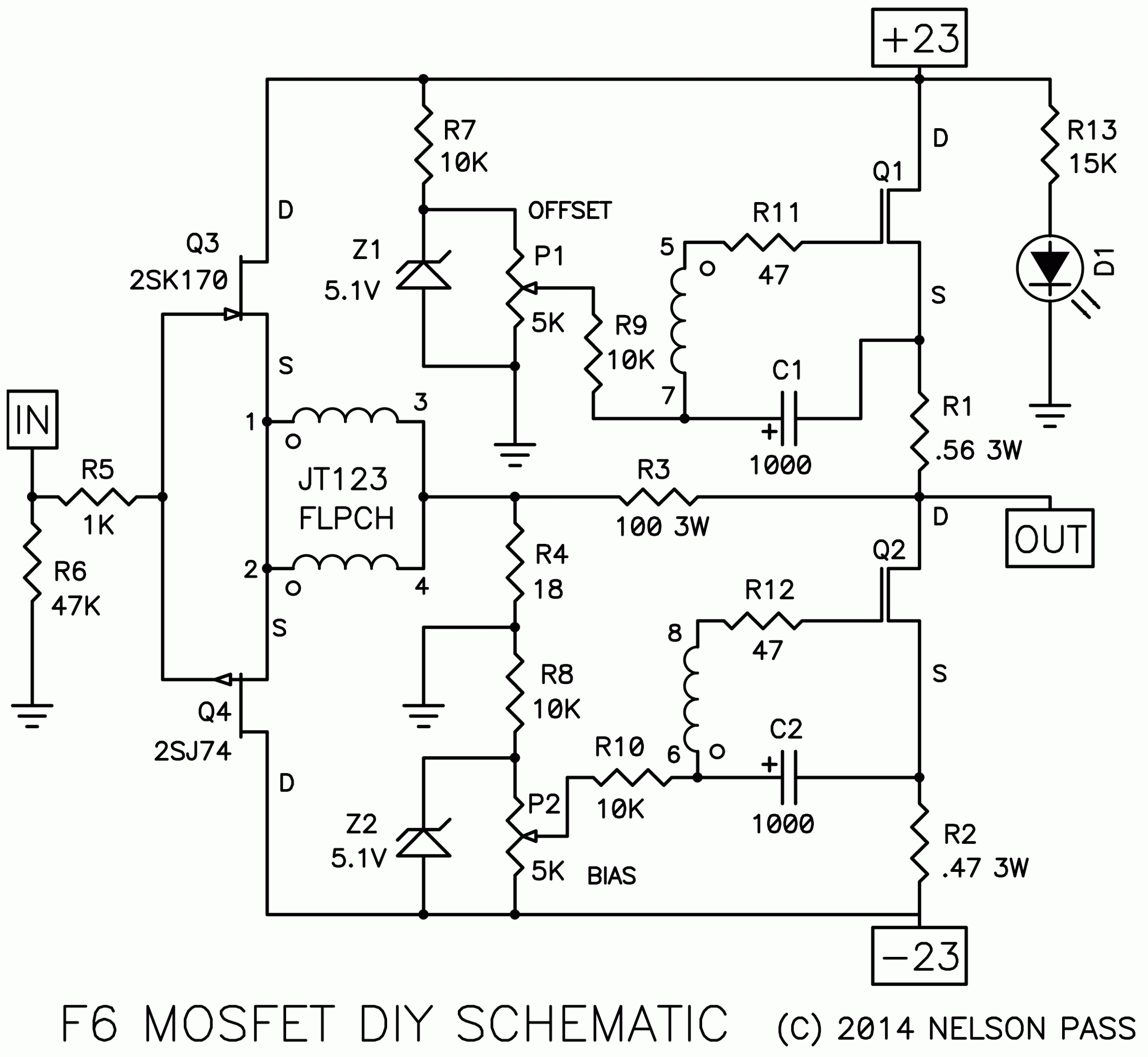

When using the LM329 as a voltage reference it appears the resistors used at R7 & R8 can vary. Is that because of rail voltage? If so, do R11 & R12 also vary? Tungsten is using 3.9k at R7 & R8 (26 volt rails). Colin is using 3.3k, I didn’t see a listing of rail voltage. Zen Mod is using 3.6k at R7 & R8 with 130 ohm at R11 & R12 (23 volt rails). What best to use? Rails on my F6 are 26 vdc. Would 3.9k at R7 & R8 be best? If so what about R11 & R12?
Currently I have installed 3.3k at R7 & R8 and 110 ohm at R11 & R12.
I’ve yet to power up either channel but power supply is good to go.
R11 and R12 are gate resistors and don't vary with the use of the LM329.
R7 and R8 are used to feed an appropriate amount of current to the LM329 for it
to develop its nominal 6.9V. The datasheet shows pretty much anything in the
1mA to 10mA range will work quite well. (You might want to have a look
at Fig 9, 10 here:
https://www.mouser.com/datasheet/2/405/lm329-442129.pdf )
Anyway I think your values are fine.

I’m having trouble getting bias to stabilize on my f6. Both channels exhibit the same issue. When I first powered up channel B the led lit up normally but the trimmer at P2 didn’t show any change when adjusted. I’m using lm329 as voltage reference with a 3k3 resistor in this circuit. On inspection I found the polarity of lm 329 was incorrect. After correcting I was able to bias the circuit, very slowly until I got .500 mv with close to 0 volts offset. Over the next hour as everything warmed up the bias began to increase, rising to.590 mv. At which point I readjusted bias and offset, again to .500mv and 0 volts. Again I waited for circuit to stabilize but it kept increasing. This was after at least another hour of being powered up. I shut the amp off and revisited the next day. Same results. At this point I started to review this forum for troubleshooting help. Could I have damaged something due to wrong installation of lm329? I’m sure Q3 (170) and Q4 (74) have correct components installed. All solder joints look good. There is 26 vdc going to the channel. But I’m not sure how to proceed.
Please advise
Replace the LM329 with the 5.1v zener and approx. 10K R7, R8 and report back on bias stability.

Replace the LM329s with three small green LEDs in series, paying attention to diode polarity. Keep the 3k3 resistors.
The F6 benefits from voltage sources with a negative temperature coefficient. The LM329 is very near zero temp co. The 5.1V zeners may or may not provide sufficient bias voltage.

The led string has worked beautifully. I’m getting stable readings from both channels. Whew, what a relief. Next step I really need to be sure I’ve grounded everything well enough.

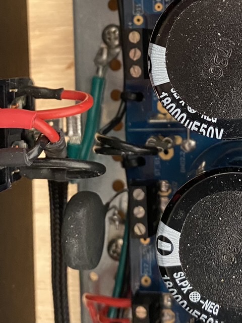

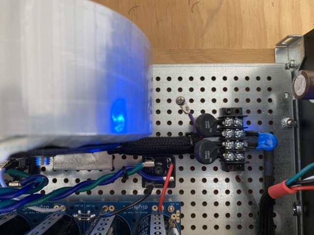

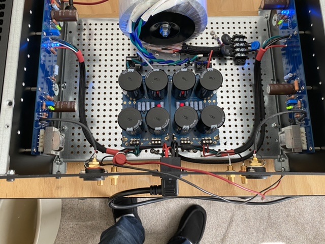

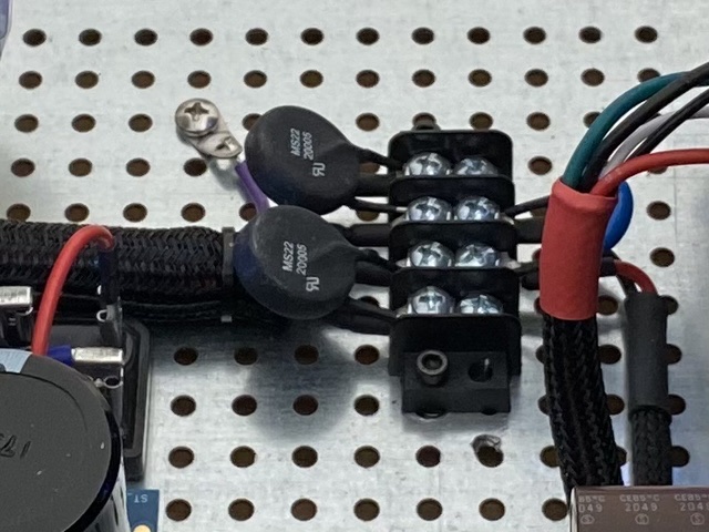

Here’s what I’ve done: the transformer shield is grounded separately next to the terminal block right on the chassis, the power supply board is grounded through an MS22 inrush limiter as is the primary of transformer, the IEC socket is grounded separately to the chassis, the inputs and outputs are grounded from each channel to a common connection on the power supply. I hope the pictures show this adequately . I’m not sure if this configuration will be quiet. Please advise.
