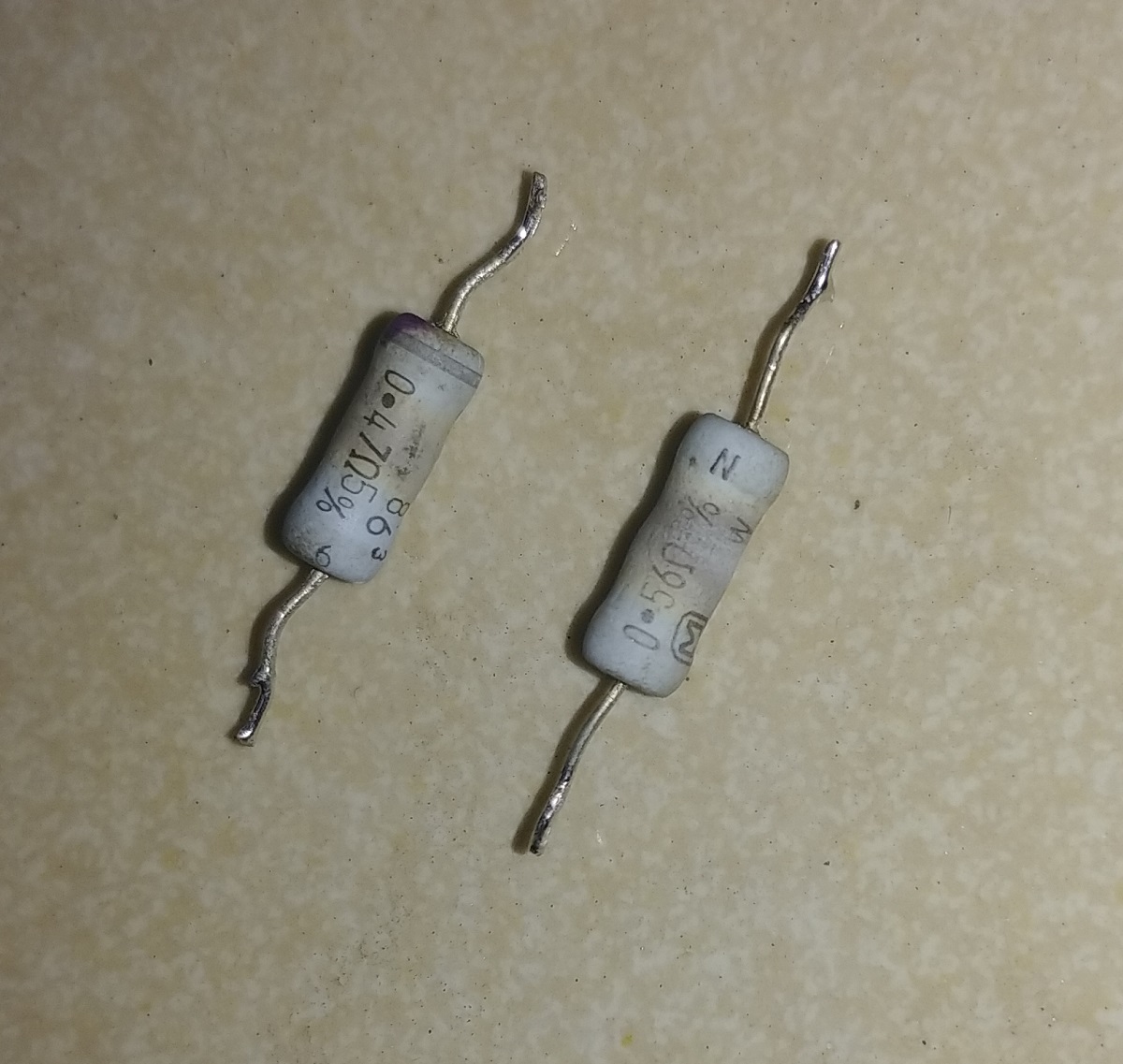

I had my F6 clone (Tea-Bag PCBs) running with 2 picoDumbs LED bias mods, and decided to change the MOSFETs from IRFP240 to IRFP150s.
However, all did not go well.
One channel blew the source resistors (0.56R). The 0.47R resistor still measures ok, but is discolored - pics attached.
Other channel did not have such issues but the voltage across the 0.47R source resistor was 1.04V - so the MOSFETs were biased at 2.2 amps 😱 So turned off power and will dial down the bias trim-pot before powering on again. By dialing down I am thinking of taking it to mid position - 12 or 13 turns for a 25 turn trim-pot. The trim pot is a 5k one. I recall Zen Mod advising to remove the MOSFETs - I can do that, but wary of damage to the PCB due to desoldering.

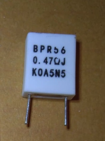

For replacement source resistors I am thinking of getting KOA BPR types.
Would appreciate advice / comments. Also, should I be checking something else?

if you remove source resistor, most likely it'll be enough isolated mosfet so you can test it with diode/buzzer test is it blown or not - worry about short, not open one - open will show as non-biasable :rofl: - is that new word?
simple loogic was - IRFP150 is twice IRFP240 ........ back up that bias before powering on!!
now, as punishment - back up trimpots all the way down; confirm "down" with ohmmeter, do not think in CW-CCW terms if you don't have direction clearly marked

Got new resistors, 0.47R 5 watt KOA BPR critters; source resistor on Q1 blown again...
Took out the MOSFETs also - Q1 shows connectivity on all 3 legs... it has become Dodo is my guess?
ZM, F6 experts (well ZM is expert on everything :clown:),
Since IRFP150s were giving "blinging beep" (become Dodo), decided to go back to IRFP240 that I had pulled out earlier from the same channel (amp was fully working for years then...).
After installing the IRFP240 in the PCB, fuses are blowing on power on. 🙁 Now scratching head...
Any specific position I should check for shorts or any other error?
