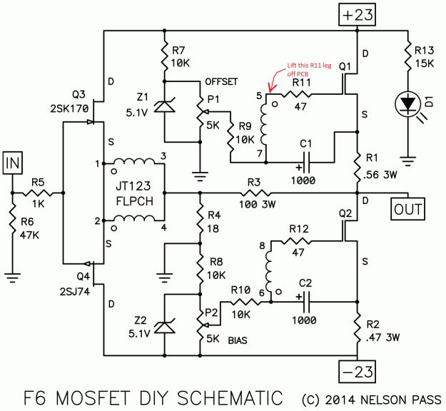

Did you ohm out your transformer secondaries? They are part of the bias and offset circuits. Lift one leg of R11 and R12 and check. Each winding should be about 28 ohms.
Thanks for the quick reply. Stupid question: I unsolder one side of R11 and R12 and attach the DMM to the unsoldered (separately) to test ohms while the amp is turned on? Also, is this done with the dim bulb tester or without?

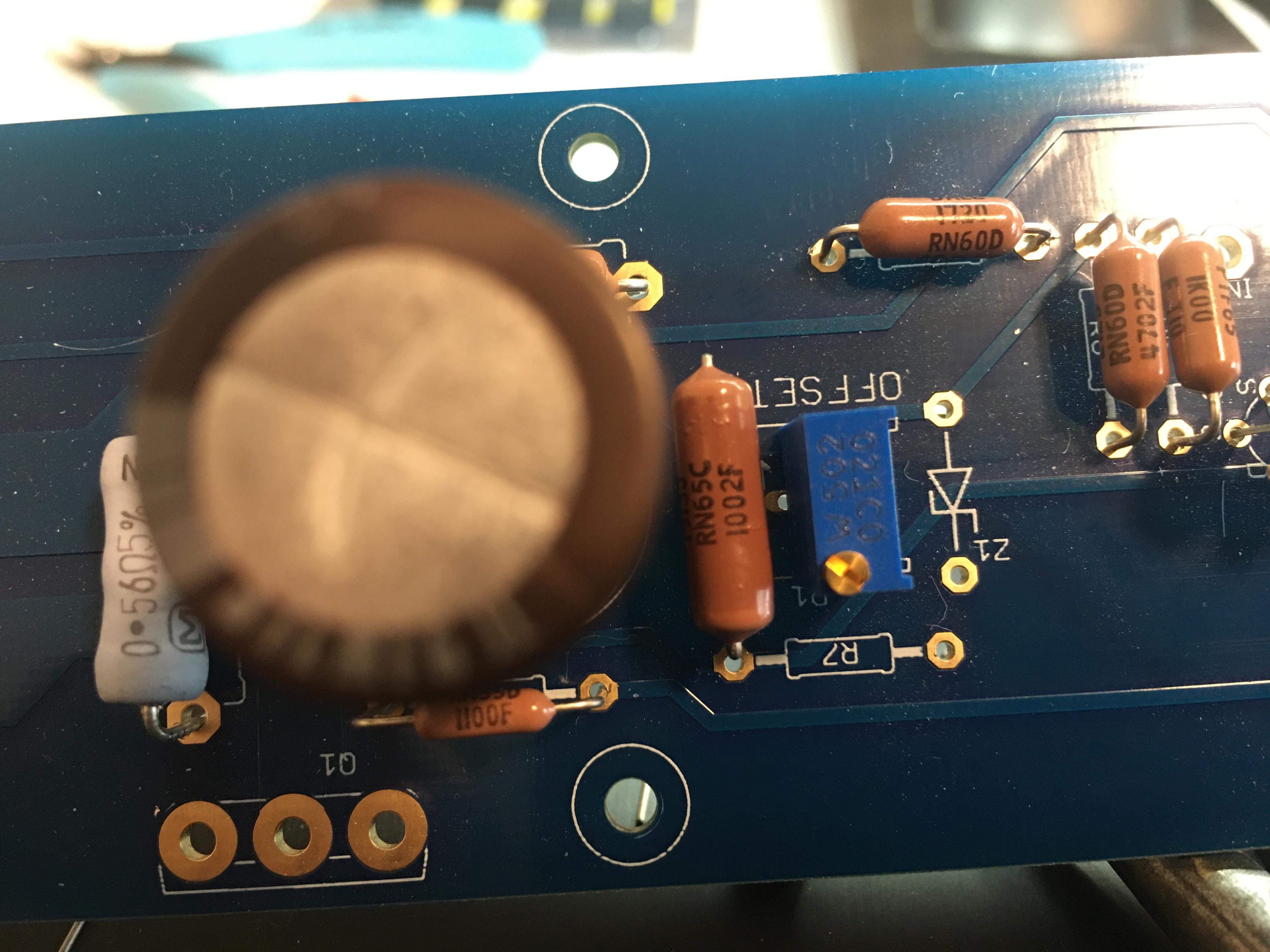

Just putting f6 boards together and noticed 10k ohm resistors are too large to fit pcb pads properly. Mouser part indicates they’re 1/4 watt. All the other 1/4watt on the boards are smaller and fit properly. Is this an issue or can I just bend leads as necessary? This isn’t a problem except where R7 and R9 get real close on one of the boards (see picture) I don’t see this as a problem but wanted to ask

To test transformer secondaries: power must be off and stay off!!
Lift R11 resistor leg off PCB as shown in schematic attached. This disconnects one end of the winding from everything else.
Measure ohms between PCB pad you just lifted the leg off of (common with JT123 pin 5) and JT123 pin 7.
Repeat same thing for R12 location, measuring ohms between JT123 pin 8 and JT123 pin 6.
Windings should be about 28 ohms each.

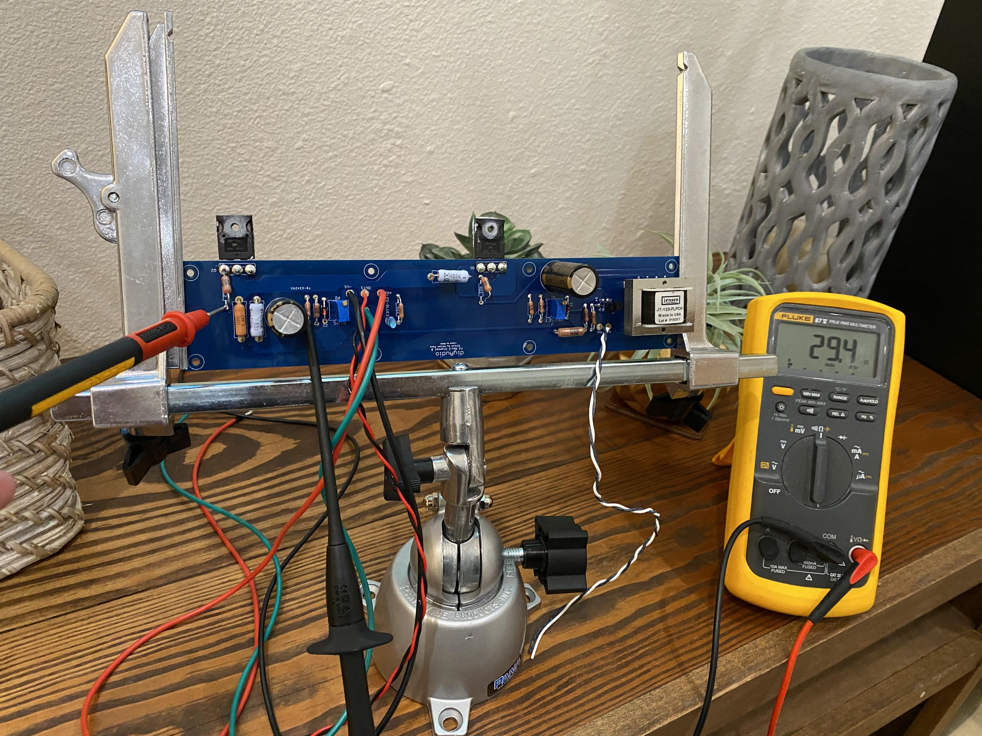

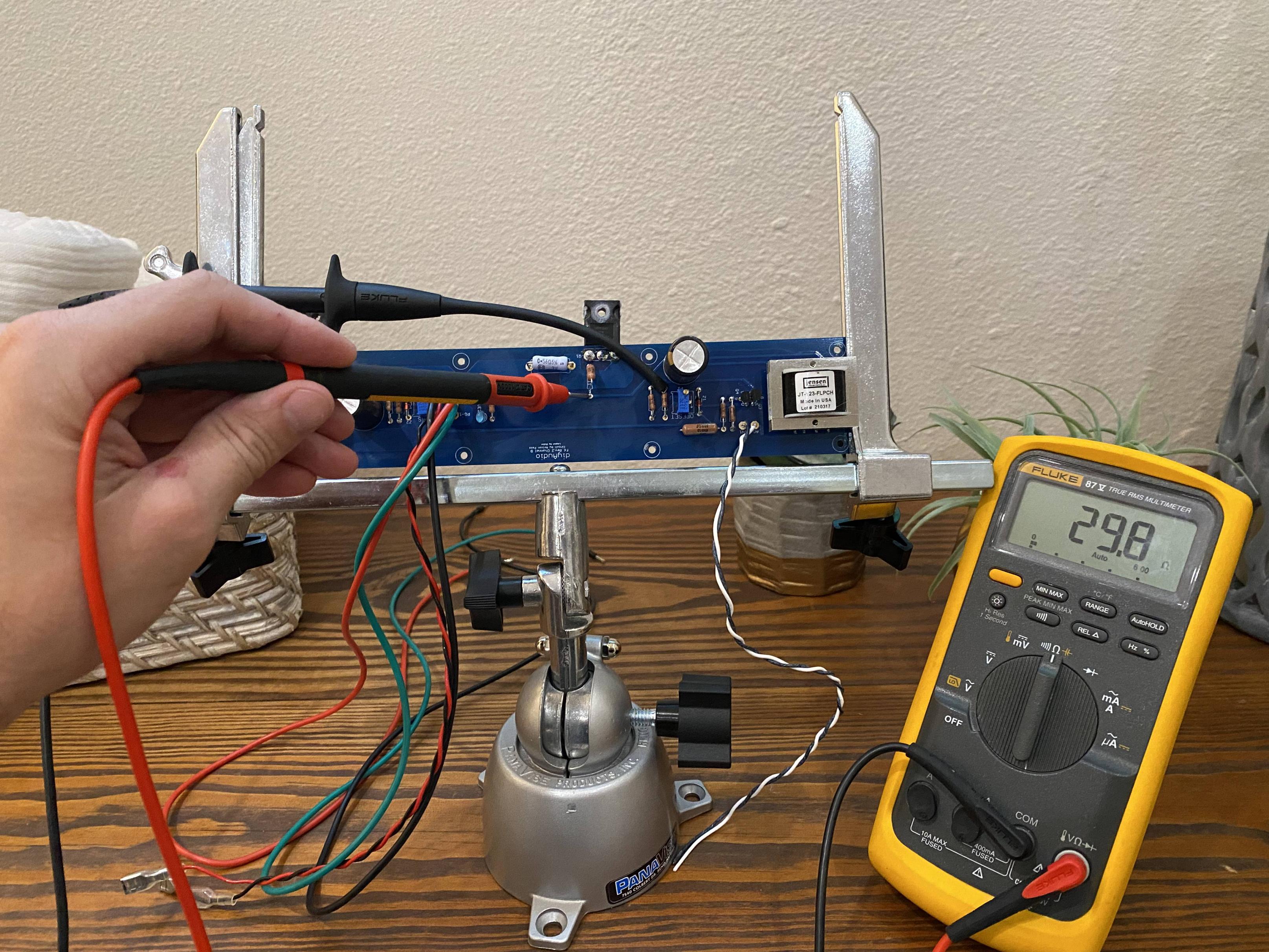

Both measured close to 30 ohms (see pics below). Not sure what this means relative to the offset issue, but thanks again for helping me problem solve.
