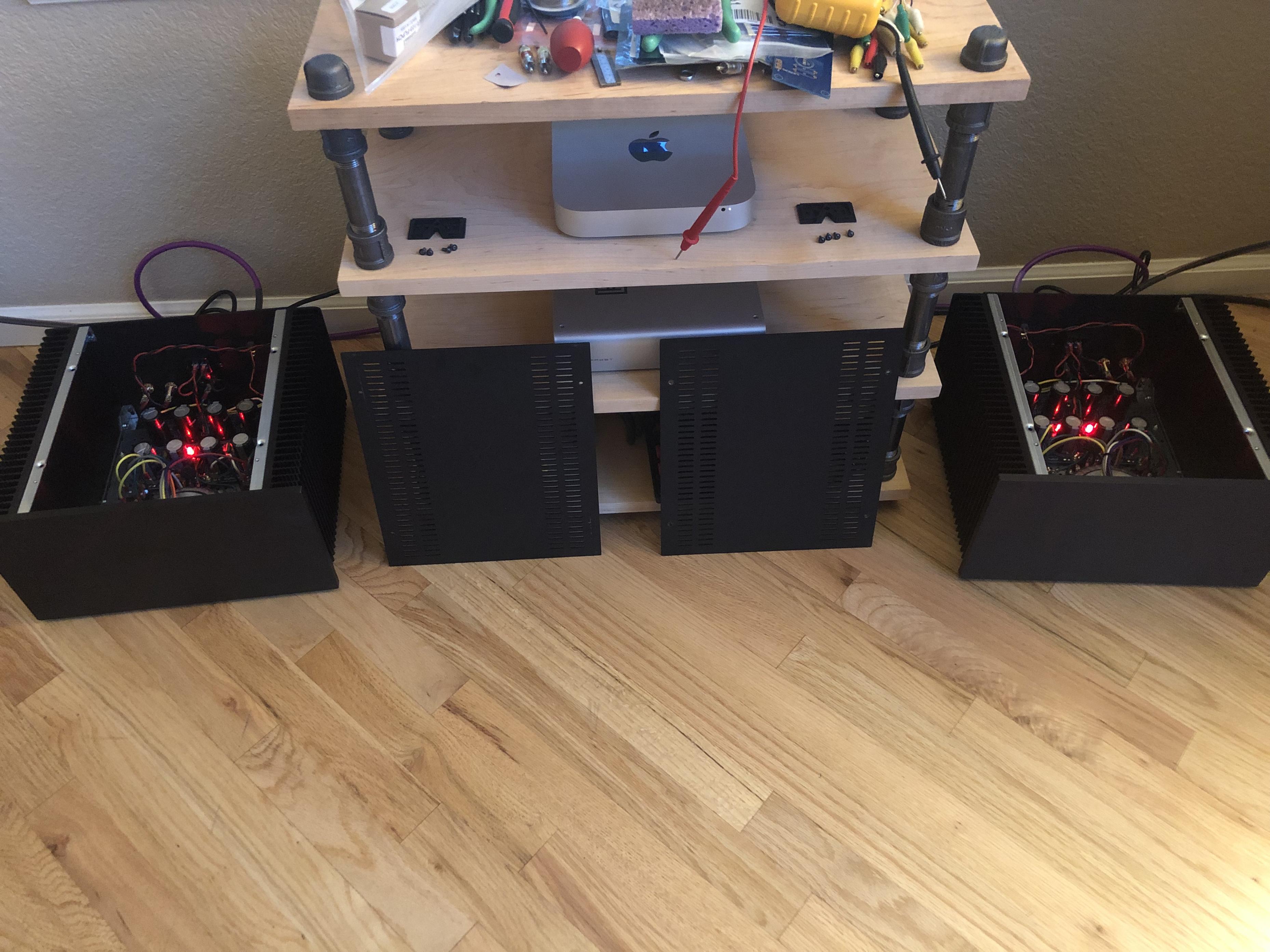

Finally! After a few missteps with the buffer JFETs, got my F6 monoblocks up and running. Next up is upping the game for some monsterblocks but until the next pair of transformers show up, enjoying these things for awhile.
The bass! Oh. Em. Gee. The bass!
I have Peter Gabriel's "The Last Temptation of Christ" breaking things in because "It is Accomplished!"
-tom

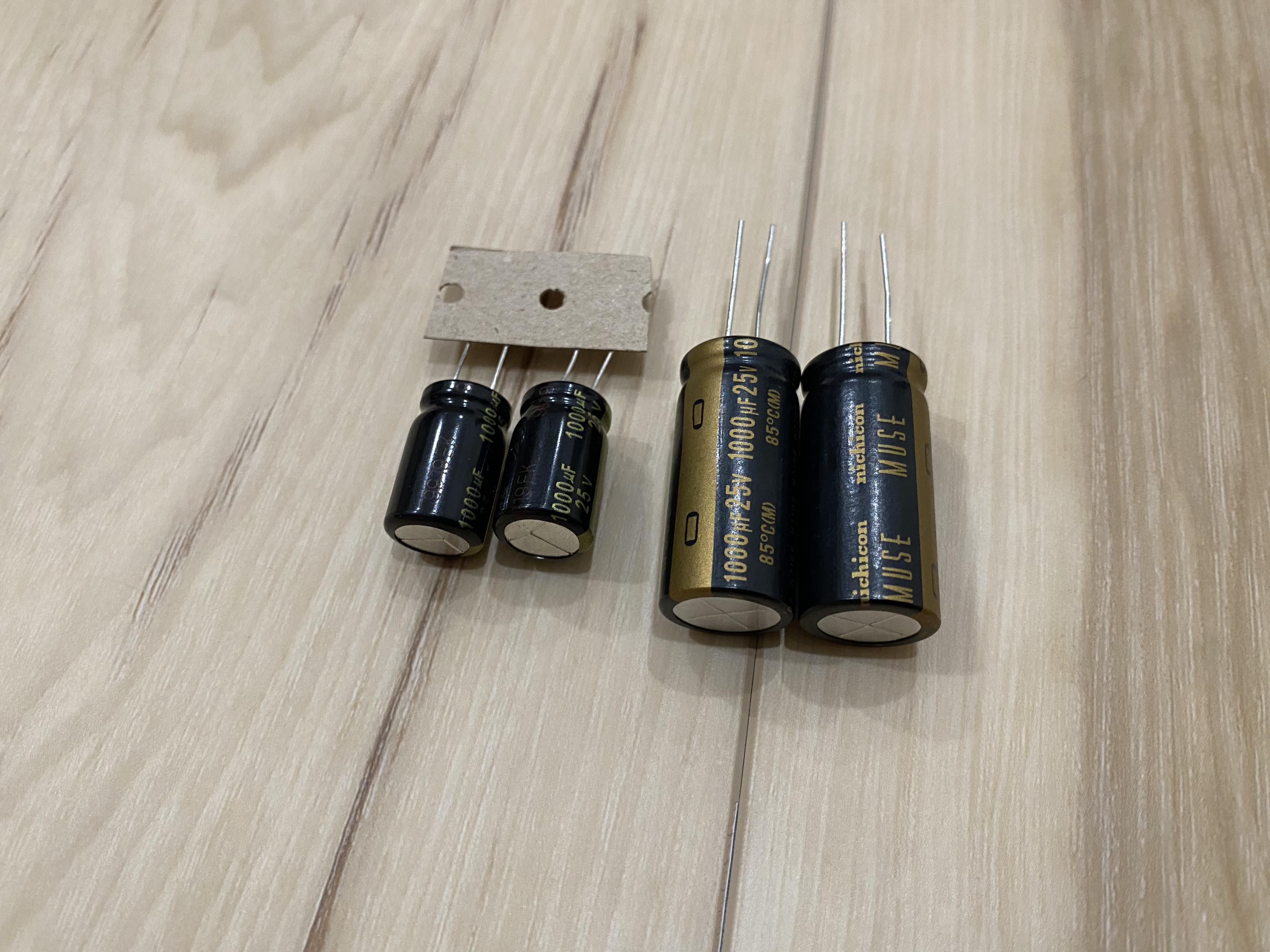

Hi all,
Finally got done moving and had an opportunity to get back to the build. I purchased some nichicon capacitors (c1,2) from mouser and noticed they’re much larger than the ones included in the f6 parts kit from diyaudiostore. Any issue with the nichicon capacitors other than size? See attached image for comparison. Both capacitors are 1,000uf 25v.
P/N: 493-14501-NDi
Thanks!
