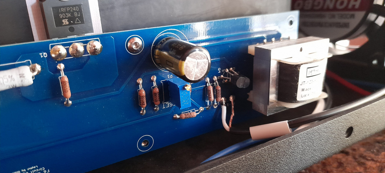

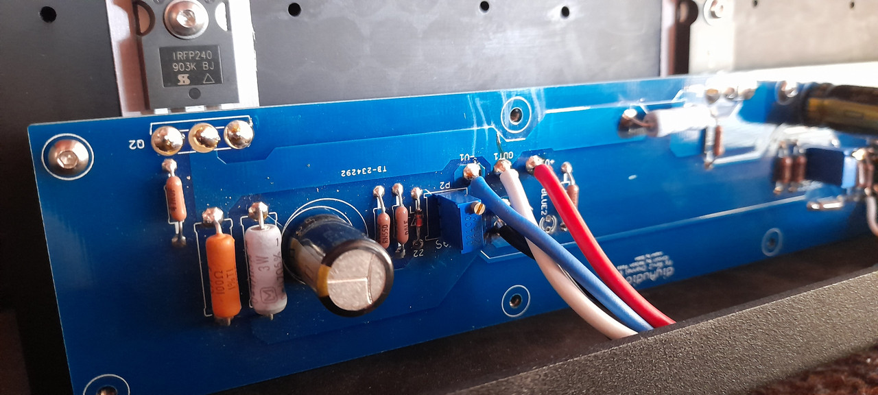

Your pics need to be bigger, they don't enlarge at all. Please take close up photos of the PCB so we can see the details of your build.
That being said, have you looked through pages 353-362 of this thread? On those pages, Dennis Hui, IAIMH, ZenMod and I helped loads of fellas troubleshoot their F6 builds. There are details in those pages that may help you. It's a simple circuit but it stumps a lot of newbie builders for some reason!
It appears the schematic you are using is from the 1st page of this thread since you have the DIYAUDIOSTORE boards.
What is the value you used for Z1, Z2?
What is the value you used for R7, R8? If it is 10K, it is best to try 3K ohms instead.
Did you make sure you installed the correct JFETS for Q3, Q4? Q3 must be K170 or equivalent and Q4 must be J74 or equivalent.
Do any of the three pins on the MOSFETS Q1, Q2 have any continuity to ground? (They shouldn't).
Did you re-read the 1st post of this thread as 6L6 has specific details for a successful build.

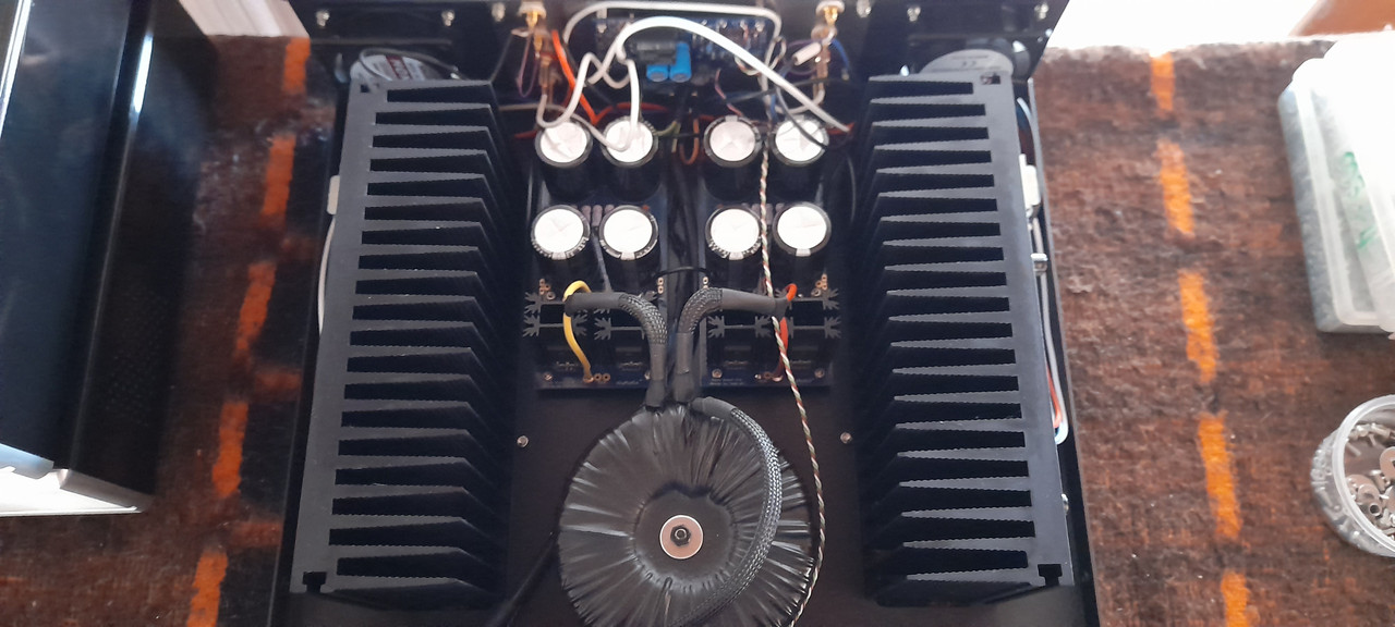

Thank you - I have rechecked the components as indicated in the build guide and swopped them out. All good now!
