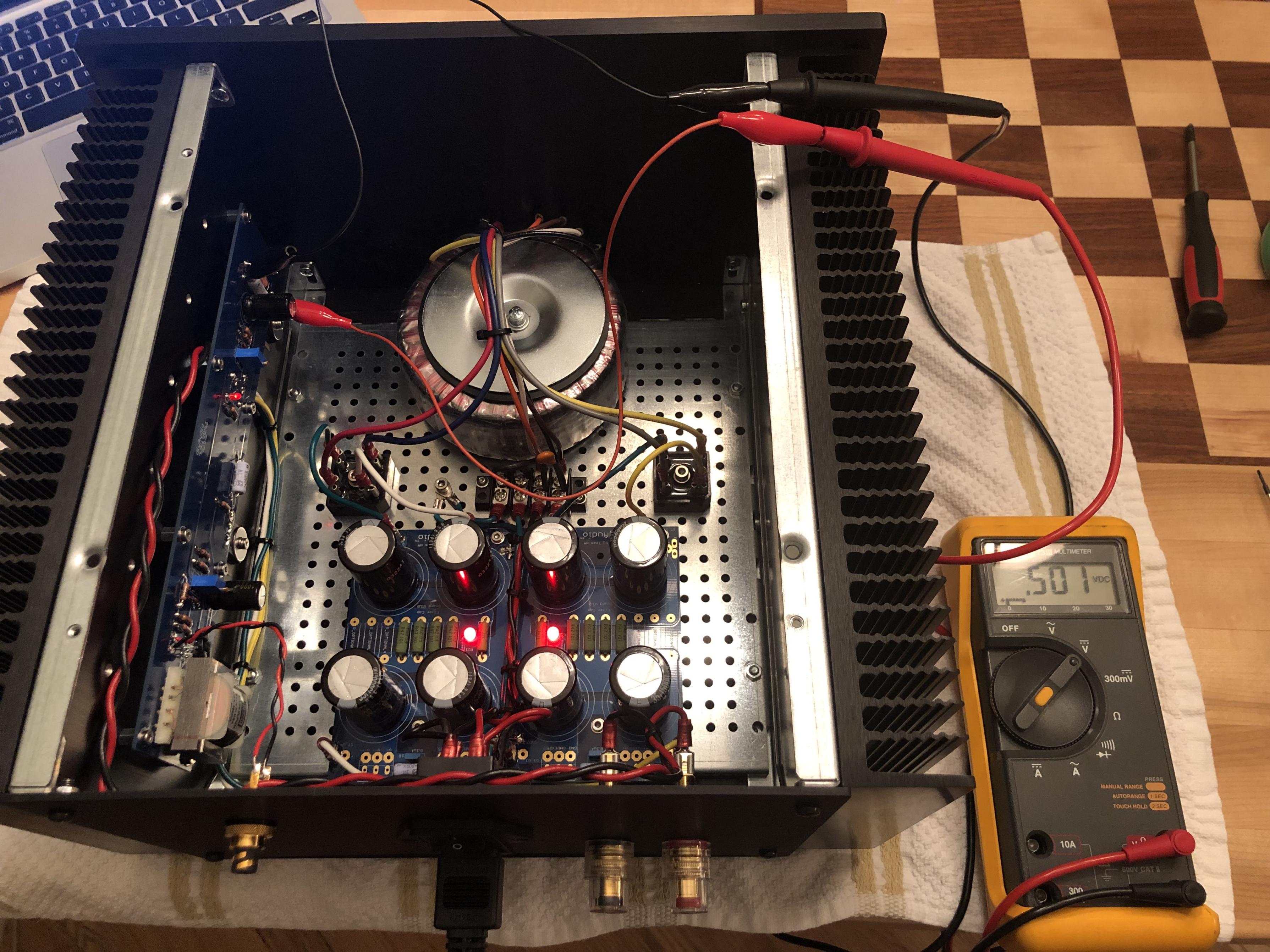

The journey continues. Power up and biasing the left channel seemed to go well. Let the monsterblock sit for over an hour and checked the bias and offset multiple times. Got the voltage across R2 to sit at 0.501VDC per 6L6's build guide. As I didn't have a thermometer, I relied on the hand test per Mr. Nelson. The heatsink never got uncomfortable to touch no matter how long it sat on. Then I hooked it up to a speaker. Got some odd squeaks and squawks so decided to power it down. Then I noticed the V- led hanging on for awhile compared to the signal board and V+ leds that died quickly. Taking a break for a few, maybe work on the other channel chassis. I need to rebuild the energy so I can check everything over as I feel I didn't do as good a job paying attention to detail during soldering as I normally do. something seemed amiss. Maybe it isn't but definitely seemed like it at 3am.

My personal experience was that 550mV was the point at which my F6 started to sound good. Below that, it just did not sound "right". Above 575mV I could not hear any improvement. More bias just increased the heat sink temps.

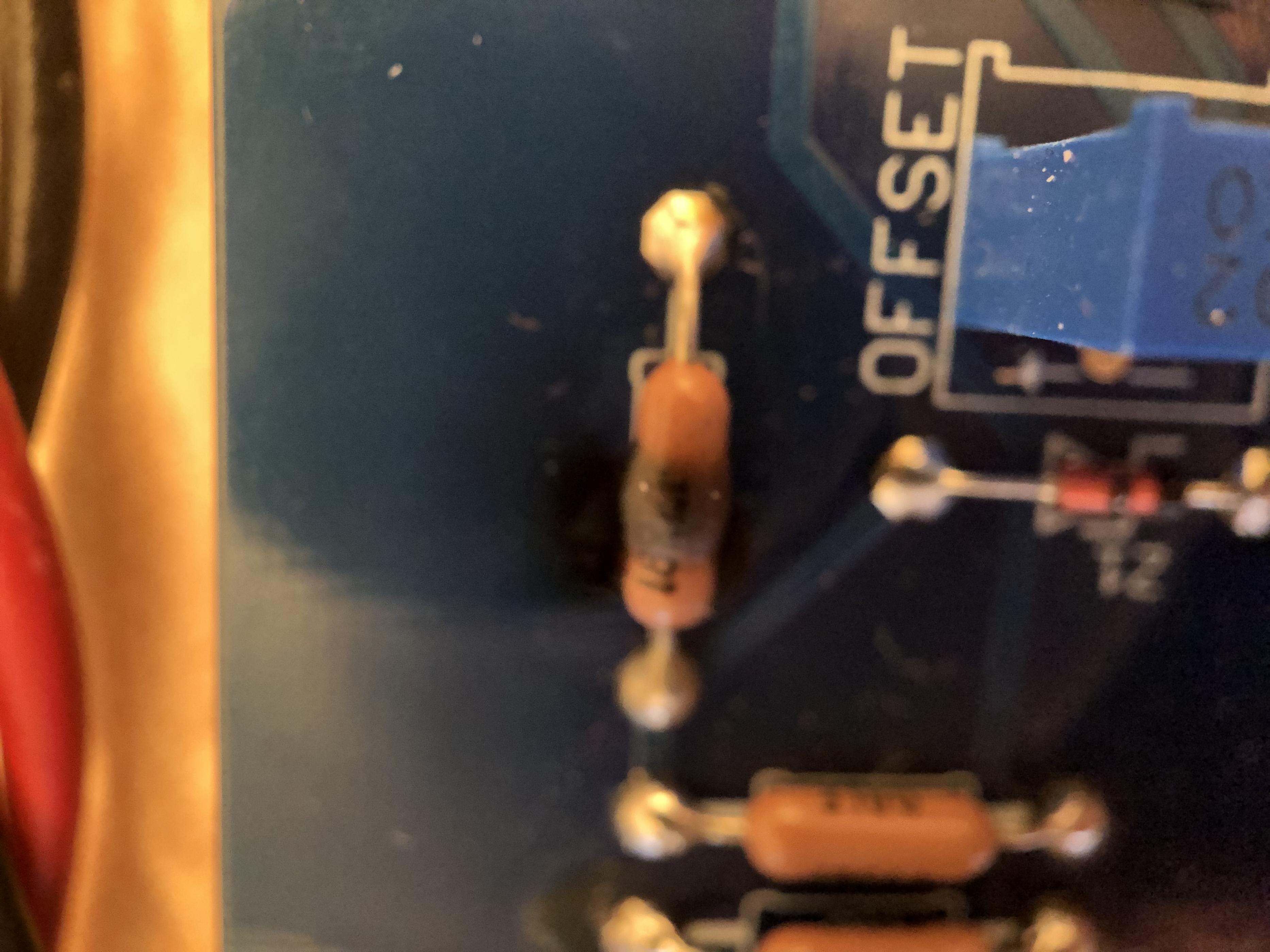

Thanks for the words of advice. And the giggle. I needed the giggle. Speaking of giggles, for giggles, I tried the amp this morning, to see if the bias would still hold. R7 (the zener feeder) is smoking. I tried the 3k ones with the 6V8 zener that Zen Mod suggested. Looks like I did something wrong. Luckily I have the stock kit resistors and zeners to try as opposed to waiting for another Mouser/DigiKey shipment. Regardless, time to trouble shoot before I fry another resistor or two. Before that, fresh air and sunshine!
I zeroed it out last night but didn't test it when I fired it back up in the morning so I'm unsure where it was at the time of the fry. Need to order replacement resistors then going to check all the components I can and reflow the board.

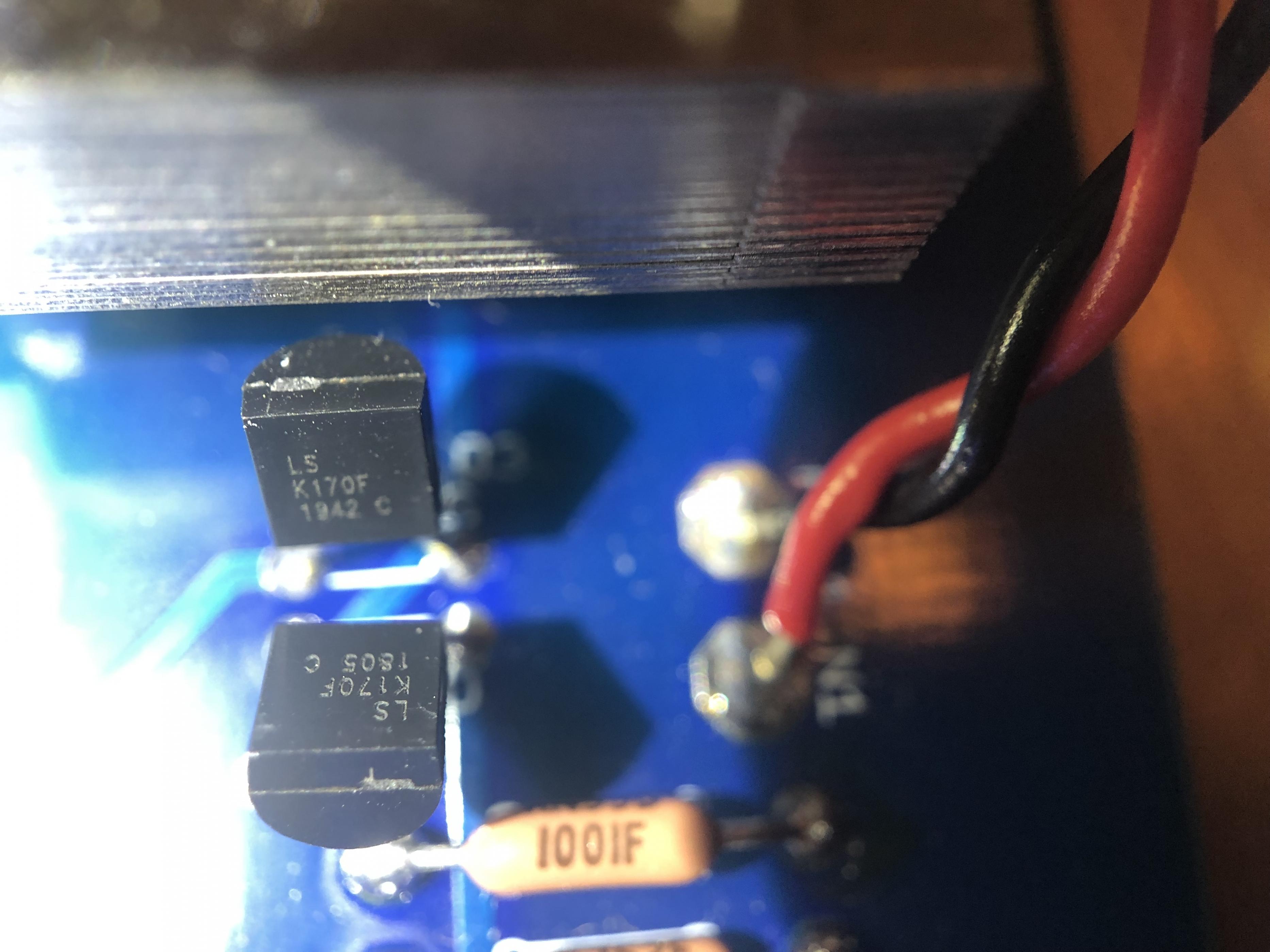

Wow... just wow... I found a boo-boo but unsure if it is related to R4 burning out. Guessing there is a good chance but I'm new to transistors. I installed both 2SK170s onto the B channel board and (thus!) both 2SJ74s on the A channel. Luckily, I only powered up B channel.
I don't know how to test the 2SK170s or if I need to. Do I need to buy all new JFETs? Any advice?
