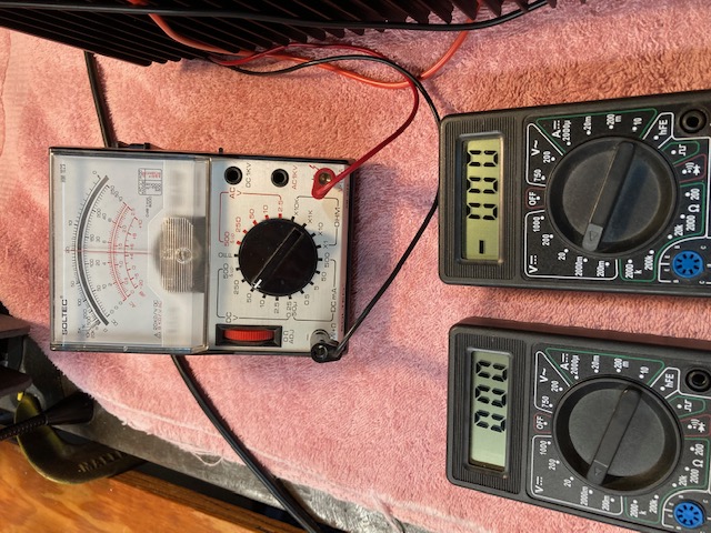

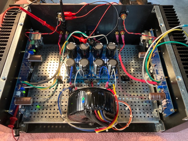

just finished my F6. power supply checks at +-25vdc. meter in photo on positive side. started the left channel first, left meter across 0.47ohm resistor for bias. right meter on output for offset. i have pico's 3 green leds and 4.7k resistor instead of zener and 10 k. turned up variac to 115v slowly, PS measures correctly. turned up p2 5 turns,nothing. turned up some more and offset started to go up . at that point i could turn p1 up and zero it out and turn p2 some more and zero out with p1, at some point offset suddenly ran away to 200mv or better and i shut it off and re zeroed the pots.i was almost 20 turns out on p2 and go no voltage on the meter. mosfets are stone cold, nothing is hot, leds are lit but cant seem to get bias on meter. what else can i check. must be mistake somewhere but i measured everything going in and double checked jfets before soldering. need some test points to troubleshoot. thanks mark

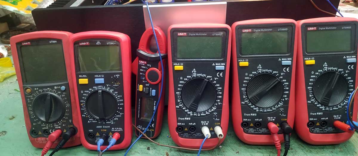

when I'm hysteric chicken (usually doing something new, not sure it'll work), besides placing one DMM to monitor Iq and second to monitor output DC offset, I place two more meters to observe G-S voltage for each mosfet
say that you call your Buddy to bring few meters and sixpack (why should you, you're event organizer
) , then do the same - you'll know where you are with trimpots (Ugs) and you can start trembling when you reach 3V8 and more - only then mosfets will start conducting (soon)

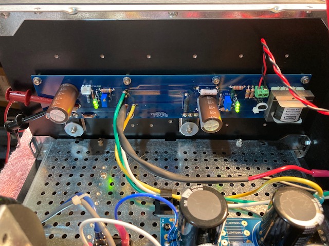

Mighty Zen Mod put Simpson meter on g-s of q2 it responded to p2 ran it up to 3 volts. Put meter on g-s of g1 Nada! Would not respond to p2. Got any ideas? Thanks mark
Cheap meter responded to g-s of q2 but nothing happened when across 0.47 resistor. How come that also?
Think I’ll unhook left channel and hook up right channel and see what happens.see if same thing happens. If right channel works it must be q1 mosfet on left channel. If right channel doesn’t work I made same mistake eh ?

Tested for shorts to heatsink on mosfets before and after soldering to PCb. All okay. Why am I not getting any voltage gate to source on q1 but I am on q2. And no voltage across 0.47 or 0.56 resistors?
Pot must be okay because gate to source voltage on q2 responds to fiddling. But not Q1. Will check trannies secondary for continuity
Does p1 have to be opened up with p2 at the same time? Ie 5 turns each at a time. What I was doing was leaving offset pot off and opening up just bias. Is that what is keeping q1 with no voltage? Wish I was smarter. Insert sad face here.

Mighty Zen Mod, you were totally right. I was just trembling. Nothing wrong with f6, put 4 meters on left channel when mosfets hit 4v bias came up, sitting at 600mv with 0mv offset for an hour now. On to the right channel. Thanks for your wisdom and trick for meters on mosfets. Thank you thank you. Mark
