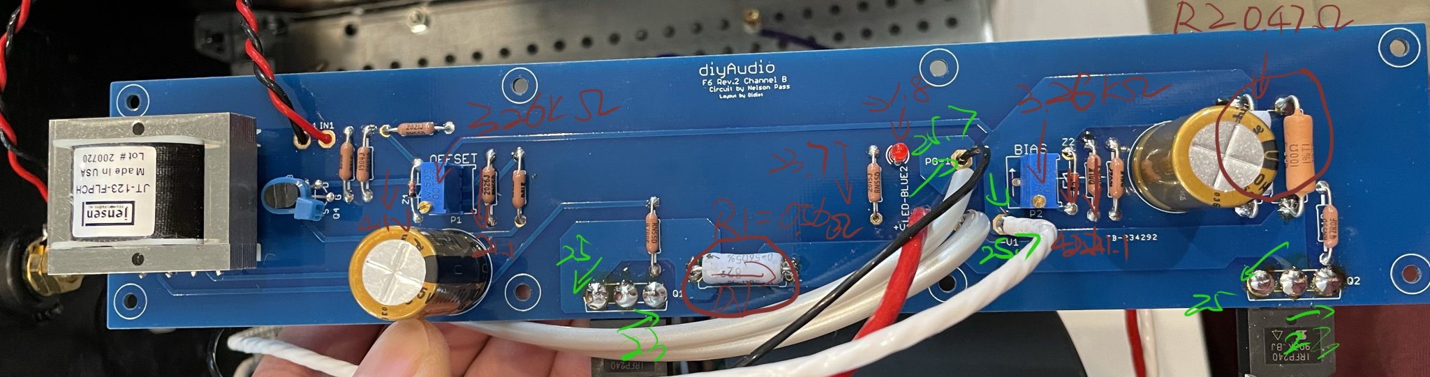

Request help: zero voltage bias no matter what
r1 0.56 ohm zero voltage drop
r2 0.47 ohm zero voltage drop
adjusted p2 and then p1, no change
no heat generated at all.
Diag so far
power input 25.7 - 0 - (-25.7) v verified, without amp board, psu output was 26.0v.
both 5.1 zener shows a voltage drop of 4.1v
Both resistors beside zener 21.1v
p1 and p2 pot are measured 3.28k ohm total, come with a kit, not 5k pot, problem?
power grounding wire is 19awg, not 16awg used for v+ and v-, problem?
both transistors pin 2-1 drop 25v, pin 2-3 drop 22.8v expected?
led light up 1.8v drop -red, led resistor 23.7v
ALL other resistor shows 0 voltage drop. Capacitor is spec 25V - should be ok.
Any suggestion? thanks a lot.

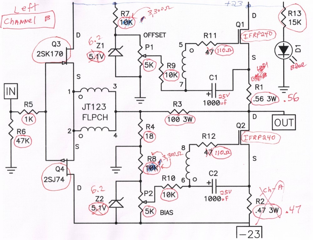

Sorry for the problems. Just powered F6 yesterday and ended up working. However thought something was wrong on power up as no heat even after some "CONSERVATIVE" adjustments of P2 bias. Ended up having to turn the P2 pot quite a number of turns, then holy cow voltage came up fast. As was said by others be patient on the adjustment of P2. Did nothing the first 30 minutes but adjust the P2 Pot to .500 volts bias on both sides.Excluded pot - 502 tells me 5k, measurements is a result of other parts on circuit
Then went on to the offset. Turning P1 pot clockwise lowered the voltage. Interesting was turning down the voltage of P1 had to go back and turn down voltage using P2. Did this a number of times. Even when thought I was done had to turn down voltage through P1 pot.
5K pots measured 2.5k on insertion into board.
Z1,Z2--used 6.2 volt zeners.
R7,R8 used 3.3kohms
There was a large conversation going about zener values and R7,R8 values. There seem to be changes all the time when someone (A lot smarter than me) came to conclusions.
Maybe these values affected the way the bias responded to adjustments.

fengyink,
As others have pointed out, you have an issue with the zener value and the resistors R7 and R8. The 4.1V you measured across
the 5.1V zeners suggests that the zeners are current-starved and not regulating. Changing R7 and R8 to 3 to 5K should address this. (The exact value is not important so just use whatever you might have). Since you are getting some decent current with the pots all the way up, getting the voltage across the zeners to 5.1V might be enough to get the proper bias current. (Though if you already have some 6-ish volt zeners I would just use them).
BTW, with these changes, you need to turn the pots back down before power up, otherwise you risk having the bias current up too high. and damaging the mosfets.

Thanks a lot, folks. 3.3k R7 and R8 solves the bias. I can reach 0.5V bias at R2 = 0.47ohm. Pin 2 stays at 60c. 2.7v zener (and leds) on their way. Sadly, offset stays at -13mV for the final 4-6 turns in p1 and did not go up to zero. I’d assume this is ok given its small and negative? Thanks again.If you have to order the resistors, get 3.3k, 2 picoDumbs has a great bias mod that works well to replace the zeners with a string of 3 LEDs tied together in series. It helps the amplifier to get to opperating BIAS and offset quicker than the Zener setup. If you switch your amp off after use, that would be a nice addition.
dumb-biasing-mod-applicable-to-f6-and-other-papa-amps-possibly-my-dumbest-idea-yet.348969
In post #92, i posted some pics to help understand the mod. The LEDs should light up when facing the correct direction
Thanks to all of your help, and I sort out both bias and offset after using 2.7 + 2.7 zener (that gave me 5.2 drop after 30 minutes stabilized warm up). Do not use the 1.3W version (that gave me 3.8V drop), 0.5W version works (why?)That's an acceptable DC offset.
Both side stabilizes at 488mw Bias at R2 =0.47Ohm and -1 to 3mV offset. Offset reading changing every few seconds (does this matter?)

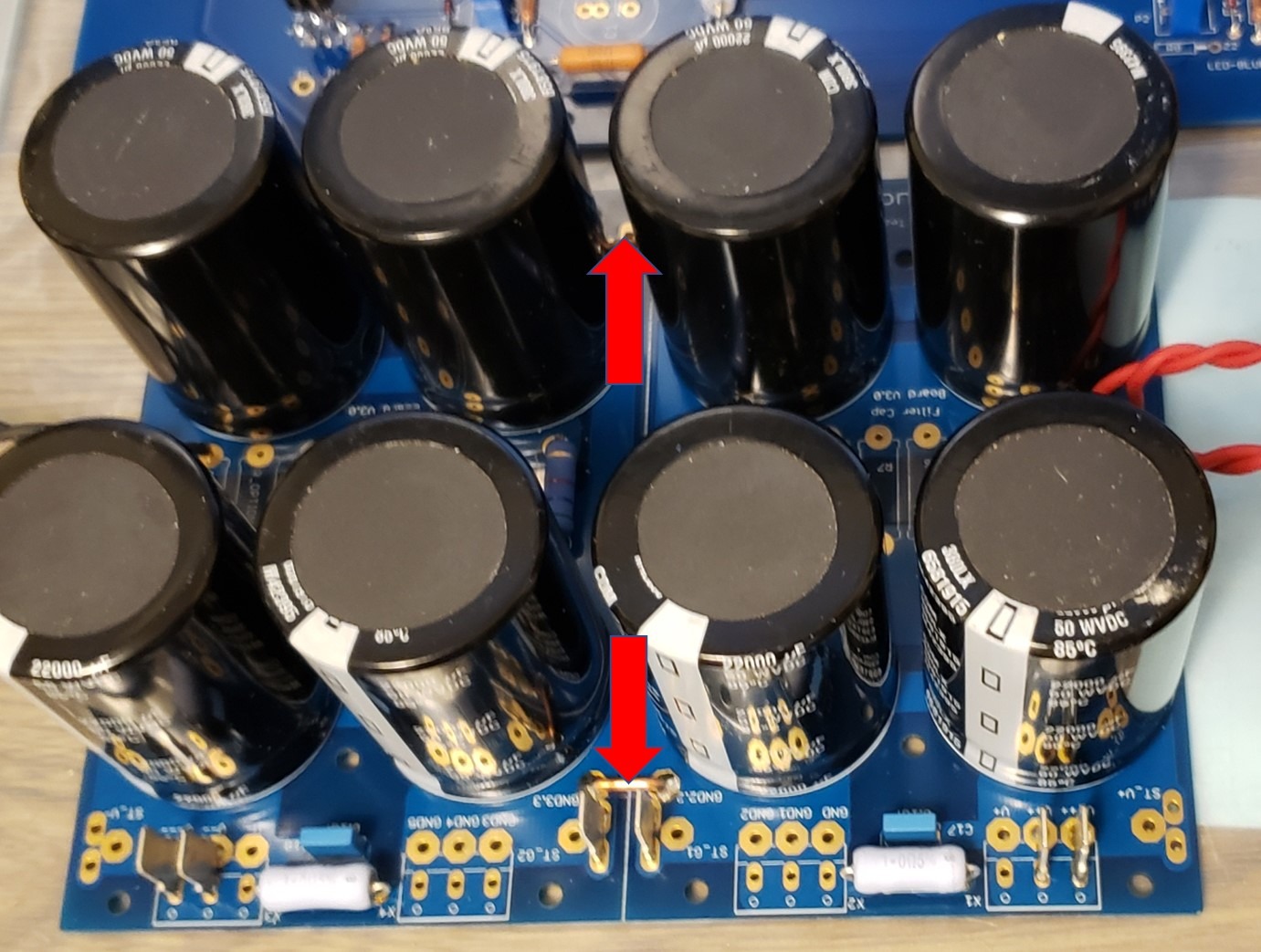

Now it comes to a very weird problem.
Primary symptom:
If I plug both left and right channel input RCA, right speaker output will get some left channel! I used youtube left right speaker to verify this. Right channel totally normal, left channel, 60% signal on left and 30% on right.
If I only plug in left RCA - left channel speaker output works fine. If I plug in right RCA, left speaker and right speaker works well. Above problem only happens if plug in both.
Diag:
Offset changing every few seconds at 1-2mV (does this matter?) with no input plugged in.
If left RCA unplugged from source (preamp), there is a buzz on left speaker. Right speaker has no buzz if right RCA unplugged from source (preamp).
Amp totally quite if RCA unplugged at amp side, either side or both.
I suspect it was my preamp problem - tried the following:
Use WHAMMY as preamp, left cross to right happens (verified ok with headphone - they are directly connected with a wire to RCA).
Same symptom happens - left cross to right happens if I use Pass ACA+ preamp (headphone works fine).
Then I changed to a commercial preamp:
Schiit Jotonhaim, [computer => usb => schiit bifrost II => either RCA or XLR=> schiit jot => RCA output => amp). Left speaker channel has NO sound. Right speaker normal.
Any clue for me to continue diag here?
Symptom recap
DIY preamp:
Left speaker output has some power (30% or so) crossed to right speaker out put if and only if both RCA input are plugged. If only one RCA input plugged, that side of speaker output sounds good at full volume.
Commercial amp: no sound on left channel
Right heatsink is about 1.2-1.5CC higher than left - consistent.
Checked solder point - good (topped off left RCA ground on F6 board, not the case).
The common part is PSU, ensure connection are solid and voltage stabilizes 23.1V - 0 -minus 23.1V at working temp (heat sink 39-41.5C).
Given both board drew from almost the same V+ GND V- (and grounding well), power should not be the case.
Check RCA socket insulation, resistance is not infinite nor zero, no matter at 2000K Ohm MM range or 200Ohm MM range. RCA left + and RCA right+ has same resistance as RCA left GND and RCA right GND, in MM range 2000K Ohm (reads 47K), 200K (reads 47K), 2000 (reads 18xx OHM) 200 (reads another number, but same). RCA socket insulation should be good.
Switched left and right speakers - that's not the problem (speakers are KEF LS50 first version)
Where could be it wrong?
Something with the amp
something with the source (preamp)
any suggestions how I can further pin point the problem.
