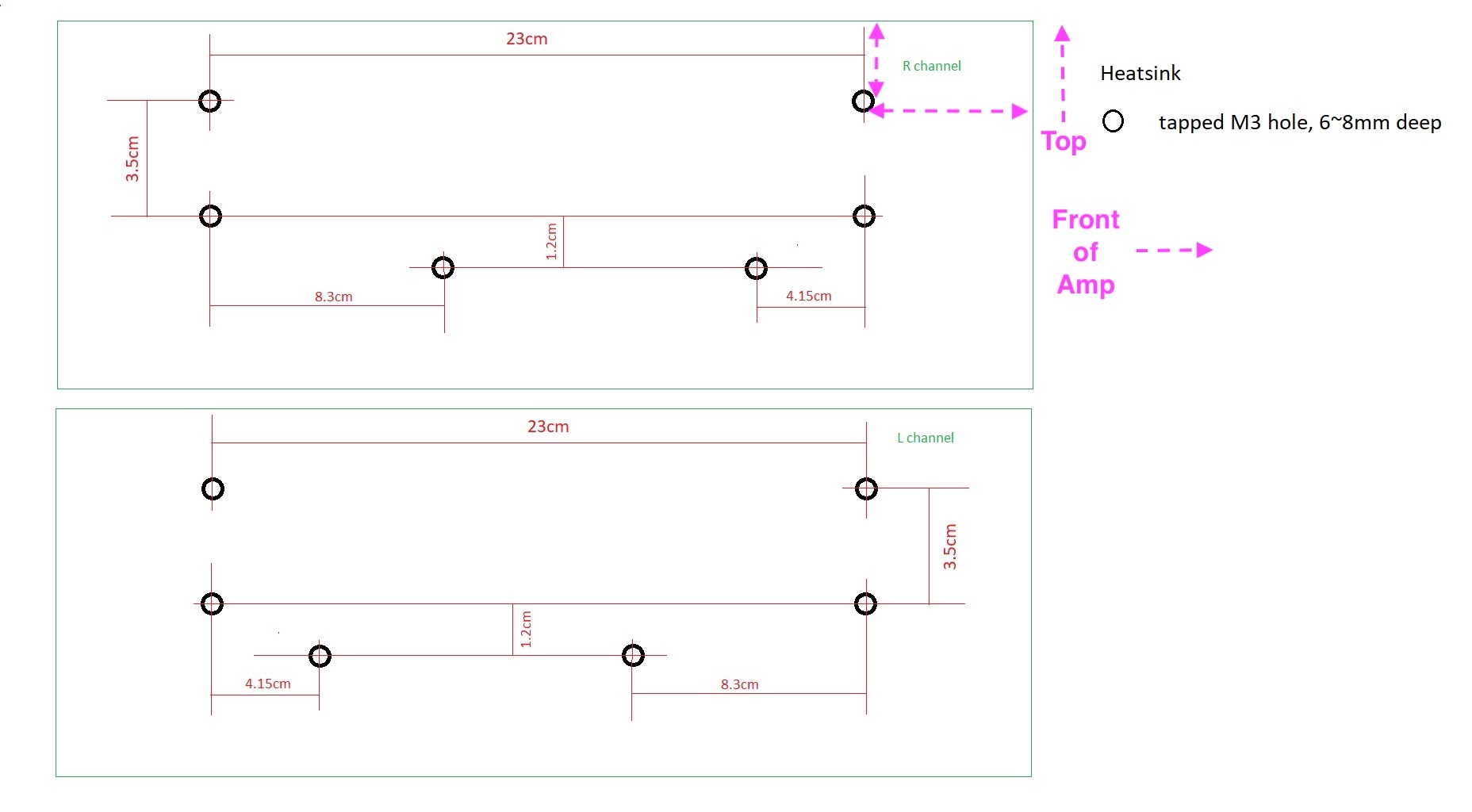

3. I'm not using the standard diyAudio boards. I have the board layout but don't know what is a good position to mount on the heat sinks. For example in the below pic what should be the distance from top and sides of the heatsink to the top right hole on the R channel? The 3U x 400 heatsink will be 120mm x 400mm.

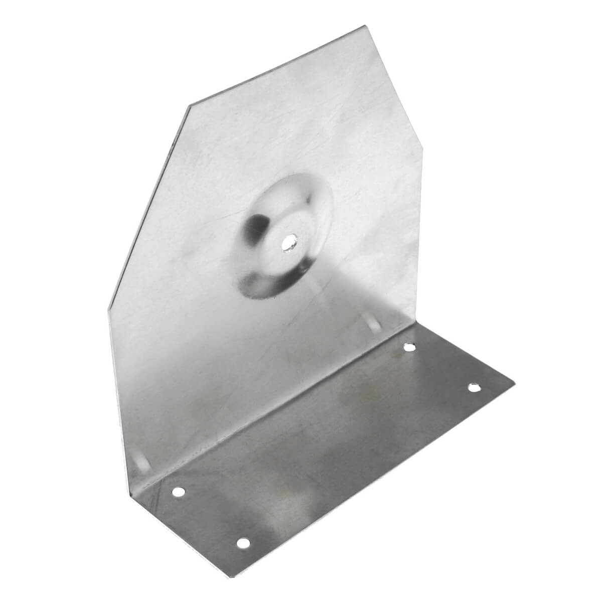

Here you go with a pic of a mounting bracket and a link with some more details.
Possibly you can have this made locally in India.
https://www.audiophonics.fr/en/tran...t-for-toroidal-transformer-o150mm-p-6039.html

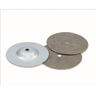

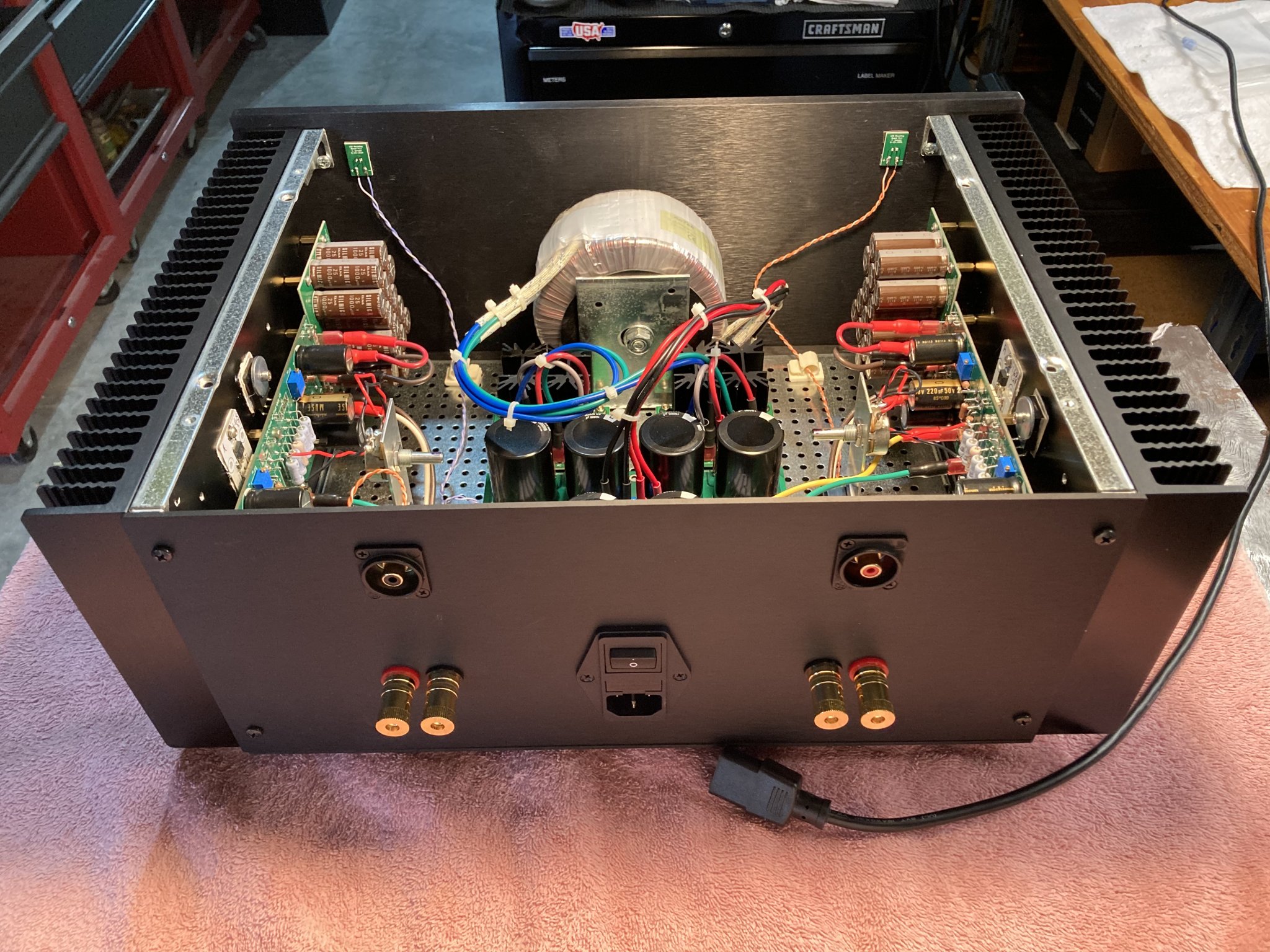

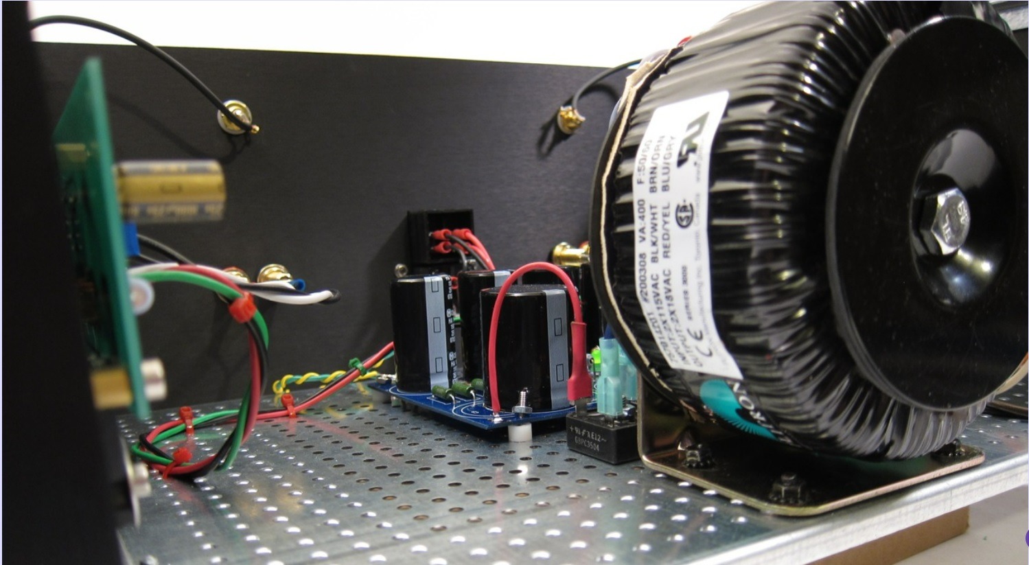

If your transformer does not have a potted core you will need some other mounting hardware to hold it in place - some images provided of the hardware and also how 6L6 used the mounting bracket and hardware for his F6 build.

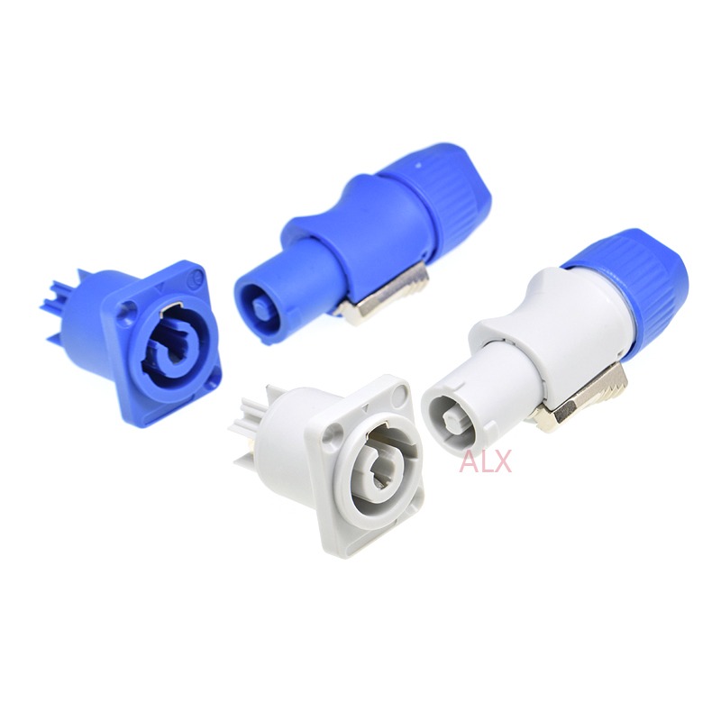

Regarding drilling holes in the back plate if the chassis, in my experience, drilling circular holes are quite easy, whereas the rectangular hole for the IEC is more difficult. One idea of avoiding an IEC socket is to you a Powercon connector - an image provided for your reference.

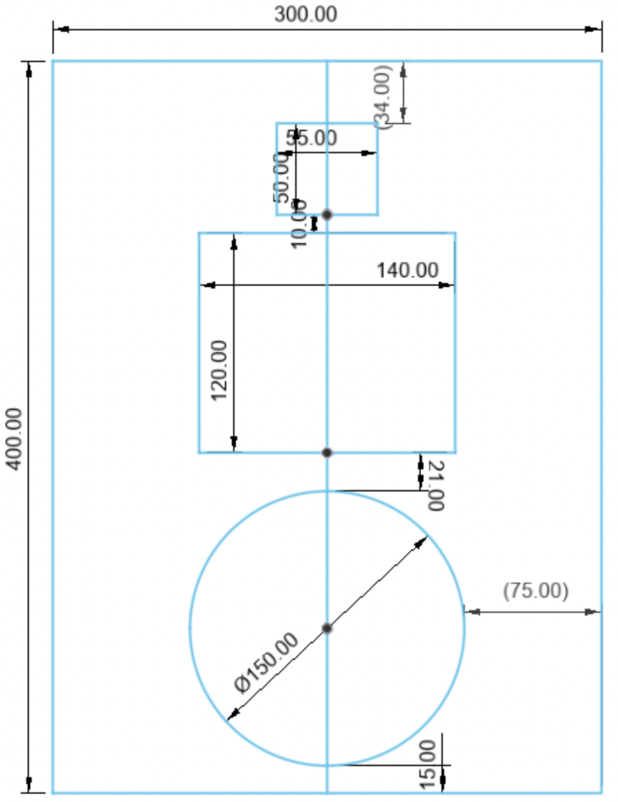

I did a mockup of the layout of items inside the 3U case with the toroid flat on the bottom, PSU and softstart board. I could orient the softstart board vertically if needed.

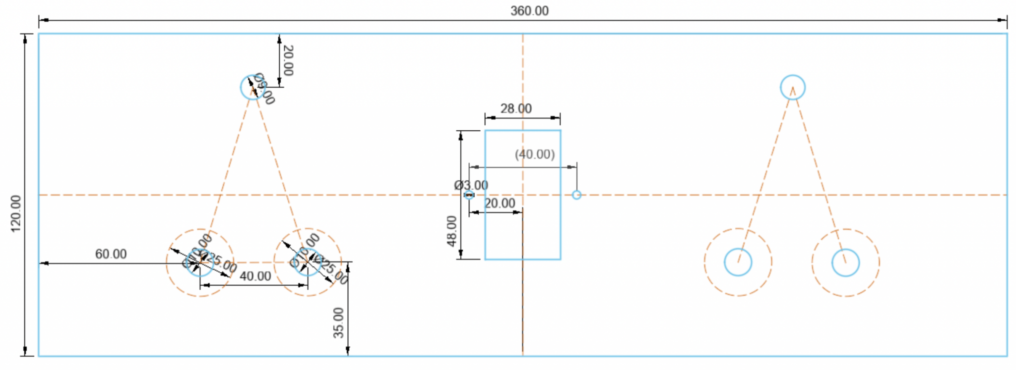

Mockup of the back panel. Does the spacing look fine? Top 2 holes are RCA, bottom are speaker binding posts and the IEC socket in the middle. Ignore the dotted lines.

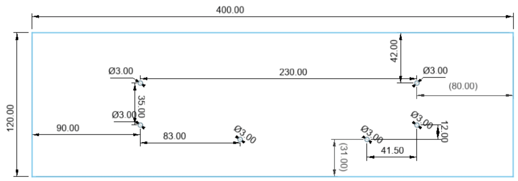

This is for the heatsink. Is the spacing ok? I get 42mm from the top and 31mm from the bottom. 90mm towards the rear of the chassis and 80mm towards the front.
Atharva,
Your layout in the first image looks ok - however, I have a question: Where are you planning to place the power on/off switch?
I see that you have 15mm gap from the edge of the toroidal transformer to the front panel; if you are planning to place the power switch on the front, then depending on the thickness of the panel, the size of the switch, and placement of the switch, 15mm might be too less. After mounting a power switch on the front panel, the body of the switch and tabs/connectors tend to stick out; and you also need to connect the wires from the IEC socket and power transformer to the tabs on the switch. If the power switch will be on the back, then it should not be an issue.
Comments on the second image - I see that the speaker connector centers are placed 60 mm and 100 mm from the respective outer edges of the back panel; you can possibly make it 50mm and 90 mm from the edges, so that there is a little more distance from the AC power inlet. The RCA connectors would then also shift 10mm closer the edges and away from the center.
I recall you mentioning that you are using a different PCB vs the diyAudio store ones? Maybe not super important, but my bias would be towards placing each of the output devices (IRFP240 MOSFET) at horizontally equal distances from the edges; the PCB may or may not be symmetrically placed, but the output devices will be. If you are using a Modushop case, then it is possibly 2 x 200mm sinks?
31mm distance shown from the bottom of the heatsink is for the edge of the MOSFET? that looks fine. If it is the edge of the PCB, will the MOSFET be mounted at the edge of the PCB like the diyAudio Store PCBs? If that is the case, the MOSFETs will be closer to the bottom of the heat sink.
